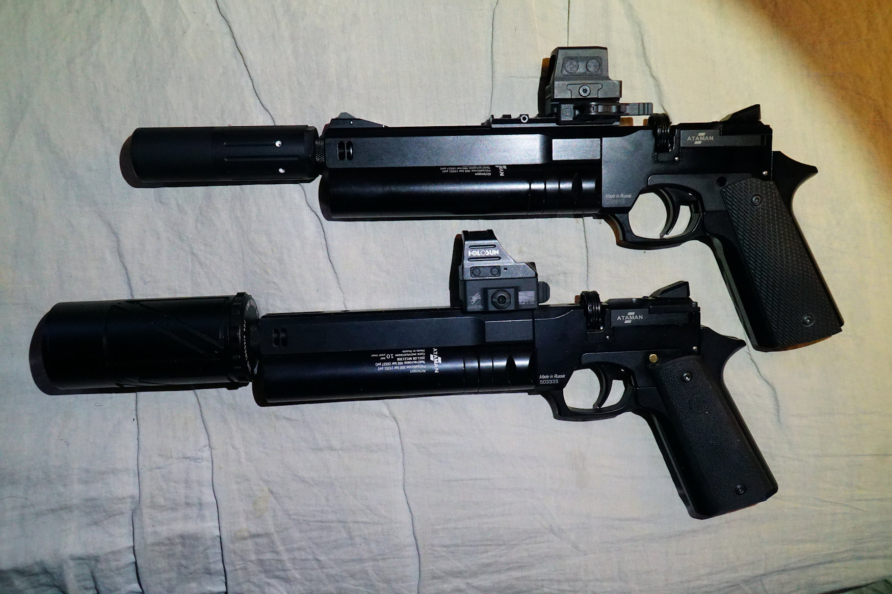

Most all of my pistols have Holosun red dot sights. One has a scope, just for something different.
Holosun, Vortex, Sig Sauer all make very good red dot sights. The Holosun are normally the best at battery life (50,000 hrs)
Another interesting sight is the "See ALL" sight. It works like a cross between a red dot and iron sights. They come in a "delta", (solid triangle) and a "T" reticle. I have a couple, on both pistols and a crossbow. They work very well with people that have "old" eyes ! And...no batterys required !

I swap my sights around all the time. I buy a particular sight (a red dot, or a prism, or a holographic) and put it on a particular gun. Then weeks, months later, I think, na, it might be better on...this gun. So I do the swap. I may change sights vs. guns two or three times before I'm happy.
Yeah, the SeeALL sights take a little getting used to, but are solid, well built sights, and work well after a little time behind them.
