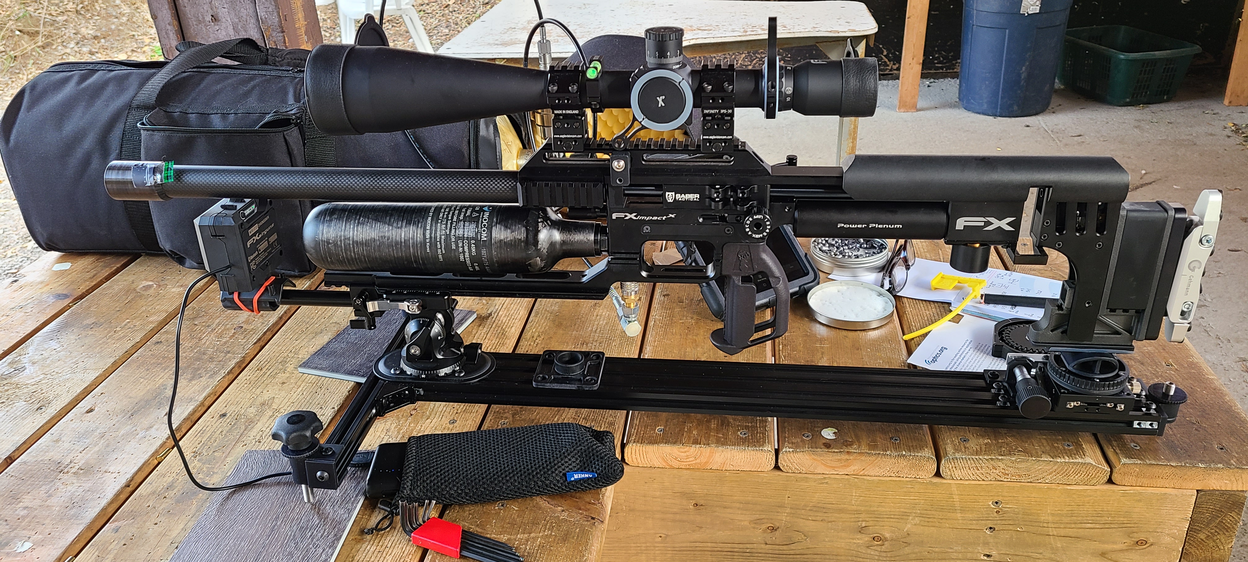

I have this MK2 I dedicate it for BR shooting, and trying to figure a way to mount the scope further back towards the stock, so I can completely sit from end of a bench.
Recently we got some options on the market that would replace the MK2 upper picatinny scope rail (D1) plus the upper guiding/connecting plate (B14) as for example the AirMarksman backbone rail but there are some others as well.
Just looking at the online pictures I am not sure yet how I would like lowering the scope height. Currently the Falcon X50 is set at 82.8mm clamped with eaglevision adjustable rings.
Currently this is my BR setup and I want to move the scope backwards, and eventually I can redesign the entire stock - remove the PL spacer and the Gehmann not to touch the body.

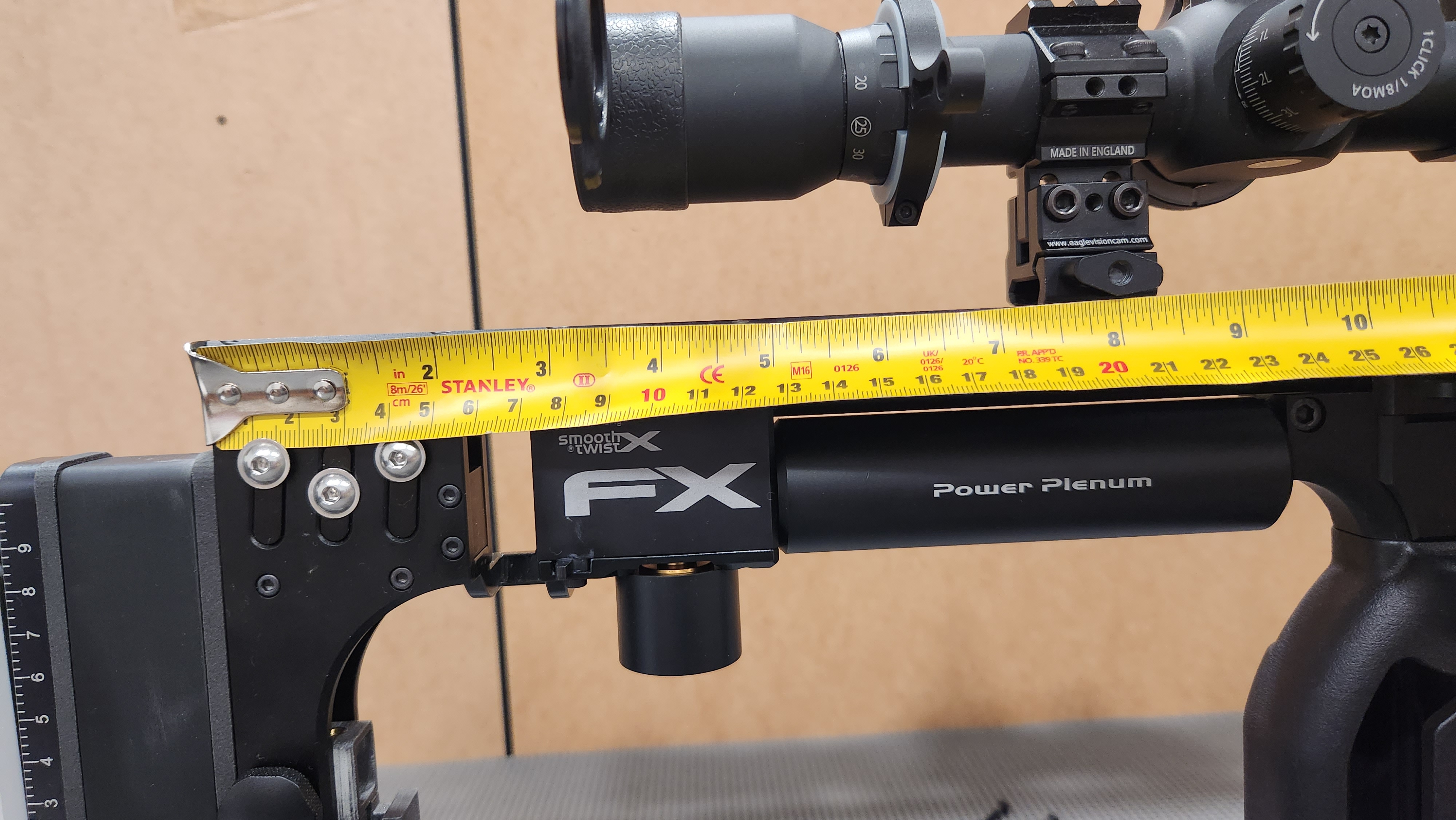

Ok- here we go-
From
The very back of the AM rail to the picatinny that would catch an entire scope ring base so the rear of your scope ring isn’t overhanging out past the scope rail-
And from the underside of the AM rail where it sits on top of the cocking block and rear block, to center of scope, using an arken cantilever mount-
Reactions: bigHUN
That measurement in the first two pics is not of a scope mount, but of a monstrum side picatinny attachment which is the same width as say a typical fx no limit mount. It catches one picatinny slot.
I have to find out what the height of the arken mount is, to give you and idea of your scope height if you went with the AM rail.
Like many others that installed the AM rail, they had to raise their cheek weld up. I already have a saber tactical adjustable cheek riser so it wasn’t a big deal
If you compare my pics to the factory scope rail, the AM rail starts its scope rail on top of the power plenum by a third, while the factory scope rail is above the rear of the power wheel dial, then starts the actual picatinny mounts an inch forward from that slant.
I think the AM rail will fill your needs, and you will be amazed at how much more robust the gun will feel.
Thank you Sir, with the measuring tape I can see the scope can be moved roughly about 2" towards the stock, vs the original FX rail.
That is a significant change, the scope height is a secondary target only.
I will need to check on the tabletop if my adjustable rings have enough extension to clear the front bell.
If you need anymore dimensions or close up pics, just send a pm ok, mr Bighun
Reactions: bigHUN

I starting taking things apart again to do some measurments.
If I want to aim like a real BR shooter from behind the stock (my X50 has a long eye relief) in order to have a full eye box, I need to move the scope to this location.
That mounting option doesn't exist for FX Impact, so I will need to design it, a combination of new upper plate and a adjustable picatinny block raised to 24mm.
