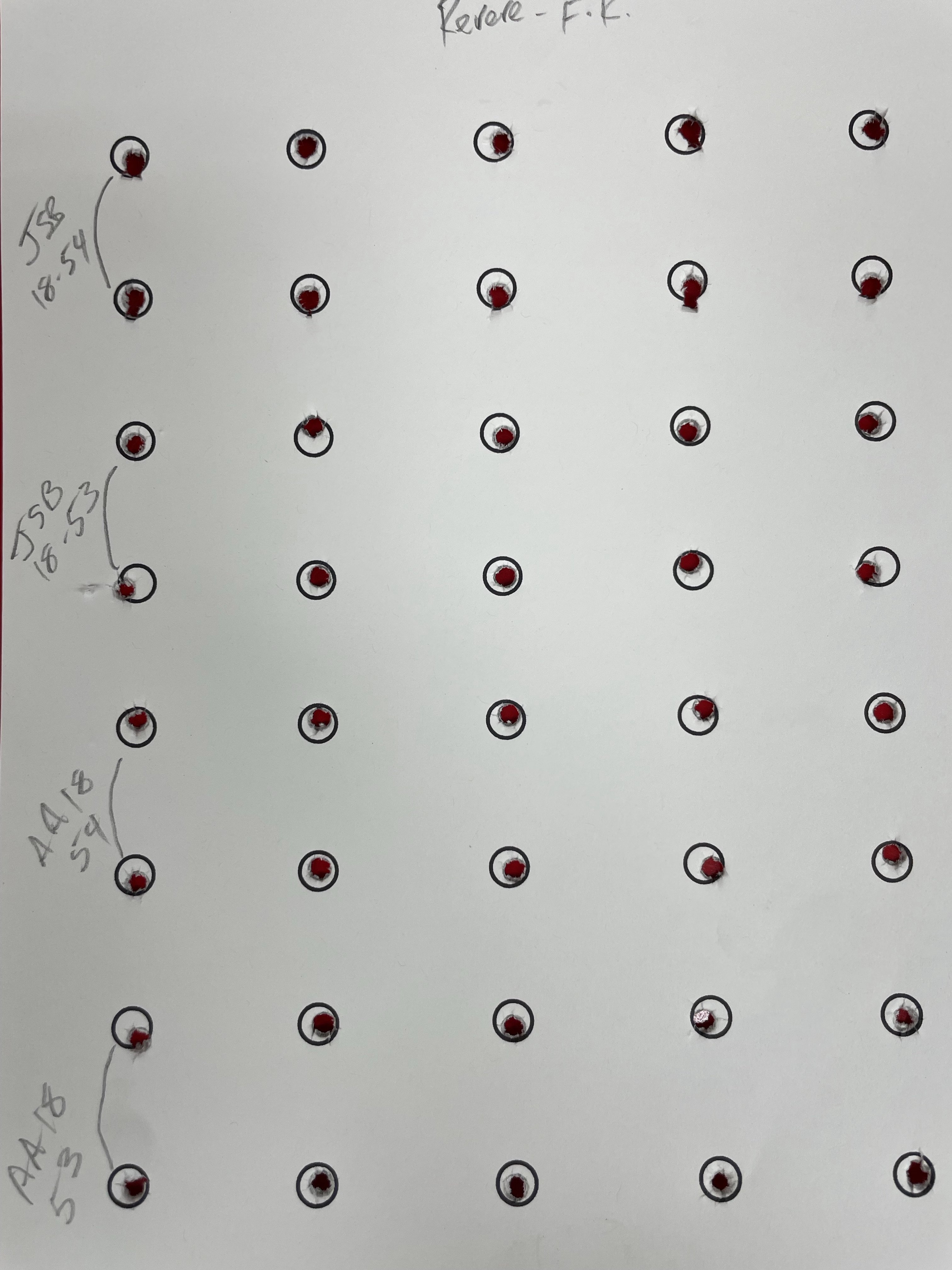

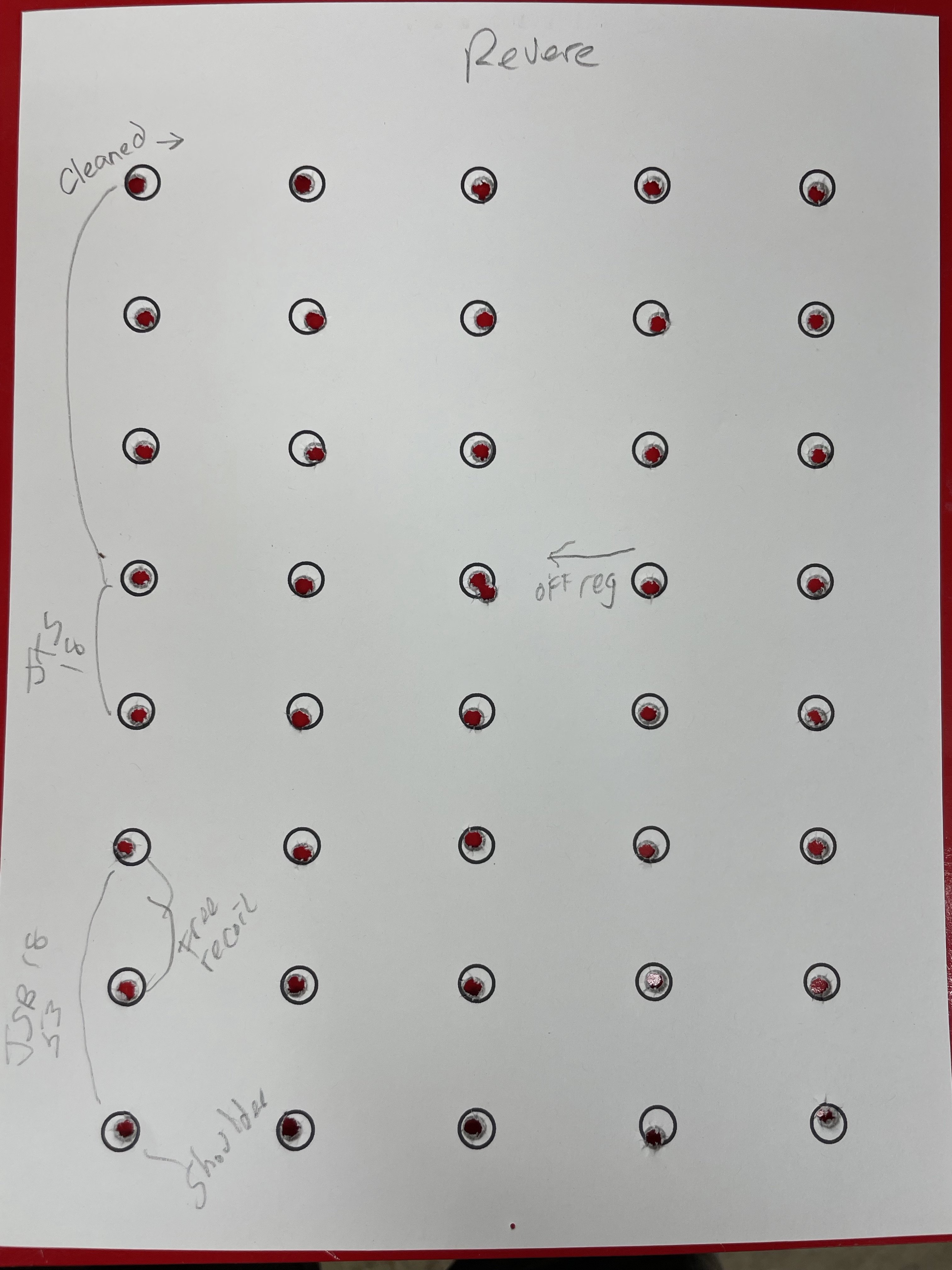

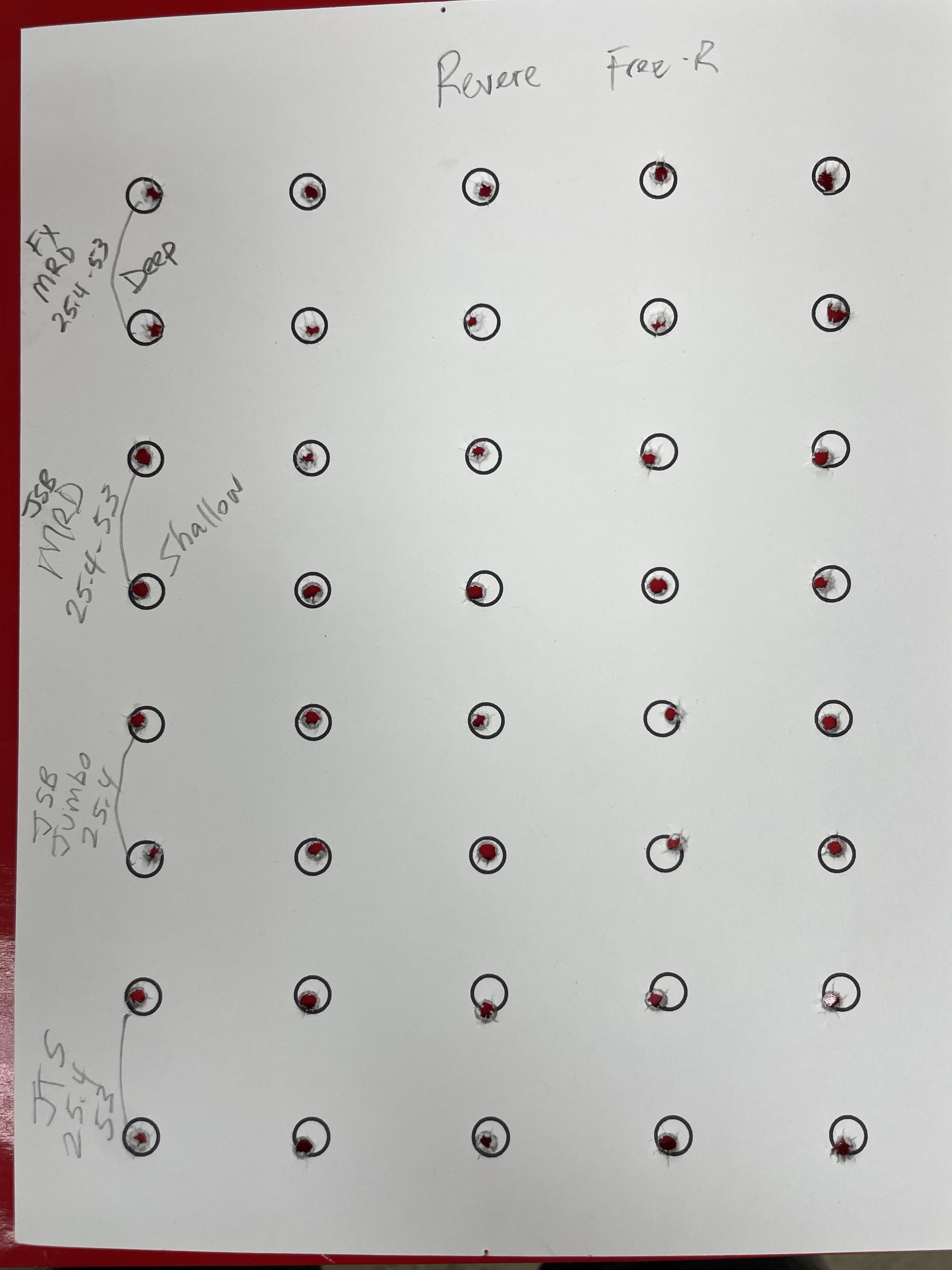

well, this giant mess is my first attempt at finding the right projectile for my rifle at 100 yards. Shots up and down, left and right.. I got a lot of work ahead. Tried a variety of slugs; H&N,FX,NSA,Zan, and patriots. I forgot to bring a chrony, so I am not positive on all the speeds. I am using a RAW hM10000X .22 with a cut rifle barrel( not choked). The patriots were not to my rifles liking, so at least that one is eliminated from further tests. The ones I will continuing testing are the H&N slug HP II, the FX hybrids and the NSA 20.2g. I still need to get a few more in varied sizes. Speed was around 890-900 fps. Will try next with a higher speed and see if any tighten up. This is gonna take some time. I am thinking of getting another regulator from Martin so that I have one for slugs and the other for pellets. The journey begins.

Mike, looks like you got some INCREDIBLE groups on some shots with slugs and pellets! From my experience with slugs, an almost perfect sight picture is needed for each shot in order to get pellet accuracy, something I am terrible at reproducing usually....😂. Oh...and looks like you got your probe and foster spring issues remedied! Woo Hoo!
