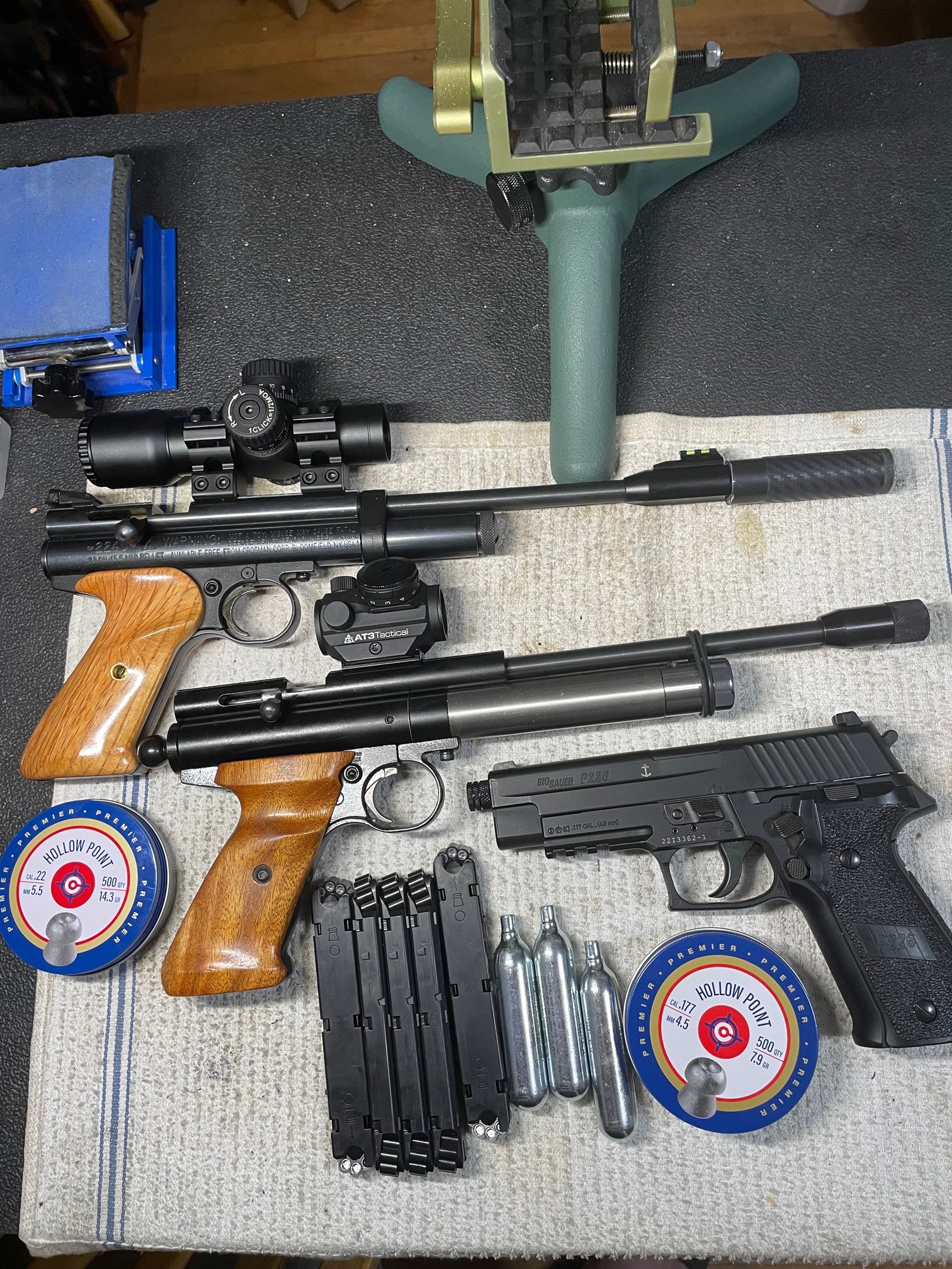

You might want one of these (KWC M712). It’s my go-to snake gun. Select fire BB pistol. A short full auto burst makes quick work of most any creepy crawler when I’m out hiking. I carry a few extra mags but have never had to use more than one

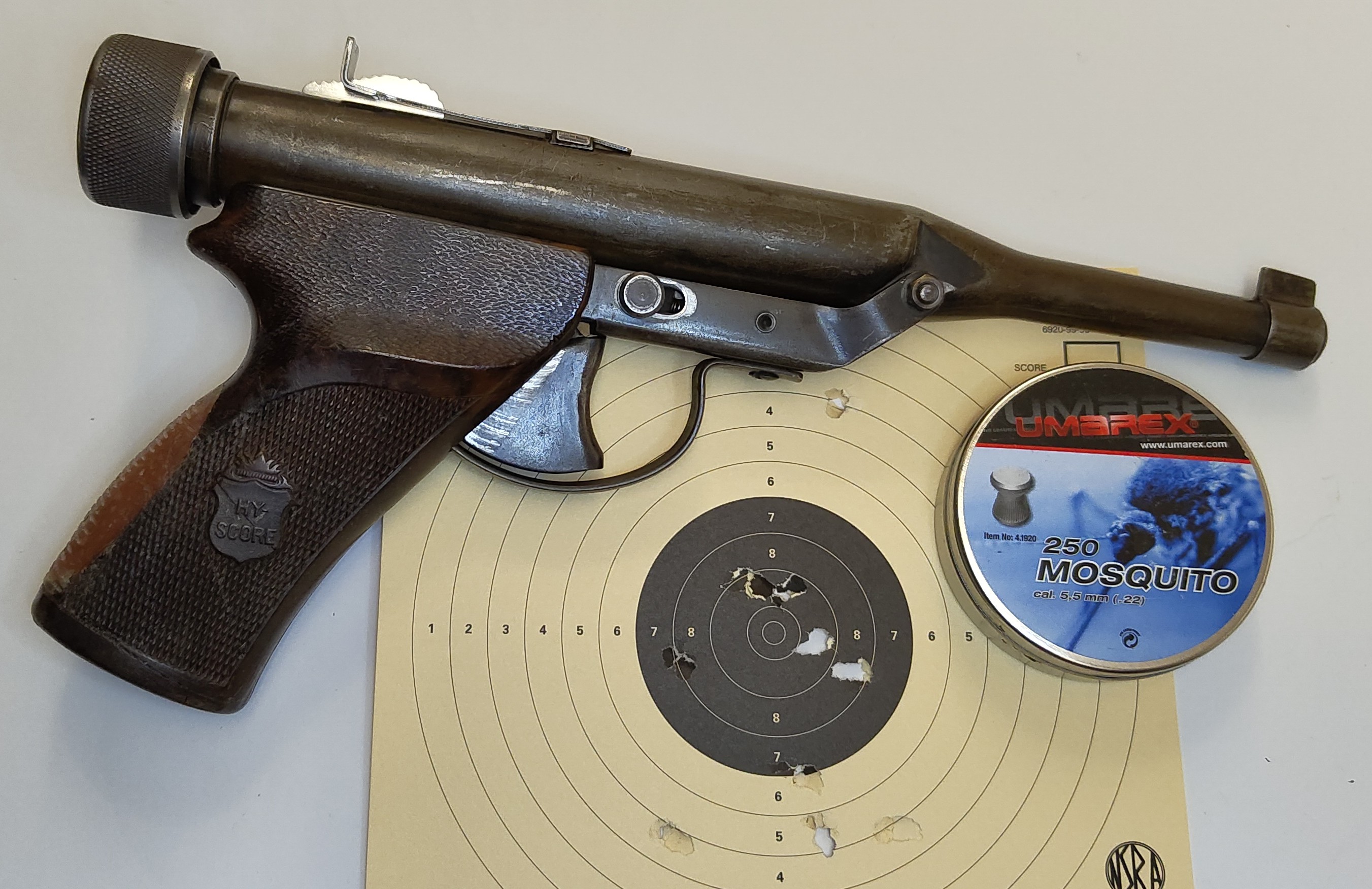

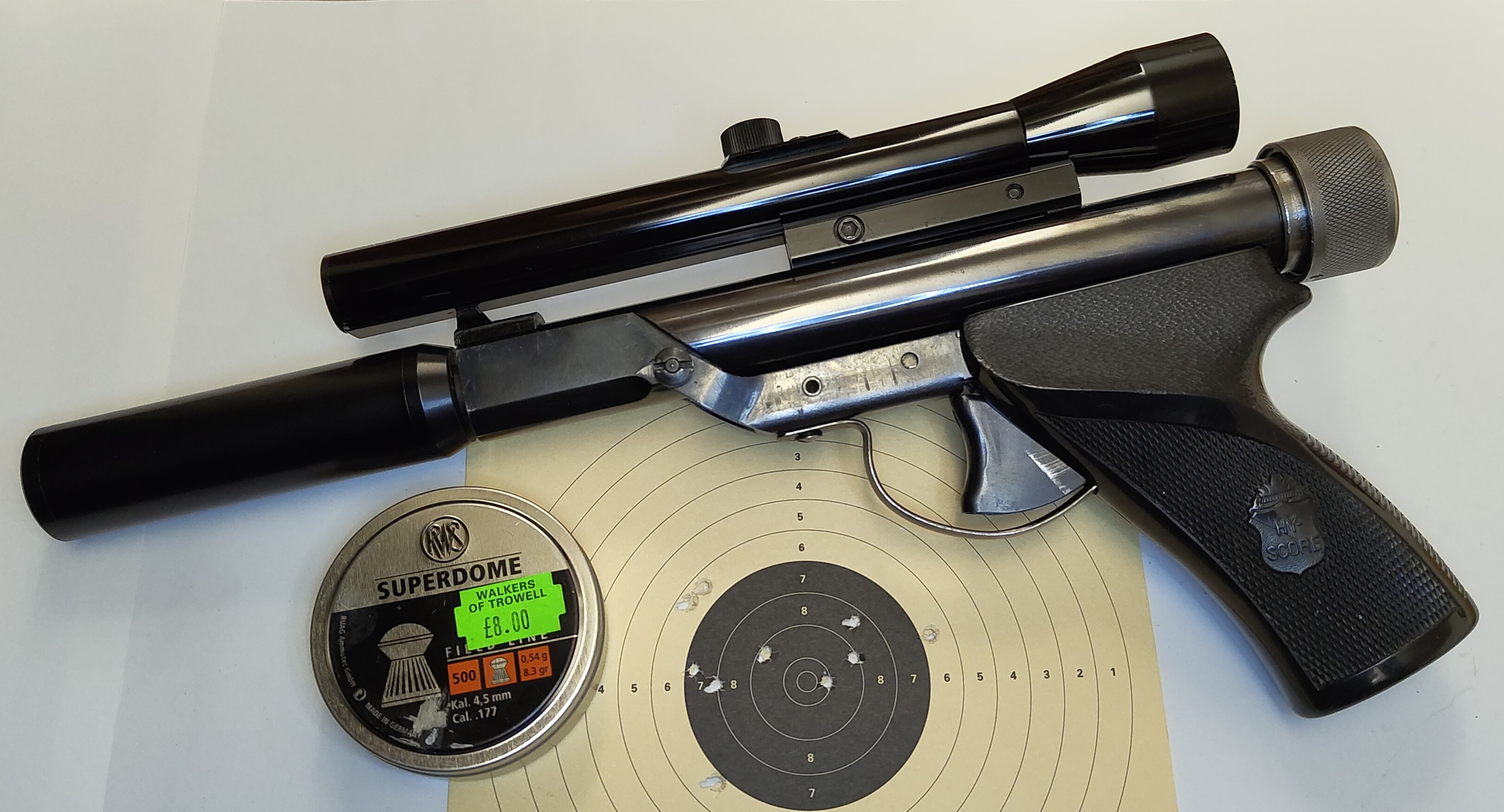

Keen to try out my recent repaired rear sight on my cosmetically challenged 0.22 800 Target model, and since it lives in the same box as the 0.177 Phoenix 'assassin', that got an airing too.
Definitely "difficult to put down" but also bloody difficult to shoot too! It was quite gratifying to actually hit the target at all, I find them so hold sensitive with the slightest variation causing wild flyers.
Shooting at 10m, the Target model was much better shooting with a single arm hold, but this was about the best I could manage.
Ten shots with Mosquitos, which seemed to be the best pellet of the ones I tested. Tearing up the card though, so either the fps is quite low, or the crown is a mess. Things to investigate.

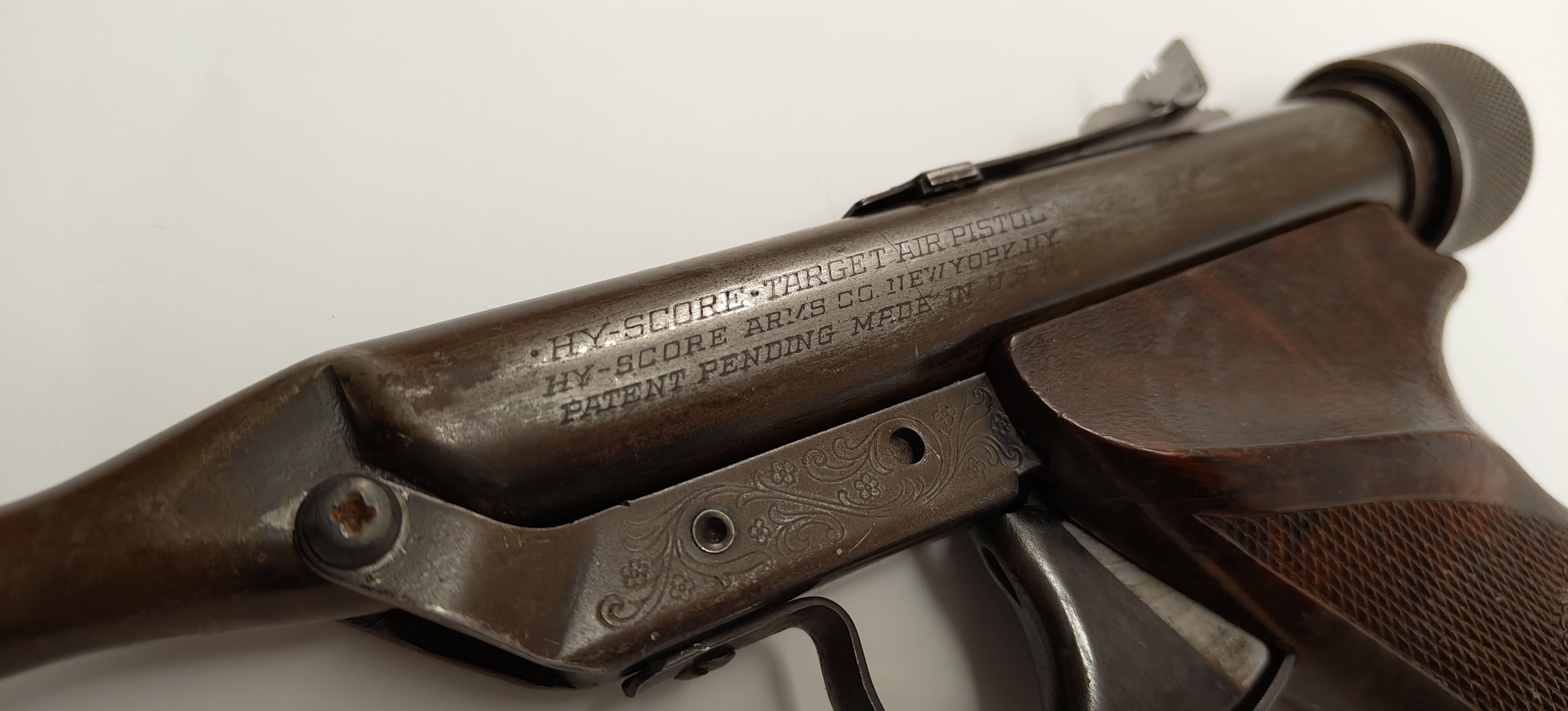

After a lot of deliberation I have decided to give it a spruce-up - strip down, polish and re-blue.
Recently acquired a new grip to replace the mangled original, which has really bugged me since I got the pistol.
This was the best with the Phoenix at 10m using Superdomes, two-hand hold, but also had some wild flyers.

Unfortunately is not a before and after, the US made 800 is still cosmetically challenged; the Phoenix is the UK made version which is pretty much in the same condition as when I bought it.

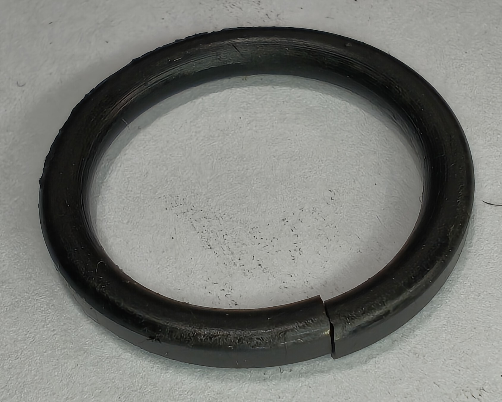

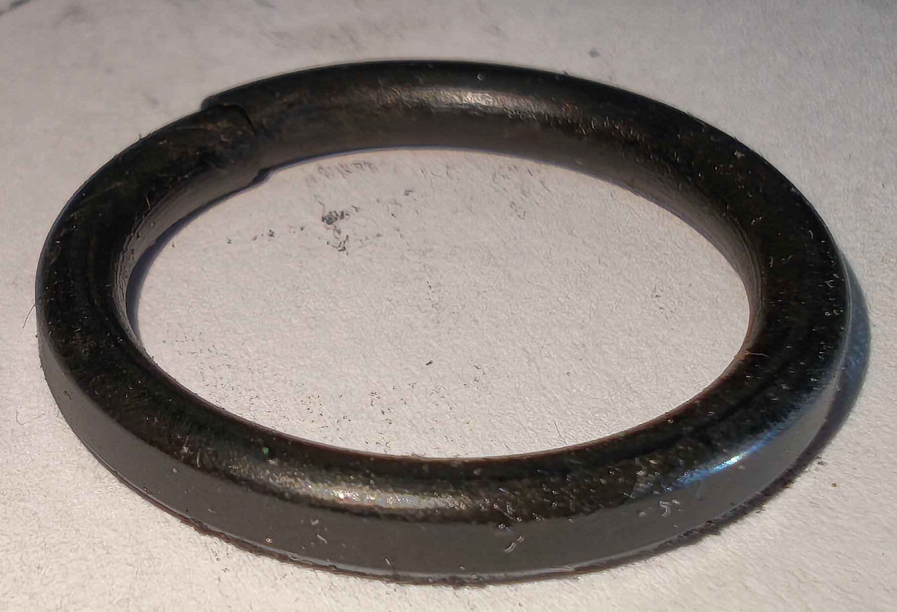

Looking on the bright side, the 800 is now in pieces, and I think I have found the cause of the low power...
I always thought that the piston seal was like an engine with metal piston rings, but this o-ring is hard and brittle with a flat outer surface. (I caused the crack when I removed it).
A new one will be on order soon!
View attachment 491388View attachment 491389
Yep, you found the problem. 👍

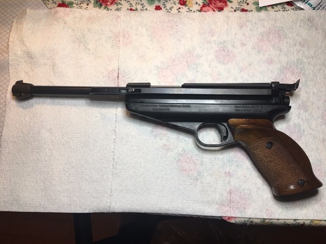

Now, there actually are some guns that have real metal piston rings …like the Feinwerkbau 65
FWB 65.
Near-zero kick thanks to that Luger-like top slide recoil action. You pull the trigger and seemingly nothing happens, but then you see the hole in the target.
The rebuild was more complicated than other air guns I've worked on, as this thing has more moving parts than a Swiss watch. And steel piston rings! Took heaps of pictures at each stage of disassembly and this proved invaluable to get it all back together.
It's relatively quiet and not all that powerful but the accuracy is incredible.
Not bad for an old springer :)

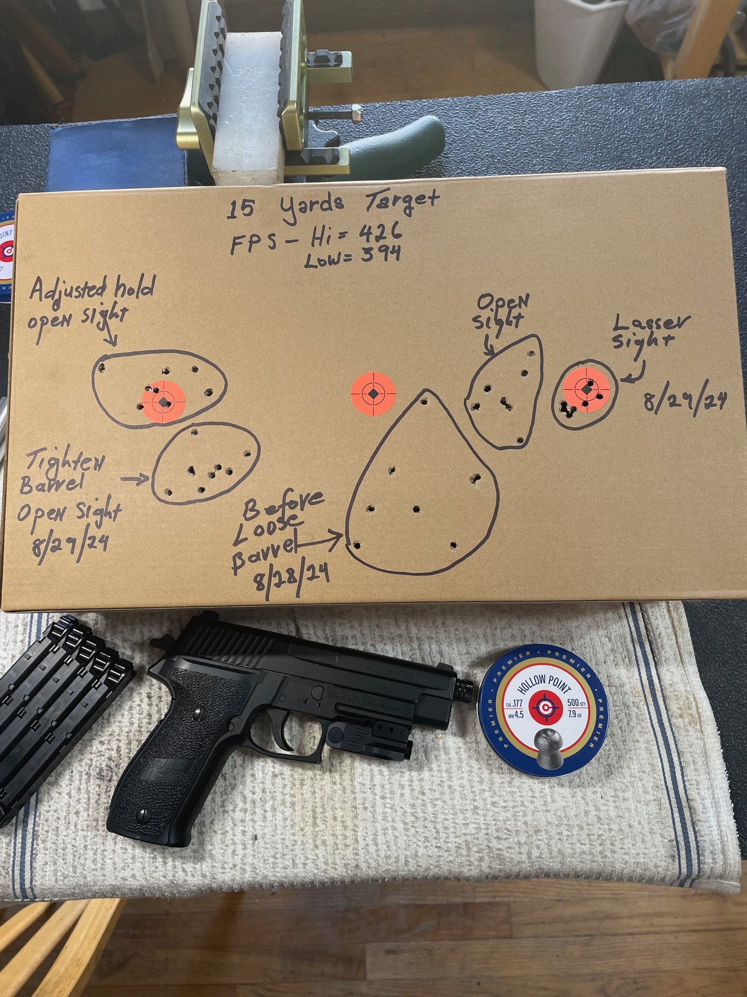

Shoot this early today, the 226 has a lot of recoil from the blow back action. My groups were so-so, I think it's my old eyes, lol. Just order a laser sights from Amazon and will see if I can shrink it down. 3+ inch at 15 yards is no go for me as a rat gun.

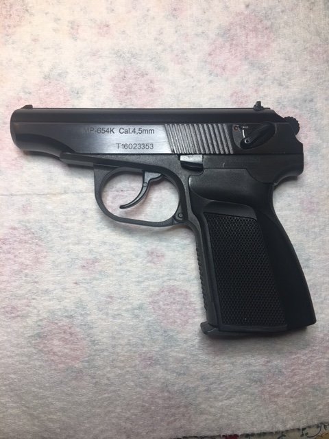

I had to reseal the Makarov. Apparently one of the valve seals on these is a known issue.
Got it back together today and it seems to be airtight again.

Just an update after I machined the action to tighten the barrel clamping on my Sig 226 co2 pistol. Much better groups from yesterday, but POI is way too low with open sights. Will have to lower the front sight. Laser sight is really good for this!
I like it! Well done. I may yet get one of those
