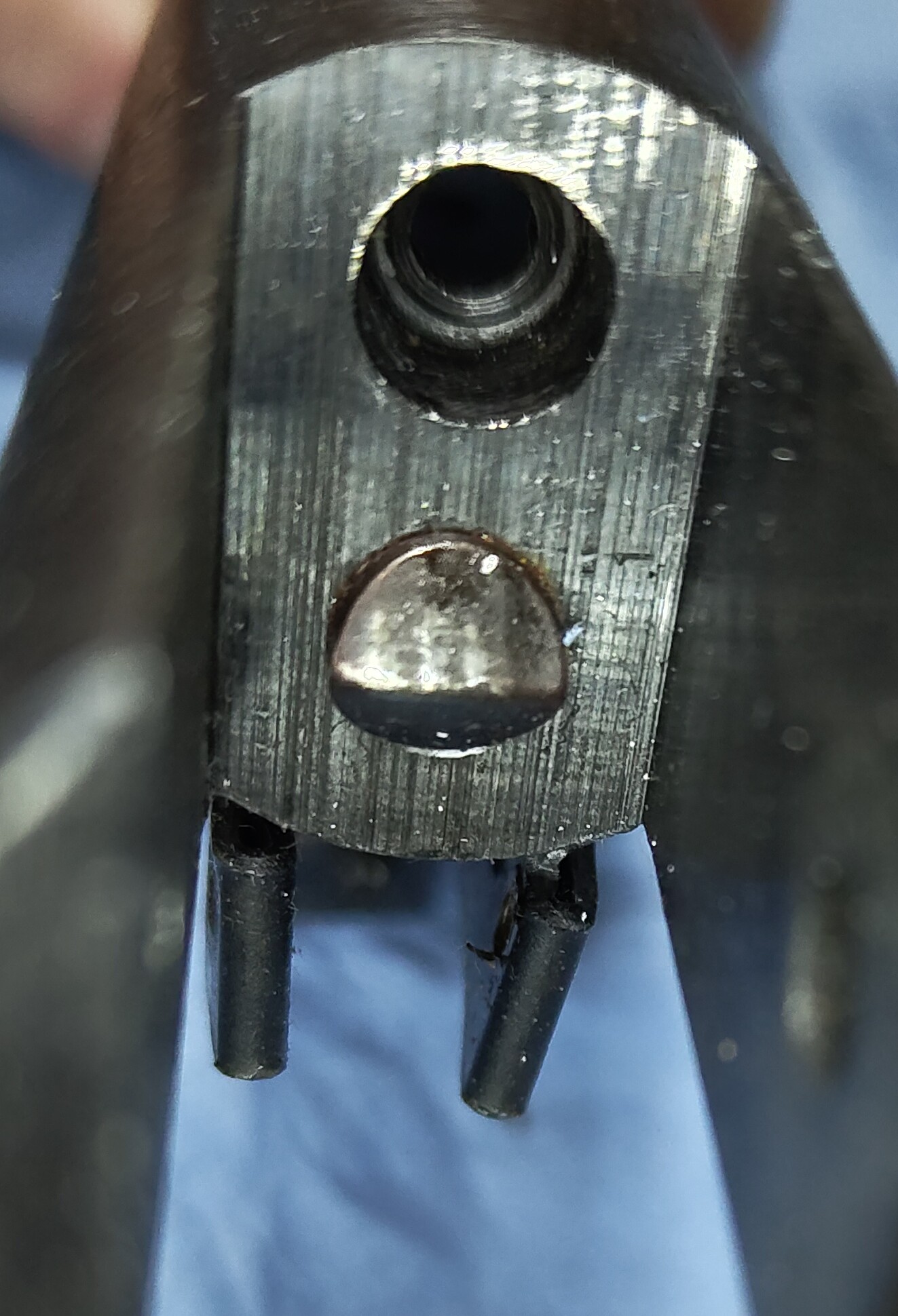

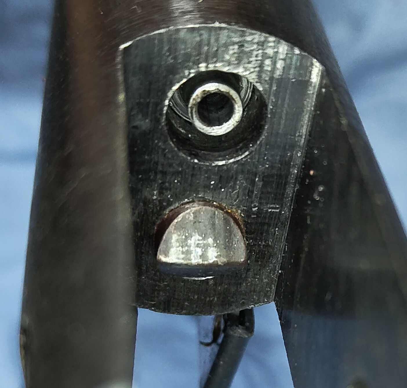

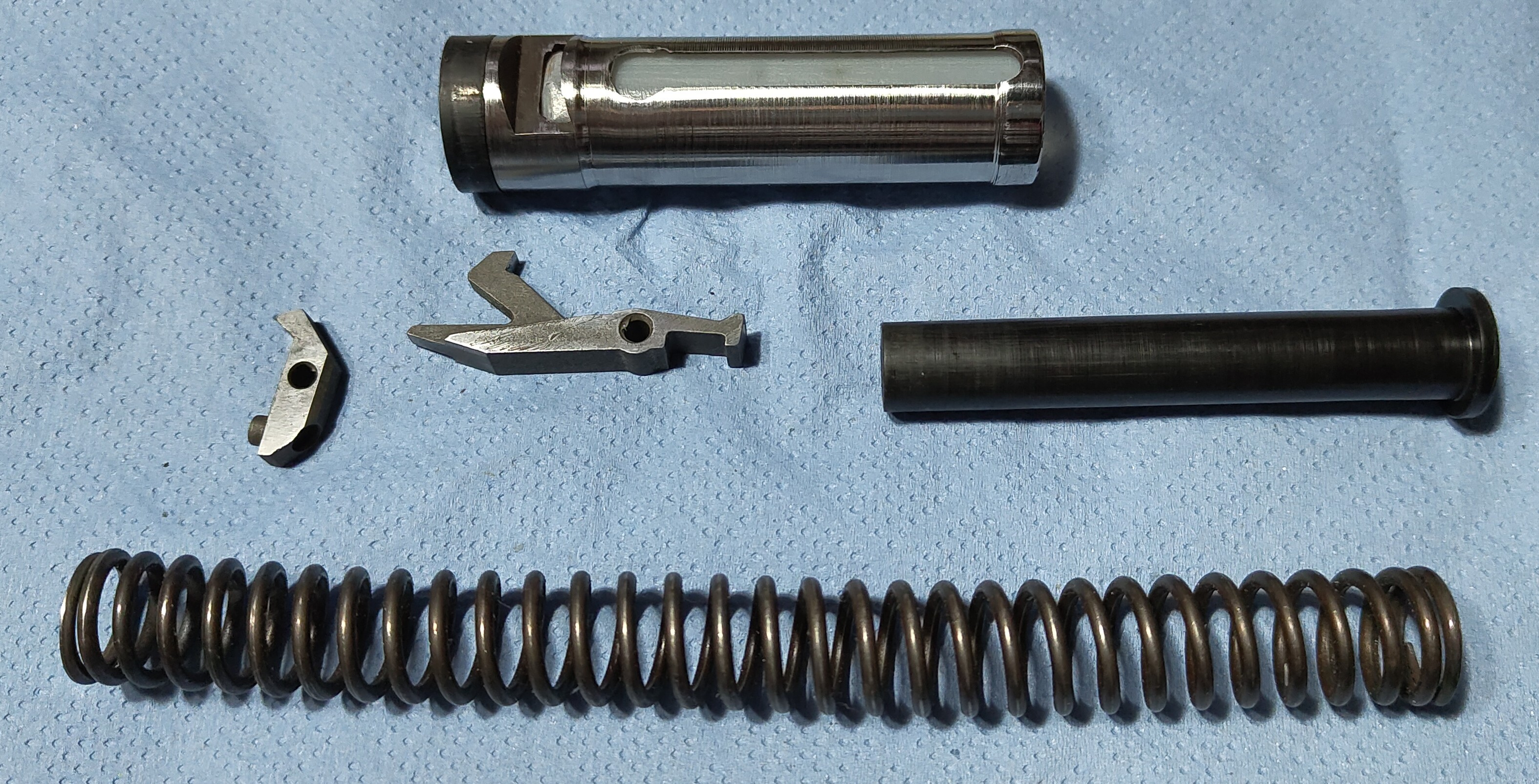

Just finished rebuilding with the addition of a Delrin spring guide, only to find that the piston seal is hardly touching the cylinder wall - so the fps could be better, but a new seal is on order from Poland which will hopefully sort that out.
Modski that is an interesting looking gun. After it is resealed etc. let us know how it shoots for you. Be Well Brother Pistoleros, B.

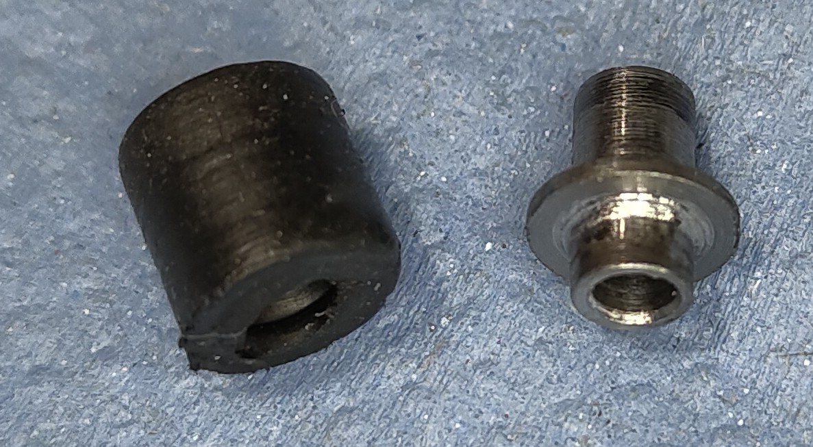

It is already much better than when I first got it, made the spring guide, lined the piston and polished anything that rubbed against anything else.
Also made a new breech seal arrangement that took the transfer port down from 4.5mm to 3mm.
Fps has gone from around 290 to over 350, hoping for more when the new piston seal arrives. 🤞
Yes, that spring is wonky, but it is now much more constrained than the the original arrangement. 😁
I have been shown a supplier in Ukraine that does gas rams that can possibly take the fps to 550!

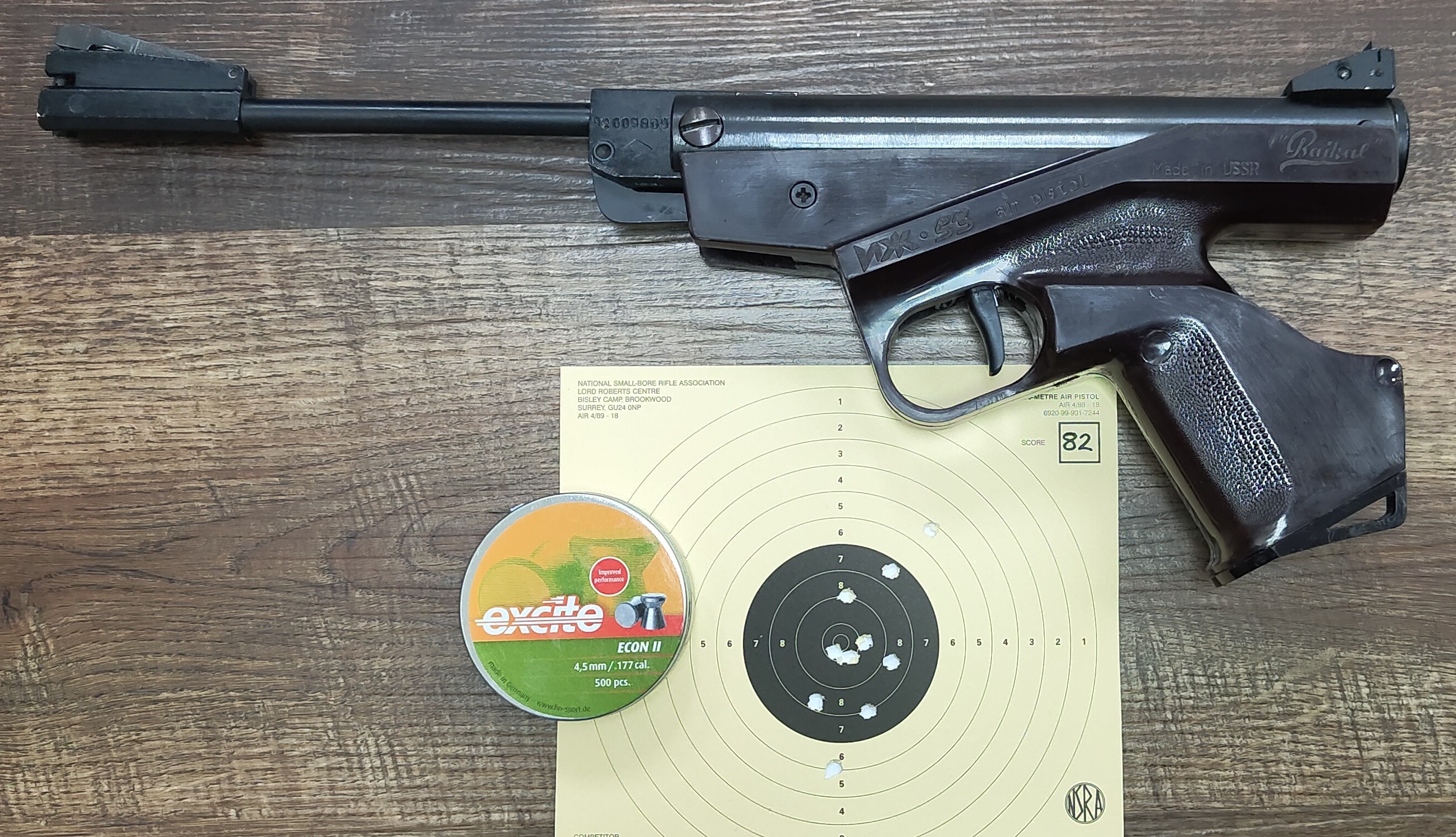

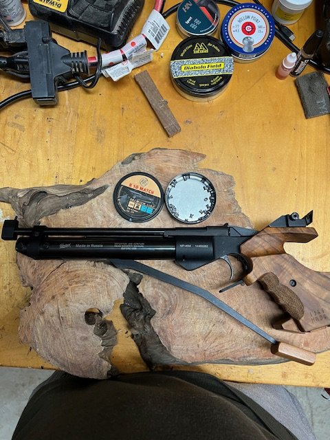

My Baikal 46M has quickly became my favorite. Russian engineering (is that a thing?) with remarkable accuracy. I think I need a true 10m pistol (Walther?, Feinwerkbau?, Steyr?) to compere it to, but those are pricey. Anyways, off hand at 15 feet in my garage. The one low shot was a misfire, very sensitive trigger..

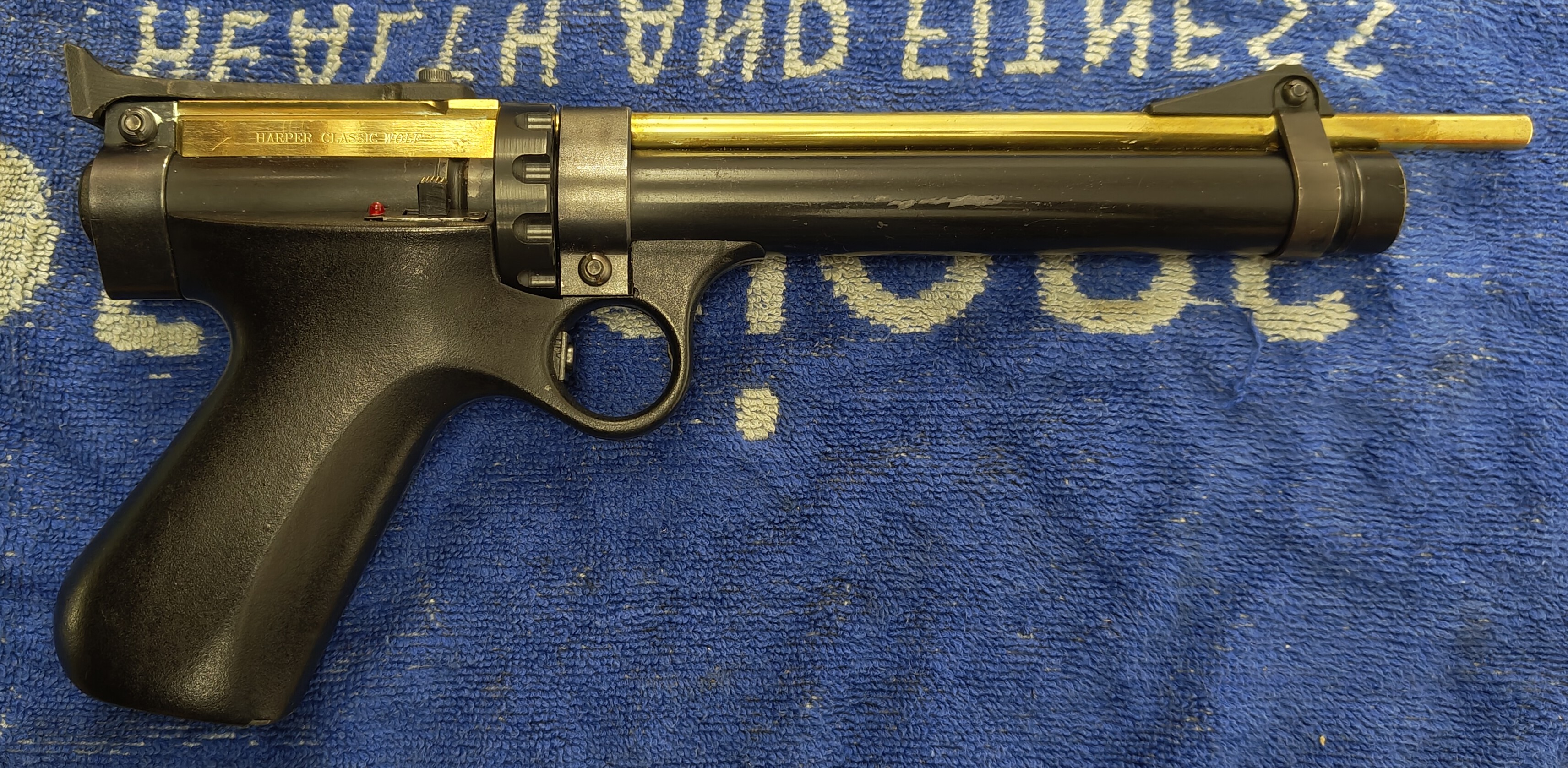

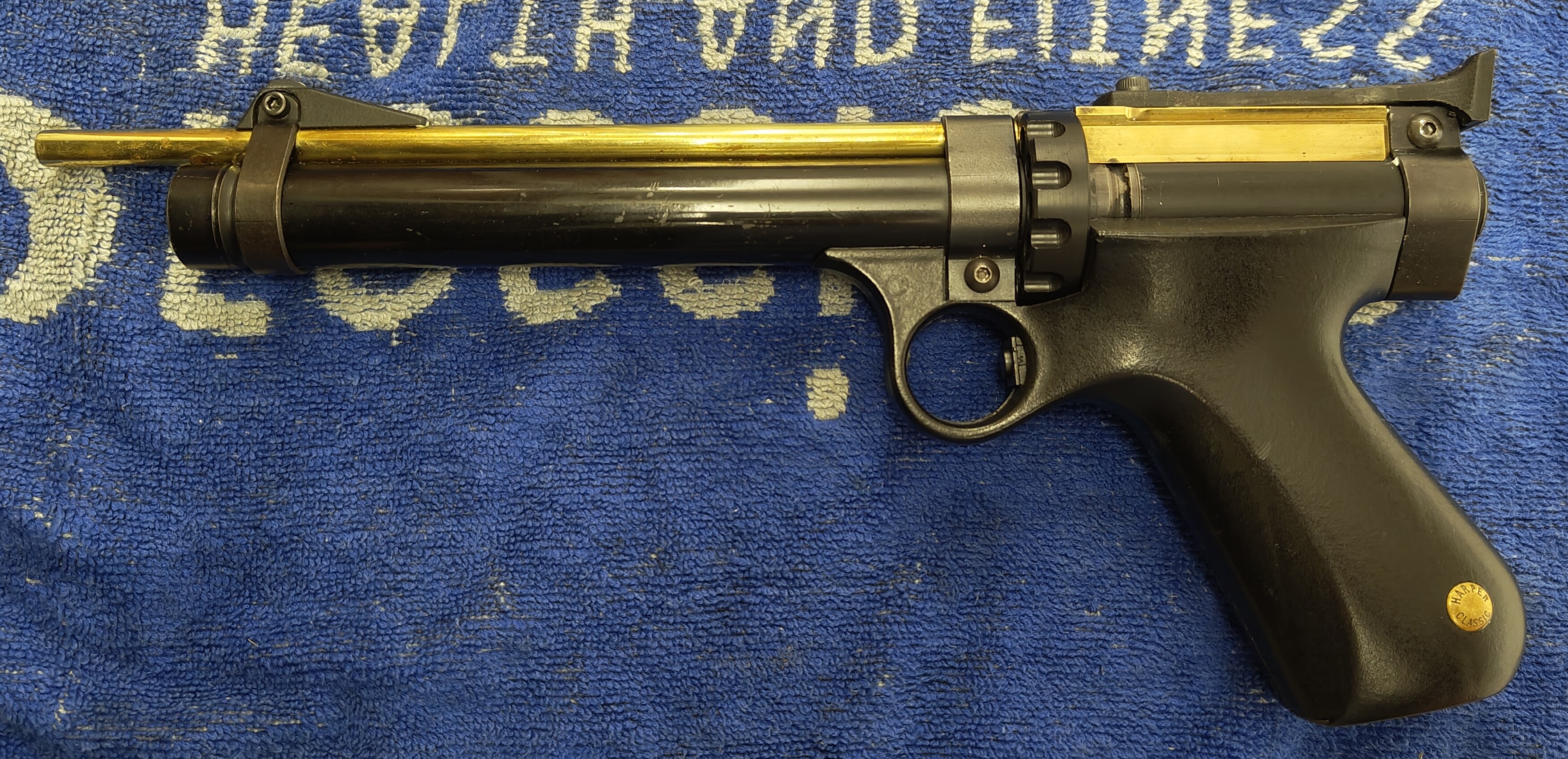

The Wolf made by Steve Harper. Predecessor to all Daystate electronic rifles.
Five brownie points to you!
Sadly it only came with enough air in the cylinder for one magazine, so to try it out properly I need to work out what is needed to connect it to my styrup pump, then I can try out the delights of the electronic 'trigger' and the handraulically driven 11-shot magazine.
