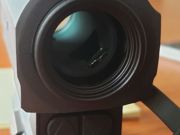

So what is a problem with a red dot?
The LED diode projects a dot into the lens, most likely from about 4-5 a clock position (from that pocket there) into the center of the lens.
A cheaper coating on the lens creates an artifact around the image which gets some sort of shape and most likely looks like this "\".
Your aged or "not so perfect eye" amplifies further and you see a star burst and any kind of weird things.
But a good news is, if you can make a picture like me that means it is not your eyes a biggest problem. You can also test it out by rotating the red dot (unit) and if the artifact rotates you are good to go for next step.
With a decent polarizing lens (or a bit higher quality and $$$ sunglasses with polarized coating) you can minimize the flaw from the sight cheap optical coating.

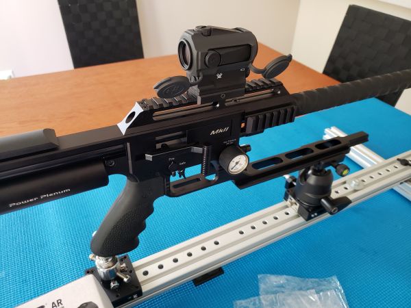

I had a (brand new out of box) Vortex Sparc AR red dot, combined with a magnifier a dot became a line.
Brought it back to a store for a refund. Picked up a Sig Sauer Romeo5, return it, picked up a Romeo7 and no improvement.
A picture with Sig Romeo7 and Juliet6 mounted.
After some playing around and investigations online (also my wife works in ITAR optics manufacturing) I came to a conclusion that:
a red dot by itself as a stand alone unit is working fine with average human eye, but combining with a magnifier the coatings errors (in both units) multiply the artifact/ghost.
The Juliet6 magnifier is back to Sig for warranty repair (or do whatever fock they want to do with it) and I ordered a prism sight Sig Bravo5, these for my FX Impact. So the Romeo5 (brand new never shot) is either up for grab or eventually could mount it to a pistol but will be bulky.
