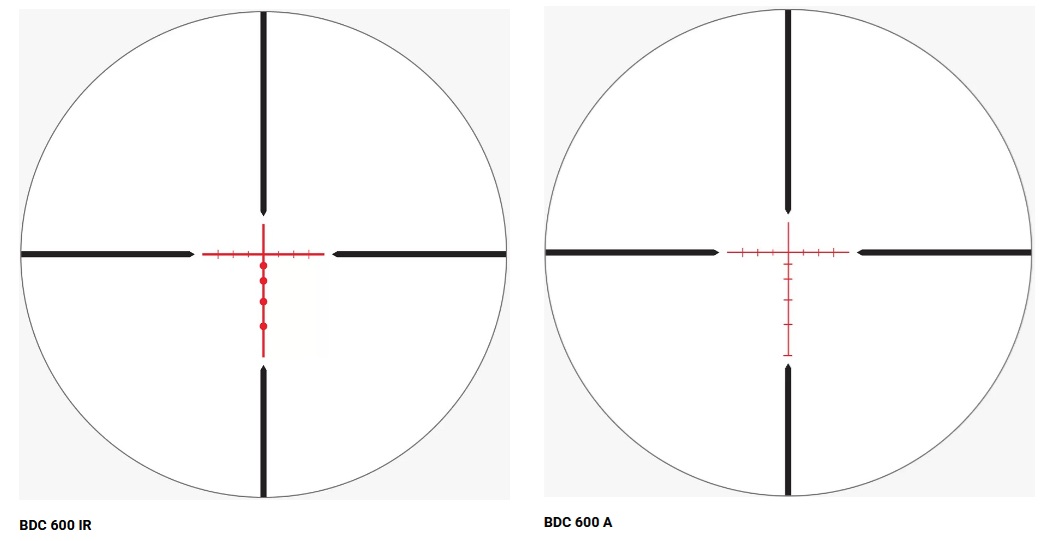

Maybe 30 years ago I bought my first good Leupold scope. It cost me a lot at the time and I couldn't wait to try it. I figured that the 'fine target reticle' was just what I needed for all of the fine target work I imagined that I'd be using it for. Well, that reticle was so fine that it was useless since I could hardly see it. Since then, I've preferred a partially lighted reticle. And it needs to be bright enough to be seen in daylight when turned up.
After comparing the scopes I sold all of them except for a couple of Athlons with BDC 600 IR reticles.
They have an illuminated center cross, visible in sunlight, with bold outer posts. Very simple and traditional.
Athlon has a list of their many other reticles here --> https://theopticzone.com/athlon-reticles/
