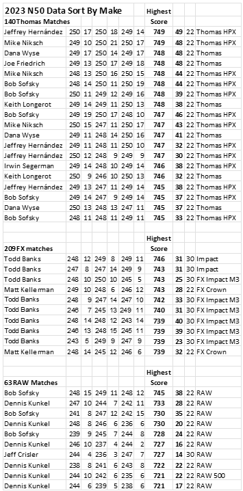

I looked at all of 2023 3-card N50 scores and sorted by make. I can't think of any other organizations that have this kind of 50 yard data. As expected the top 3 makes were Thomas, FX & RAW.
When sorting I set the lowest score at 745, then sorted by make, counted those, gathered a min of 10 matches or more. Then sorted by how many matches were scored. As you can see more FX rifles were used. Note the X-count and caliber as well. Good shooters too.
Then, sorted by quantity of matches above 745
Number of matches shot. Make. Number of matches above 745.
140, Thomas, 19 above 745
209, FX, 1 above 745
63, RAW, 1 at 745

Crud, I can't load a powerpoint. Here's a screen capture. Sorry its so big
