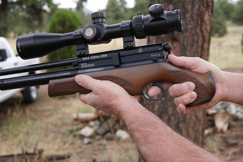

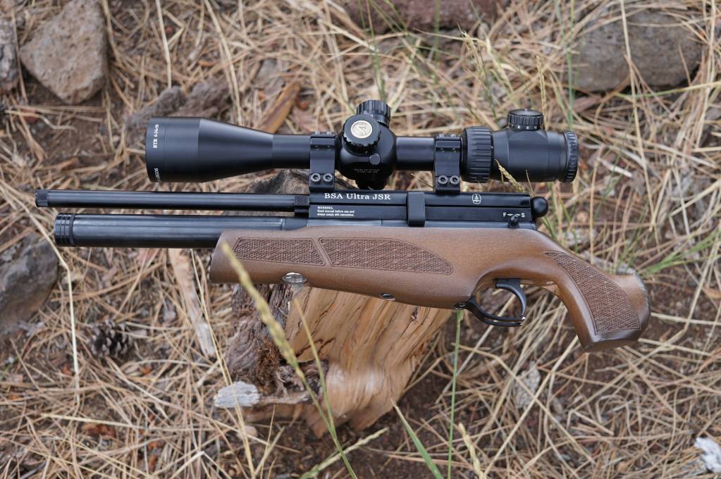

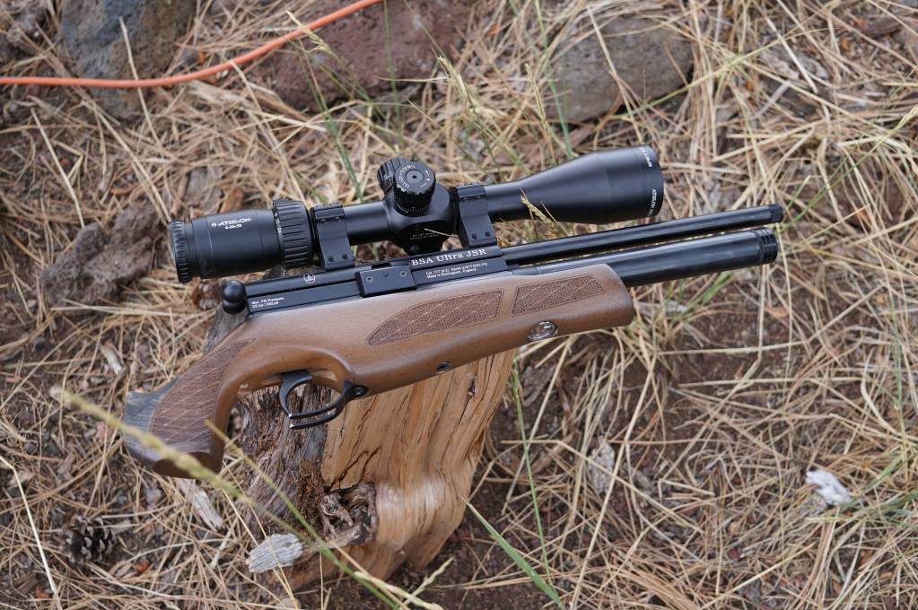

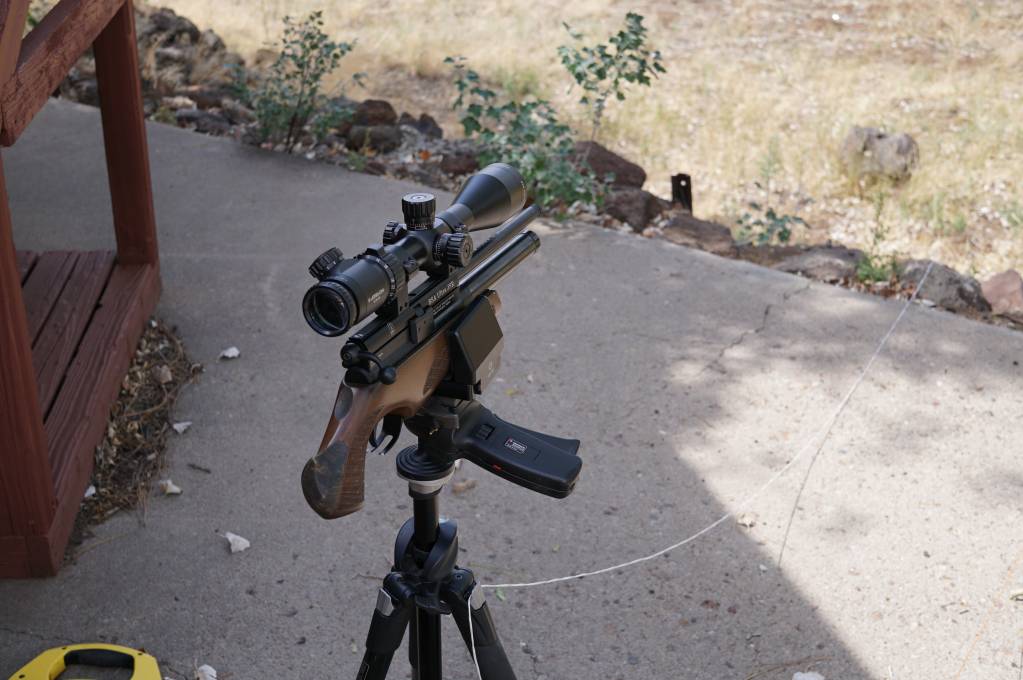

Here's my converted BSA Ultra JSR PFT pistol which started out as a youth rifle.
I chickened out, lol!!! Sorry Bobby but I couldn't find it within myself to take on the walnut stock project from scratch. I got to looking at the walnut blank that was given to me and it's warped, also not as thick to use for what I had in mind so I'm giving it back to Kent.

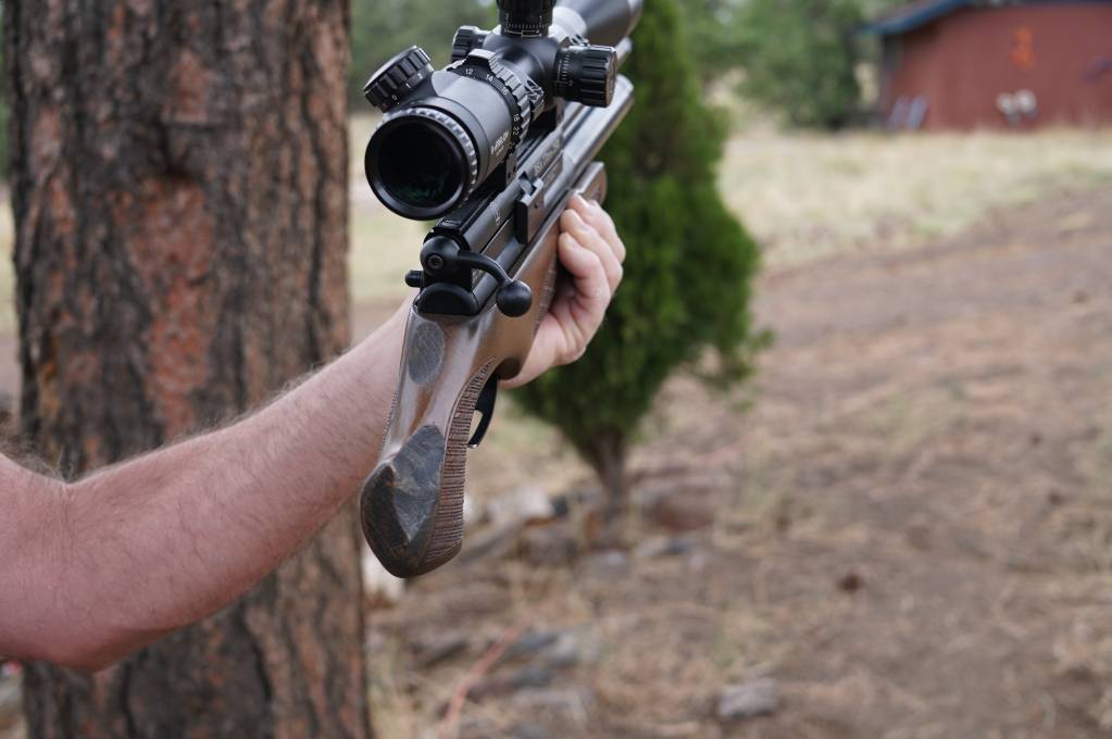

First thing I realised when holding the rifle before I did anything was that the highest part of the rear most of the trigger guard was so close to the grip that my fingers couldn't get up high enough to be comfortable so I lopped off the trigger guard with the dremel just behind the trigger. That problem was solved.
I then dremeled out a thumb rest you see in the photo which is just below the back of the bolt high up on the grip, and also fashioned the back and right side of the grip to fit my hand perfectly, part of that was making a shelf for my palm to rest on which it does nicely. You can see this in the photo. Sanded all that with 60 grit then 220 grit and stained the bare wood with ebony stain for some contrast.
I didn't think about it until I got to shooting the gun but because the cocking force is substantial I can use the back of the top of the palm rest to push against when I cock the gun. It actually helps a lot so that was a plus!
Speaking of substantial - I turned the HST all the way up and got 890 fps with jsb .177 8.44 grain pellets which is almost 15fpe. So I kept turning it back down until I got 792 average fps which is just shy of 12fpe and which is the power limit in the PFT. The gun came from the factory at 10.3 fpe.
I adjusted everything on the trigger I could and got most of the take up eliminated, then adjusted the trigger weight as light as it would go, as well as the sear engagement. It was probably 4lbs as set from the factory and now it's 15oz with a crisp break. I might cut a coil off the trigger weight spring later on but it's much better than before.
I've got maybe 2.5 hours of labor into the pistol so far.
It's pretty darn accurate. It wasn't any problem touching shots on paper sub 1/4" or knocking down my crow target with a 1/2" KZ at 17 yards this morning.

I shot some more today. Winds were a gusty 8-14 mph mostly full value. It's a pifle alright, it doesn't miss much even in these winds, I'm impressed with it's precision.
That's the tripod, etc, I use in Freestyle division. It's not as steady as it looks but it sure helps me in getting my dope down.

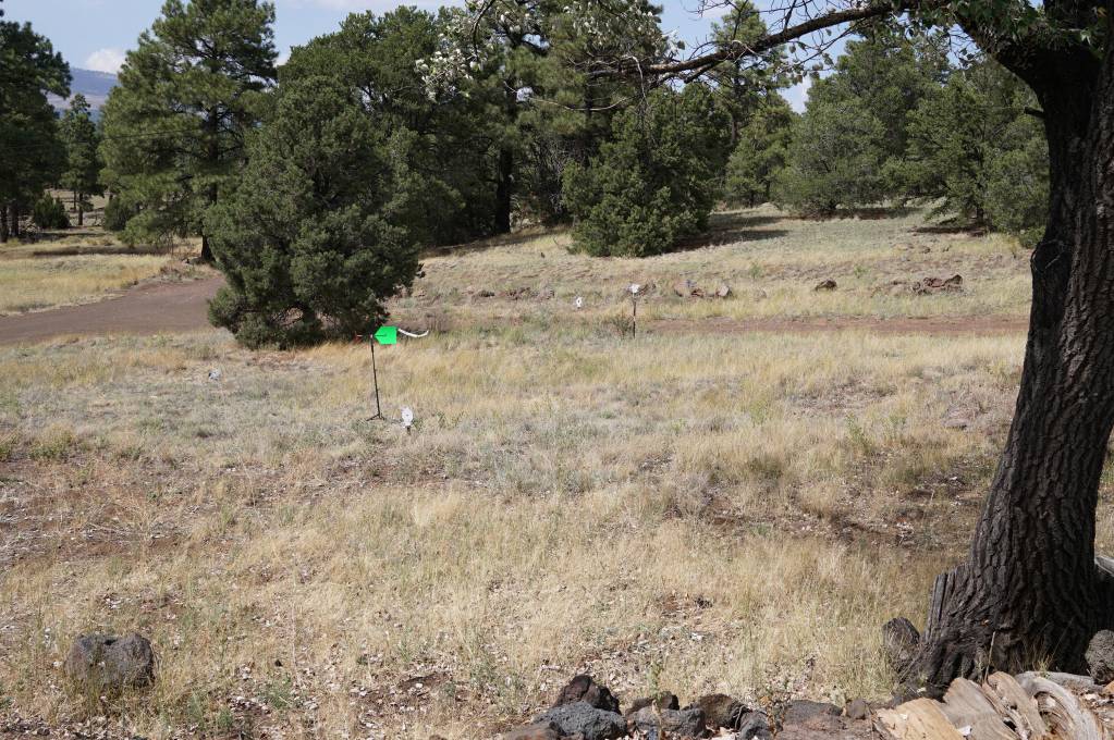

It's hard to make out the 25Y bird FT target to the left of the flag, it has a 3/4" KZ in the body and a 5/8 KZ in the head, and it's my sight in distance. Other targets are 13Y with 1/2 and 5/8 KZ, 30Y with 1" KZ hole and 1.25" reset, and 35Y is a 1.5" KZ and same size reset. FS in the background and that's my road so no cars or neighbors will be harmed.

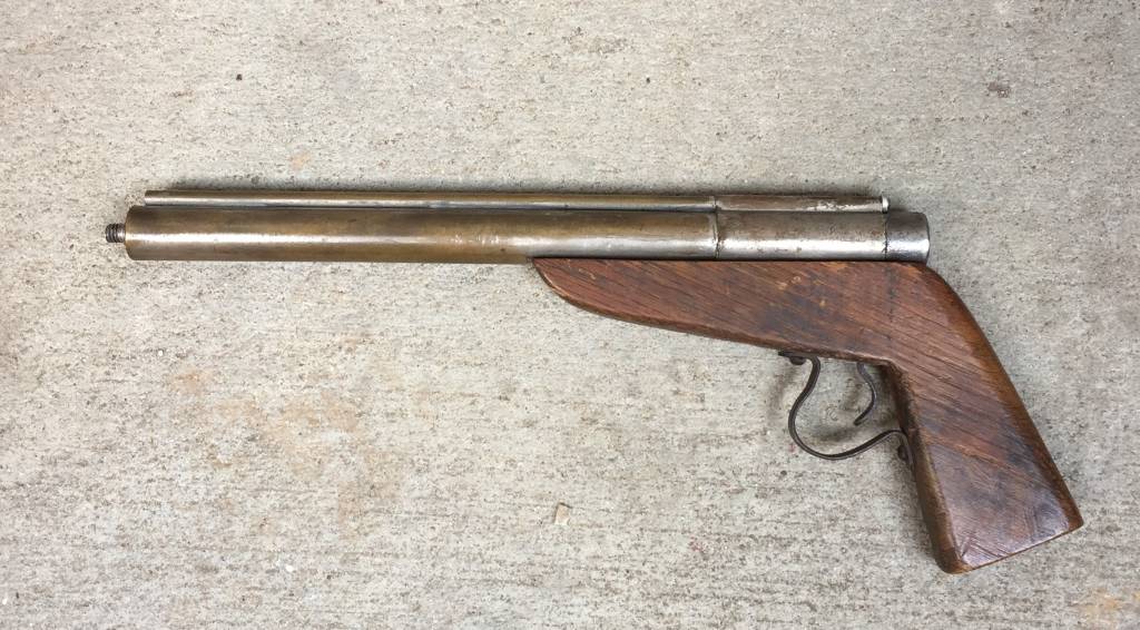

When you used the term "hack job" it reminded me that I have a very early entrant in the rifle to pistol genre. Not my work and it's got a bit of "folk art" vibe to it but a trailblazing effort. Just thought I'd reset your benchmark for ugly.
A Benjamin Model G pistol...
OK I'm wandering off the reservation here...not pneumatic, and not made by me, so not really responsive to the question!

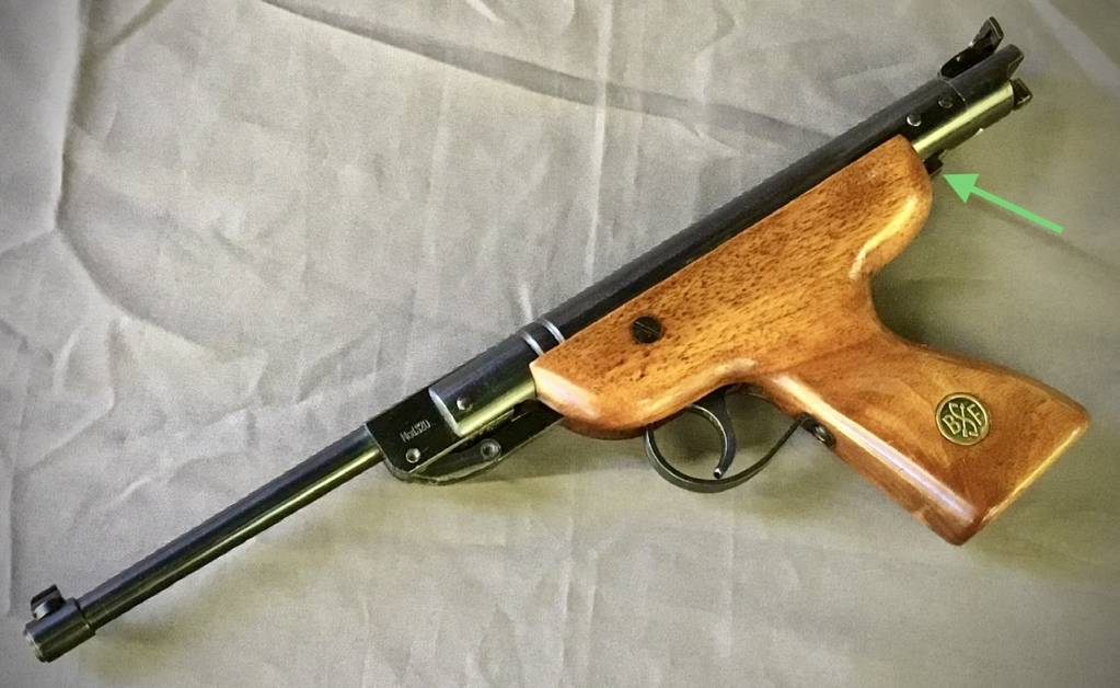

But hey old springers are my thing, and this one demonstrates that converting rifles into pistols is not a new idea. It's a German-made BSF S20, a design dating to the mid-1950's - this one prolly manufactured in the 60's sometime. The action is BSF's small "Junior" rifle of the day...with a pistol rear sight, nice short tapered barrel, and a "bullpupped" trigger so that it all drops into the neat wood grip/frame (green arrow is the sear; you can see it move when you pull the trigger).
FWIW, one of these guns belonging to a childhood friend was the first serious Euro-springer I ever saw...obviously, the lust it inspired hasn't worn off yet, LOL. For many years the S20 had the rep of being the hottest air pistol around - Smith clocked it at 472 fps in his classic 1957 book.
