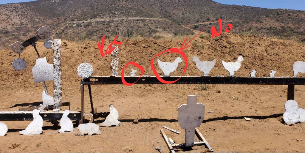

So I did go to the range today. Lol dunno why as the winds were so variable at 200 yards the 30 gr slugs were going about 4 to 5 mil to the right then as soon as I thought I got the hang of it, it changed! 😅
But the Crimson Trace 5 scope was very clear and I was able to see the marks it made on the steel targets even though the .22 could not knock over the larger targets with one hit.
I dunno what I was doing before but I was clearly able to see them today.
I still had some fun. I was able to knock over about a dozen bunnies and finally after hitting the chicken a million times knocked it off the railing. Lol
