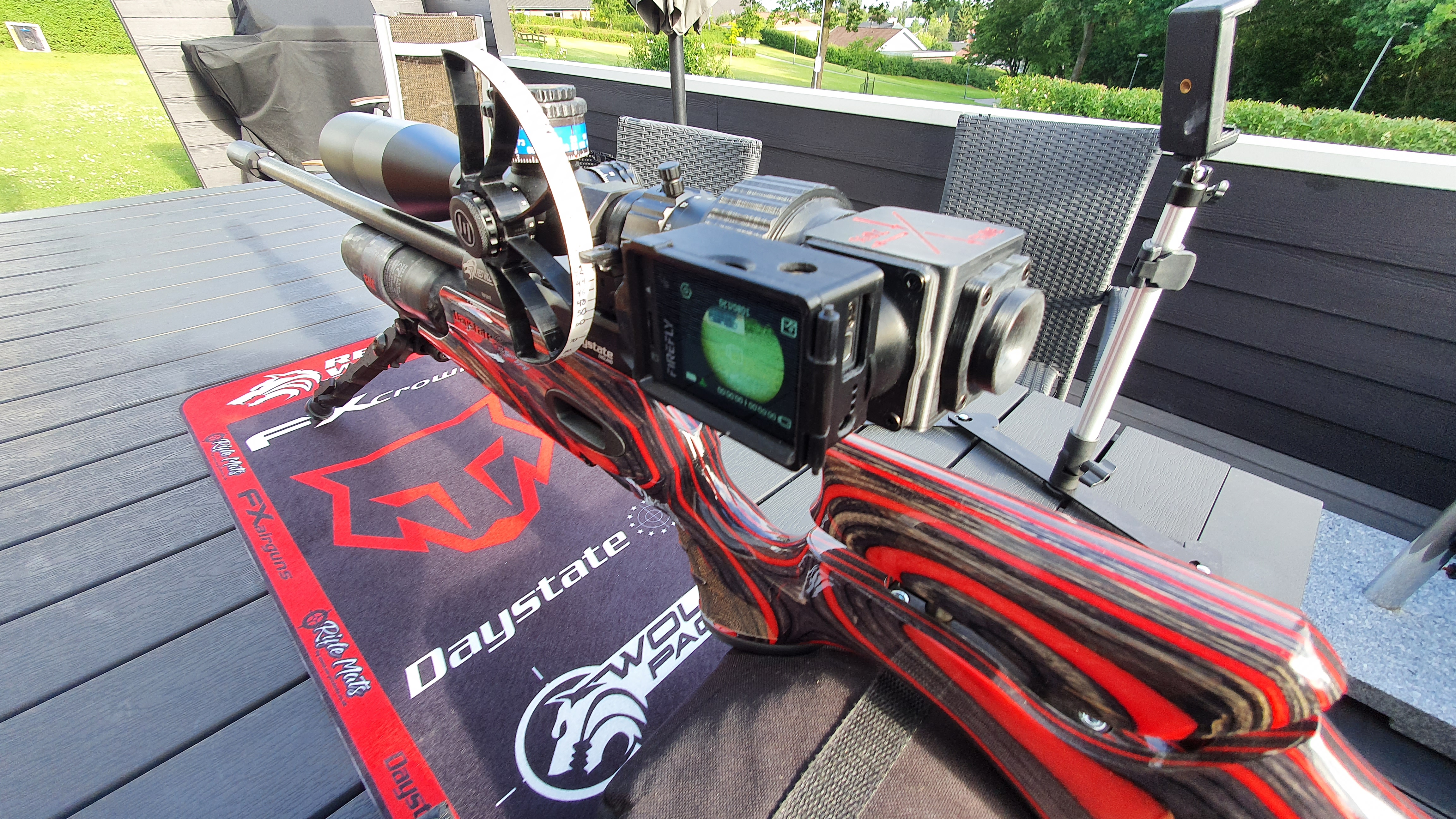

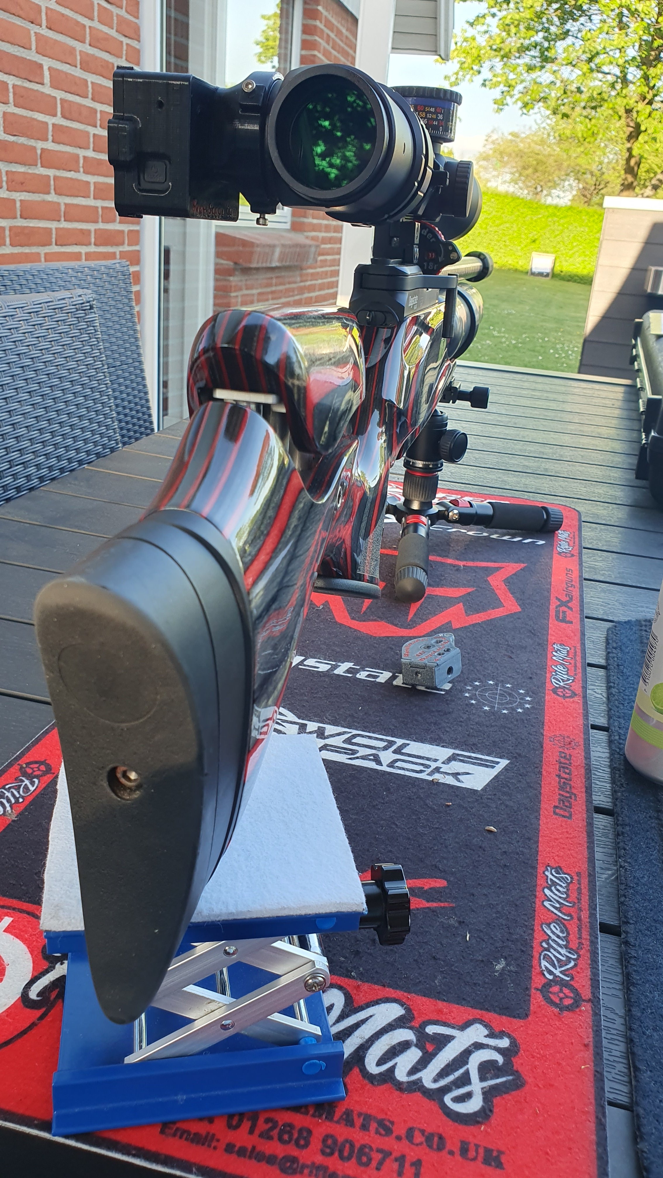

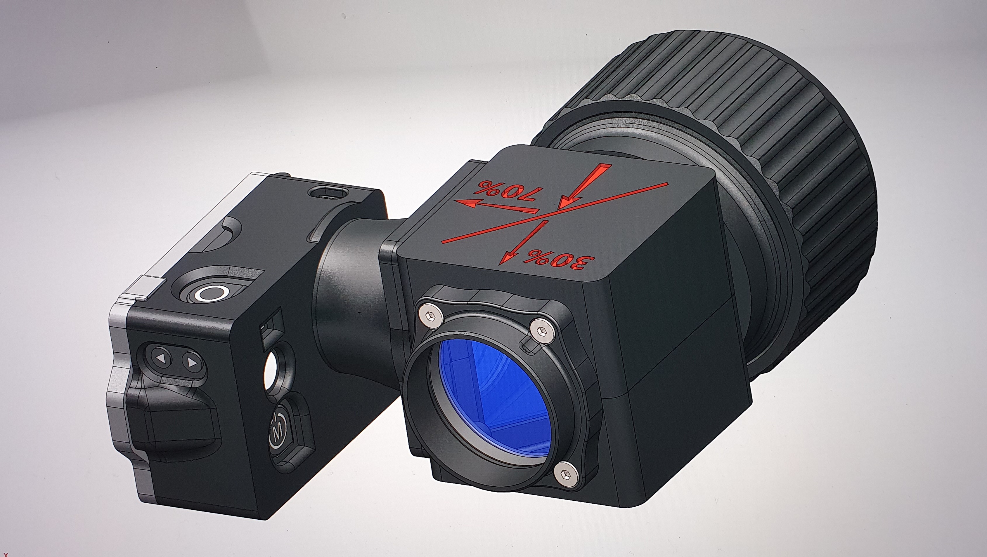

Why are you so against the traditional scope cam... A scope camera system with 70/30 light distribution and even a cheaper Firefly 90se is superior in recording quality to Pard and those more expensive systems. Even the proff. Youtubers uses scope cams with a Gopro (With modified lens)
I designed a cheap DIY scope camera system that you can 3d Print and buy all parts for at a price of 50 USD. Additionally you have to buy a Firefly 8 SE 90 degree lens. or a Gopro 7 and a new 12 mm Tele lens. Of course it is also possible to purchase a Gopro 10-11 or higher and buy a new Lens for that too, but I haven't designed a camera house for any of those yet. Main difference is that the Gopro 7 Black edition (Old) can do 1080 at 240fps and from Gopro 10 and up they can record 2,7k at 240 fps.
See more about "the free scopecam" here:
Footage with Firefly 90 degree 8se:
Footage with the Hero 7 Black:
The best designed system to buy is Eaglevision
Orion is also doing a system.
I have both a Eaglevision and my own design "The Free Scopecam" and I cannot see any differences in the recordings between my DIY system and the Eaglevision system.
But equal for all is the scope camera system must be adjusted right and Parallax settings too. Best is to shoot with glasses so you don't need to compensate for Parallax - The scope camera does not have week eyes :)

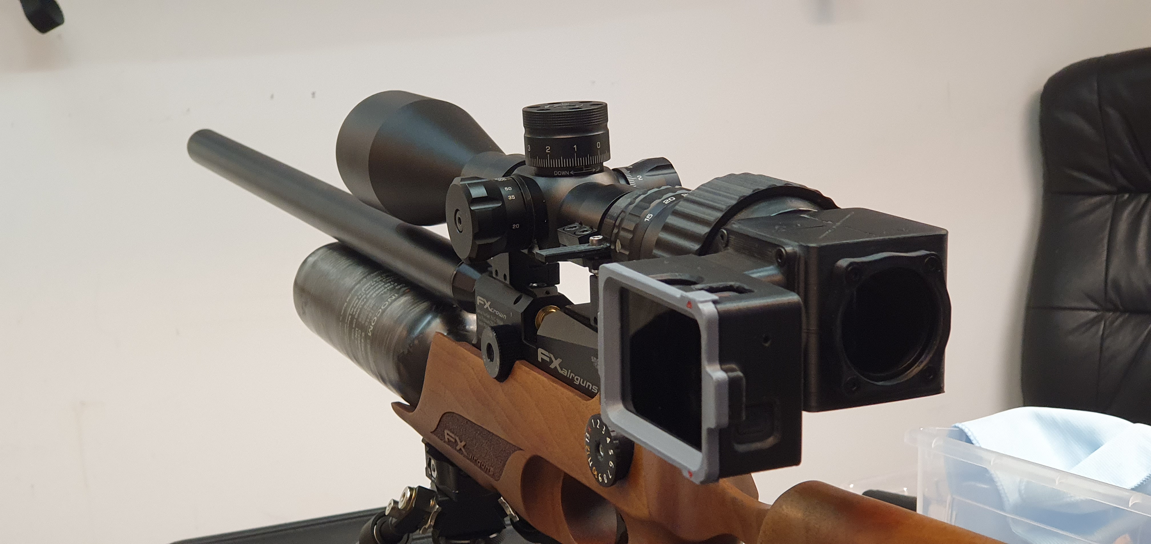

I had a day of tinkering what for I could use a scope cam, and now I have a Question:
- instead of a side shot (with a mirror box) what would be a best camera mounting option straight inline with the scope? eaglevisioncam + Firefly or not... I can aim to target with the camera screen ;)
I don't hunt, I just want to see a slowmo only at what tune speed the pellets/slugs start corkscrewing.

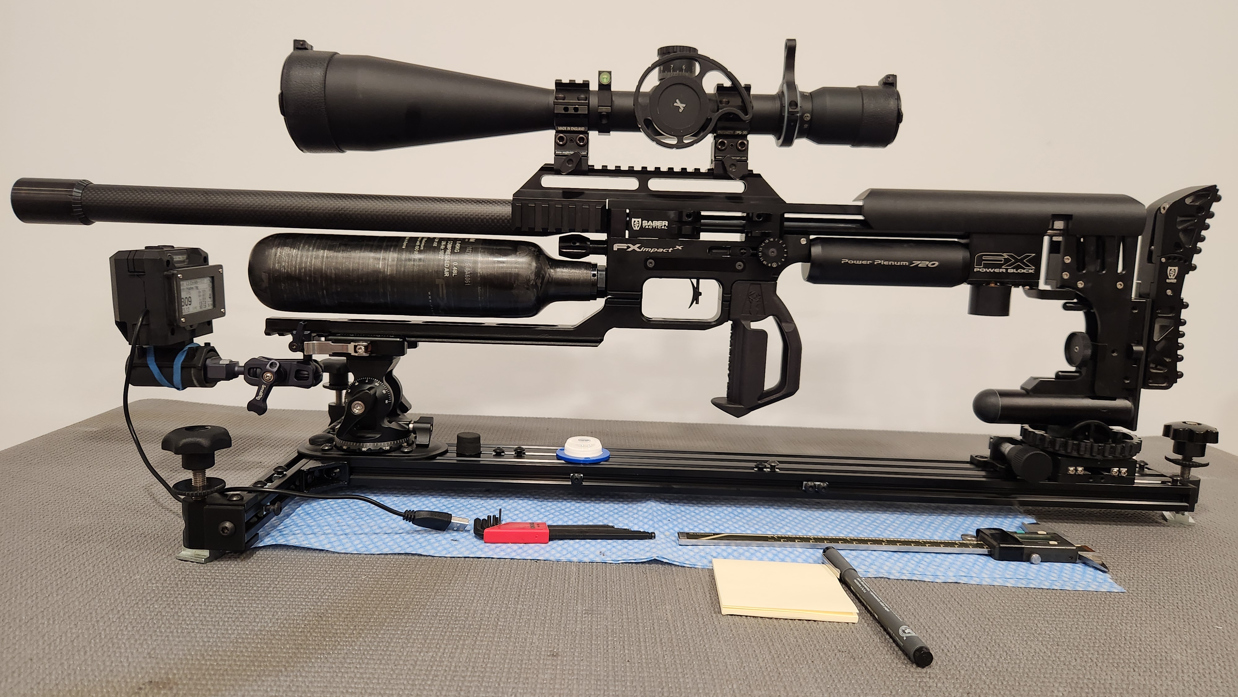

I have a one-piece rest for shooting from bench and especially the tuning aspect is a very different ball game with these ;) (old picture but just to have a visual).
With this rest I learned a technique sitting behind the gun, and if the camera would be mounted there I assume even more comfortable.

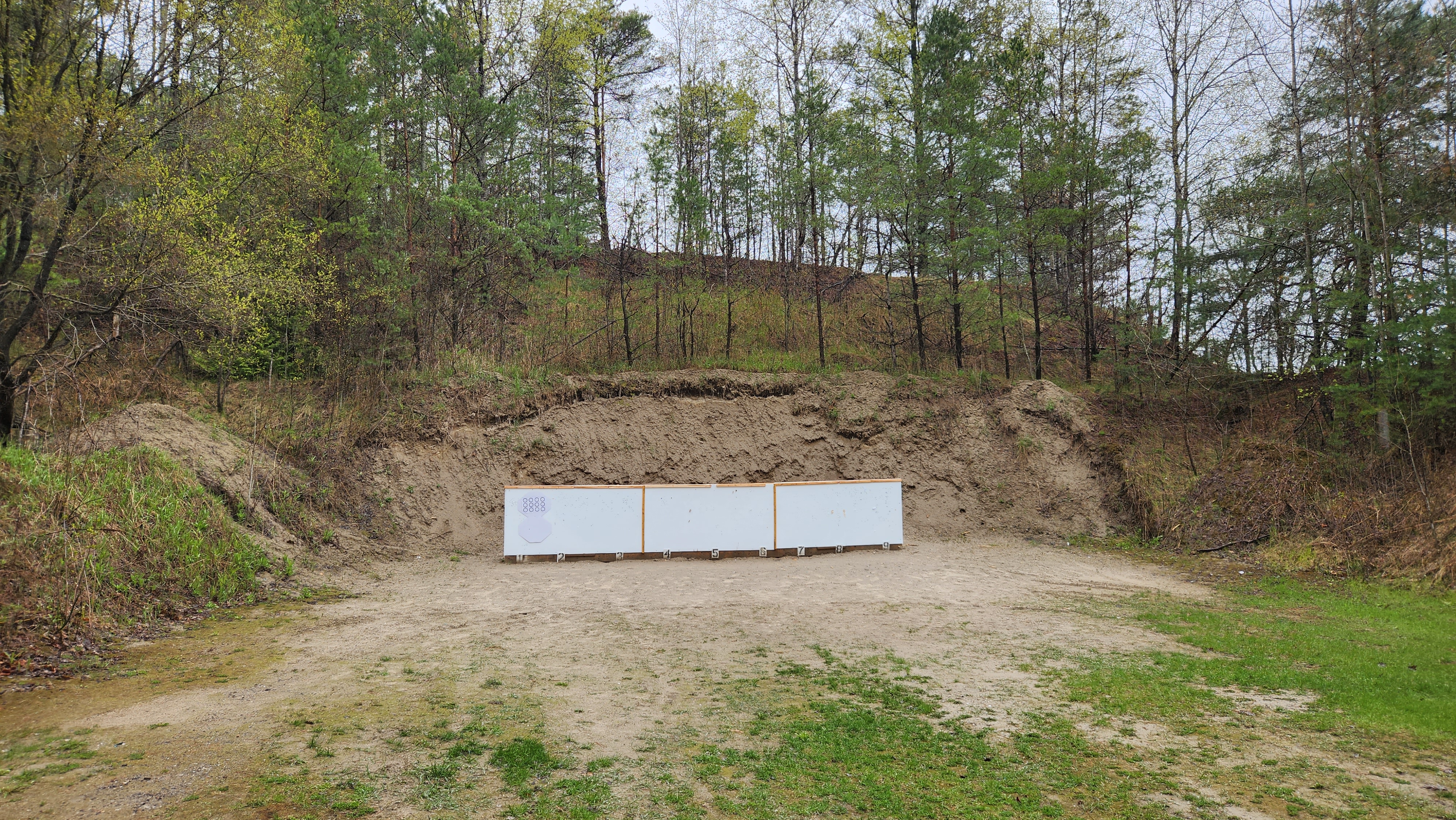

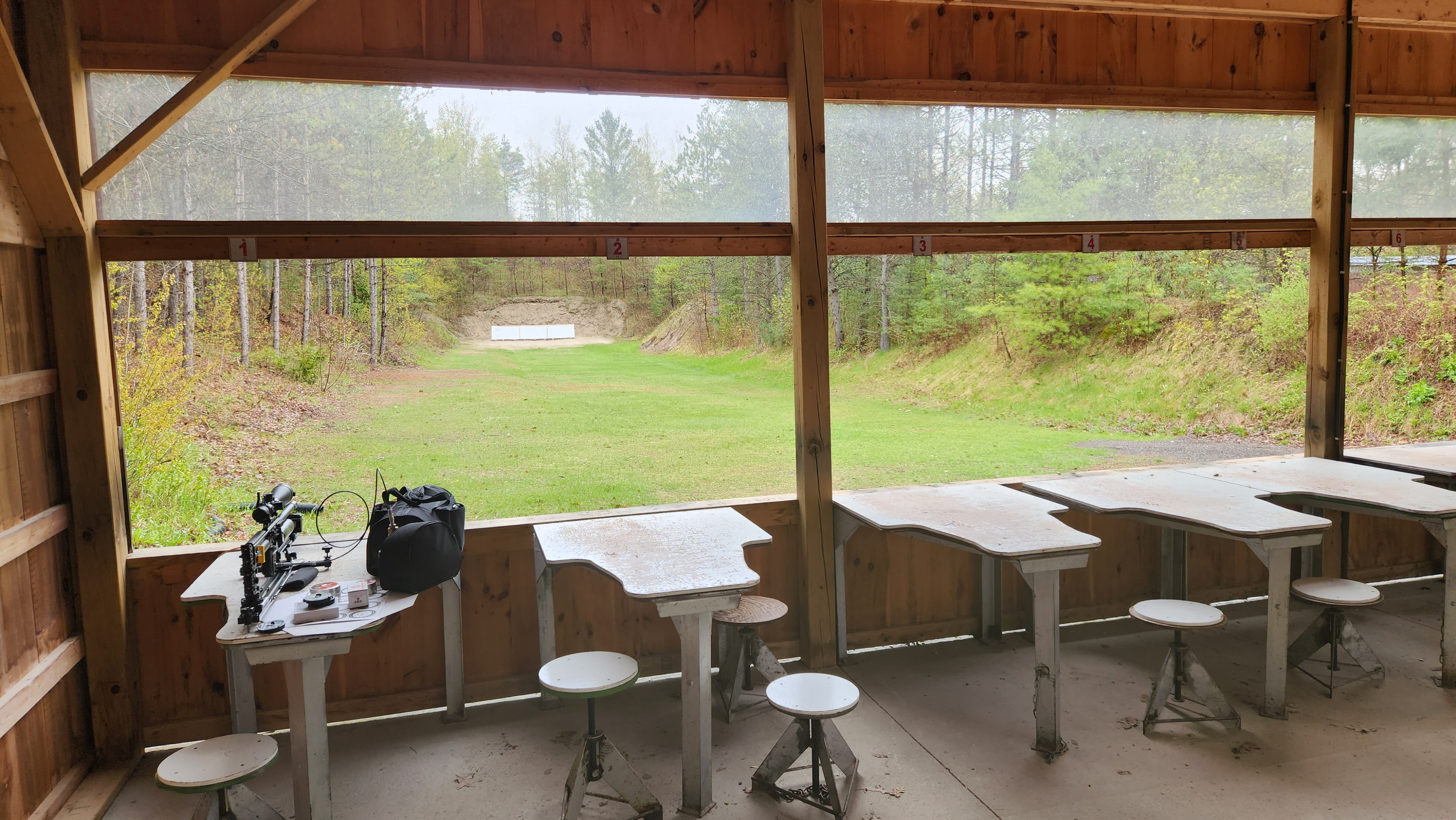

I was thinking about focus as well.... At my 100 meter range the backstop is a big white panel,, and luckily no light is coming from behind my neck,, windy yes and that can make a mess on the rings :)
This my target scope has a very fine focus range up to 55 meters (many people like to use it for FT). If I would set a focus @75 for example and a zoom at about 25-35 that would give me a big white background and a pellet flying towards...
