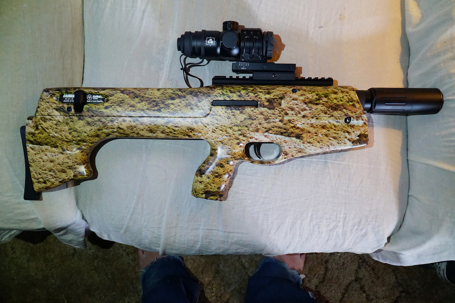

I see you mention a dip. I dip alot of things, and I'd strongly suggest not dipping wood or a full stock for your first foray. If you must dip, find a sacrificial stock and practice alot. Otherwise be ready for alot of attempts and re dips, unless it's a pretty abstract blotchy pattern where exact transfer is not that important.
I was looking at some techniques for dipping after this post the other day. I can definitely see how it can go wrong in a hurry, especially with larger size items
The one nice thing about dipping though is generally, if you mess up you can just re sand, re prime/paint and re dip.
If anyone wants to try an entire stock though, I'd suggest dipping one side at a time. Doing the whole stock in one go is not for the faint of heart and it usually ends up buggered.
Reactions: Hold_Over
Again...don't forget "vinyl" wraps.
Lots of pattern and color variations to choose from.

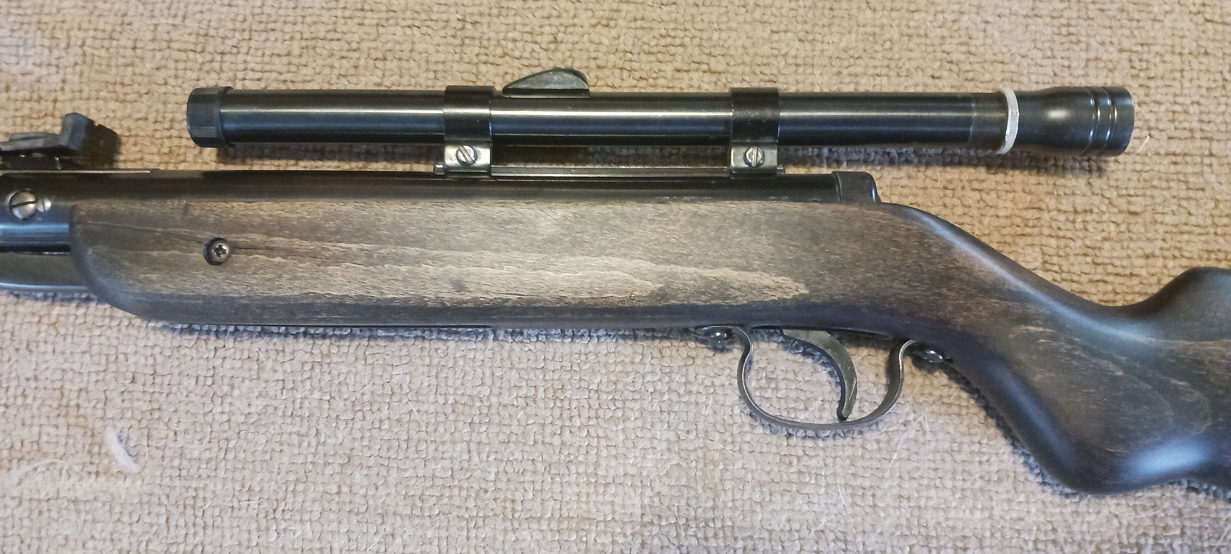

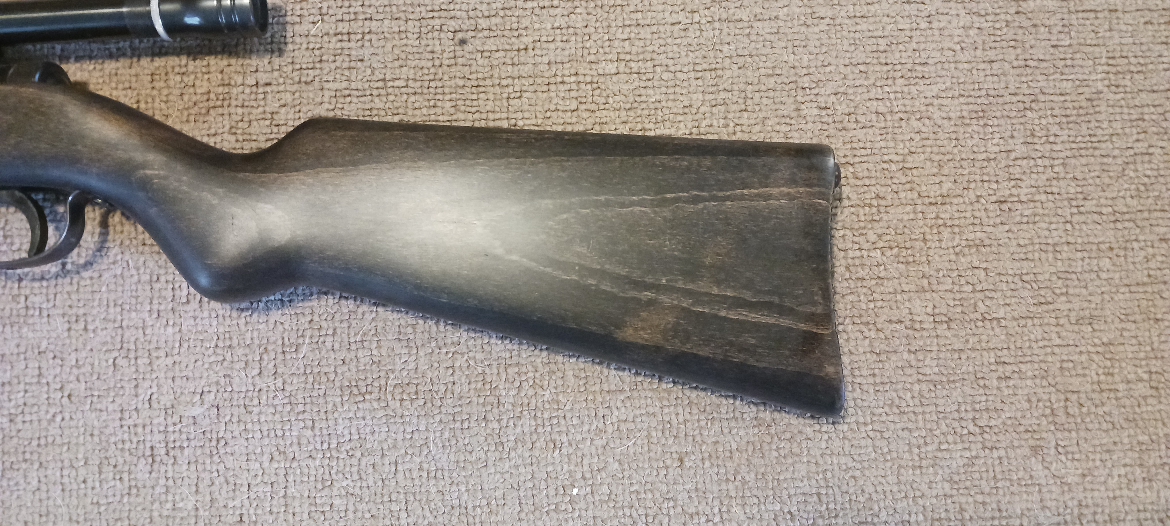

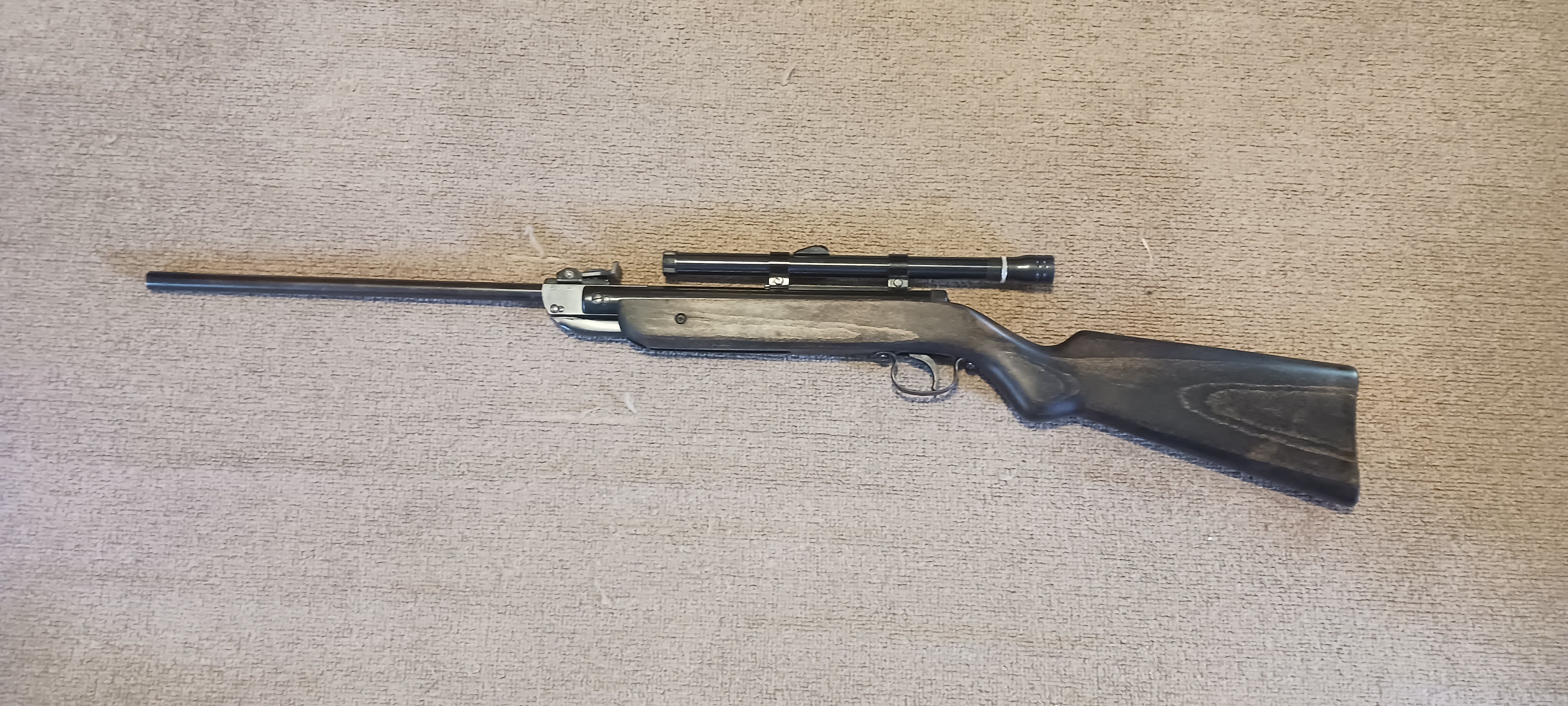

I sprayed a coat of flat black primer on it and sanded back with 600 wet to find my low spots. Tons of them, so I will be sanding it down again with 80 and back up. I will try a grain filler/sealer and some oil or dye after that. The down time is killing me since this has been my go to starling gun as of late.
I did however swap the spring and tried it over the chrony to see what it'll do. Just a .038 spring and a shim brought it up from 16 fpe to 22 fpe. Still super quiet, but now it's not as accurate with its original preferred pellet. It likes baracuda match now. Need to try JSB 18s, but it hates the hades now. Shot guns them at 15 yards.
