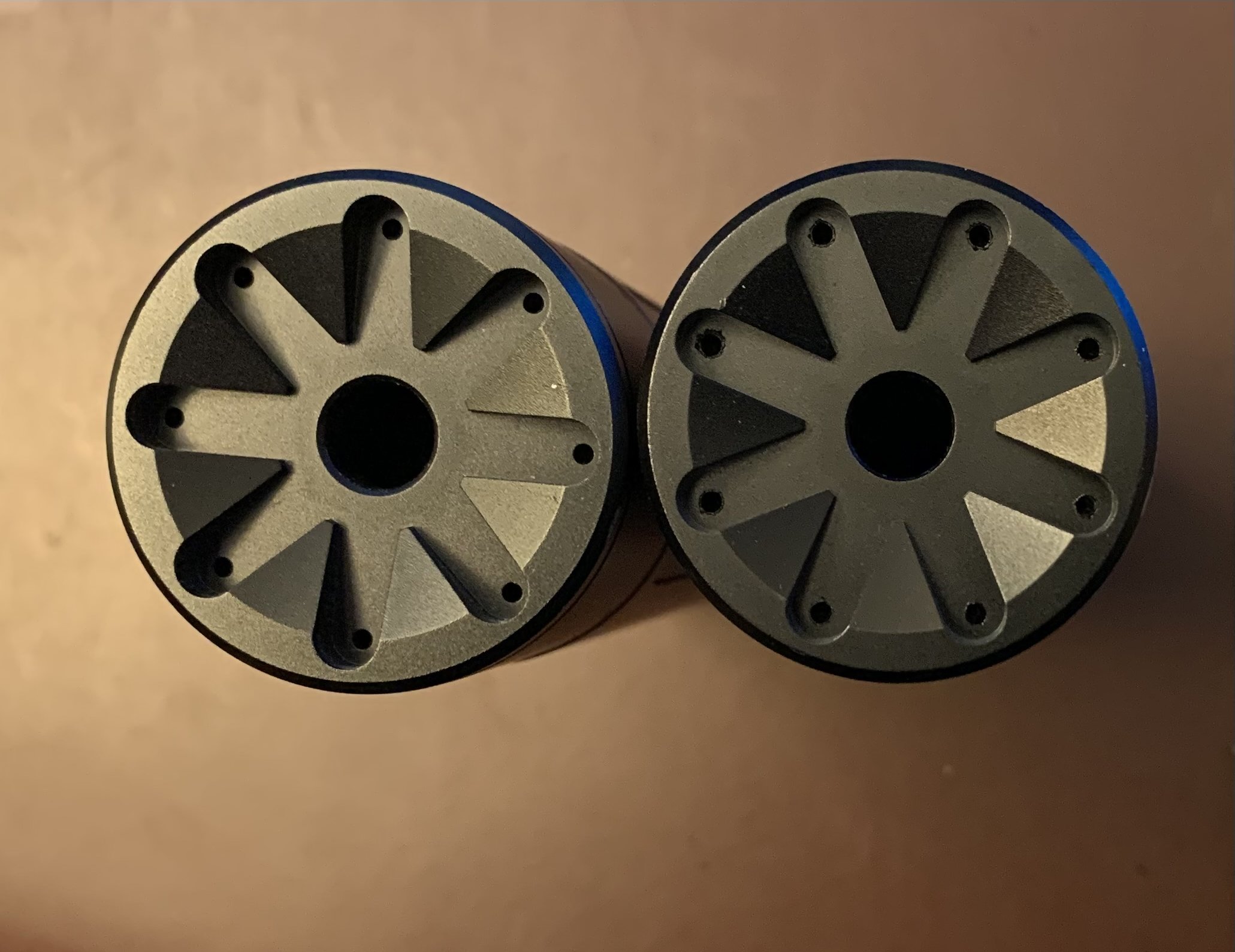

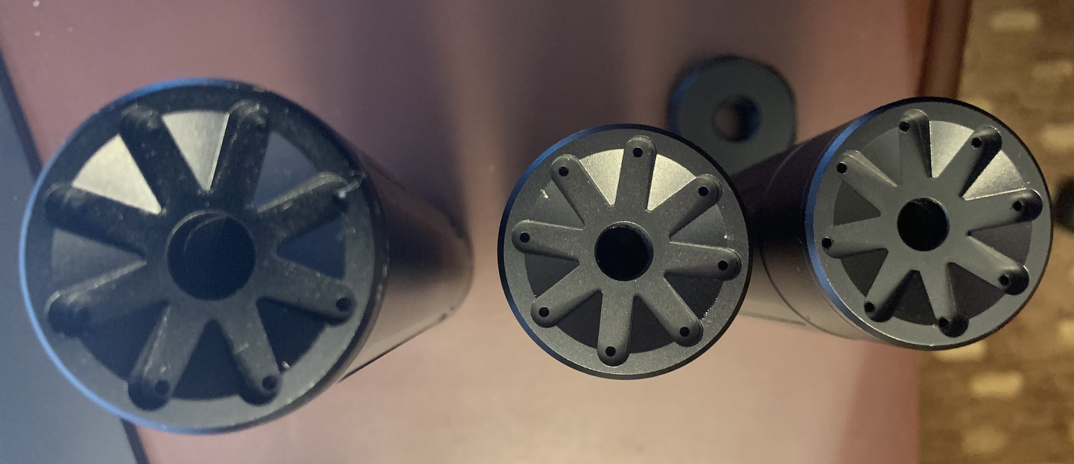

About six months ago or so, I purchased a Donny FL Sumo from a member. The listing said the moderator was .25 - .30. The front hole seems way too small for that, and the suppressor is marked "Sumo," but inside the cap there is no caliber marking, unlike the others I own which all have this.
I asked the buyer, and he said he used it as a .25 for sure--but I have doubts, going by the hole sizes I have with clearly marked suppressors.
I have several Donny FL suppressors, and the hole where the pellet exits is smaller than my .22 - .25, let alone my .25 - .30.
I am including three pictures of three suppressors. From left to right are a .25 - .30 Shogun, a .22 - .25 Sumo, and the Sumo under question. To my eye this Sumo on the right is either a .22, a .177 - .22, or a .177 - .22. But those are guesses.
I don't want to learn anything the hard way here.
Can anyone weigh in?

Do you have a pair of calipers?
Measure it and it would answer your question.

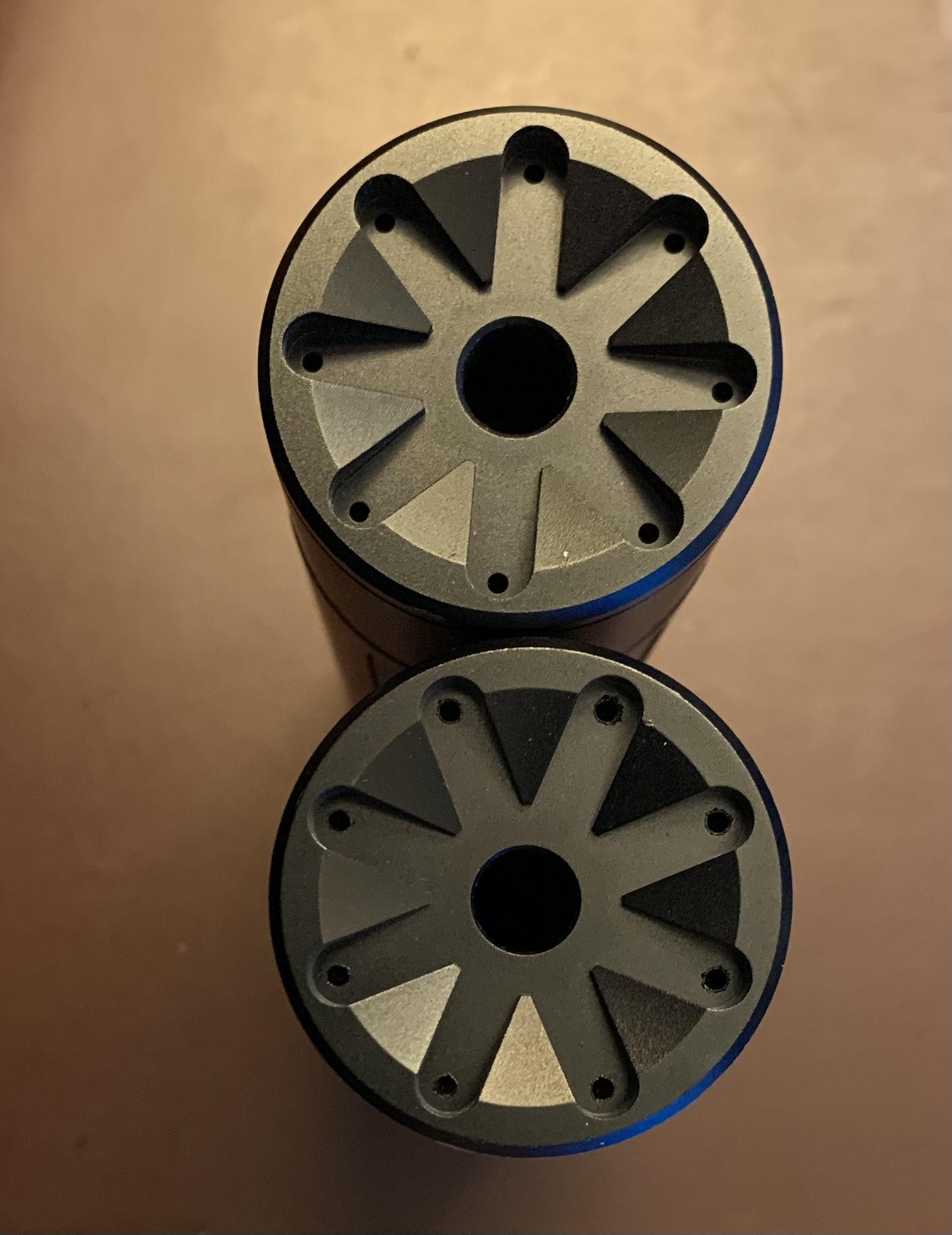

Okay. Due to the brilliant common sense advice I received, here are some results of the dimensions of four Donny suppressors:
  • Shogun .25 - .30 = .36 inches
  • Sumo .22 - .25 = .32 (or 33) inches; I guess my hold with the calipers is not quite consistent
  • Sumo unmarked (the smaller hole) = .30 (or 31) inches (the same)
  • Donny FL .25 - .30 = .35 inches.
I am guessing the unmarked Sumo is either a very tight .22 - .25, a .177 - .22, or a .22. It is hard to know definitively what it is.
I have included a better picture of the marked .22 - .25 Sumo and the unmarked Sumo (on the right). Now the width difference is more clearly seen.

The unmarked one also has a different thickness on the outer lip where the relief holes are.

I just took them out and looked at them. I am not sure what you are referring to. They look pretty much the same off camera. Thanks. S7
If that was a mod I built I wouldnt call a hole .060 over bore diameter of .250 a tight fit .25. I regularly keep my holes within .025 to .030. If that mod was made square and the barrel that its going on has a square shoulder to bore there is no reason it cant be used on a
If that was a mod I built I wouldnt call a hole .060 over bore diameter of .250 a tight fit .25. I regularly keep my holes within .025 to .030. If that mod was made square and the barrel that its going on has a square shoulder to bore there is no reason it cant be used on a .25.

I read your post wrong I thought you said you got .310. If you got .300 then its .050 over a 25 cal pellet. Still plenty of room. I added my comment about where I set my pass thru hole size to illustrate .050 over bore is plenty if the mod is built straight and the barrel has a square shoulder to the bore.
My unmarked Sumo's exit hole measures 0.312" and I use it with .25 cal. Hope that helps.

Okay. Help me out here a bit further, please. I know something about calibers, but not the kinds of details you are involved with. I now get the math, but how is something like a .300 hole the right size for or .25 pellet? That's .050 over the pellet size, right? Unless the obvious is eluding me: the .050 is simply the amount of space needed to insure proper exiting of the pellet without contact? Did I answer my own question? Thanks.

Yes thats the basics of it. I build my mods to have .010 - .015 of clearance per side giving a total of .020 - .030 clearance. So my personal mods would measure .270 - .280 for a .25 cal. I can build them with tighter holes cause its a one off and I have the rifle in hand and know if the shoulder on the barrel is true enough to not clip pellets. If its not true I have the equipment to re machine the thread tenon and shoulder on the barrel to make it true. People who make mods for the masses have to give a little more room incase the rifle it goes on was not cut perfectly true.
