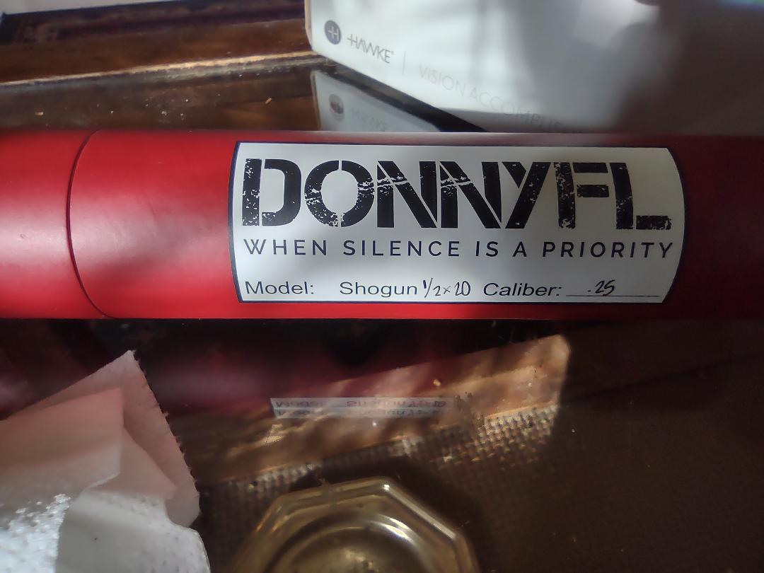

What size is this Donny FL?
Okay. Due to the brilliant common sense advice I received, here are some results of the dimensions of four Donny suppressors:
  • Shogun .25 - .30 = .36 inches
  • Sumo .22 - .25 = .32 (or 33) inches; I guess my hold with the calipers is not quite consistent
  • Sumo unmarked (the smaller hole) = .30 (or 31) inches (the same)
  • Donny FL .25 - .30 = .35 inches.
I am guessing the unmarked Sumo is either a very tight .22 - .25, a .177 - .22, or a .22. It is hard to know definitively what it is.
I have included a better picture of the marked .22 - .25 Sumo and the unmarked Sumo (on the right). Now the width difference is more clearly seen.
Thanks again, MEC.
S7
Given these measurements and crunching the numbers suggests the unmarked Sumo is probably a .22 caliber or an extremely tight .25. If I were you, I'd call it a .177/.22 and treat it like that. I just put four Ember's together with 1.5mm clearance over the caliber (which is about what it looks like DFL is using on those other three) and one of them clipped because I was testing them on a shrouded gun.
Call it a .22.
A while ago, I did put a .25 pellet in it to check things out. I think it fit but was stuck a bit. I was tentative because I didn’t to gaff anything up trying to dislodge the pellet if it went deeper. Thanks. S7
How could a .25 pellet stick a bit in a .30 hole? I realize that it is probably on the tight side to prevent clipping if shot, but for just trying to fit a pellet through? Something seems off . . . .
Thanks for chiming in. What red tube? Are you referring to a moderator you have?
Also, my calipers only do one-hundredths. S7
The tube they come in, no markings on the dfl shogun (inside or outside the moderator ).
