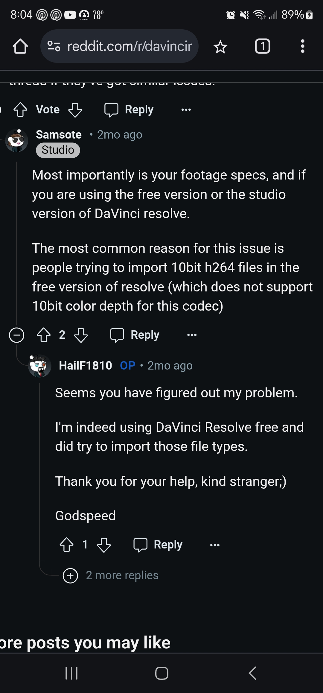

That is not the free version as I understand it. It could also be an issue with color bit depth.

Looks like Reddit has a decent DR subreddit.... according to some users there, the free version has a max frame rate of 60 fps. But someone mentioned a similar scenario as the OP, and the response was it could be a CODEC issue......
