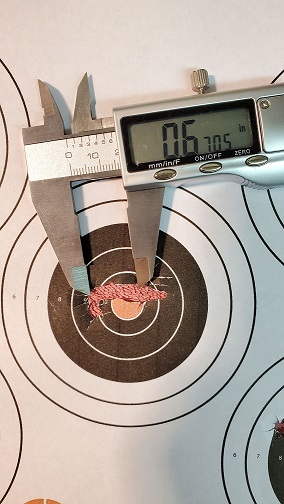

HI my Edgun R5 shot best with my cast 48 and 52 grain slugs around 92 fpe so like 900 to 920fps

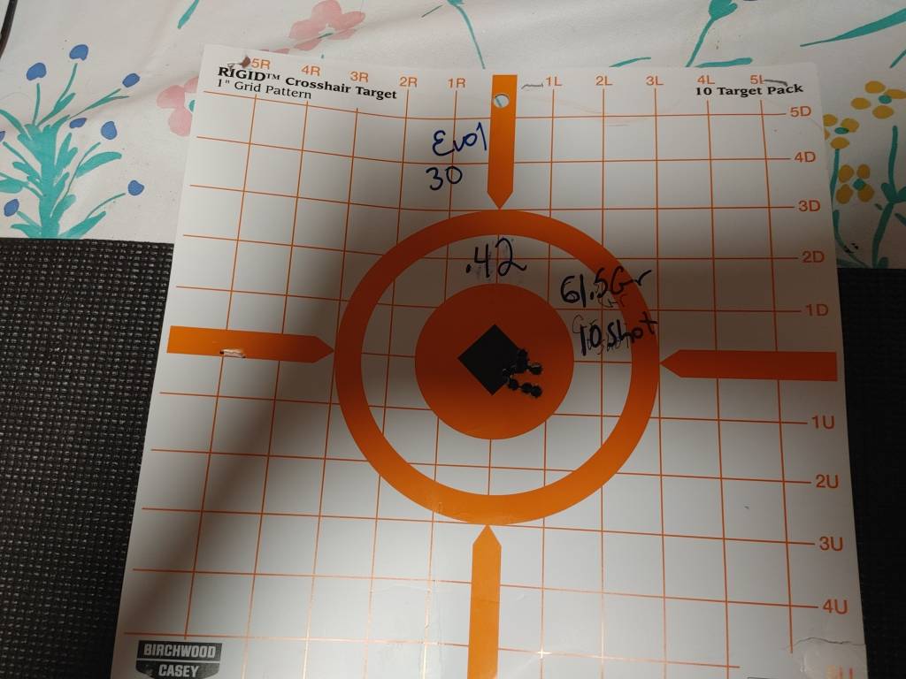

my evol shoots best with61 gr to 66 gr slugs at about 100 fpe I can push it higher but then harmonics and shot count suffers

both guns shot 1 moa or better ,
here is a group i shot last week , off a tripod in about 10mph wind standing 100 yds I am sure with no wind and shooting prone with bipod and a bag or seated in a sturdy table with no wind it would be much better
