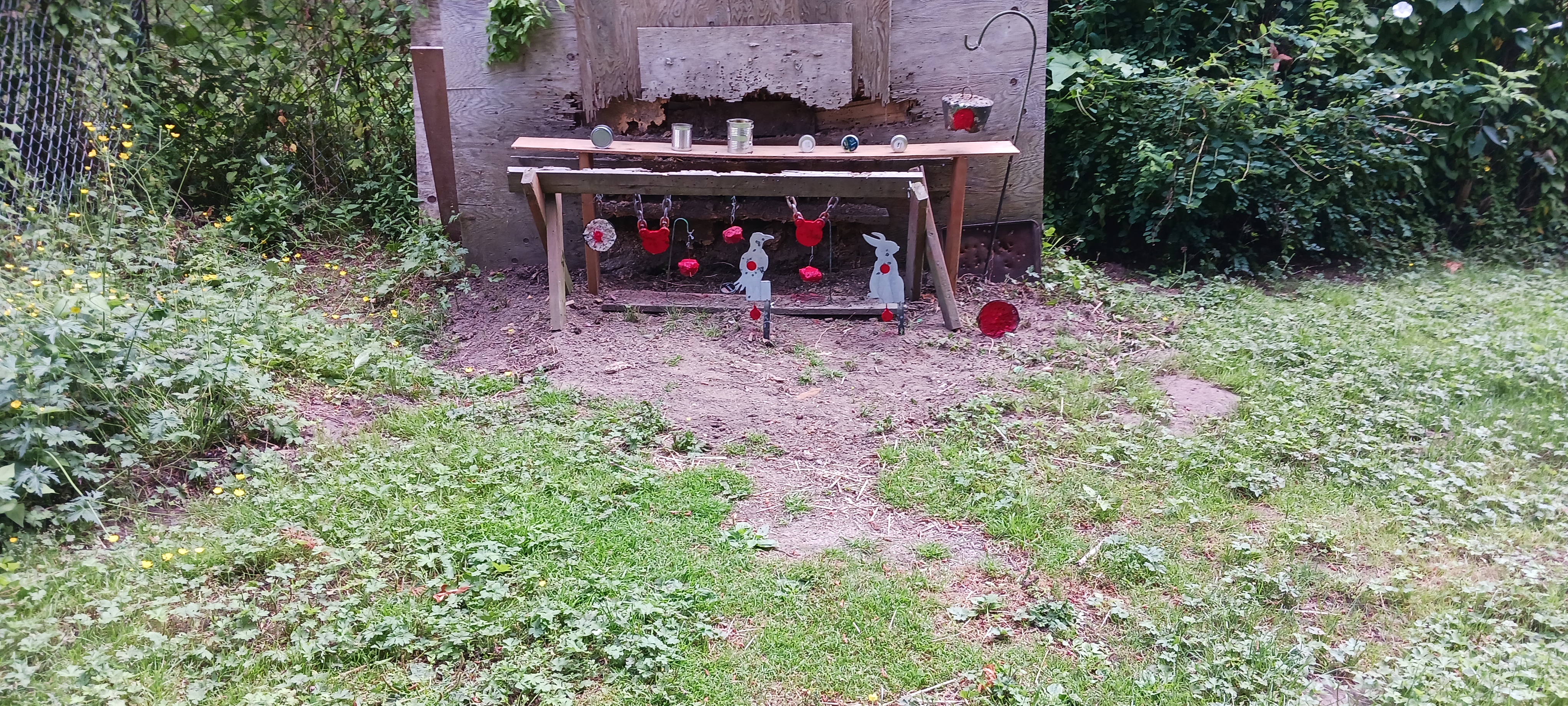

Decided to bring my Diana 34 TO5 Classic in .22 to work to shoot in the yard over my lunch break. Its lightly tuned at 740 fps with RWS superdomes. I replaced the sights with spare set off an HW77 which required a little fitting and filling with some JB weld. I also spent a lot of time getting the trigger just right. With the irons and the elongated wood on the forearm I think its quite a nice piece. I now love putting my finger in Diana and popping cans at 40 yrds!
Crowski, that looks like a really fun range!
I’ve got targets at 25, 30, 35, 42 and 47 yds. Rain or shine. Crow

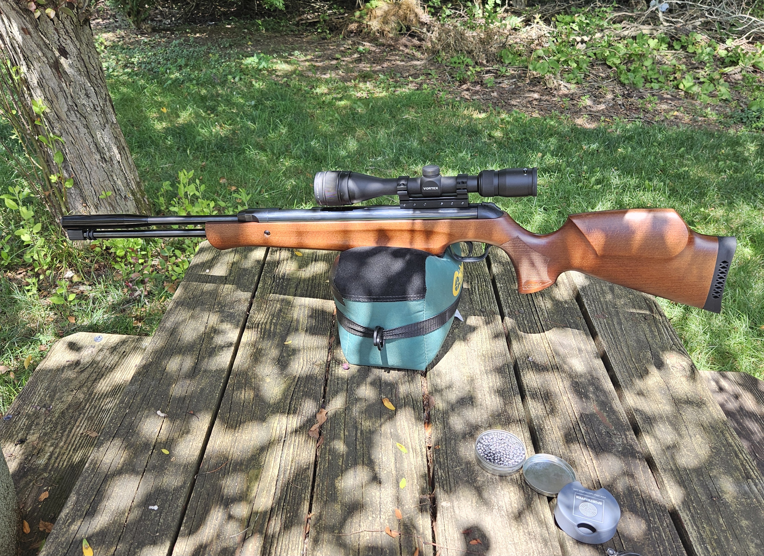

Yesterday plinking with the HW95L.
Pellet Rifle performance data results (6/27/2024)
Shot NumberPellet Weight (Grain)Speed (FPS)Speed (MPS)FPE (450240)FPE (450436.7)JoulesRange (FPS)
114.66720.0219.516.8816.8722.88713 Low
214.66713.0217.316.5516.5522.44723 High
314.66716.0218.216.6916.6922.63
414.66716.0218.216.6916.6922.63
514.66721.0219.816.9316.9222.95
614.66719.0219.216.8316.8322.82
714.66715.0217.916.6516.6422.57
814.66716.0218.216.6916.6922.63
914.66719.0219.216.8316.8322.82
1014.66723.0220.417.0217.0123.08
Mean ValuesGrain
14.66
FPS
717.8
MPS
218.78544
16.7816.7722.7Spread
10

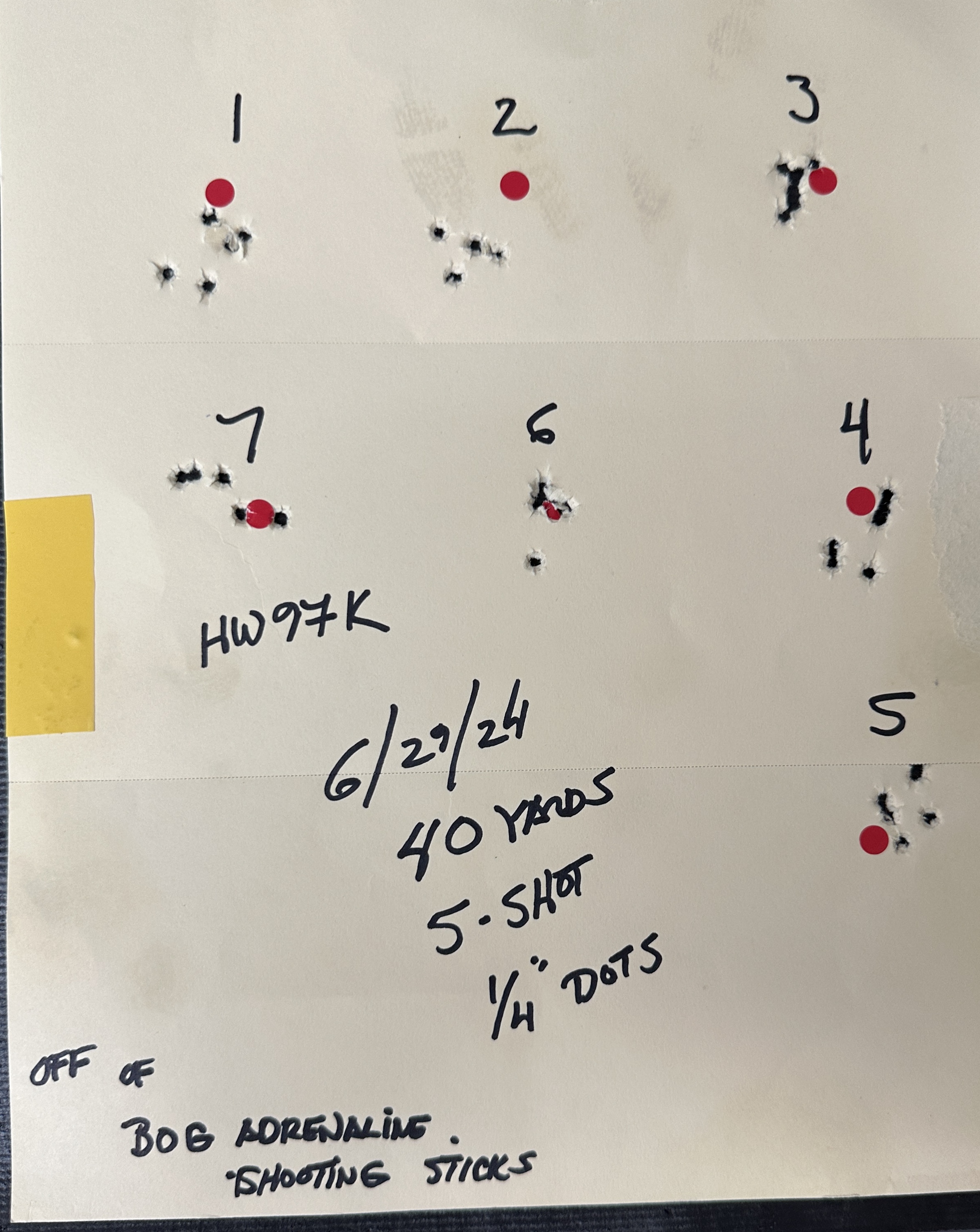

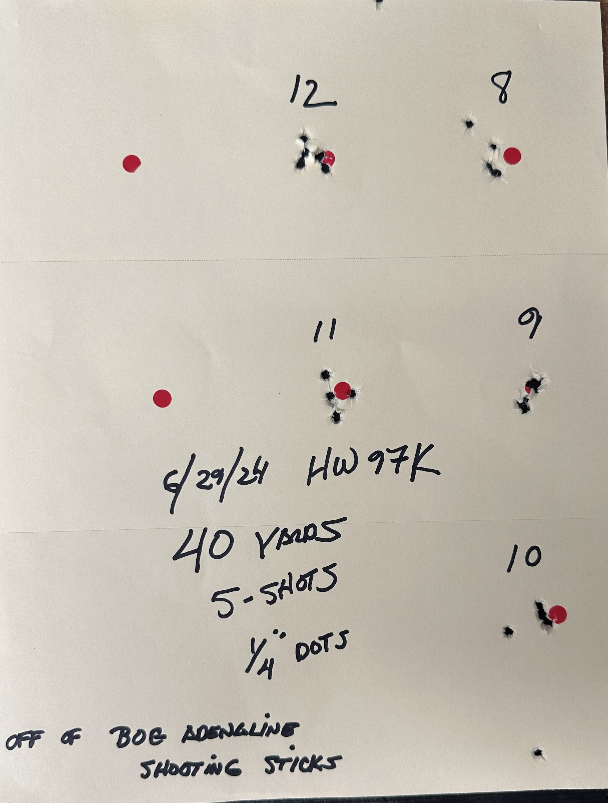

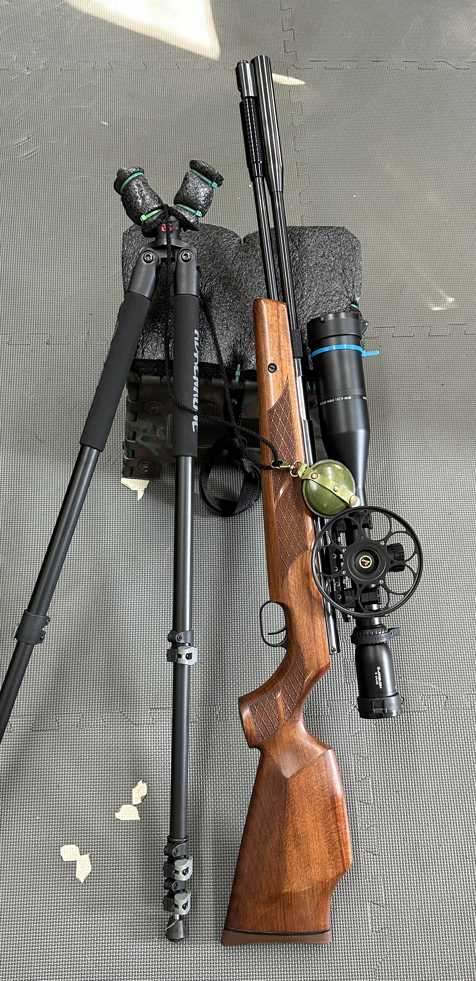

Prosport is torn apart, so I mounted up the Midas Tac on the 97K. I haven't shot this rifle in several months so it took a few groups to get back in the groove. They started out wide but tightened up as I went. Groups shot in order 1 thru 12 at 40 yards off the sticks.

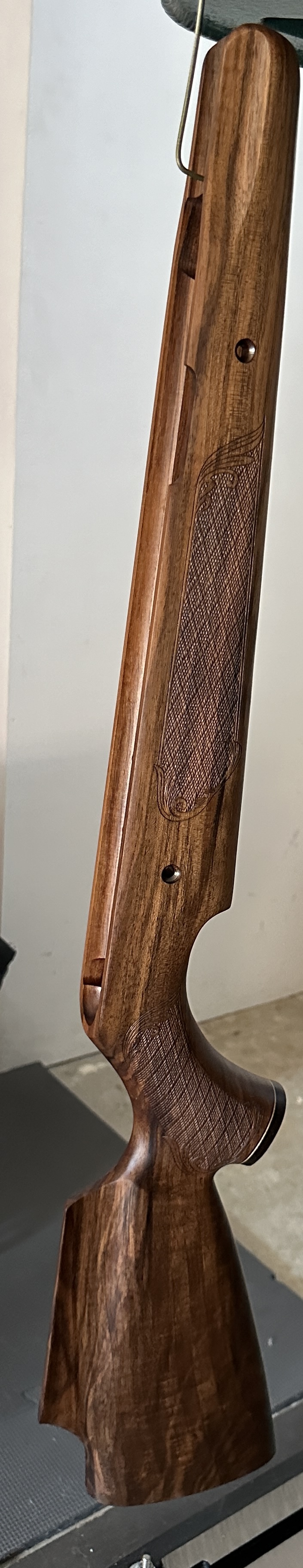

Prosport stock gonna hang till next Saturday, while it soaks up the sixth coat of tung oil....

Damn that looks good. Crow

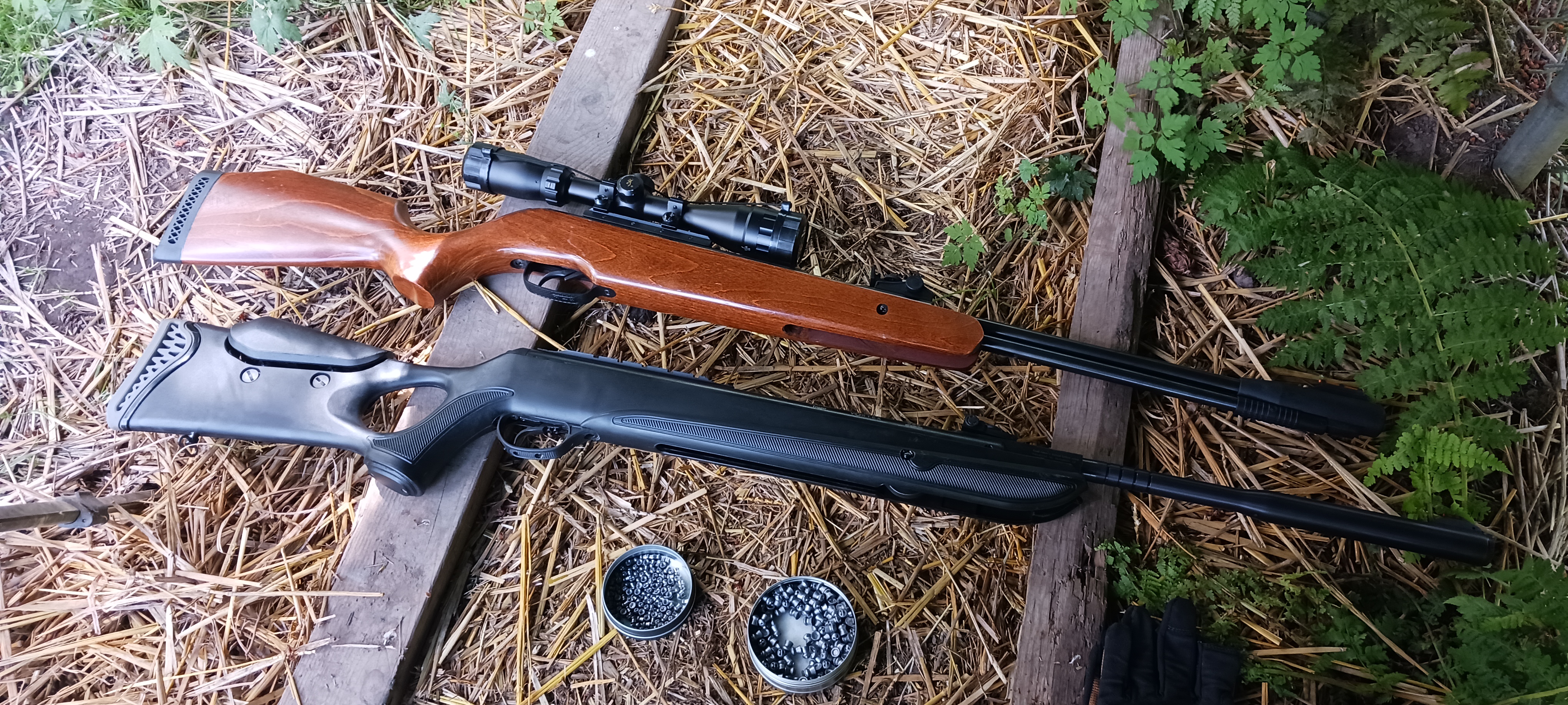

Took a break from the vintage classics, and went with modern cult classics today.
Walther LGU .177 that has been tinkered with.
Transfer port drilled to .136 or 3.45mm with a #29 drill.
Bronze thrust washer added to factory tophat , TX200 spring, factory rear guide and thrust washer.
Averages 781 with H&N FTT pellets for 11.7 ft. lbs.
The mods totally changed the nature of the rifle from box stock form. Solid abrupt shot cycle with no twang, resonance or undue vibration. In stock form with the small transfer port, the rifle was harsh and exhibited a lot of piston bounce.
Assuming I do my part, the rifle is now a ringer.
Walther LGV Master that has also been tinkered with.
Fitted with a HW97 spring, factory rear guide and tophat used and thrust washer added to the tophat.
Once again, the mods totally changed the nature of the rifle from box stock. Not that it was terrible, but still exhibited some resonance and piston bounce.
The shroud was made from the barrel shroud from a Remington NPSS rifle. The rear piece was bored to slip fit over the Walther barrel O.D., the main tube was cut to length and the front end baffle was used as issued. Main part of shroud body had good quality shrink tubing applied for purchase while cocking, and has held up well for several years now.
The shroud, while being aluminum, does slightly tension the barrel, does away with the noodle barrel look, and gives a decent grip while cocking
Both triggers are factory stock Walther units that benefitted from stoning, polishing, and longer adjustment screws added. While they still have the lonnngggg first stage typical of the longer screw mod, it does not bother me enough to order a Rowan unit.
Shout out to Hector Medina of Connecticut Custom Airguns for his blog that details all of the mods that I did to both rifles. The shroud was my idea, not Hectors though....

Nice work, I like the shrouded barrels, always liked the HW98 look also. Working on the rifles is half the fun IMO.

Very nice guns. Been sniffing around for both those guns, hopefully one day. Have an LGU Varmit, one of my favorites. Crow
