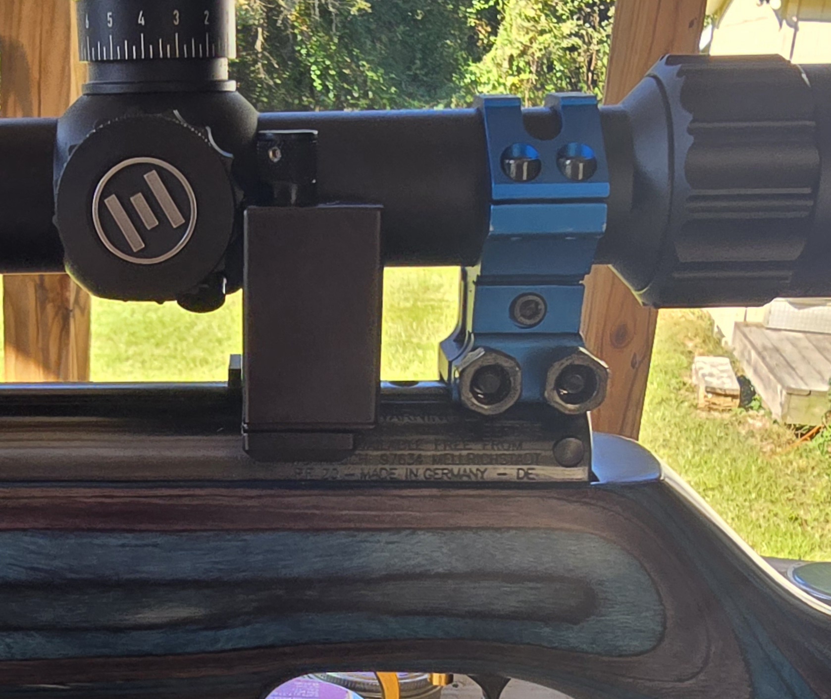

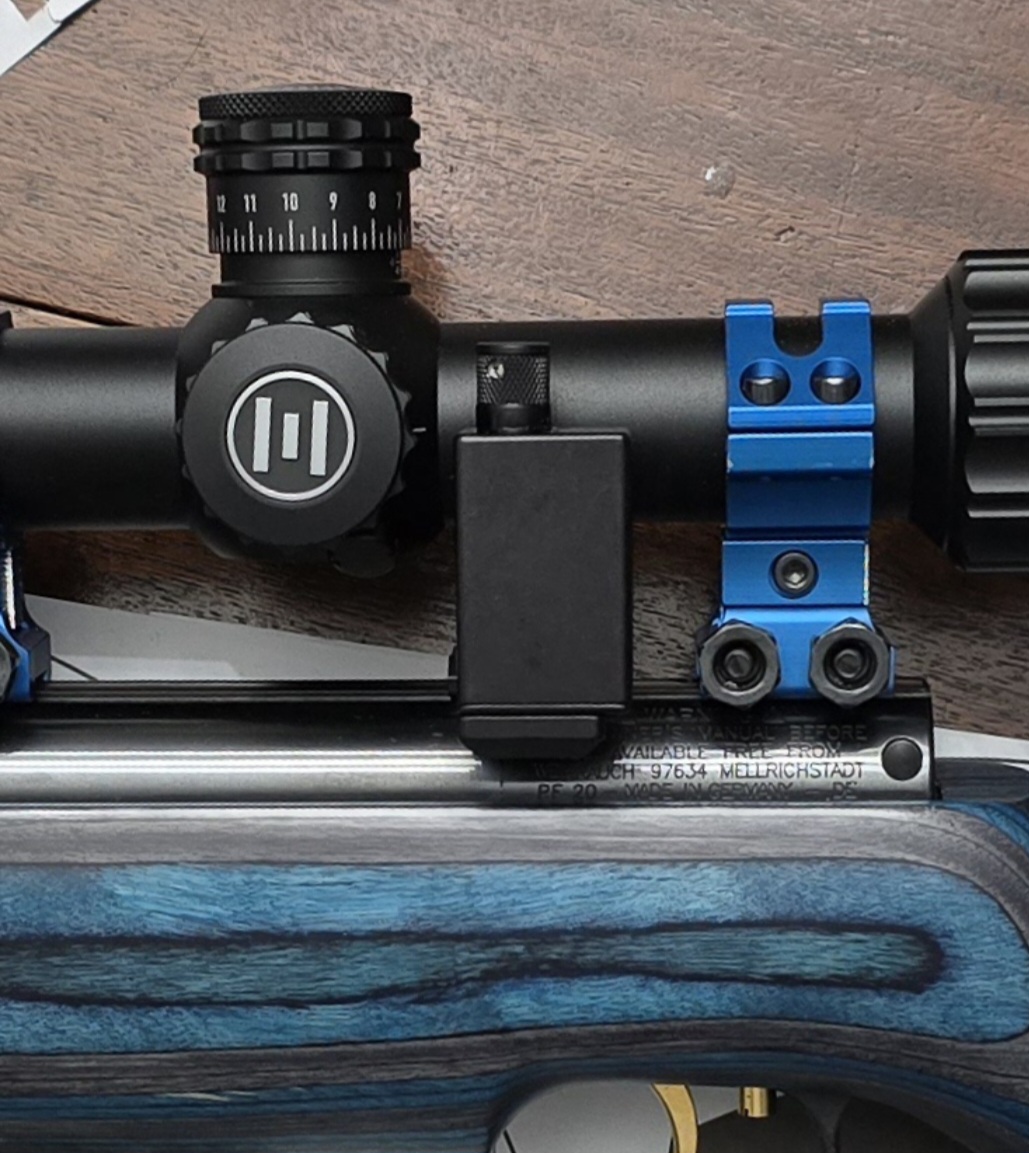

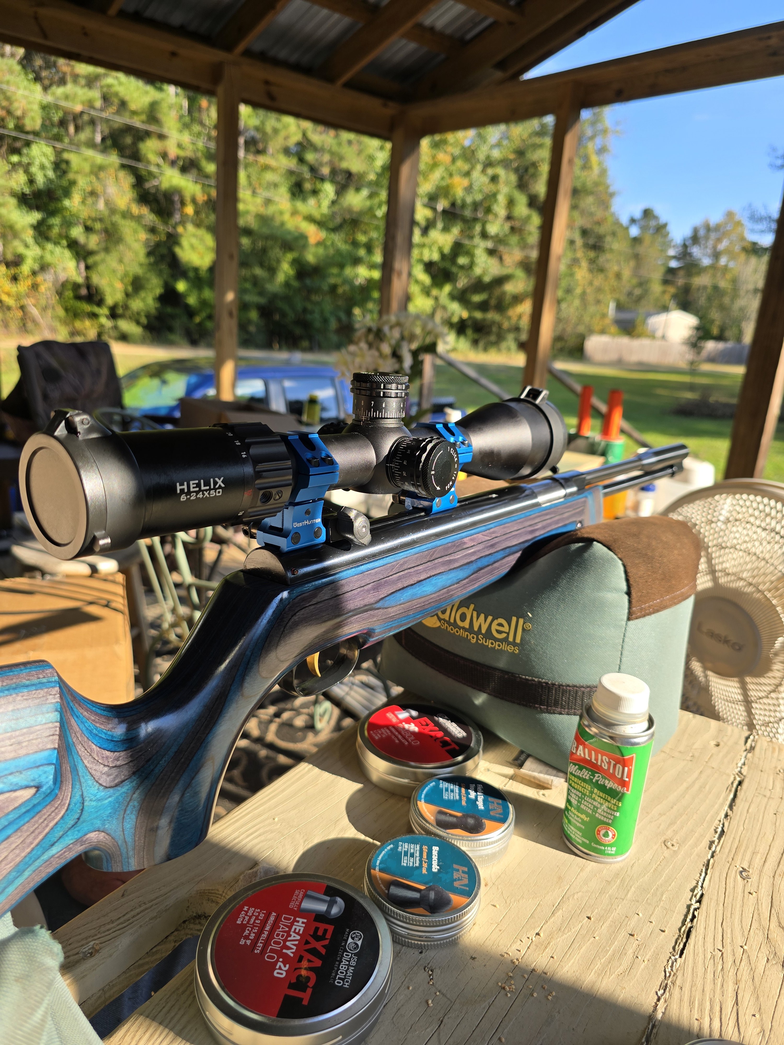

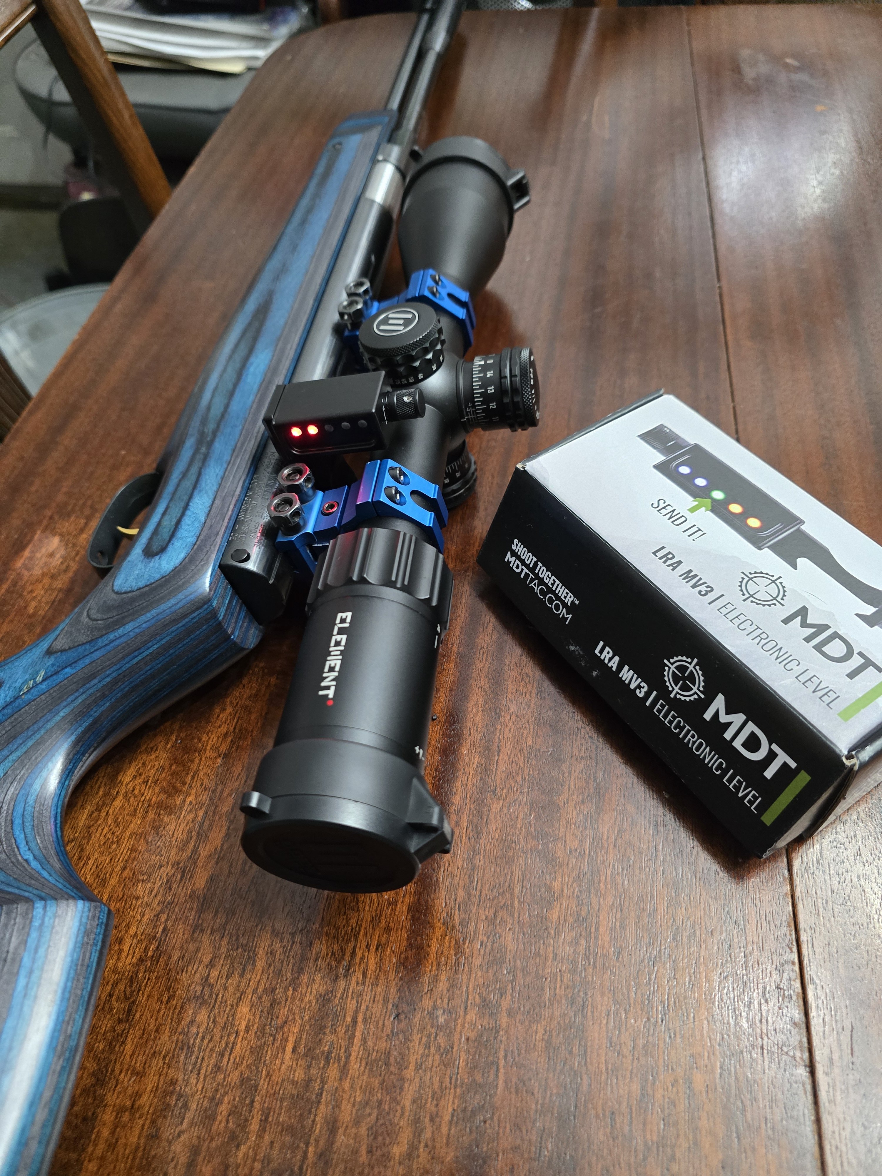

Sad to say it, but my Element Helix FFP failed possibly due to springer recoil. Time to test the warranty unfortunately. The ocular lens came loose with about 10 moa of movement when you wiggle it.
I mounted the Element Helix SFP and continued on
I mounted the scope and butted the scope level against the rear ring to monitor any slippage, and it was moving, so I reset and put a little more torqe on the rings. So far, so good.

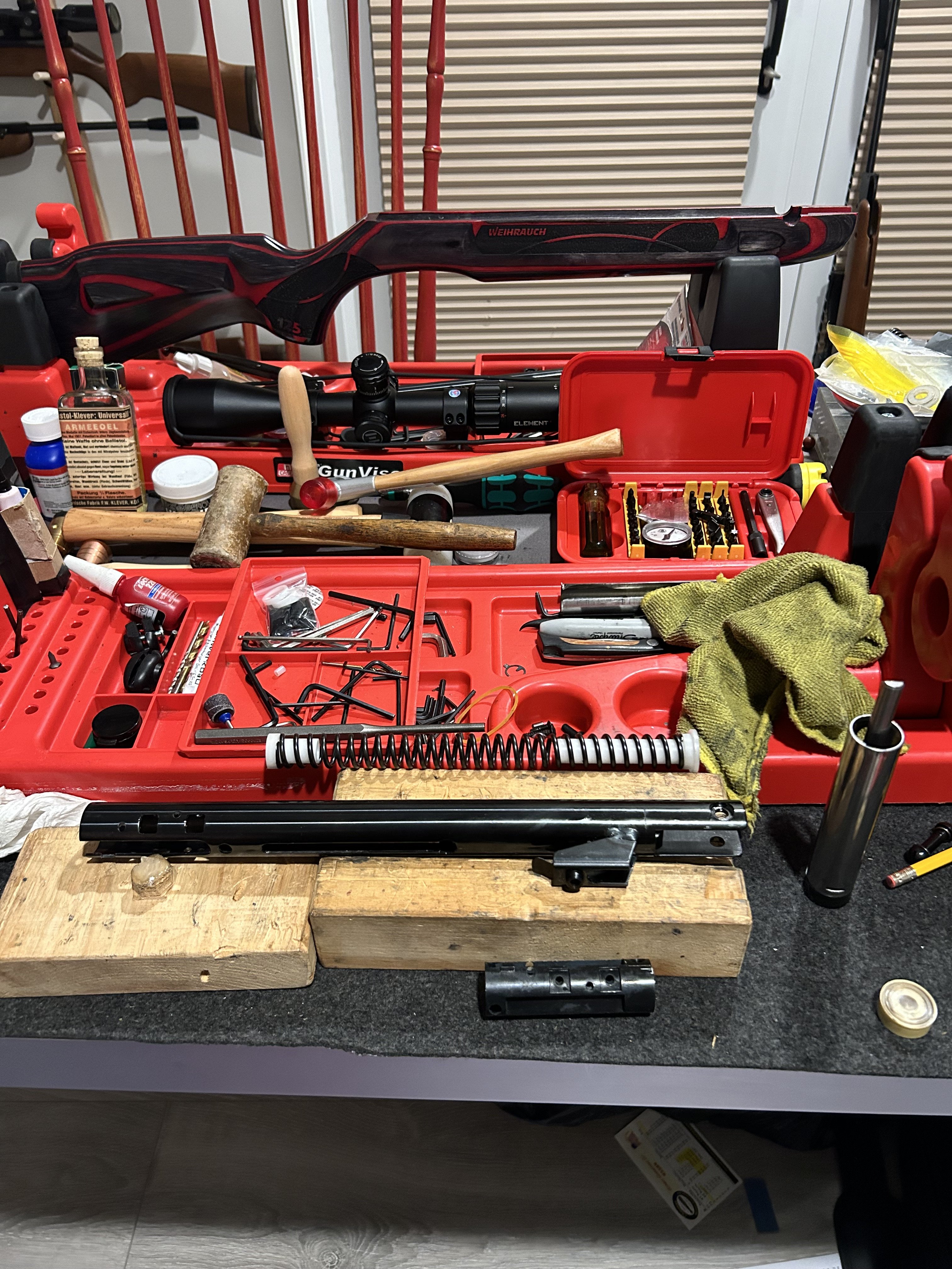

381. Today I started on the 125 yr. HW50 .22
Put a TbT kit in this one. I have another 50 .22 with a Vortek. I’ve been using these Snap-on files.
They make de-burring easy and cut clean. After this post I’m going down to assemble the 50. Crow
