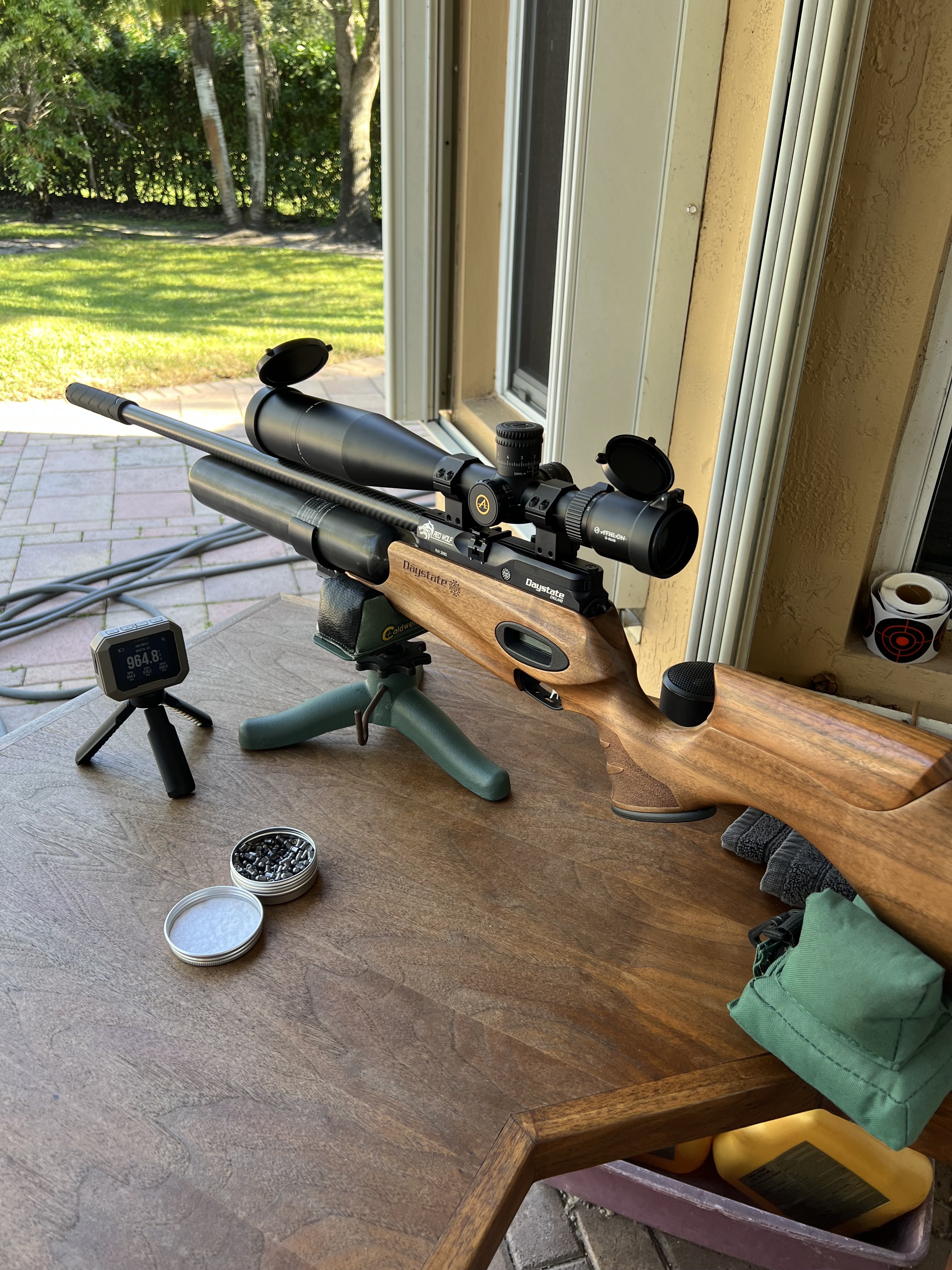

Mine is a little easier. It's an F X radar.I can relate on the chrony, I had a Alpha shooting chrony for years. A new battery is a must for it to work decent. But even then it would miss shots, give errors and screw up the whole string which was very annoying. Outside depending on the sun angle or cloud cover, I would get different readings. Then I made some lights to go on the sky screens and used it in the garage mostly, and
that eliminated most of the problems. Still a PIA to set up and time consuming. With my new Garmin all that is thing of the past, this thing works every time, any where, and sets up in 2 mins, but cost 5X as much. Worth it? Every penny.

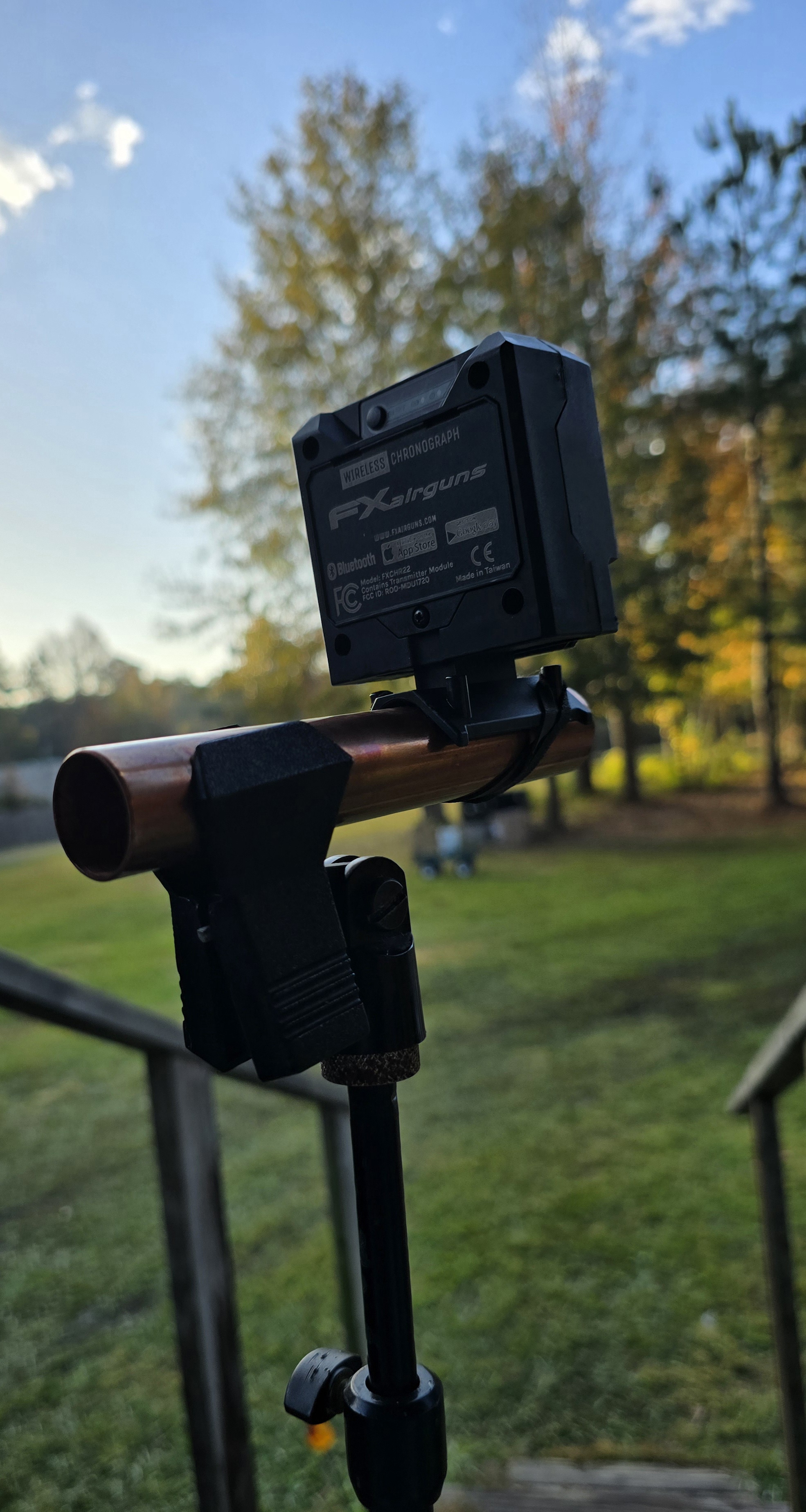

I had a server error and couldn't send a pic of it.
It is mounted on a mic stand that I put under the barrel.

I scored the FX, the Garmin was out of stock. Worked great but now it’s not picking up .177 cal. So disappointing. I took it in to AGS. He tested it with a PCP. Said it worked flawless. Got it home. Tried with 3 different rifles .177, not one worked. Can’t have this.I can relate on the chrony, I had a Alpha shooting chrony for years. A new battery is a must for it to work decent. But even then it would miss shots, give errors and screw up the whole string which was very annoying. Outside depending on the sun angle or cloud cover, I would get different readings. Then I made some lights to go on the sky screens and used it in the garage mostly, and

That is unacceptable for a 1K + chronograph. I would be sending it in to FX or whoever for repair or replacement. That said, my Garmin hasn't missed with my air riles yet. At the PB range I could make it miss when firing rapid fire with a AR15, but that was expected. Slow fire never missed a shot. And $400 less than FX cost.I scored the FX, the Garmin was out of stock. Worked great but now it’s not picking up .177 cal. So disappointing. I took it in to AGS. He tested it with a PCP. Said it worked flawless. Got it home. Tried with 3 different rifles .177, not one worked. Can’t have this.
A big thing I didn’t like of the FX was it doesn’t record under 400 fps. HW30 .22 cal. also I shoot sling shots. Crow

Maybe it wasn't lined up right before. Need to keep an on it for sure.I tried the FX on the HW50 .20. Worked like a dream. I shot the HW50 1968 right after and it picked it up just over 400 fps. Some worked most didn’t. Grabbed a HW30 .177and it worked like a charm. Don’t get it. Tomorrow I’ll try a 97 or 95 .177.
