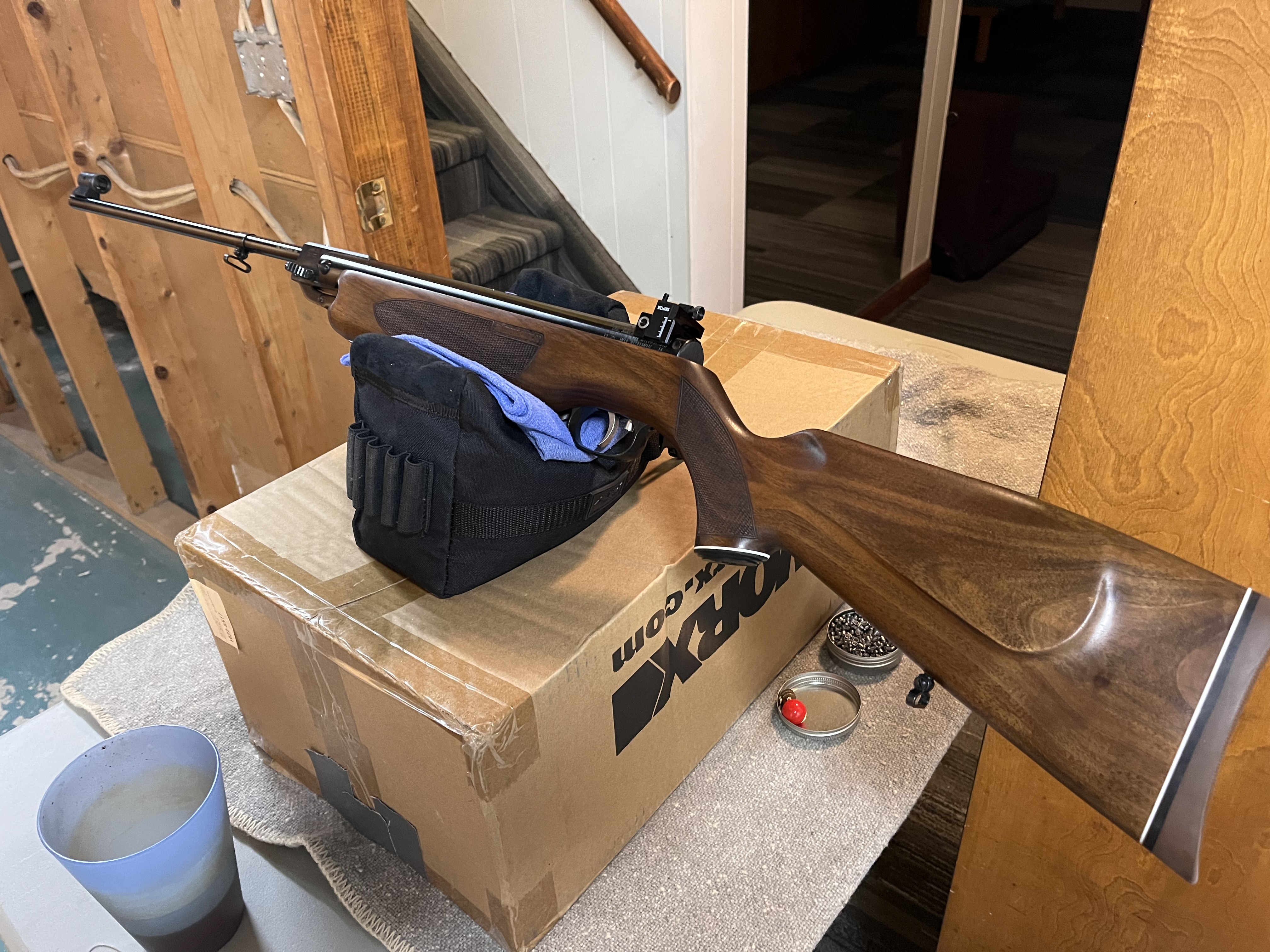

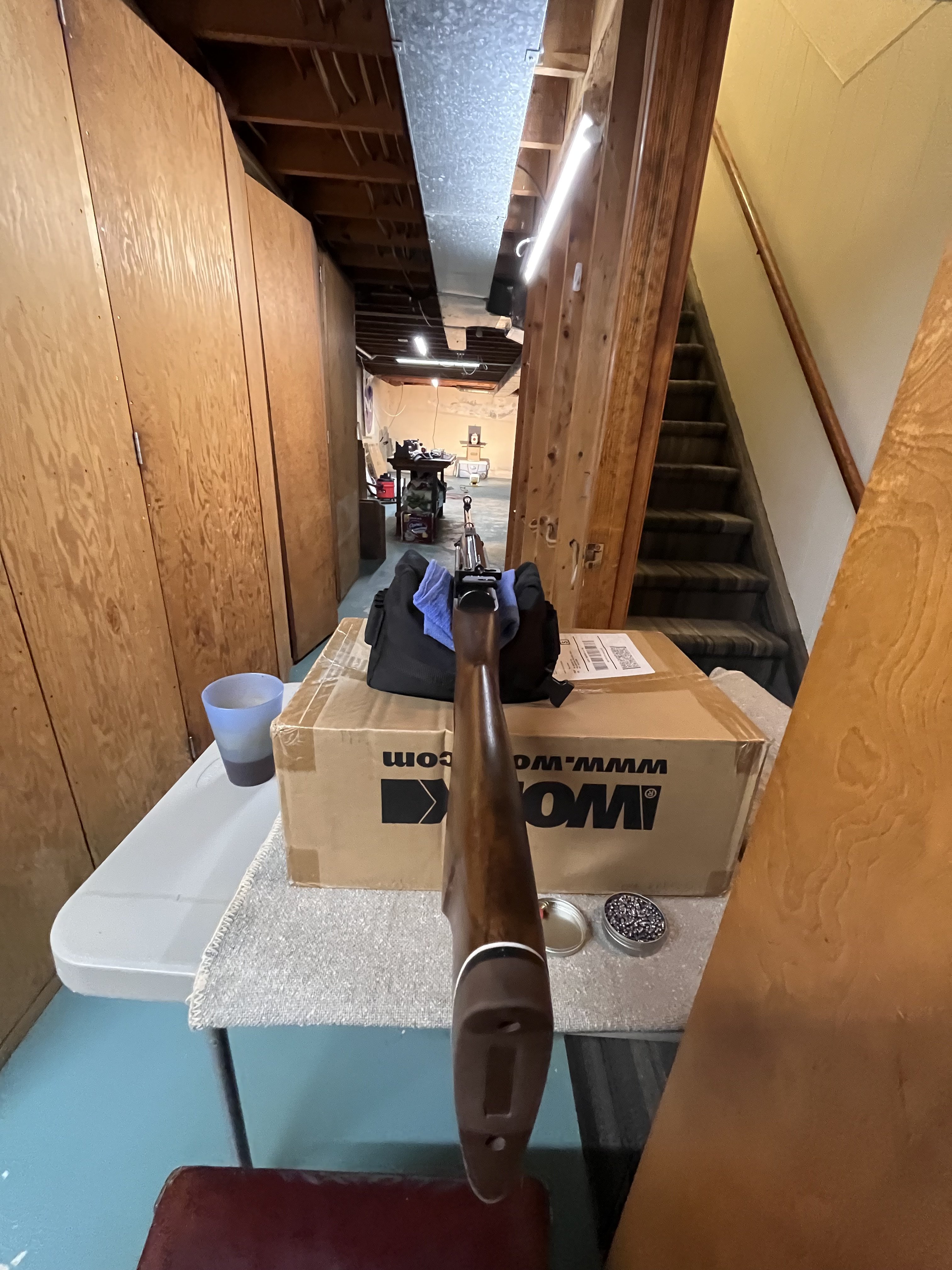

Perfect winter range down there.Some after dinner HW35 time. Playing with different pellets at 45 ft. Smoothing out after about 350 projectiles (the gun and me).

Beautiful grain in that stockSome after dinner HW35 time. Playing with different pellets at 45 ft. Smoothing out after about 350 projectiles (the gun and me).

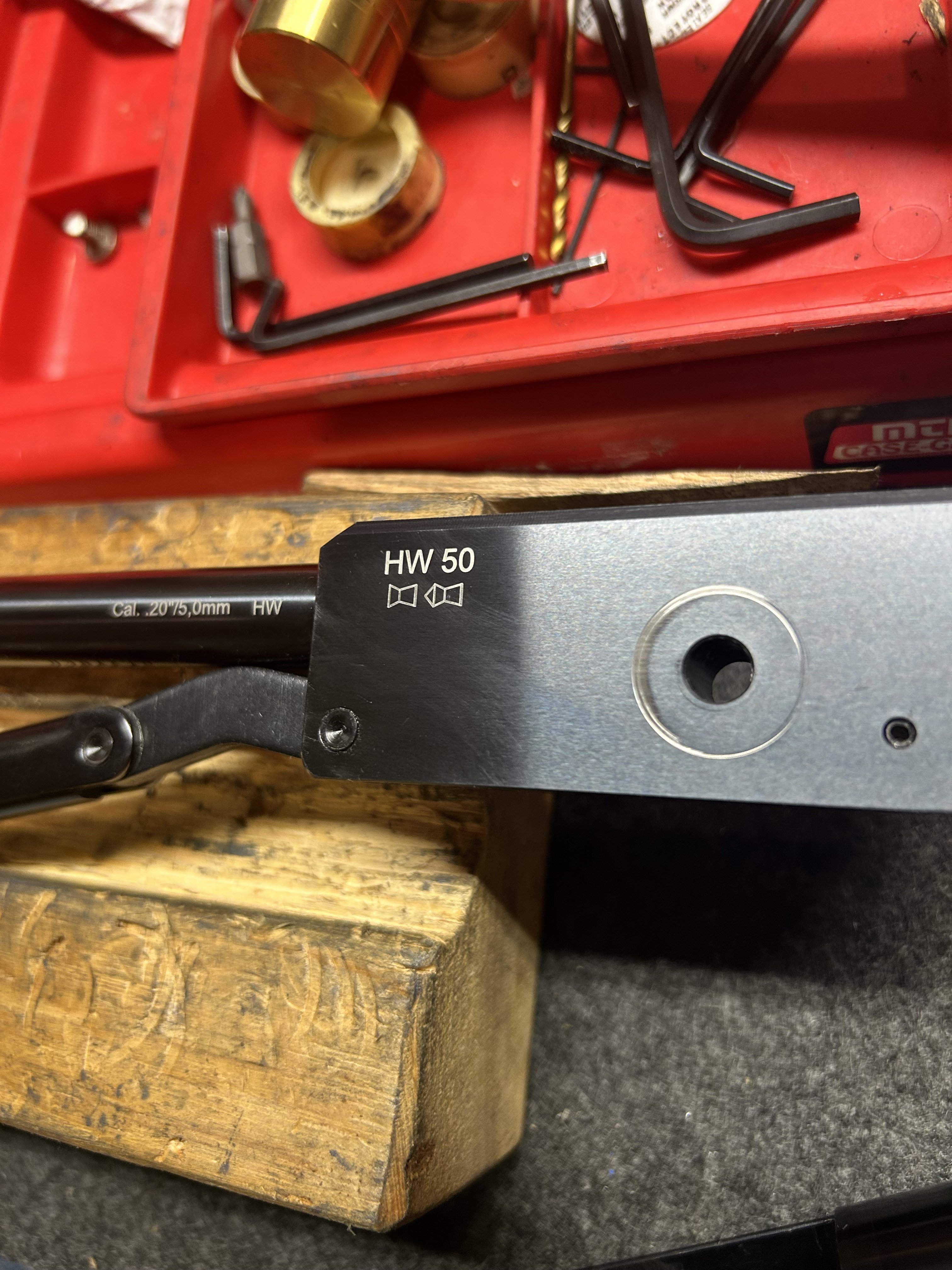

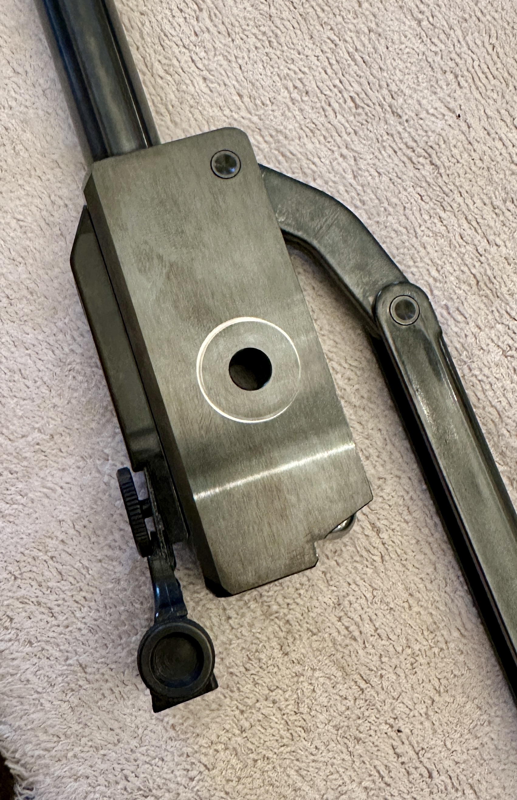

Wow! Hope they haven’t started using low quality metal for the breech block. First their bad springs. Now this?When I changed springs on my HW50 .20. Up to then it may have had 500 rounds through it. This seems to me to be excessive wear. View attachment 520525Would brass bushings be better? Crow
Did it have any lube on it?When I changed springs on my HW50 .20. Up to then it may have had 500 rounds through it. This seems to me to be excessive wear. View attachment 520525Would brass bushings be better? Crow

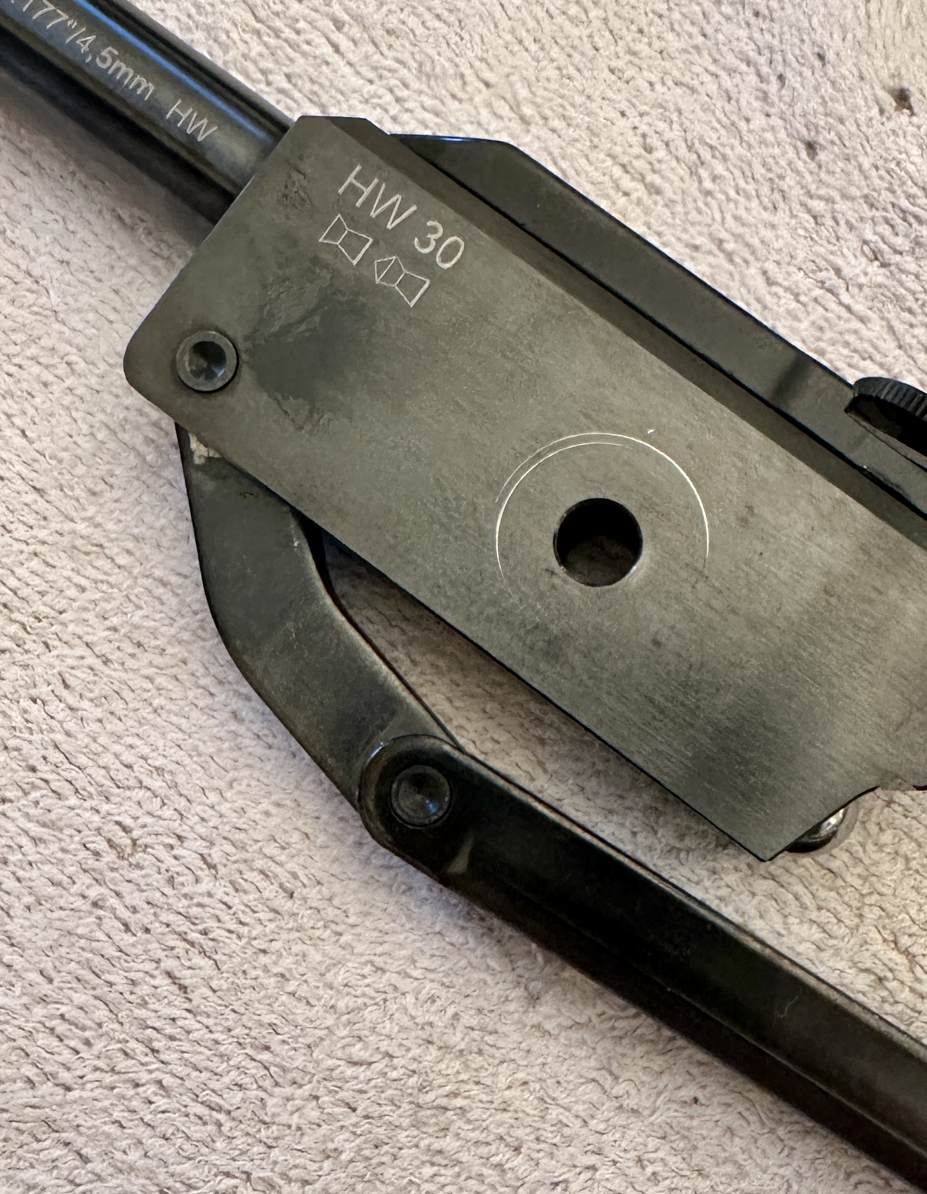

This HW30 I'm working on doesn't have 30 pellets thru it yet, so it must be a thang.yes it did
SadThis HW30 I'm working on doesn't have 30 pellets thru it yet, so it must be a thang.
These shims are only .004" thick.MMMMM, maybe a washer of delrin/nylon and some lube? Just a thought. I used to work on machines where we had actual sheets of Teflon about 1/8” in thickness. Used them for slick washers or anything on the machines that needed it. Also a clear plastic sheet to make things slick or put controlled friction to guide envelopes through the folding machines. This stuff could take a permanent slight crease for interesting guides. We had double stick tape that was tenacious. Need a washer make a washer! 500 envelopes per hour was slow. Be Well Brothers, dito.

Would brass work?These shims are only .004" thick.
