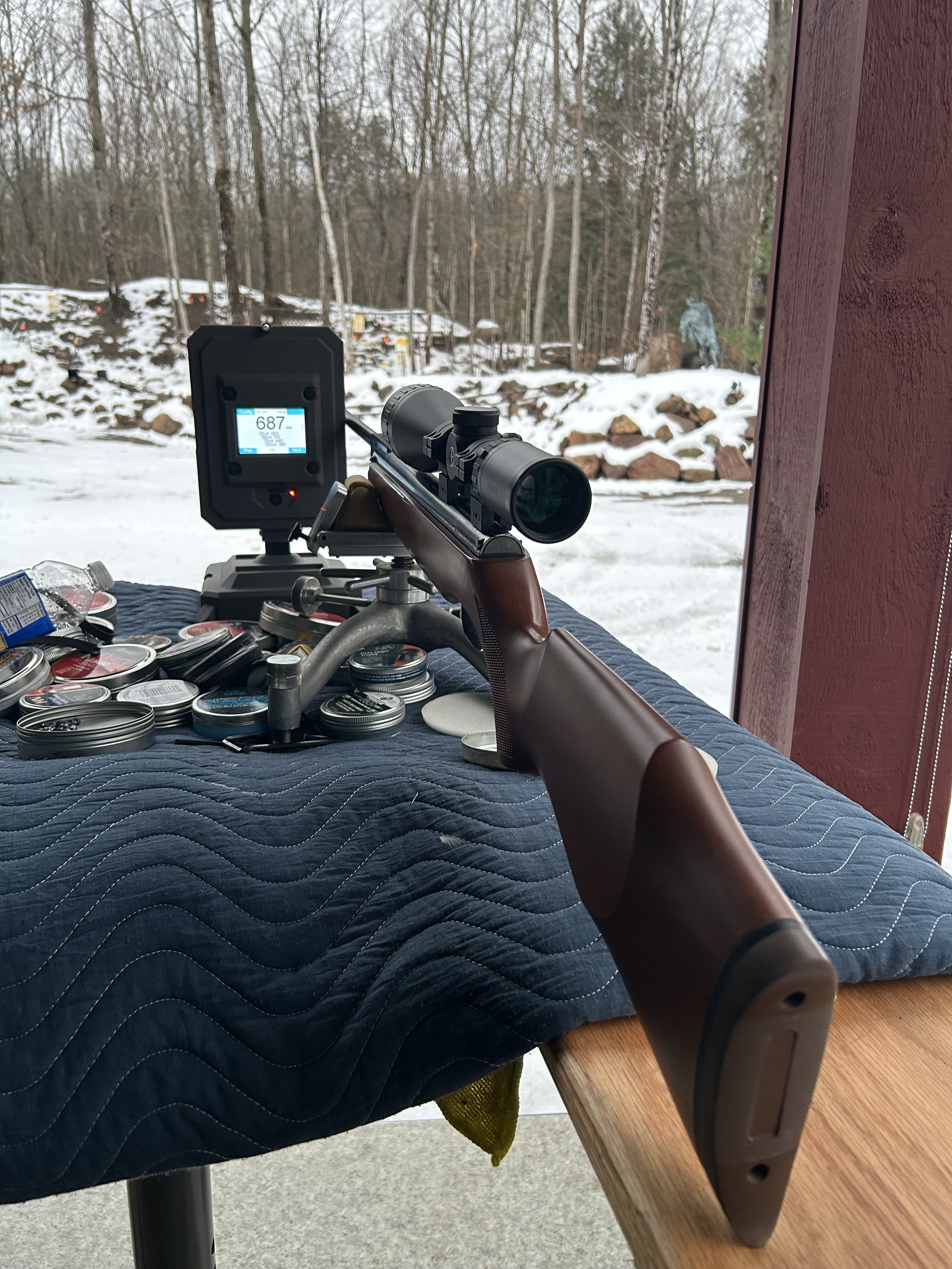

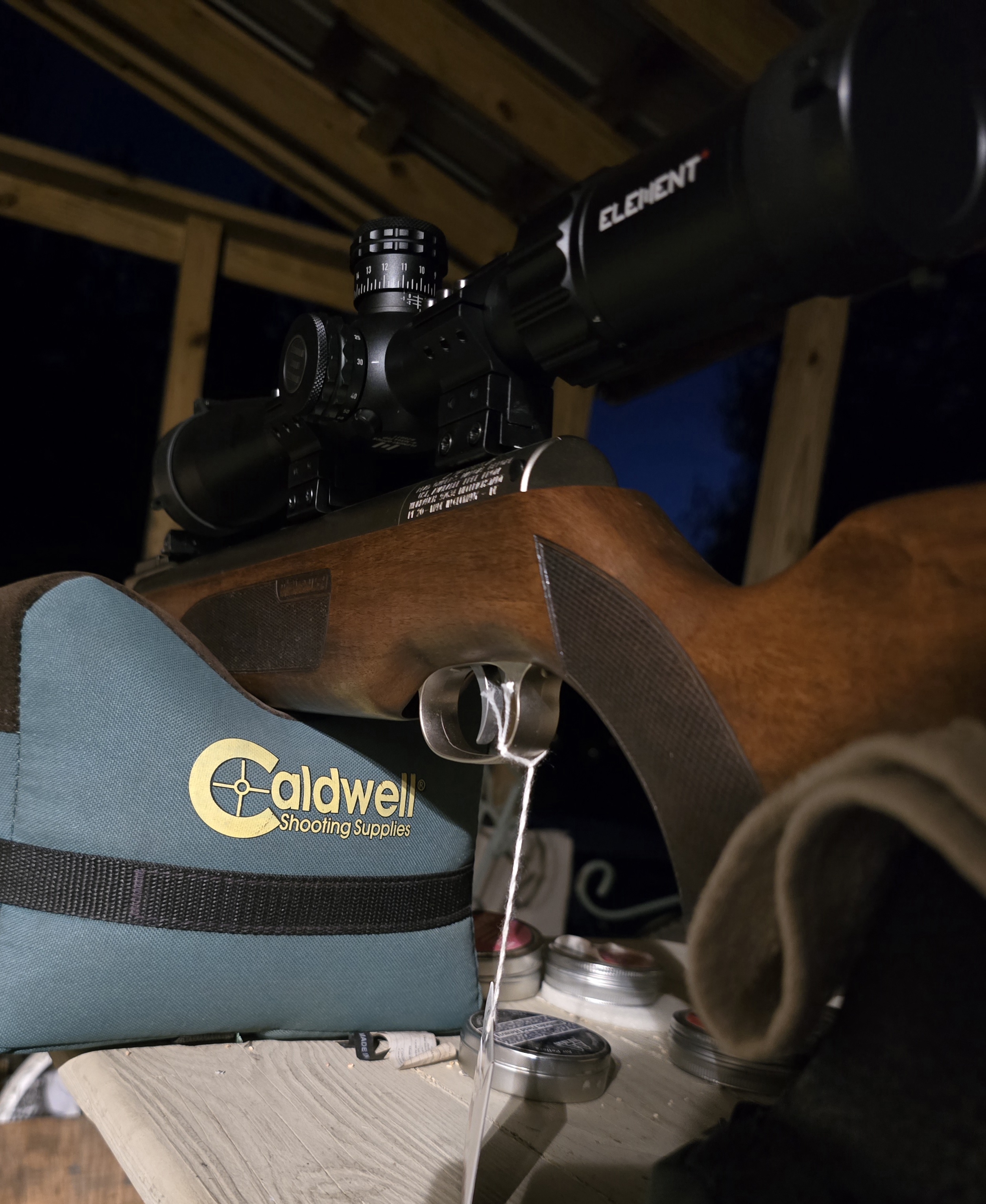

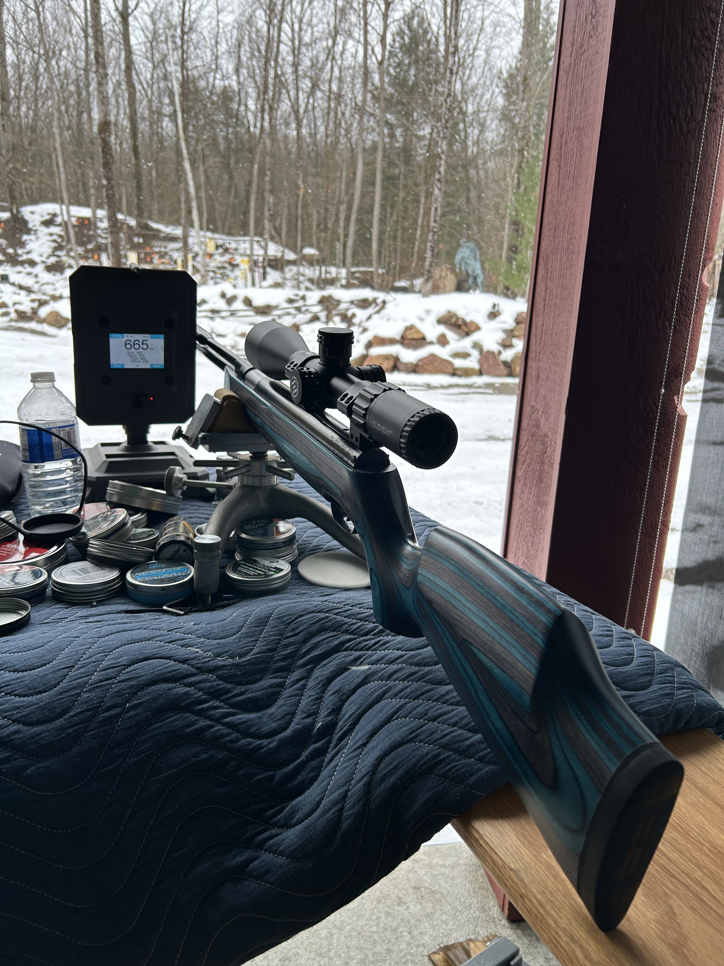

I cronied this honey this morning. It’s shooting almost 200 fps slower than before the spring change.View attachment 521315Almost sounds like there’s a silencer on it.

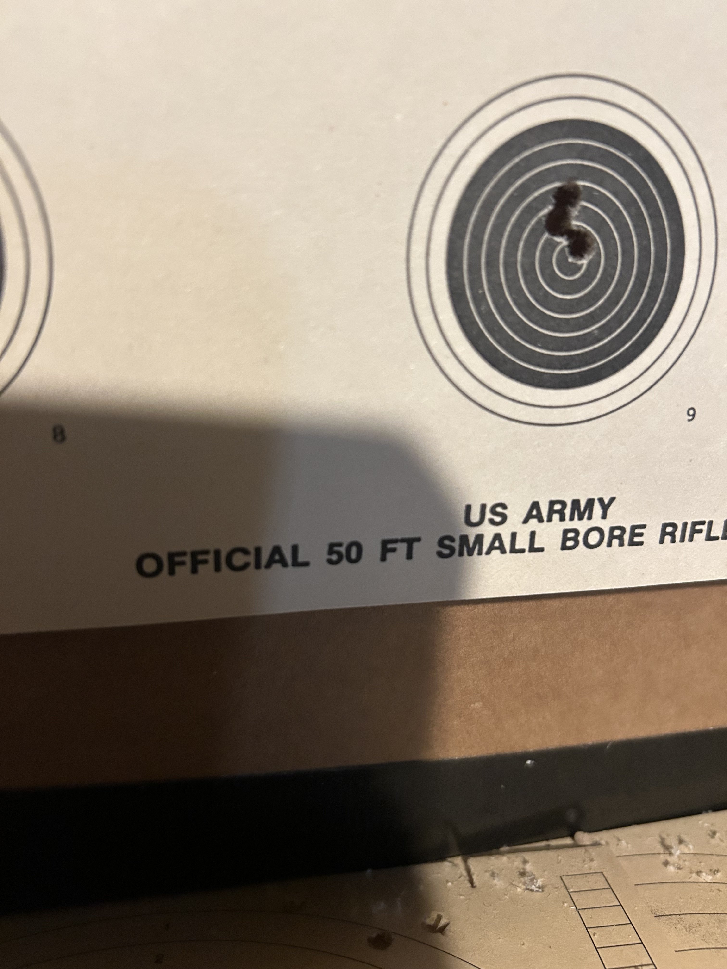

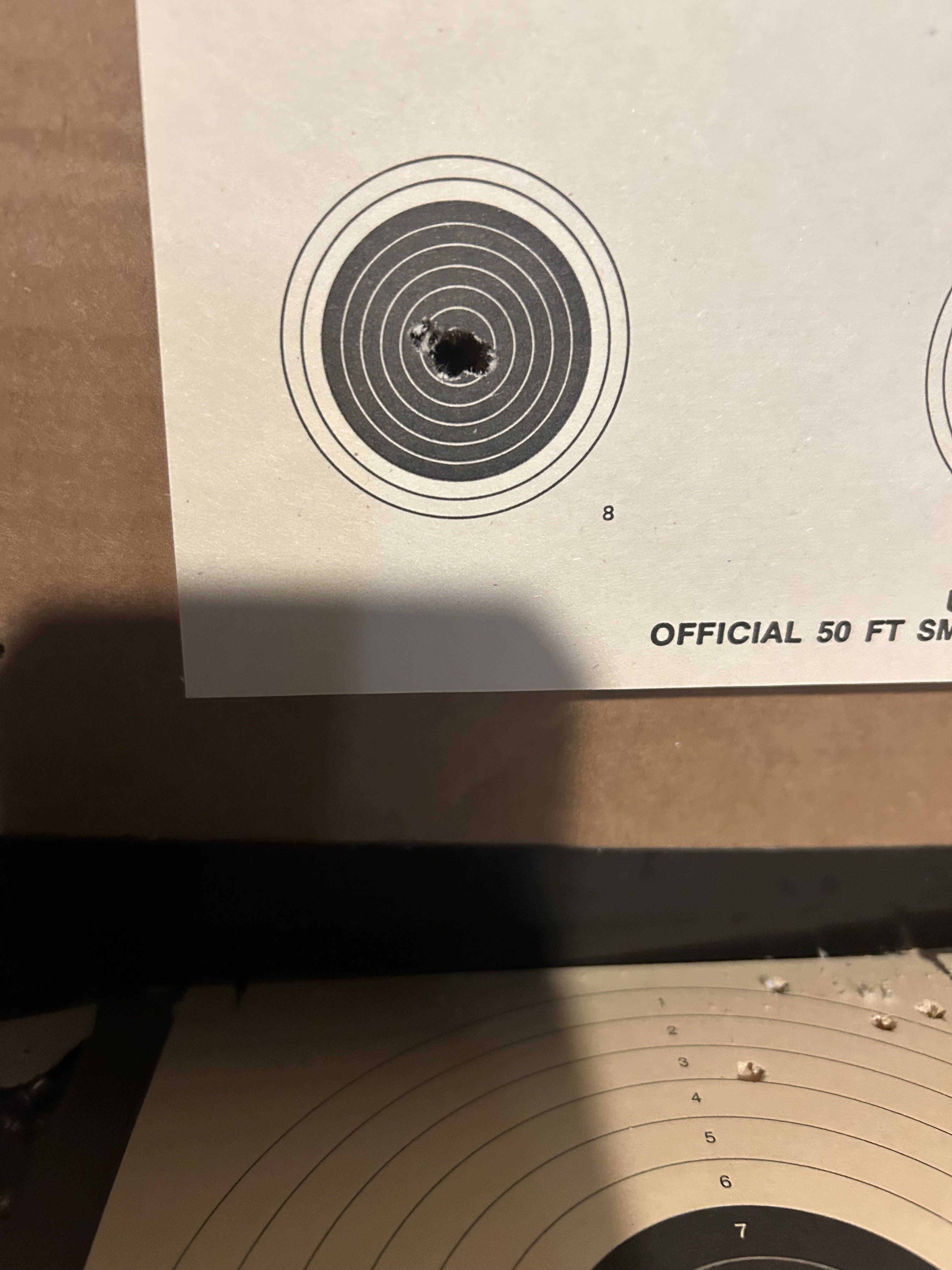

Here’s 20 rounds 35 yds. Pulled 2. These aluminum targets are the best. Nail close to dime. View attachment 521316Lost a lot of snow. Been in 40’s. Crow
That's pretty slow for a .177🤔 That's only 8.2 fpe if using a 8.44 pellet. Maybe it's not sealing well, or the piston seal is way too tight in the compression tube.

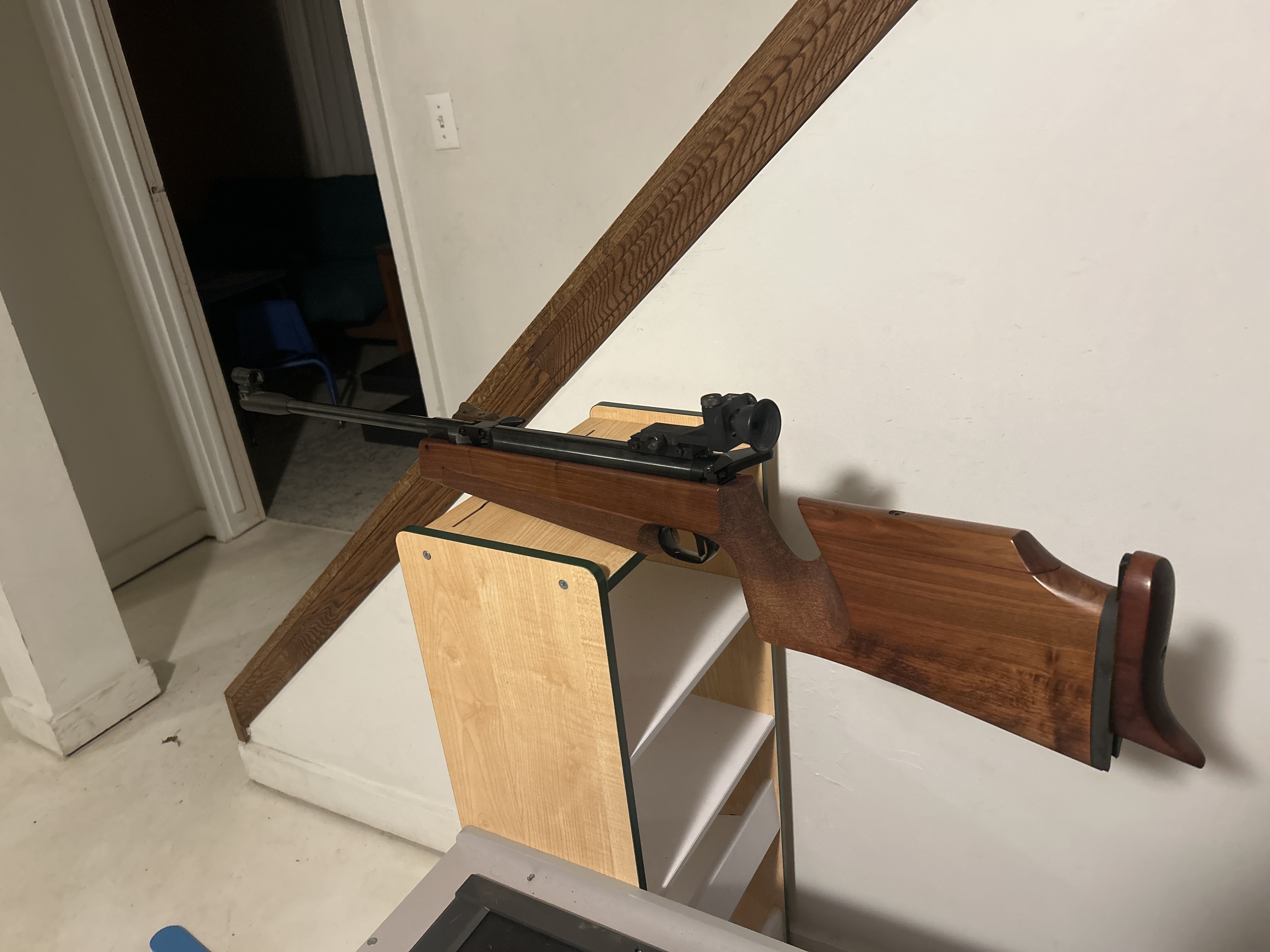

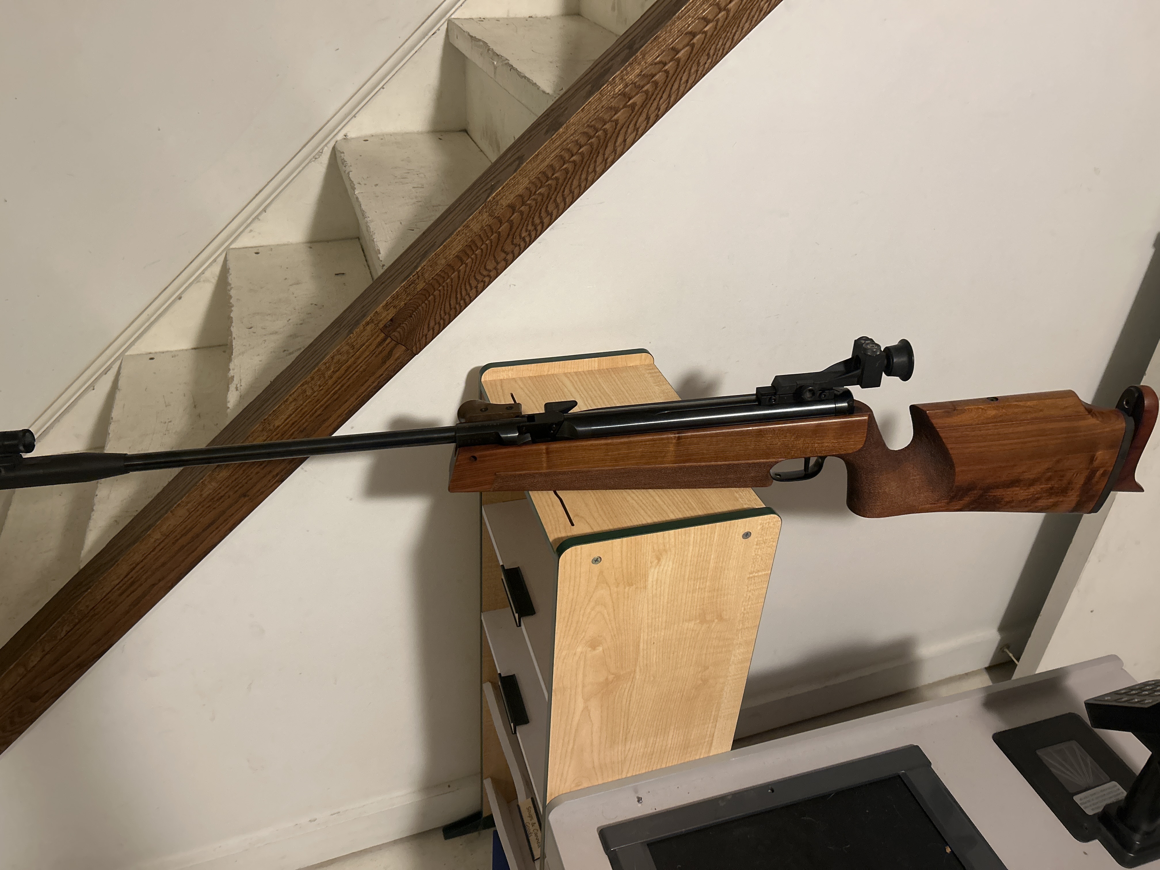

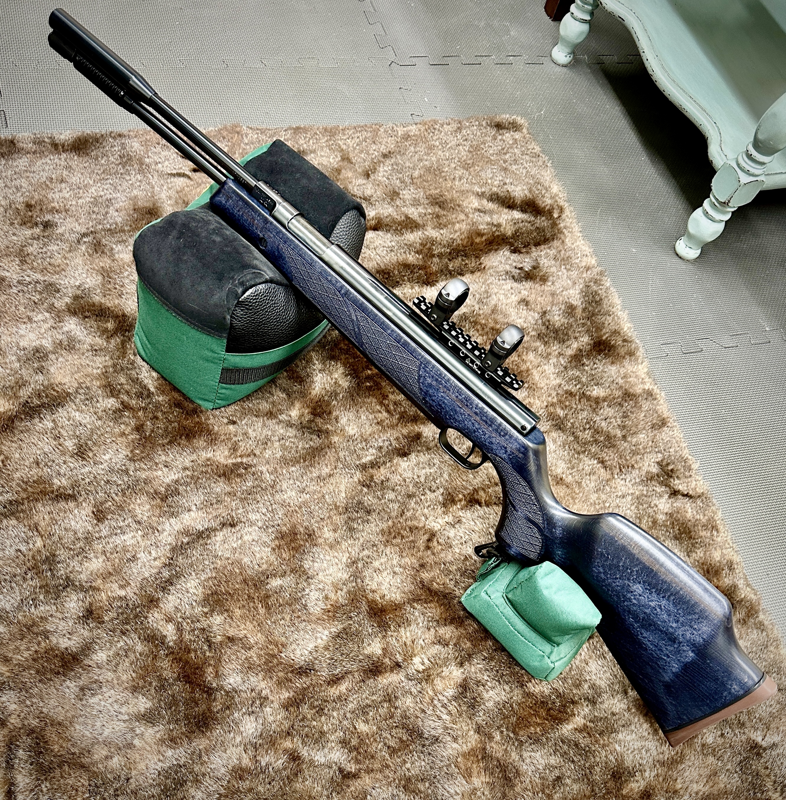

Very good! I’m dying one because how well you did.
Well take your time, because it will take time..lol.
Prep work is key. The dying part is adjust it to your liking. I did a couple maple boards to get a feel for how to mix it, and color output. If you finish it with the matte polyurethane, do one light coat and let it dry for a couple of days, then repeat, letting it dry. I made the mistake of trying to do three coats in one day, and it wouldn't dry in some spots. I ended up with about seven coats, so it took a while.
Thanks. I was a 8.44. I thought it was slow. I’ll hopefully get at it tonight. Love the sound and accuracy. Crow

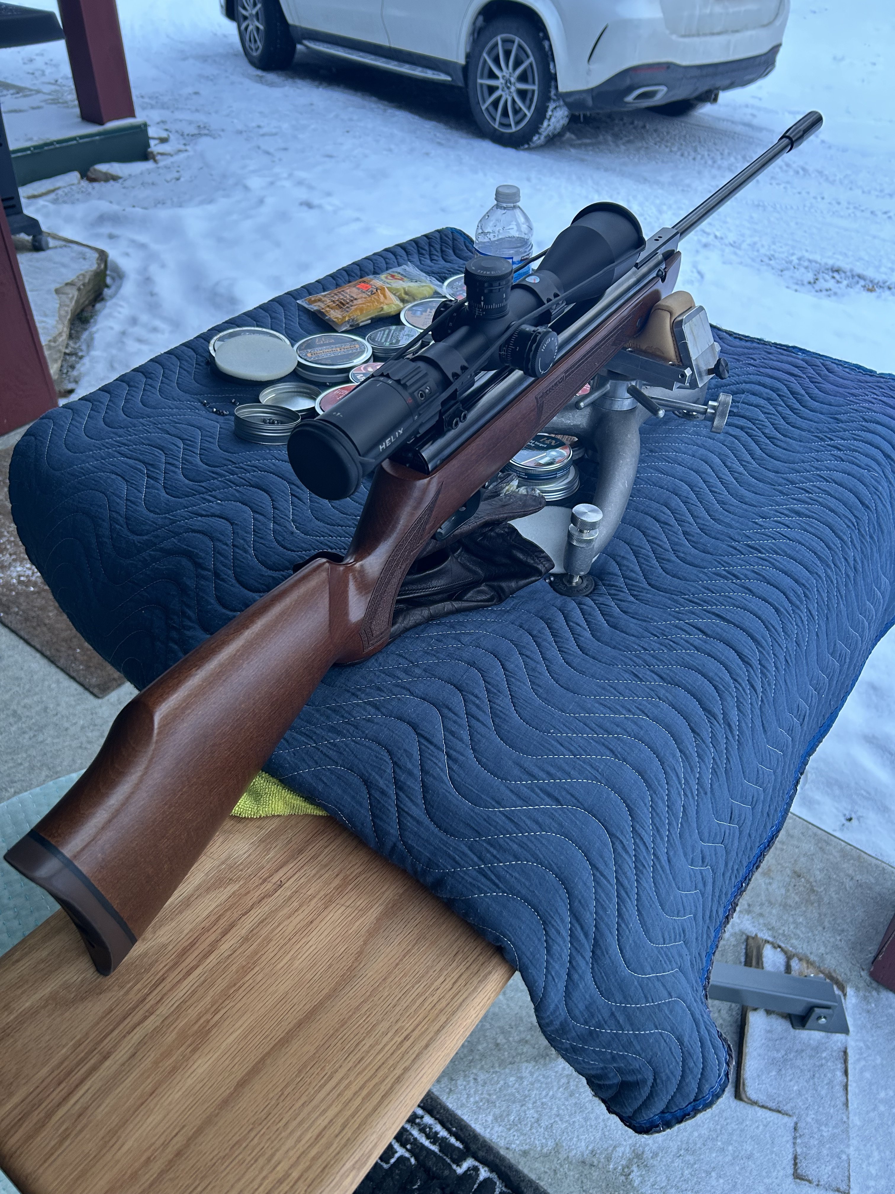

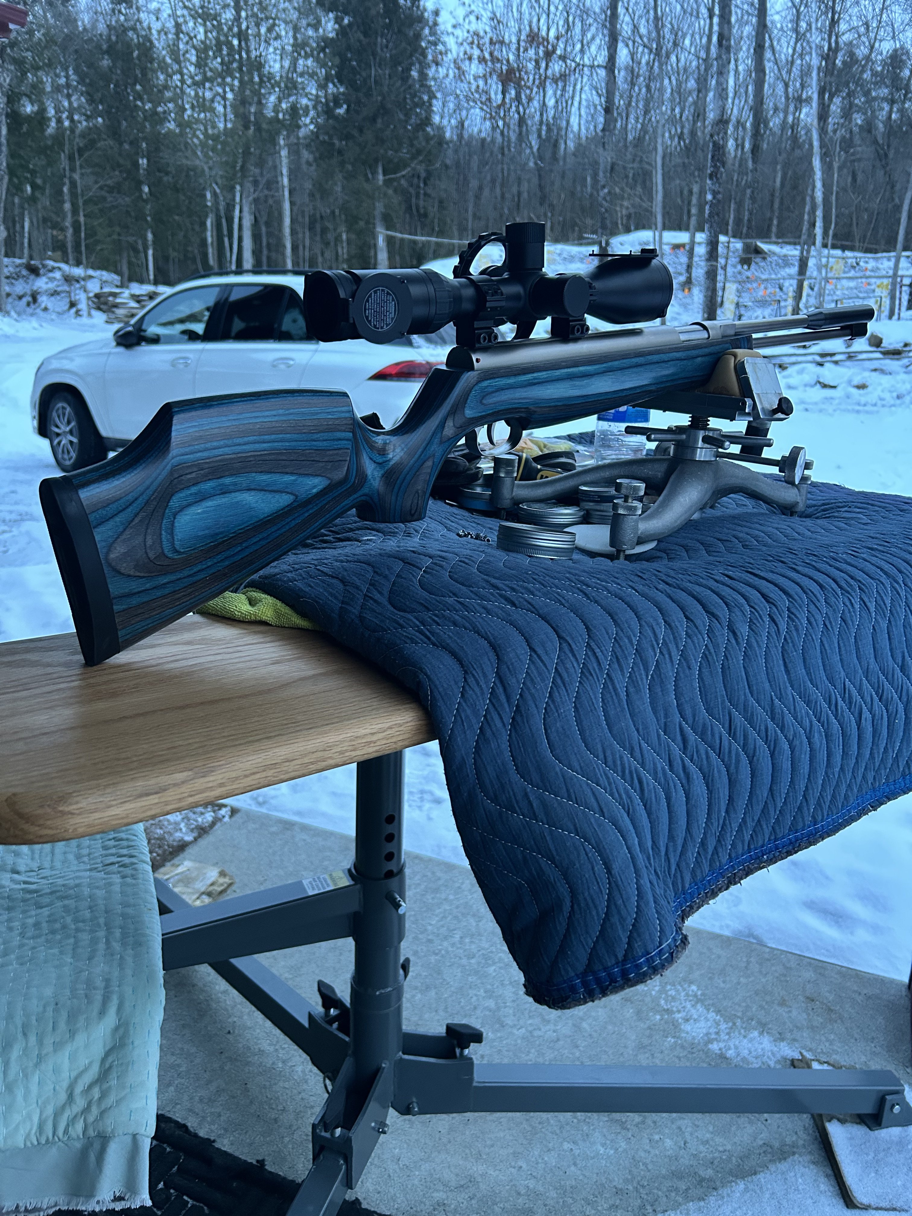

Here’s another that never got cronied after the change. A HW85 .22. JSB 13.44
I came this close to getting one of these in .20 cal.This gun is infectious. Crow

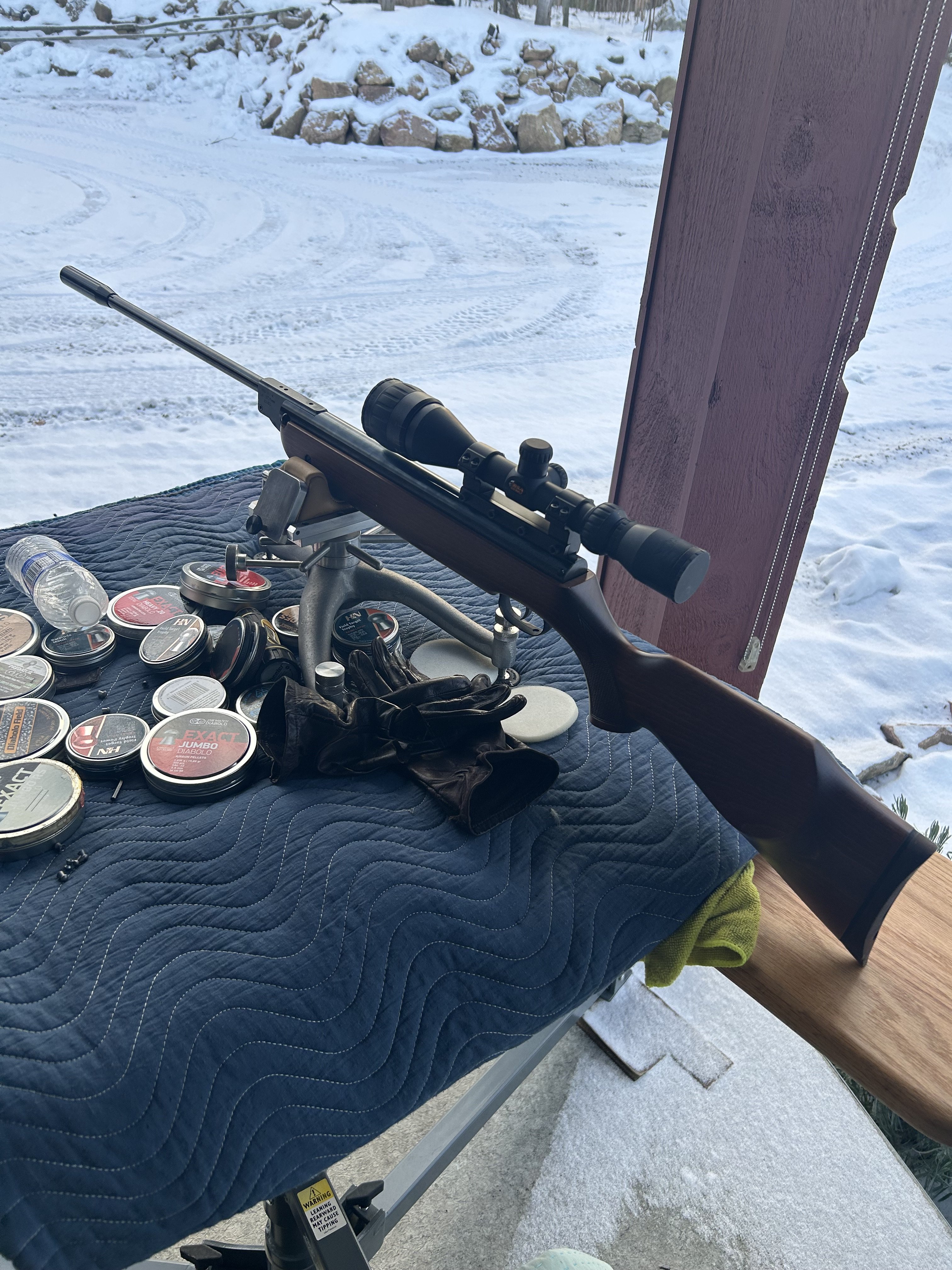

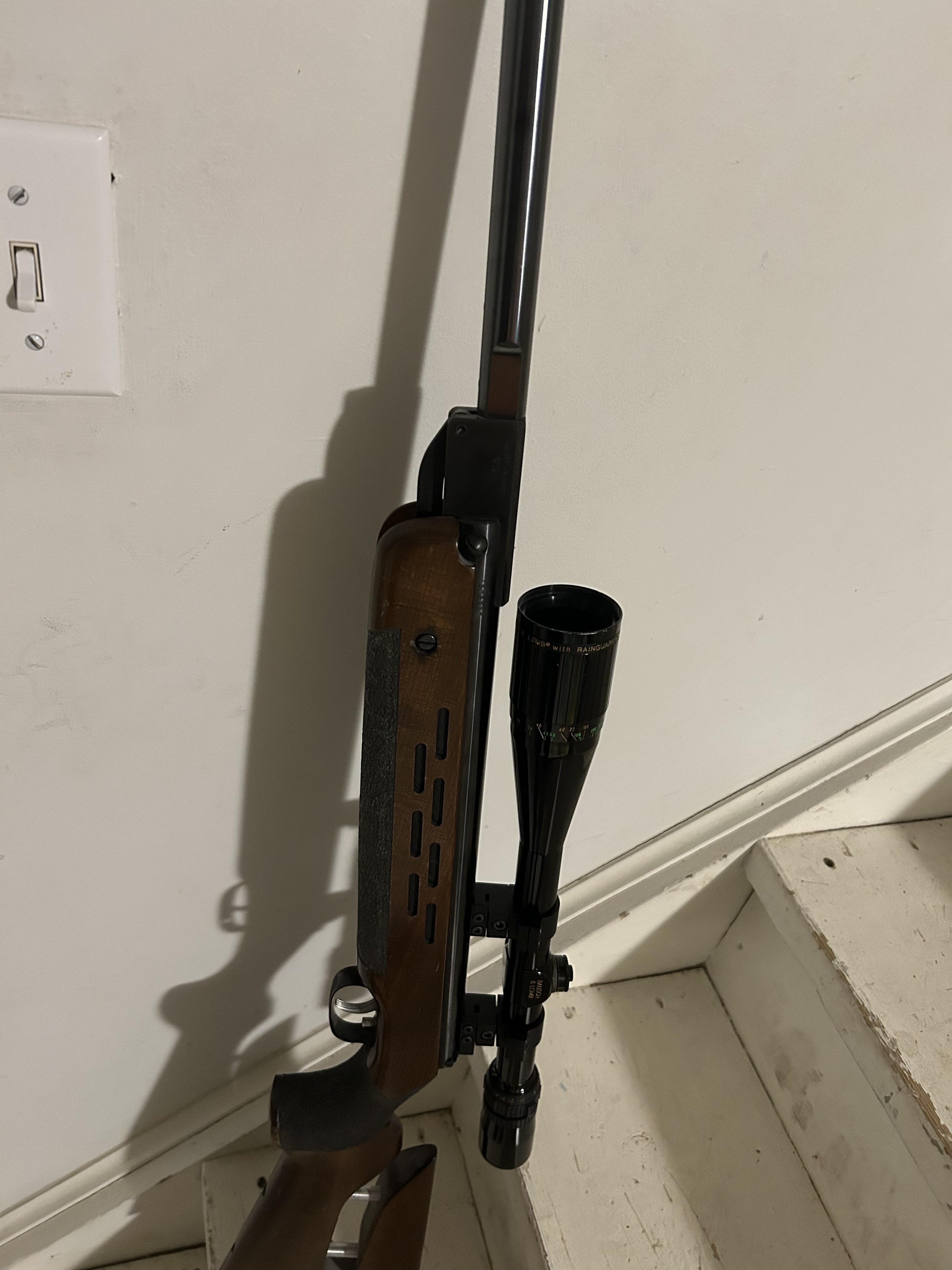

One of my new old 50’s. Accurate, but made some clicking noises when returning the barrel. Going on the bench.View attachment 518489I also shot my HW35e .177. View attachment 518490Such a pleasing gun. And today above accurate, if there’s such a thing.
24F. and still snowing. Awesome day to shoot. Crow

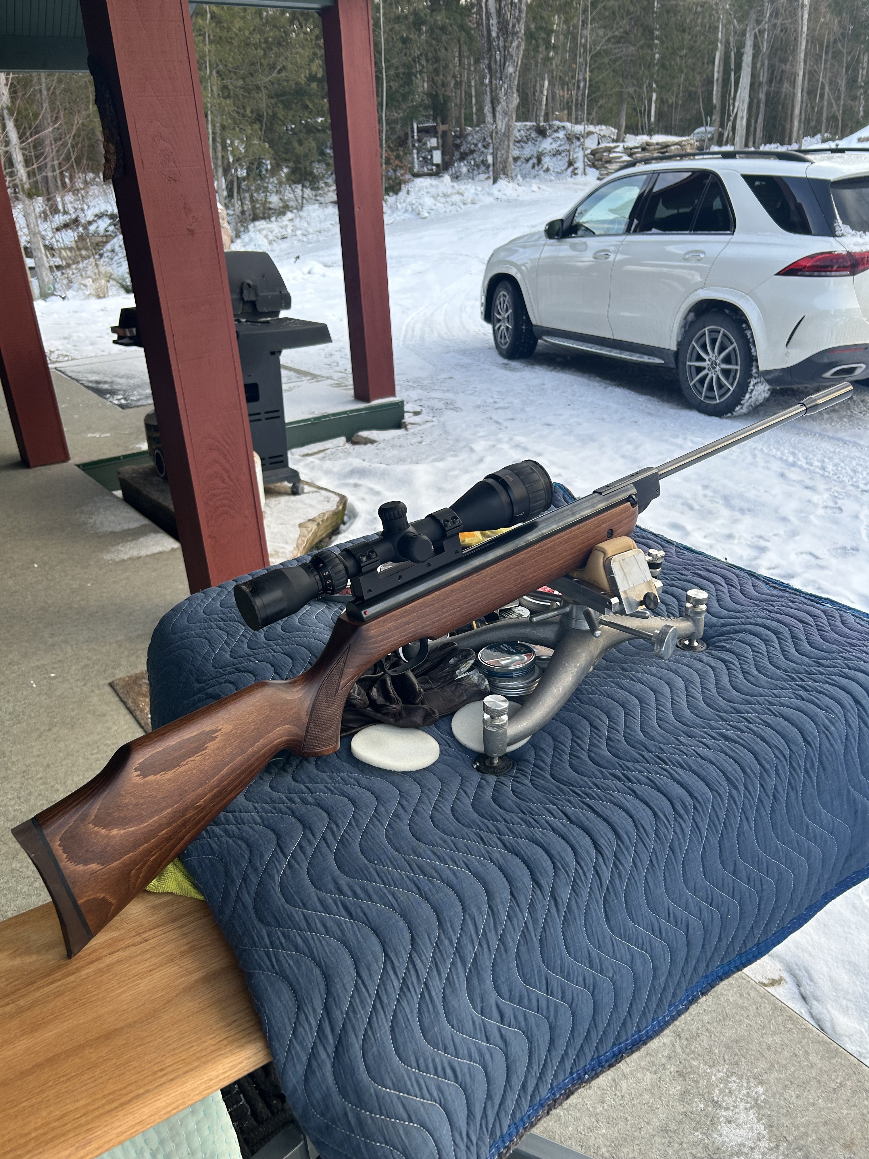

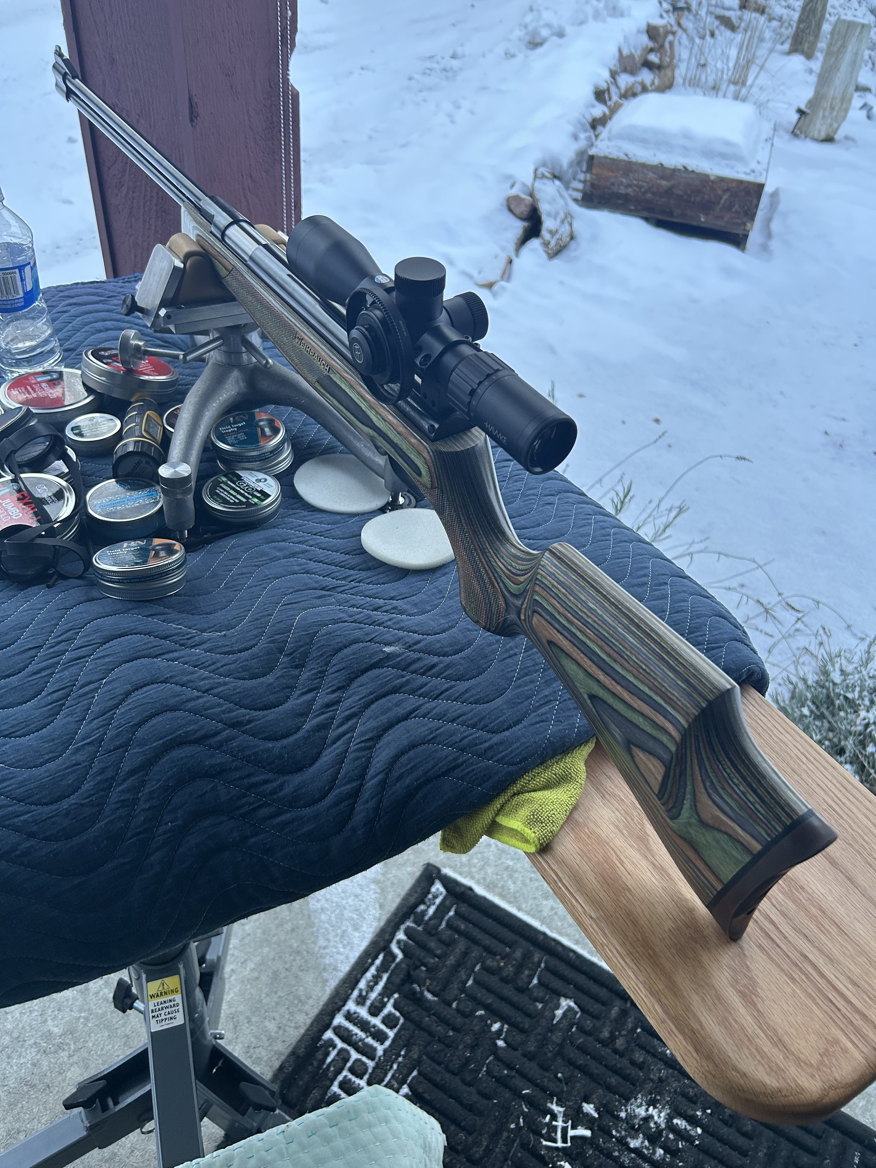

This morning shot this HW77 .22, bought used.
Dirty accurate. I have nothing against the 77’s.
‘The HW90 .22 almost makes your head spin like in the Exorcist. What a marvellous gun.
It takes every shot serious.

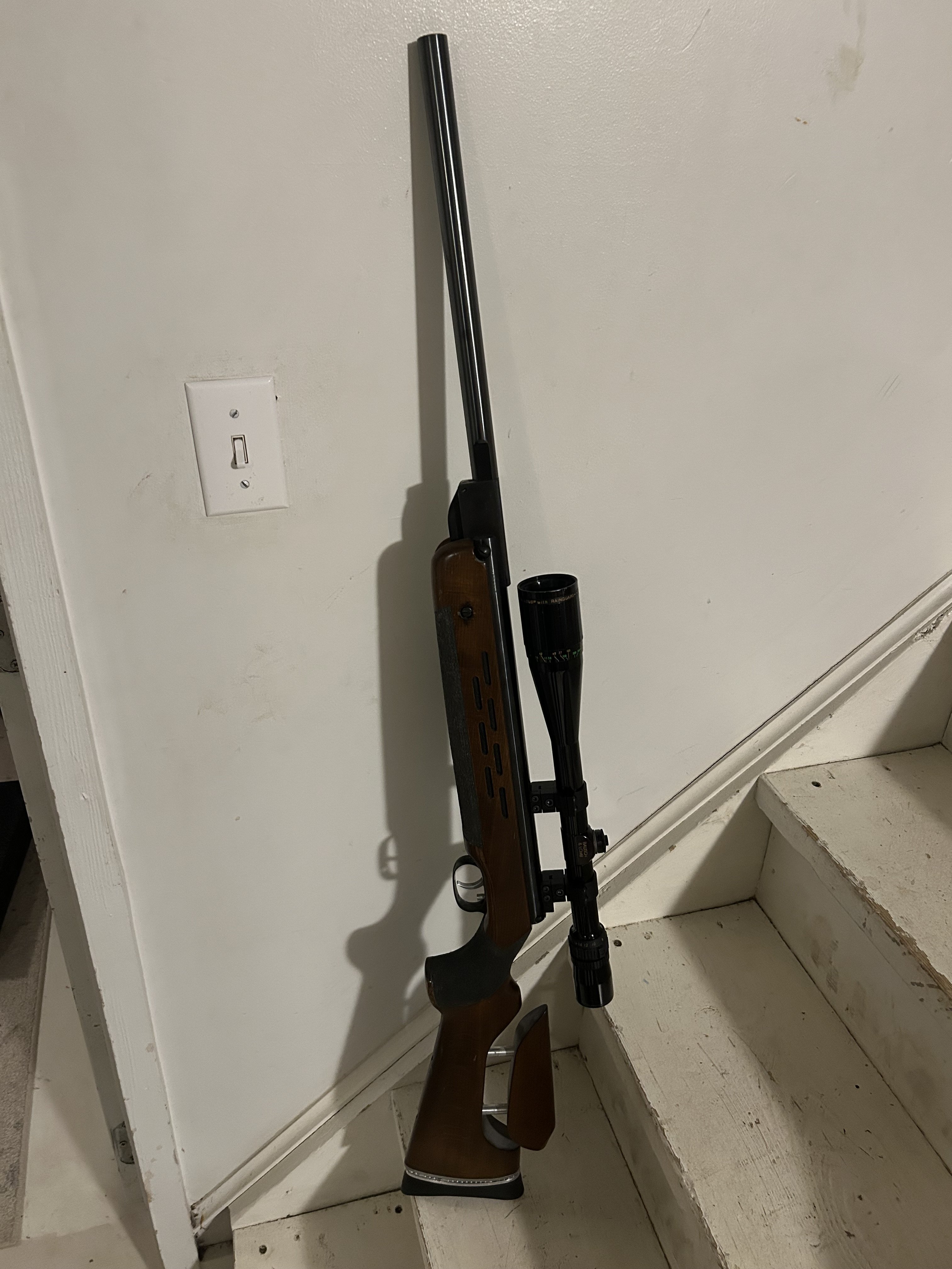

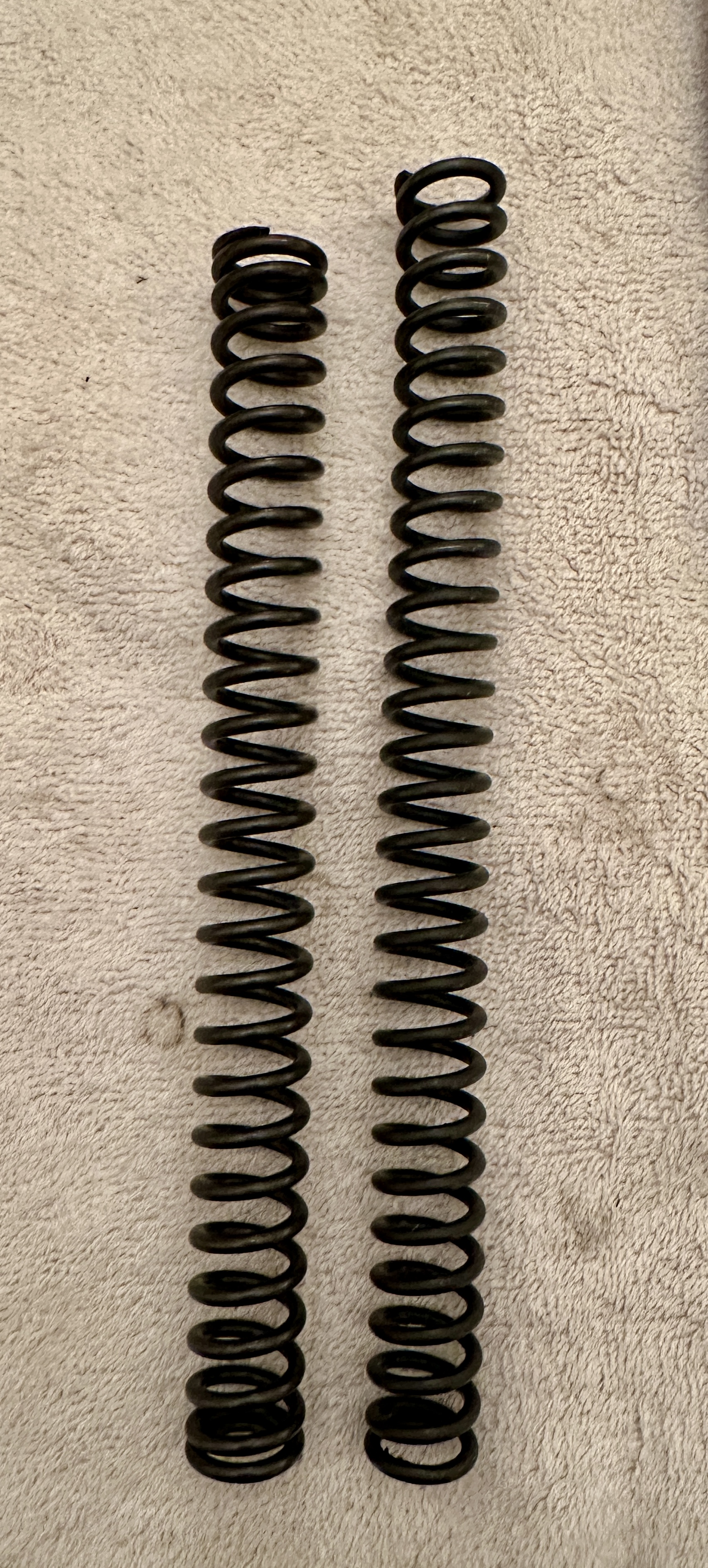

HW30 spring comparison for those interested.
In the pic, JM on the left, and factory HW on the right.
JM is .113 wire diam and 27 coils, OD is .744, ID is .518. And the spring is straight, and it has been set. It's about .570 shorter than the HW
HW factory is .106 wire diam and 29 coils, OD is .720, ID is .501 and the spring is kinky, it is set and is about 8-1/6" long. Guide diam is .463 so it's about .019 per side too small..lol.
I need to make guides for the new JM spring.✌🏻

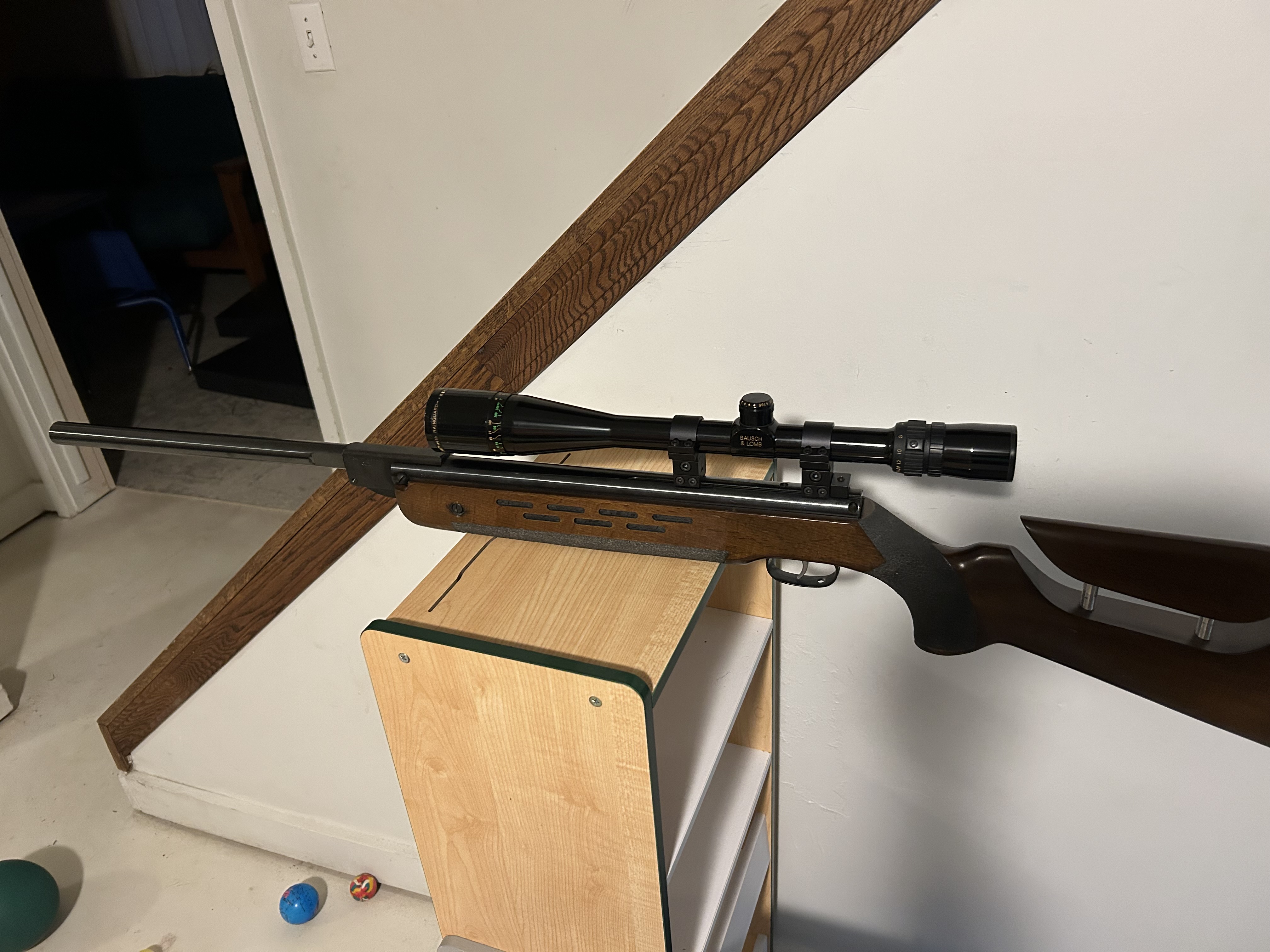

Shot an R11 i found, I traded an FWB 65 I had for it
Nice gun. R11. It’s on the bucket list.
A few of my Weihrauch springs had bends in them. None were used a lot or abused. Crow
