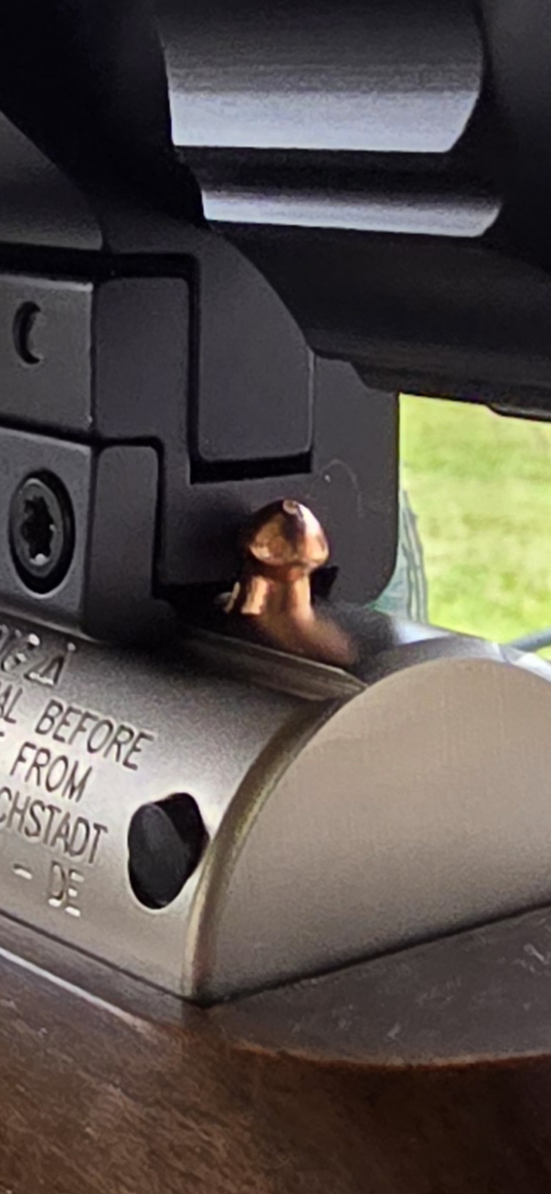

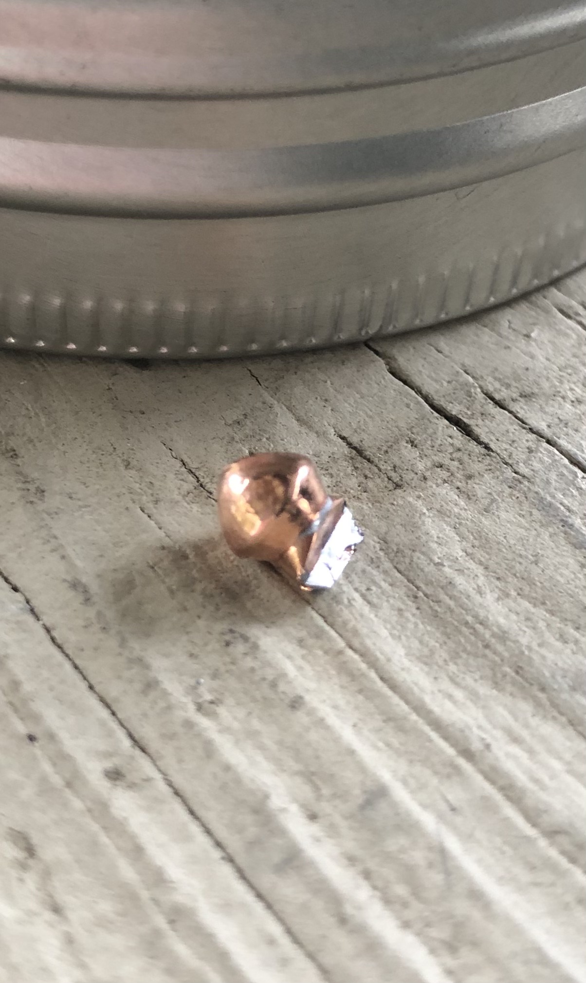

It started more like this with scope firmly against it.Is the skirt pinched under the mount?
eventually smashed flat..lol. Why not just put the stop pin in the receiver stop pin hole, then push it to the rear and tighten it down, done, no more slippage.It started more like this with scope firmly against it.View attachment 523577
You think that the pellet is going to stop it?
Or does it get sheered off?
lol. Now what fun would there be in that?eventually smashed flat..lol. Why not just put the stop pin in the receiver stop pin hole, then push it to the rear and tighten it down, done, no more slippage.
Absolutely shear offIt started more like this with scope firmly against it.View attachment 523577
Huh? I’ve got a stop pin somewhere around here? Lollol. Now what fun would there be in that?
It's all ball bearings these days..lol.Huh? I’ve got a stop pin somewhere around here? Lol
Actually my plan has been to put the propper size steel ball in there that would get pinched under the edge of the ring.

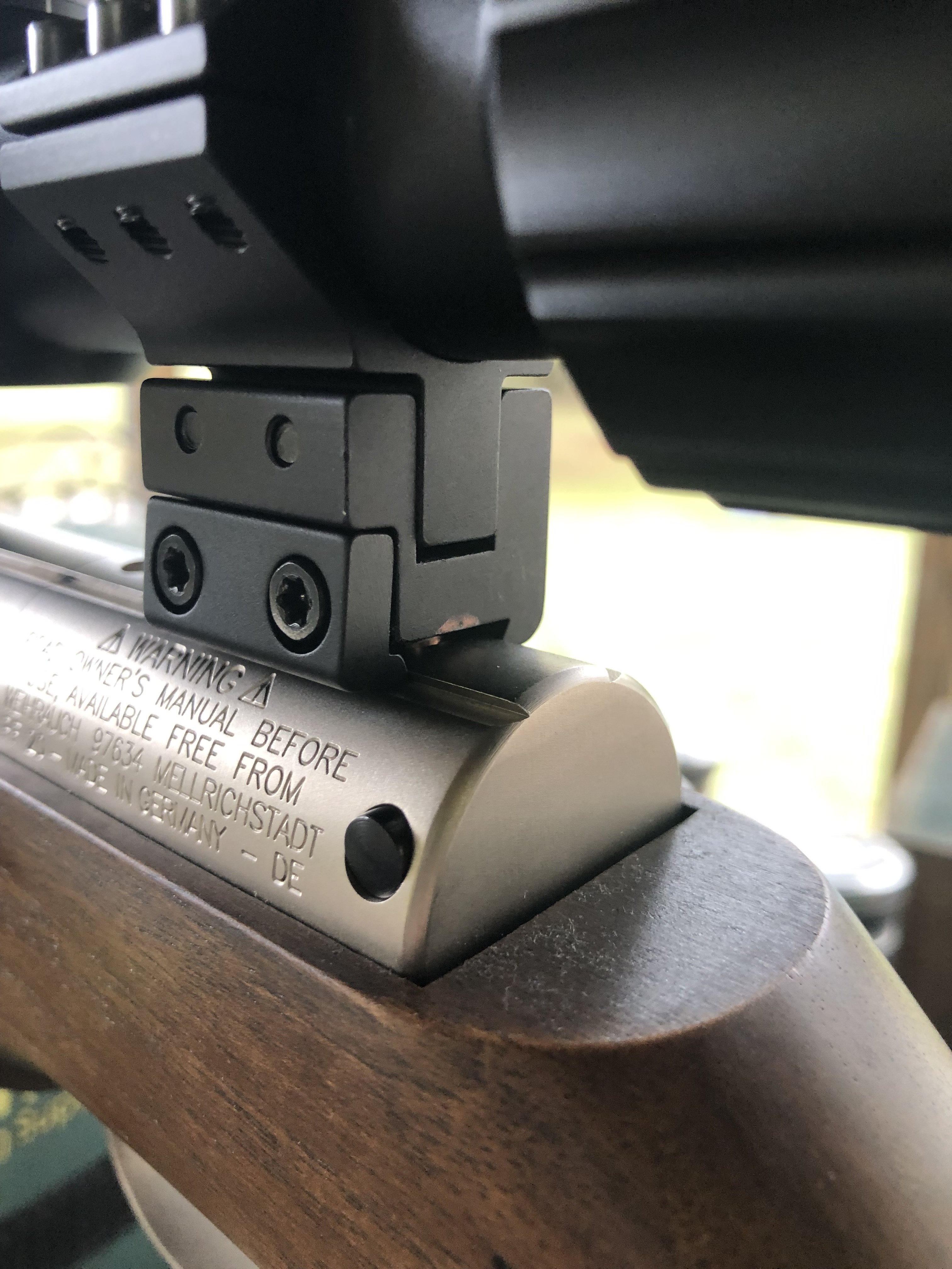

Try some Vibra Tite VC3 on the adjustment screws and you can still adjust them without reapplying. It's a little expensive for a such little tube that you'll eventually find hardened. But good stuff.Fun fun fun, with the 35e. Had some really awful mixed with great shots. I actually clipped two of the hanging targets, strings dropping them to the ground.
I was using .22cal JSB 13.43's, at 75-yards.
The wind was all over the place, switching directions before I could shoot, rendering compensation useless, then laying down for a flurry of shots.
The scope was still coming down the rails, improving my eye relief, but causing elevation re-zeros about every hundred rounds. I shot a whole tin, bringing the total shots for the new gun to apx 750. Scope slippage was about 3/8" for the whole tin.
As I finished off the tin, I noticed the rifle starting to fire early, but the issue still hadn't dawned on me yet. I thought wow I need to lighten up on my grip. When shot placement finally took a back seat to the problem, I reached down and screwed the adjustment screw back in with my finger's.

I am 15lbs over torque specs for those rail screws.Couple of observations. 1 you need a stop pin in the receiver, and 2 you aren't tightening the base clamps enough. They shouldn't be sliding back that easily. Maybe a small creep, but it shouldn't be noticeable by eye. Exactly why I don't go by the torque specs..lol.
I had to bend the tab and peen the side of it with a punch to stop my HW30 screw from backing out, but it's good now.

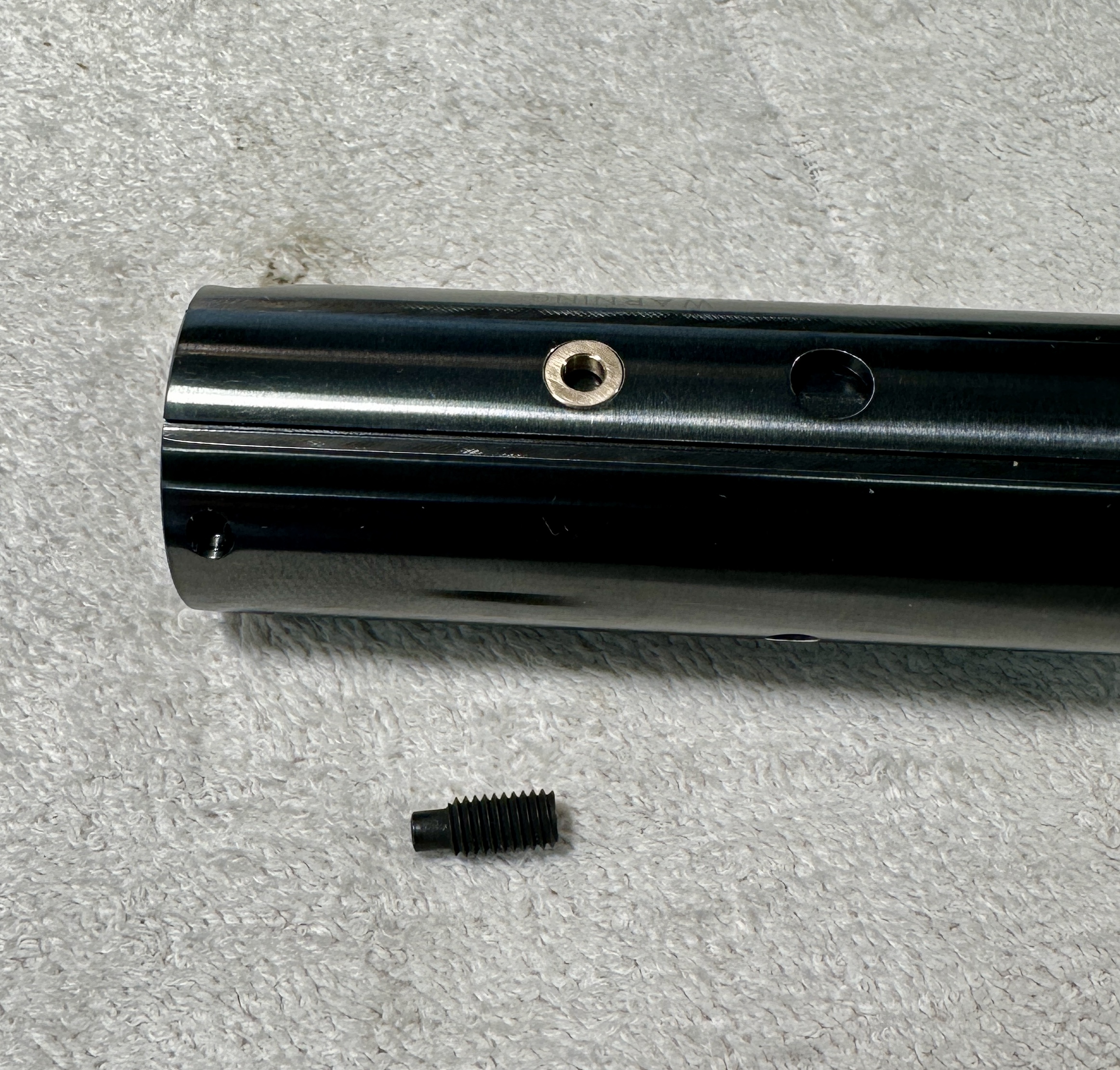

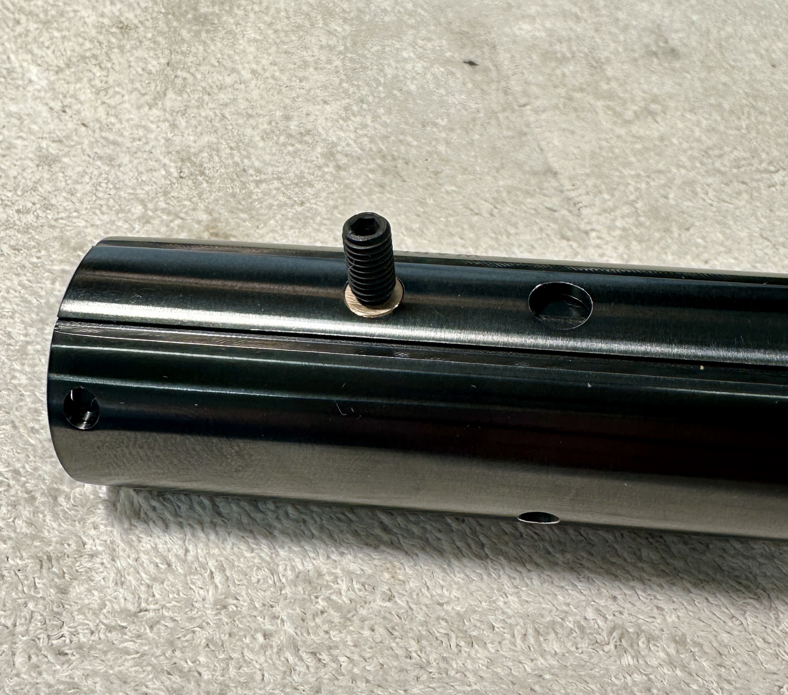

Maybe need to be 20 over spec..lol. I was just thinking about you, I have "my" HW30 torn down for a complete tune. And I just made a bronze bushing for the stop pin hole, so there's no movement at all. Also keeps from elongating the receiver hole, when being pounded by the scope ring, slipping on under torqued screws. Naw, I'm just poking fun, no harm no foul.I am 15lbs over torque specs for those rail screws.
I will drill, & tap, a grub screw in the rings to provide a lock pin, and lock them.
Nice! I like it!Maybe need to be 20 over spec..lol. I was just thinking about you, I have "my" HW30 torn down for a complete tune. And I just made a bronze bushing for the stop pin hole, so there's no movement at all. Also keeps from elongating the receiver hole, when being pounded by the scope ring, slipping on under torqued screws. Naw, I'm just poking fun, no harm no foul.

If you use typical lopsided side clamp rings will the screw hit the hole in the bushing?Maybe need to be 20 over spec..lol. I was just thinking about you, I have "my" HW30 torn down for a complete tune. And I just made a bronze bushing for the stop pin hole, so there's no movement at all. Also keeps from elongating the receiver hole, when being pounded by the scope ring, slipping on under torqued screws. Naw, I'm just poking fun, no harm no foul.

So far it hasn't been a problem. I made the bushing .002" smaller than the receiver hole, and I made the pin hole .002 to .003 bigger than the pin, so it has a little play. Anyway I line up the pin and get it started, then push the ring base to the rear to take out any play, and then tighten the side clamp. Then I'll screw the pin in till it hits bottom, and back it off 1/8 of a turn. I usually blue locktite the pin so it stays where I set it at.If you use typical lopsided side clamp rings will the screw hit the hole in the bushing?

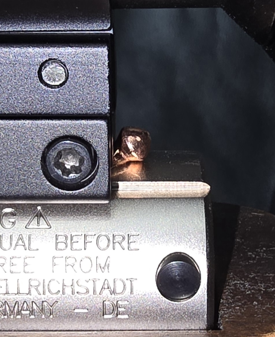

The exact location is going to be marked by copper streaks.If you use typical lopsided side clamp rings will the screw hit the hole in the bushing?
