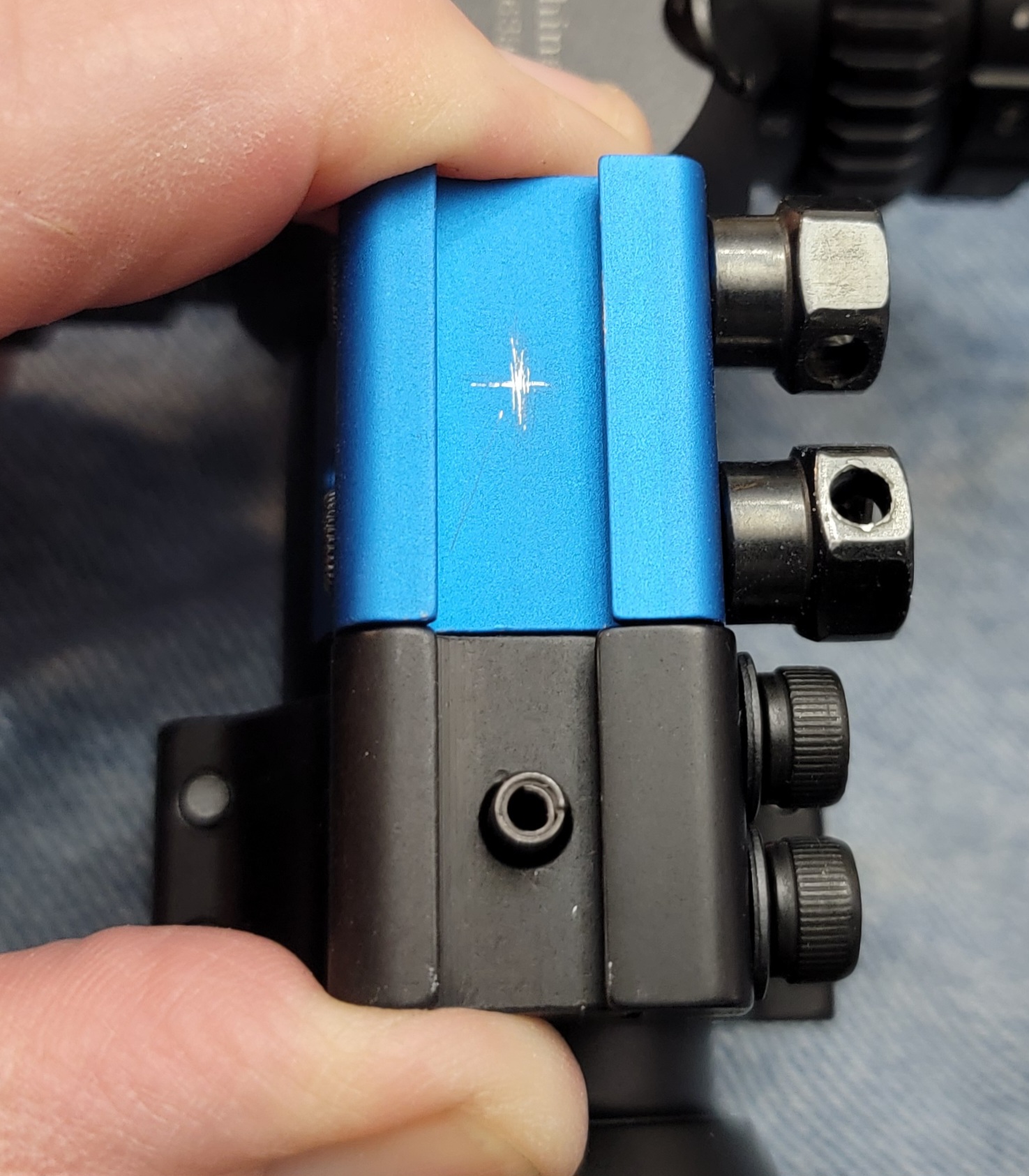

So far it hasn't been a problem. I made the bushing .002" smaller than the receiver hole, and I made the pin hole .002 to .003 bigger than the pin, so it has a little play. Anyway I line up the pin and get it started, then push the ring base to the rear to take out any play, and then tighten the side clamp. Then I'll screw the pin in till it hits bottom, and back it off 1/8 of a turn. I usually blue locktite the pin so it stays where I set it at.

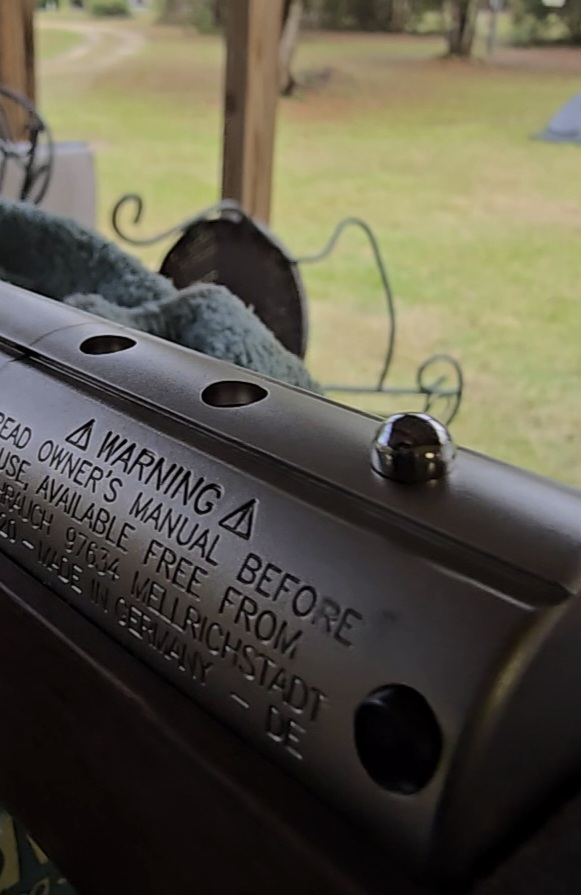

What is the diameter of the HW's receivers pin holes?
My original plan was to drop a chrome ball bearing in the pin hole that would be a tad taller than the rings so that the rings pinched and locked the bearing and the rings in position.

I imagine they vary somewhat, but on this HW30 they're .245 in diameter and about .100 deep.

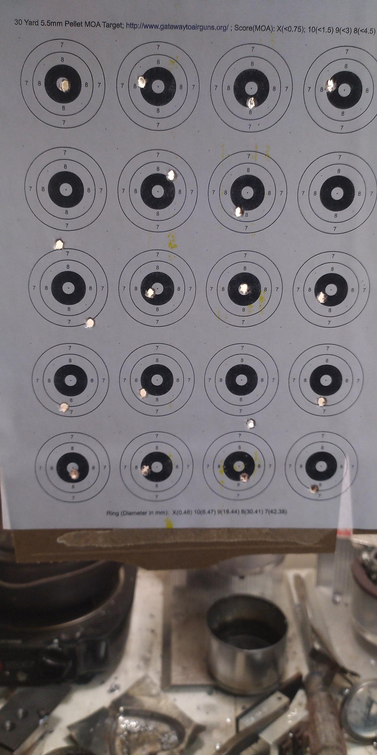

I switched to the 97 at 75y this evening as the sun was going down. I set 50-yard bench rest targets out at 75-yards and shot five 5 shot groups before it was too dark to see. I was shooting.20 FTT's. My best groups were 1 1/4" for two groups, 1 3/8" 1 5/8" and the worst, 2 7/8".
I like these little targets. They're close to the size of a Crazzy Eights paddle, and there are 20 targets + 3 sighters to a sheet. I was setting the scope between groups so placement wasn't on point. No 10's but I got 3-9's out of 25 shots. Lol

The ring to receiver clearance is .07. So a BB should just miss the rings if those measurements are correct? If so a .20 bearing would likely work.
A .25 cal bearing is ginormous on there.

Most rings don't have pins. Heres a West Hunter ring that I was marking to add a pin.
A 6mm ball bearing would give you .0045" per side of play.

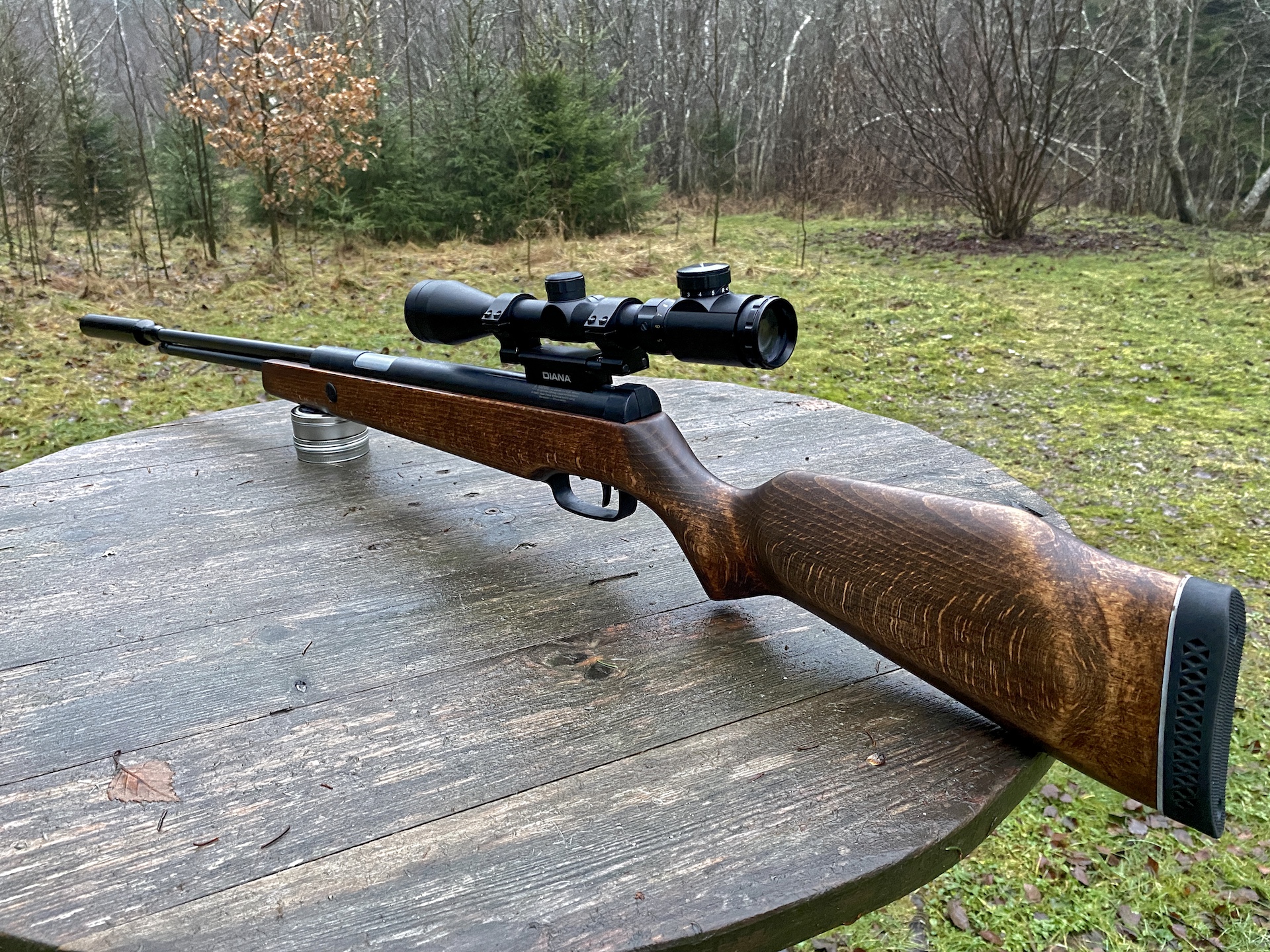

The weather has felt more like October than December this year, leaving few opportunities for shooting due to the rain. However, today I managed to take out my project rifle, the QB36-2. I acquired it specifically for tinkering and learning, and so far, it hasn’t disappointed. I had to redo the stock because the factory one was just a plain, square block of wood—especially the pistol grip section.

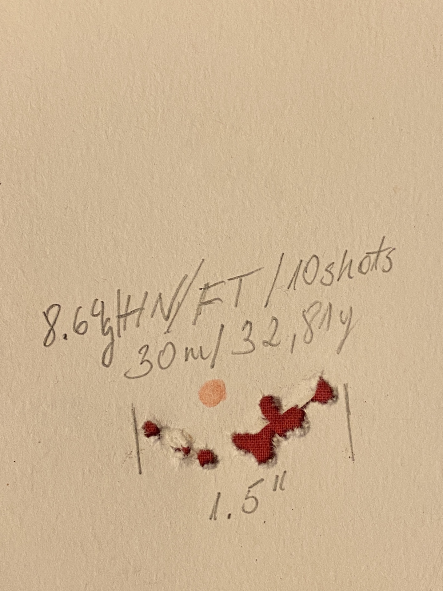

At 30 meters, using H&N Field Target Trophy .177 pellets with a muzzle energy of 11.88 fpe, the results weren’t too bad. However, I definitely need a better scope.
