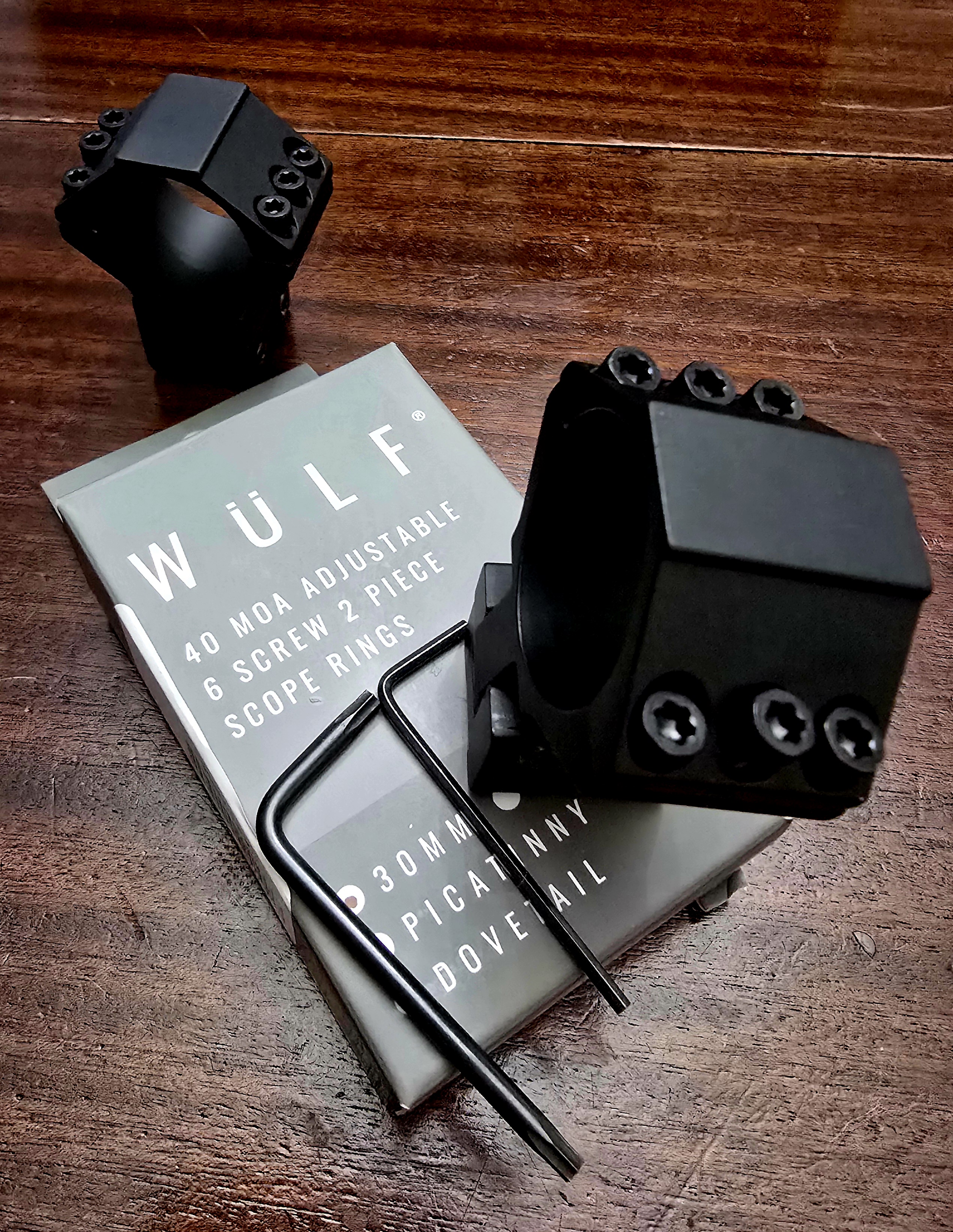

Actually The West Hunters have been flawless. I modified them from adjustable height to adjustable moa, and they lock on the rail, with a wide bite and bolts instead of screws.
the ones I'm having issues with is a Wulf 40 moa dovetail mount with screws. At the time I couldn't find any moa adjustable Sportsmatch rings.
He uses them for a specific reason. They're probably extruded from the same alloy. I would just clamp them tighter. If that ruins them buy something else and start over but that's all they probably need. I don't think Sportsmatch even makes a ring that offers the adjustability he needs.
Otherwise, they've been working out very well for HIS purpose.

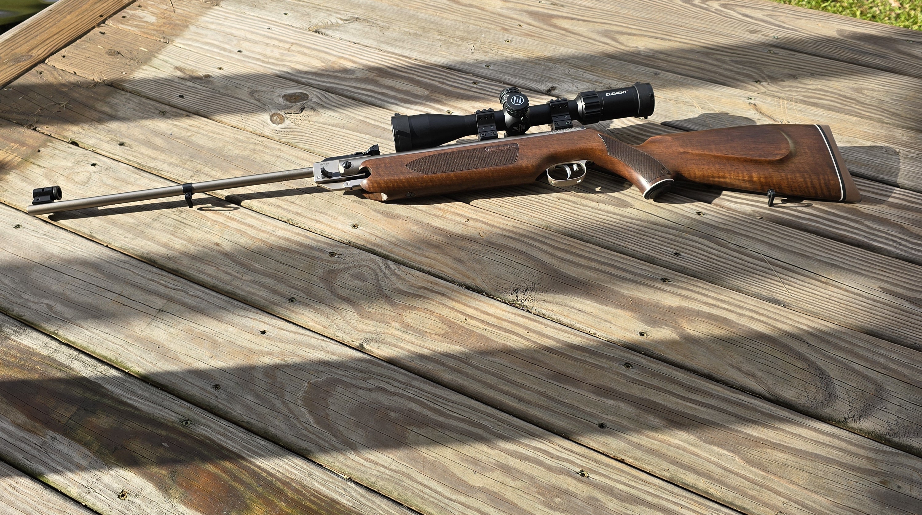

I would like to add that this 35e has the most violent recoil of my group so far.

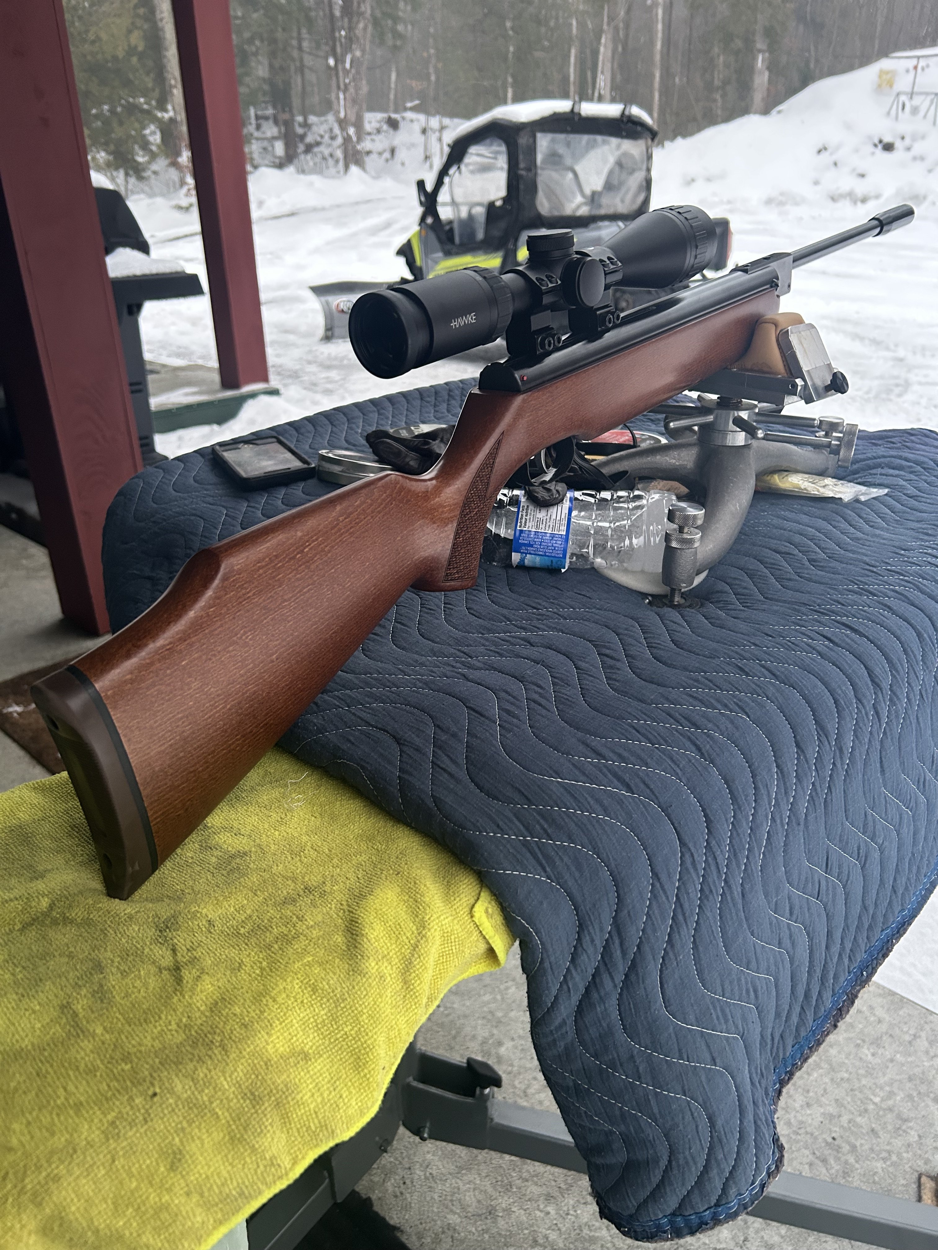

Finally got time to shoot. Mild crazy weather. This keeps up our trees are going to bud, about 5 months early.
This is a HW80 .25 with a Vortek plus in it. It’s a workout.
This is one of my tanks. Also shot a HW80 .22, no pic same gun. Much more manageable than the .25.
You might want to take it apart and check your piston seal. You might have blown it already. Our HW97K kicked like a mule -- ok. harder than a .308, maybe a .30-06 -- from day one. It blew out the piston seal, melted the breech seal, and broke the main spring within less than 90 days. I couldn't keep the scope from sliding back in the rings no matter what I did. The way yours is acting sounds like deja vu all over again.
View attachment 524076This is one of my tanks. Also shot a HW80 .22, no pic same gun. Much more manageable than the .25.
