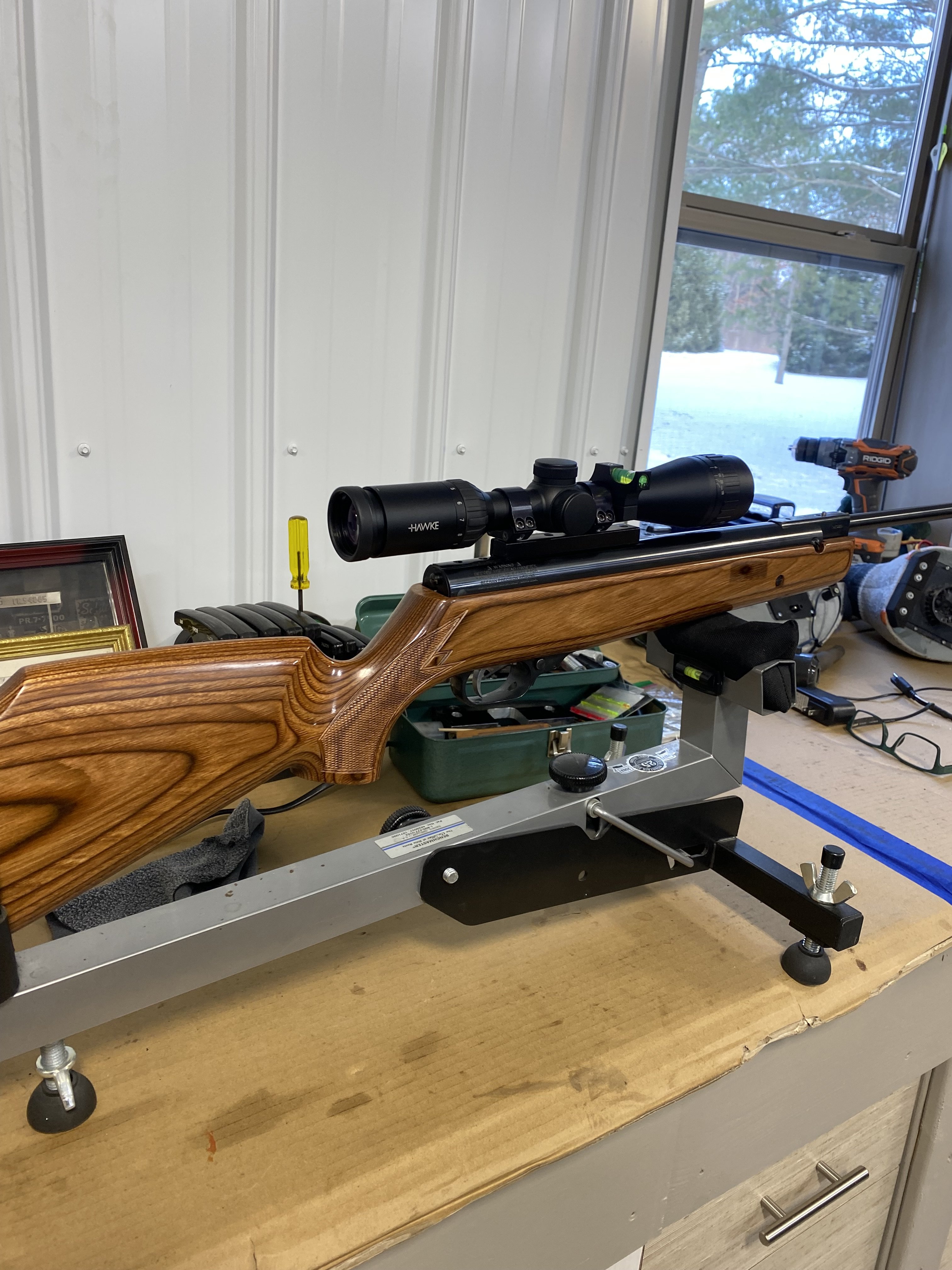

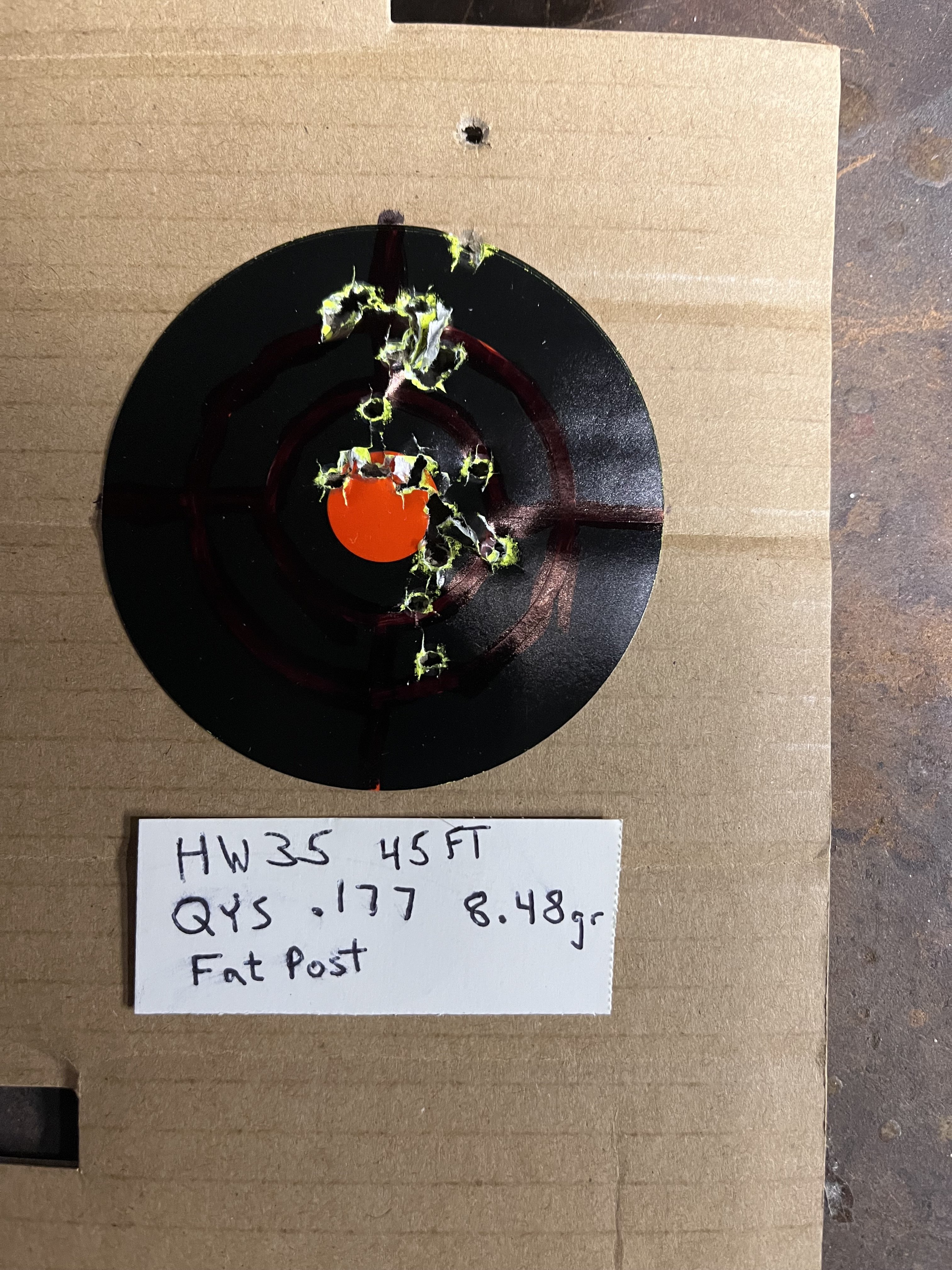

It started more like this with scope firmly against it.View attachment 523577
You think that the pellet is going to stop it?
Or does it get sheered off?

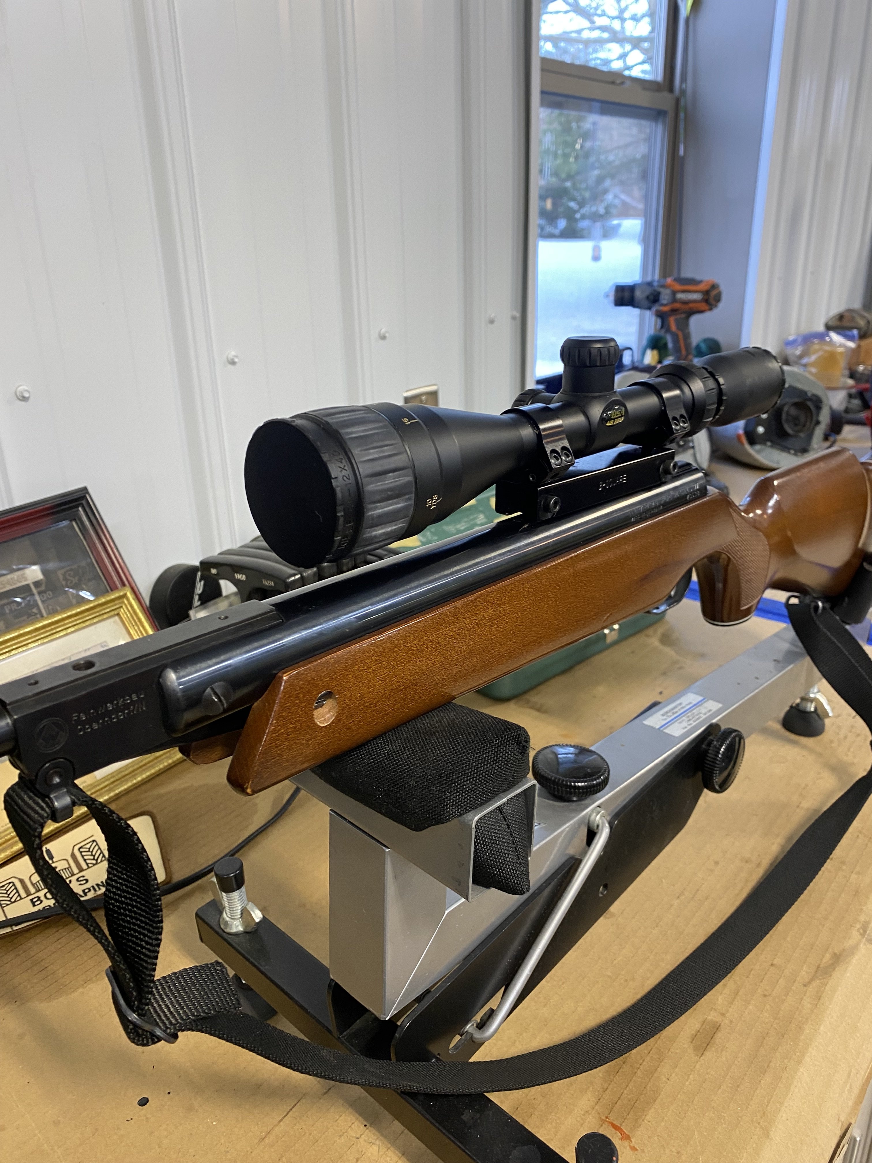

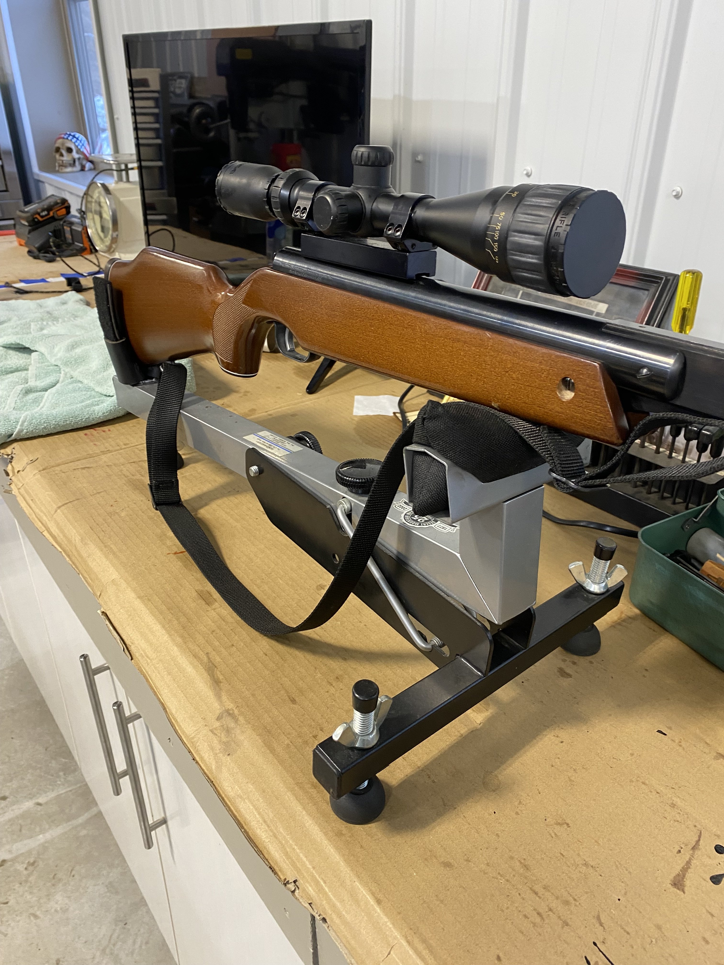

@20calguy - Friendly observation. Take it for what it's worth:
Several years ago, one of the more seemingly knowledgable guys on the list advised somebody that when he mounted his scope to his springer, to put the stop pin in the hole and then slide the mount FORWARD as much as possible before he tightens it to prevent it from slipping forward.
If you think about it, if you are assuming the greater recoil is the first recoil backwards into your shoulder, that should move the scope forward if it's loose.
Inertia would make the scope want to stay in place as the rifle recoils backwards underneath it, thus making it creep forward.
You have the opposite problem, just like I had with our HW97K. Our scopes slipped back - indicating the second recoil forward is the stronger recoil.
Mine was, and continues to be, so much stronger that it's literally broken the welds that attach the barrel assembly to the receiver tube three times so far.
Yes, it's literally broken our gun apart three times.
So, I could be all washed up here - I'm not the brightest boy in the world, and my thinking hasn't been as great as it could be lately - but it sure seems to me that your problem is with your forward recoil, from it not having proper air cushioning. And I don't know how your 35E is engineered, but you might want to at least examine it to see if there's anything it might break if you don't address the issue sooner rather than later.
Ours broke some sizable welds. These springers have some pretty considerable forces in them.
If you were to fire your springer without a pellet in the barrel, the piston slamming forward would be very much like giving the breech of your rifle a good hard smack with a hammer. If you have a leak or some other mechanical problem going on, that is essentially what you are doing every time you fire your rifle.
Or so it seems to me, for what it is worth.
Just a friendly observation. Forgive me, please, if my thinking isn't right here.

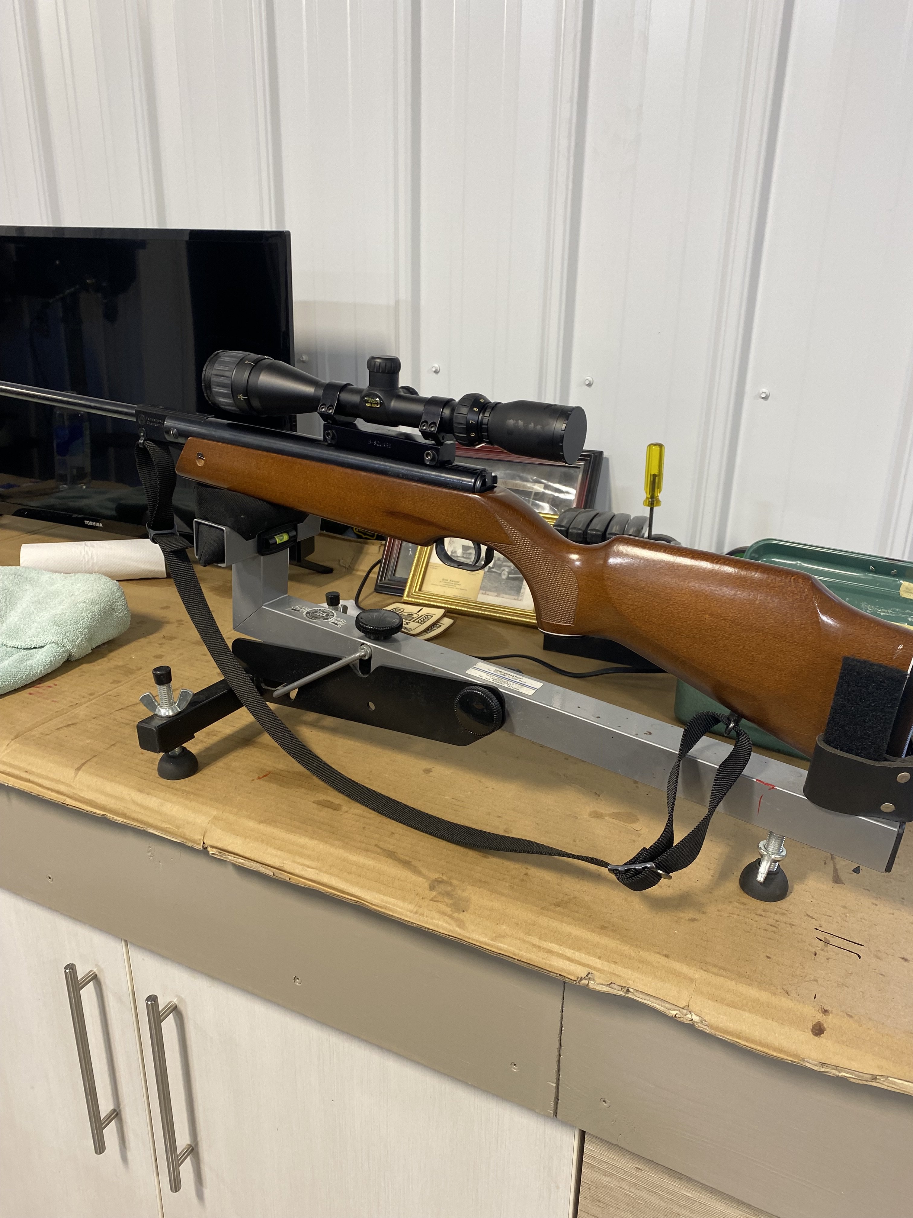

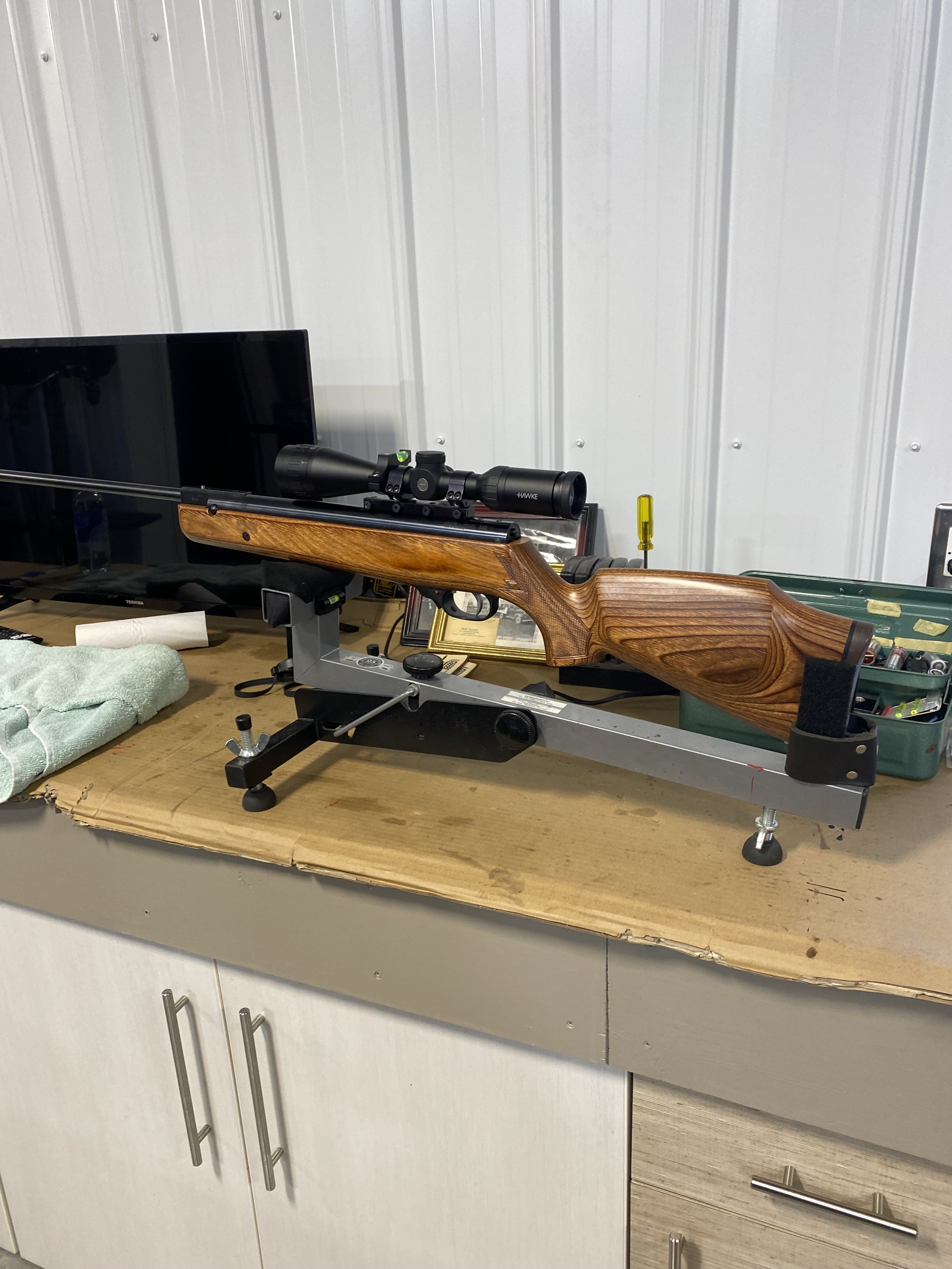

Just banging around a little.
QYS have some seriously wide skirts. Not very thumb friendly as far as seating them proper.
I agree on the 35's shot cycle. Makes the R1's tame in comparison. I need to move the 35, not fun for me.
I haven't shot an R1 in thirty years.
I really like this 35, though. It would probably be better for the scope if I were a hunter rather than a shooter, though. I shot it yesterday from sunup to just short of sundown, switching to the 97 for sunset. 👍

I appreciate your input, but all of my springers and gas ram go backward with scope or rail slippage? I have never had one go forward?
Maybe some more could chime in on the subject
When I install my springer scopes I always push the slack to the rear before tightening the base clamps. On powder burners I push the slack to the front before tightening the base clamps.
Works for me.🤔
Works for me.🤔
Yes, if the scopes went frontwards, regular hi powered rifle scopes would work on a springer.
Scope manufacturers had to support the scopes internals from the opposite direction, for springer use.
