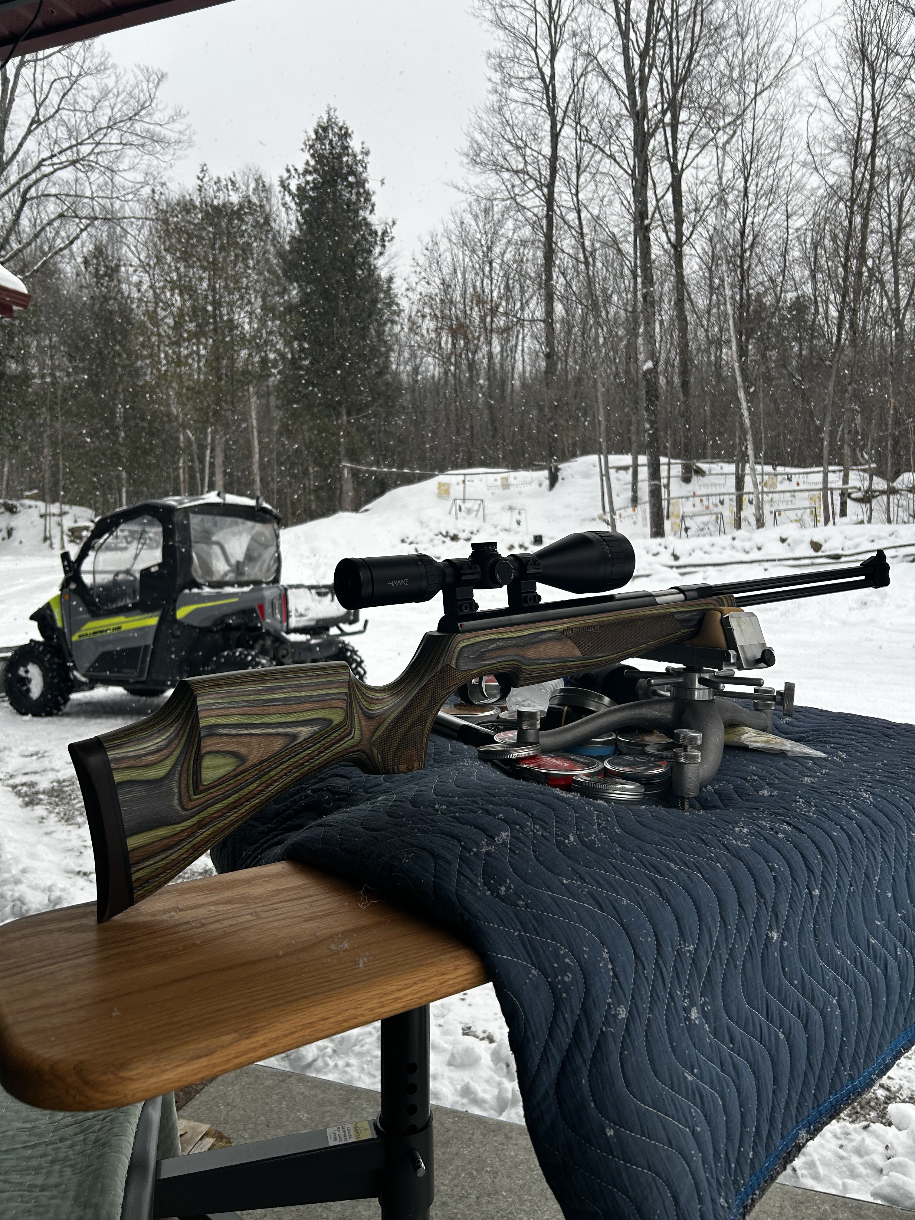

Shot a Diana 350 mag. .22 cal. “Killer”. Had it zeroed at 47 yds. Still packs a punch.
24F today with light snow to clear the background. Used the hand warmer, Hollywood.

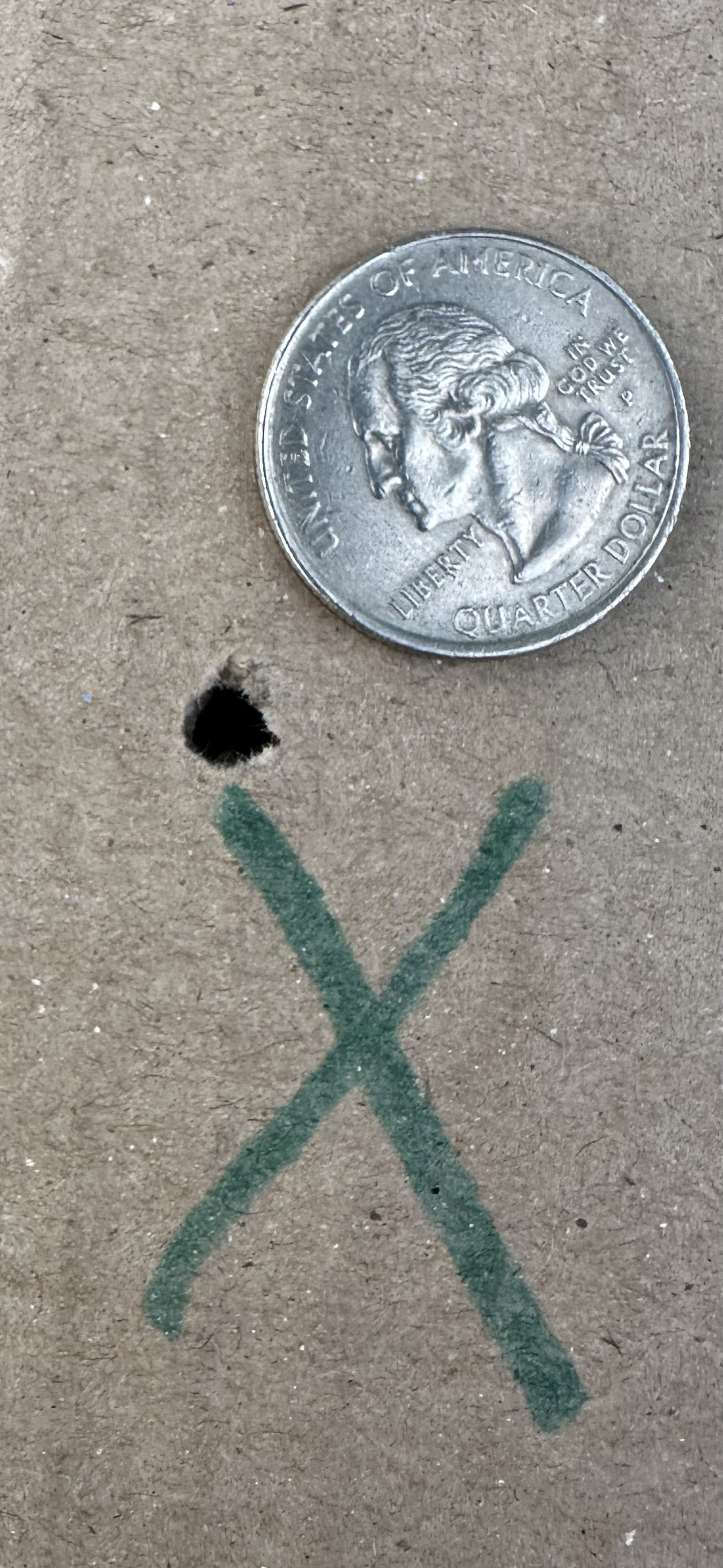

Second gun a killer squirrel gun a R9 .22. I was able to ring a bell through a 3/8 hole at 30 yds. If it didn’t go through, it was on the edge.

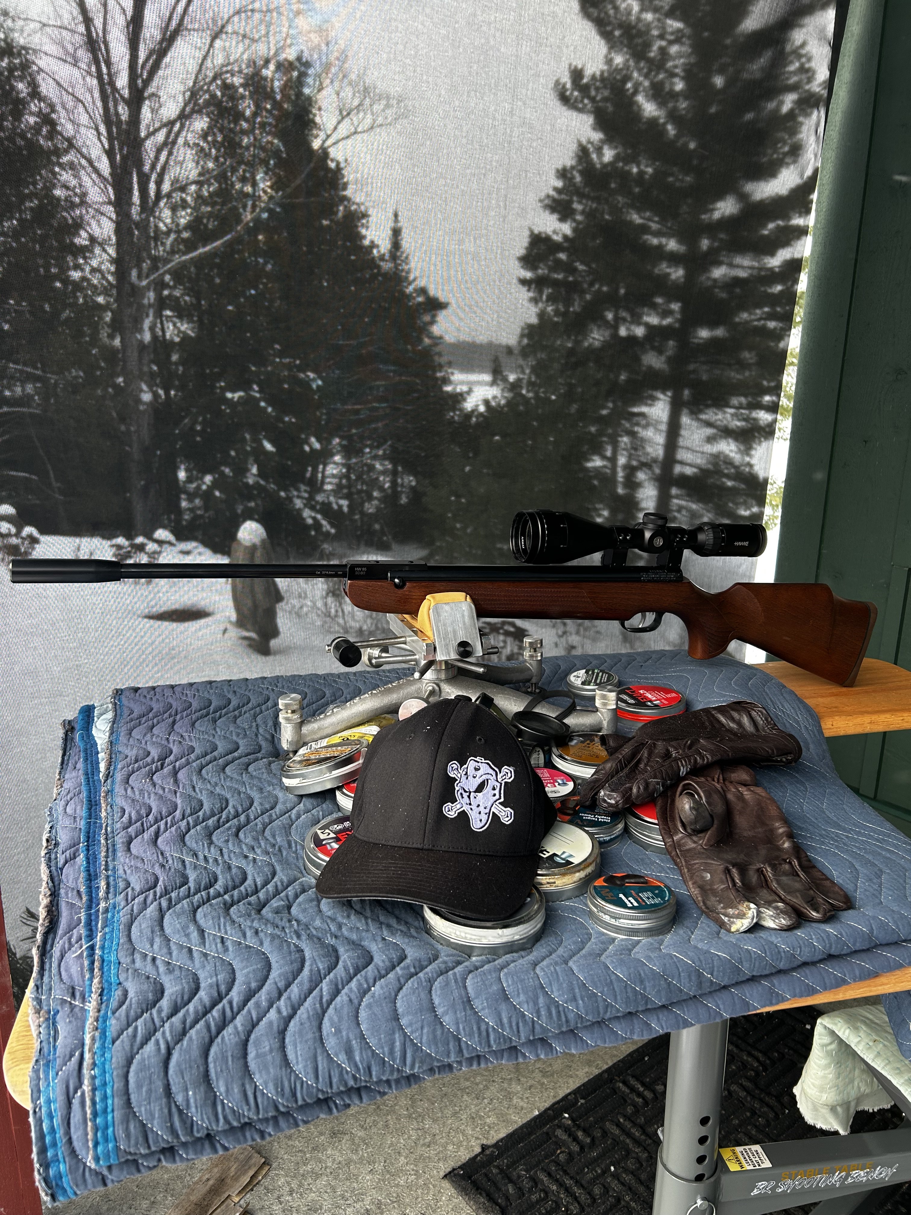

wear driving gloves as well on both hands but cut the index and thumb tips off left hand. The first to get cold. View attachment 529420There’s my painted gloves. I’m usually good for 1-2 hr. runs before I catch a chill. Once your hands are cold you’re done. I’m going to try that hand warmer tomorrow. Crow

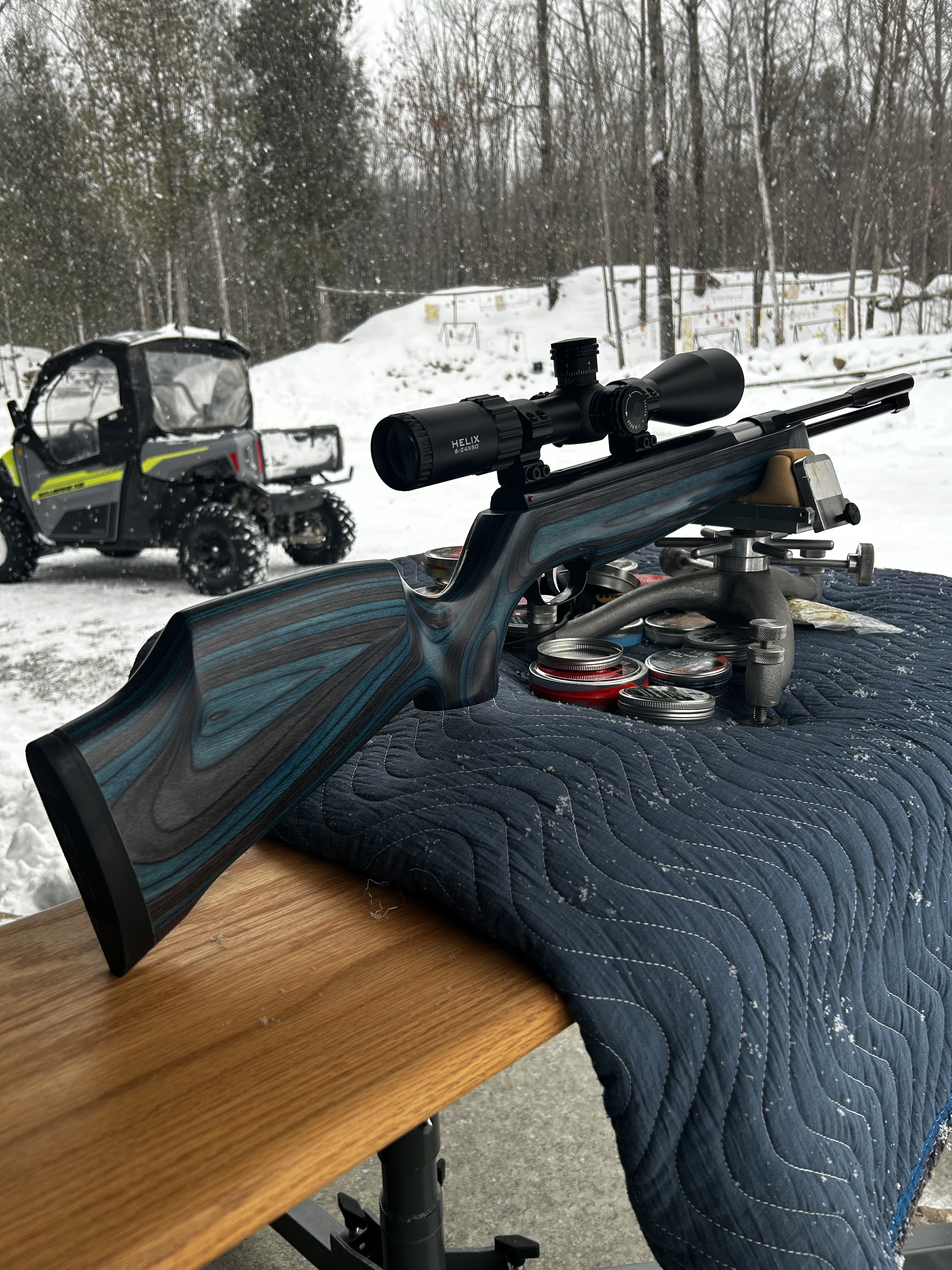

These two started this post a HW77 Special .177 and it’s special.
And this HW97 .177. I think this has a 12 FPE spring.
Almost like a delay shot but accurate. I’m getting more of these 12 FPE springs.
Amazing accuracy. I could hit a squirrel 🐿️ in the ear lobe.

These two started this post a HW77 Special .177 and it’s special. View attachment 529636And this HW97 .177. I think this has a 12 FPE spring.
Almost like a delay shot but accurate. I’m getting more of these 12 FPE springs. View attachment 529639Amazing accuracy. I could hit a squirrel 🐿️ in the ear lobe.

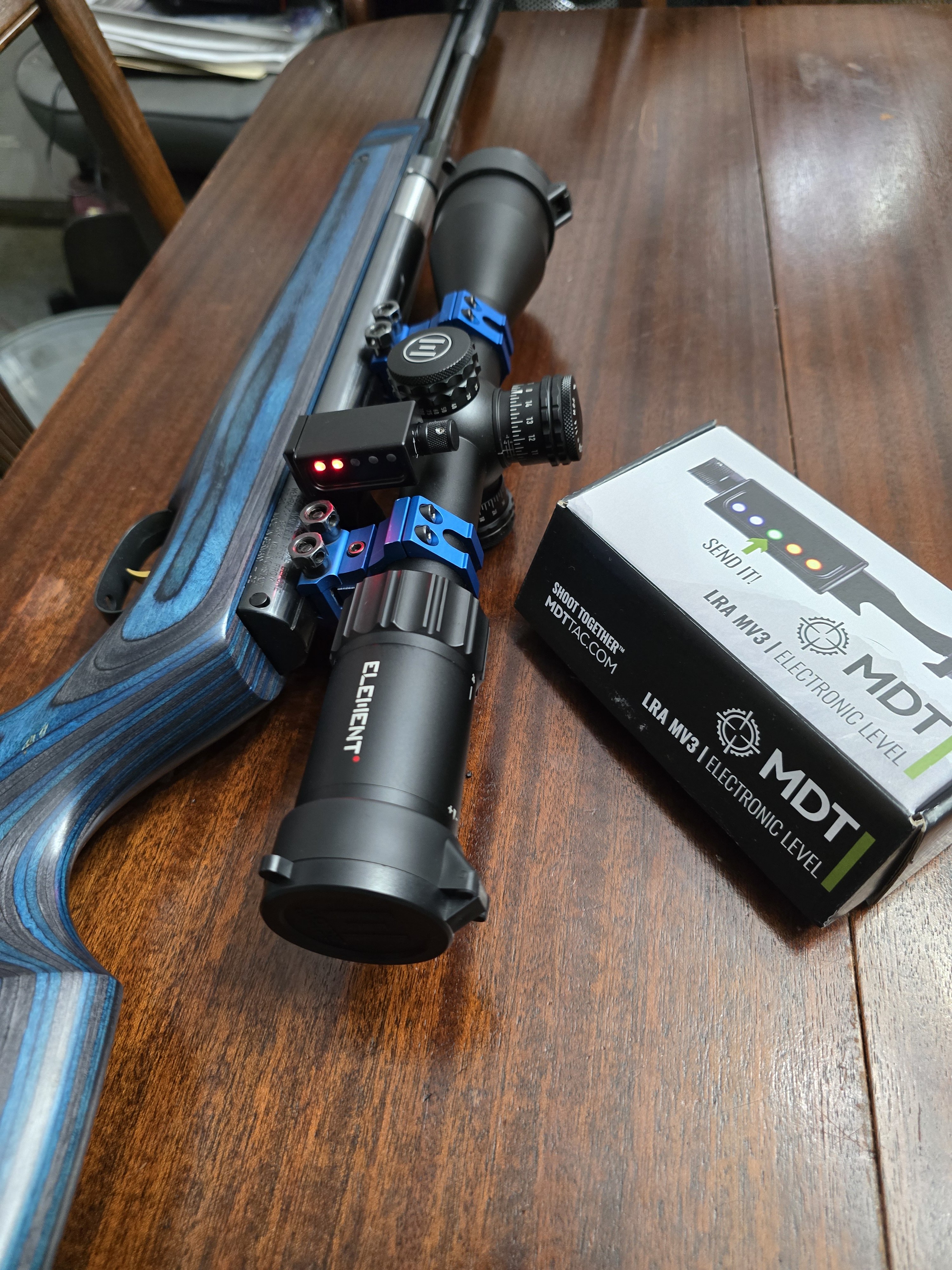

I really like my MDT level. It currently resides on my AAA EVOL…
