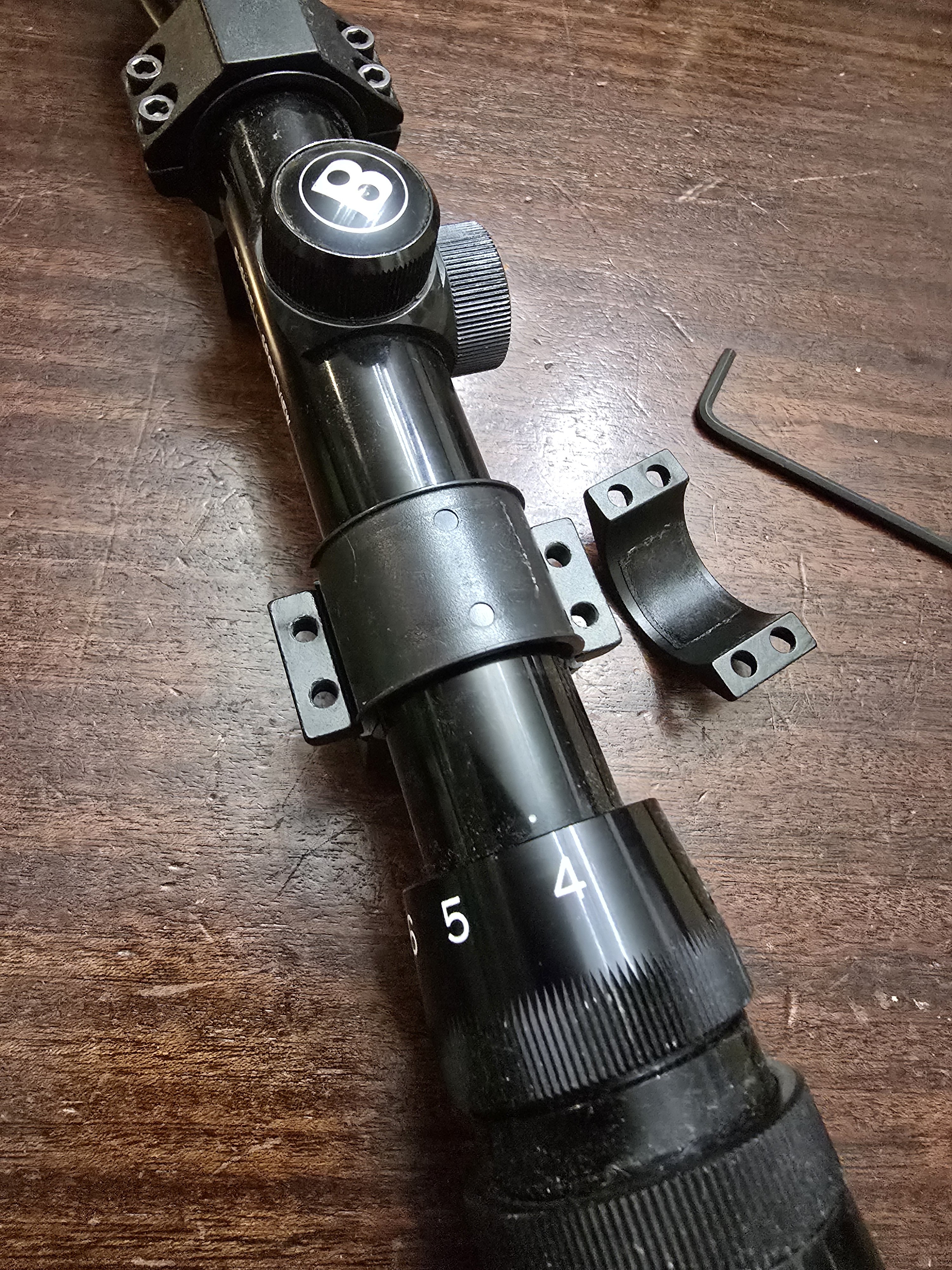

Dovetail, I could go with the picatinny adapter. Stupid me actually didn't think of that. Maybe I'll order a pair to keep my options open. Thanks!
This is the adaptor I have on my prosport and 97K. With low rings it really doesn't make that much difference, and since using them I think it actually helps with my long shots.

Thanks, I have one of those with a smaller footprint and two even smaller ones that fit one ring. So I ordered the Signature Rings in 1" with the Weaver attachment. Thanks for the idea. I guess I'm a little slow today ;-)

Only thing about that adaptor I showed is it's a mount and forget. They don't like being taken on and off a lot. Aluminum threads don't last when squeezing and then using to open the clamp up.
Still they work good.

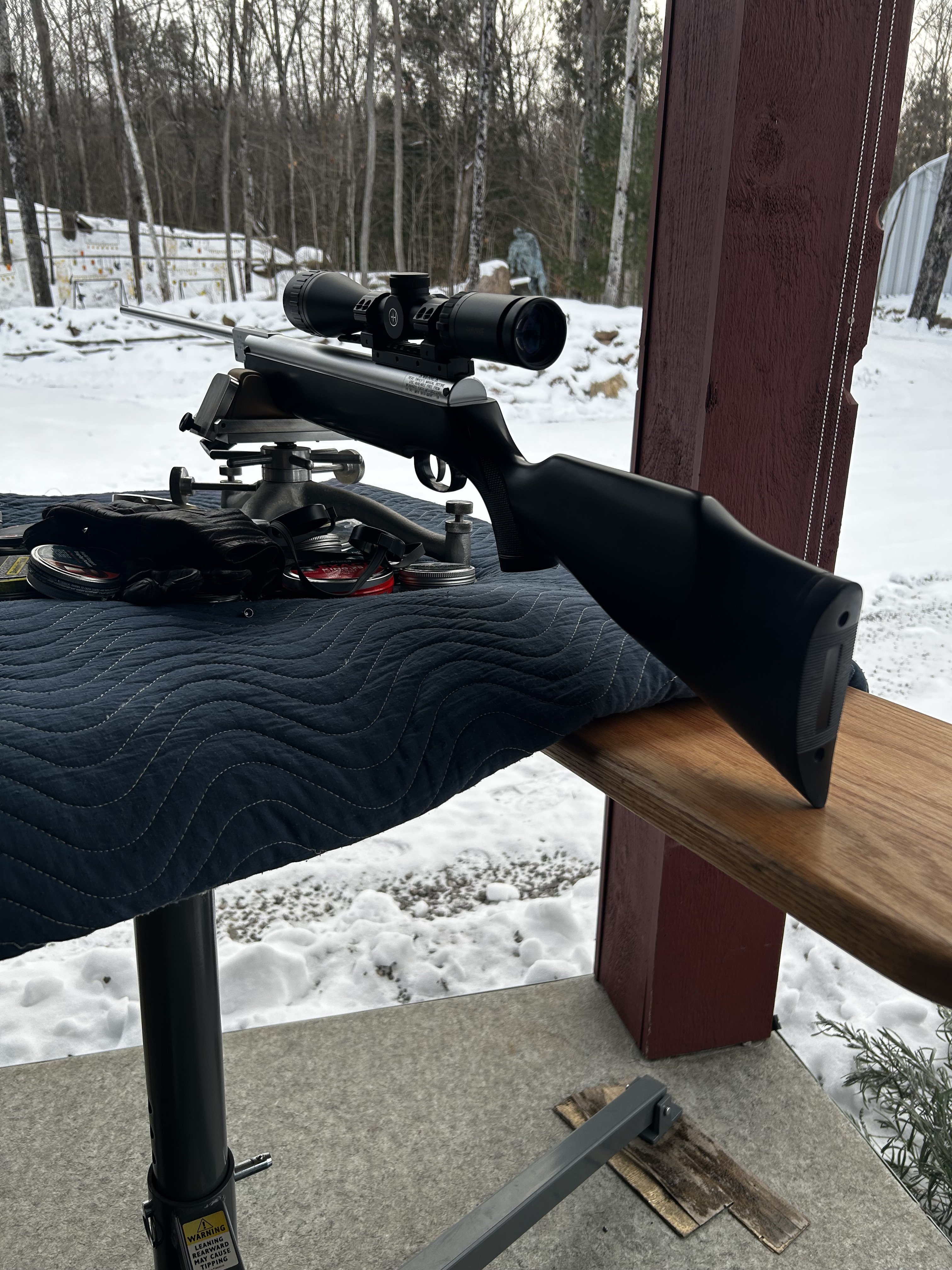

Shot only one this afternoon. Didn’t get above 20F. This is the rifle that got me hooked, now I have it. HW80 .22.
This gun is very accurate. Never been opened. Crow

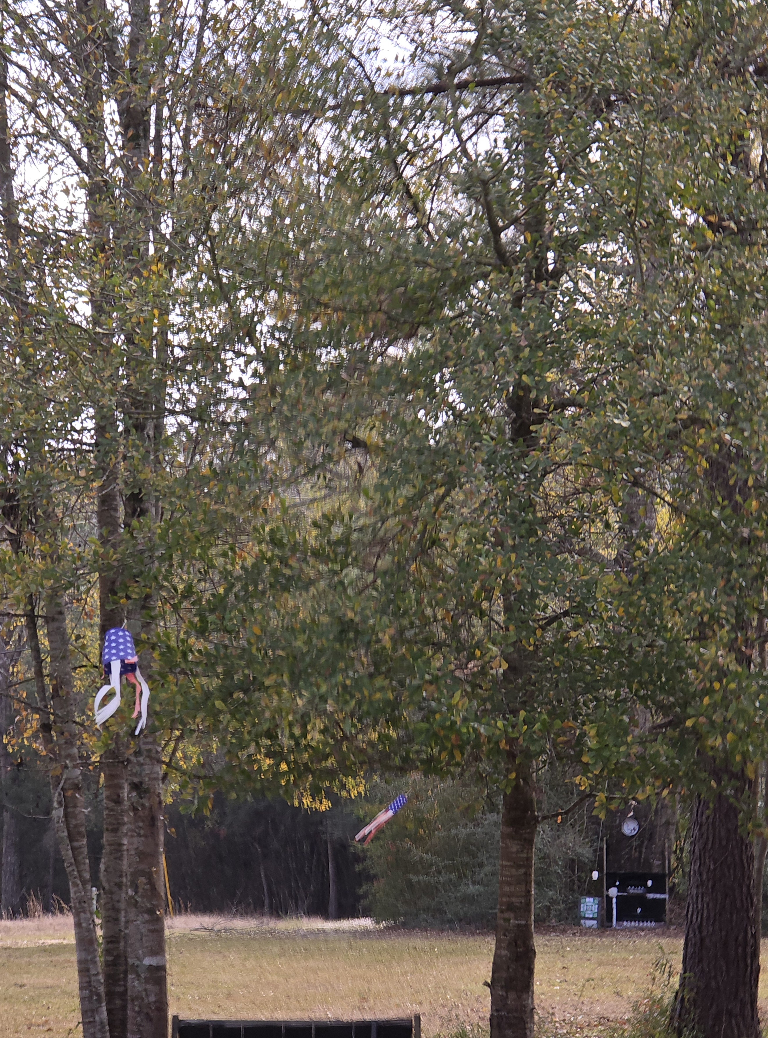

The wind was challenging, but I managed some pretty good Kentucky windage for a Louisiana raised Michigander. 😁
That hanging med bottle at 75y is on a long string. It hangs directly under the white pan up on the tree trunk. When the wind lays down.
You have a nice breeze going there.💨💨💨

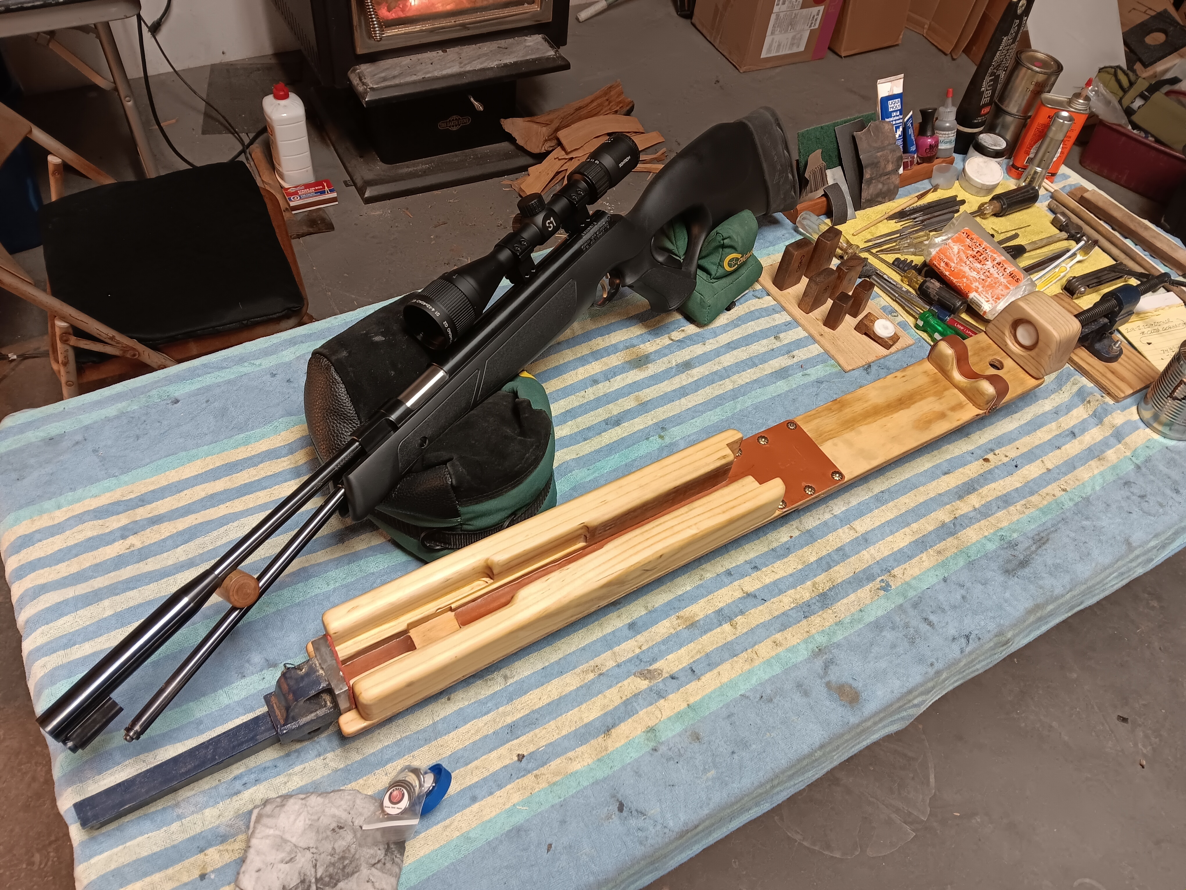

Rebuilt the 'ol 97 .22 with a Tinbum full power kit.
It's settling in about 670 fps and shoots great. I've got about 60 shots through it in the cold howling wind. Quite an improvement over the (3) factory springs.
It was quite a job threading the breech plug on there under preload. It had me sweating pellets for a few minutes. It's a whole lot more involved than the breakbarrels....
Yes it is, is this the first time you've done one?

Yes. The first time.
I couldn't get enough grip to turn the breech when I got it up to the threads. It sits low in the compressor and i couldnt get my fingers around it. I needed a little strap wrench or something. I had a chain tong but that wasnt happening...
I improvised by using a tow strap with a plastic buckle stuffed in the trigger slot and a wrap around the breech. Once I got enough force to twist it to start the threads it went right on.
I'm making a hardwood block and a nylon strap that will make it an easy job. It took me 30 minutes to figure out what I needed to get it screwed on there. Once I decided on a strap around it the plan came together and things went together smoothly.
An impressive amount of preload. It's a bear trap in a pipe even when it's not cocked.

I see guys on youtube just leaning on it and screwing the plug in. I knew mine was going to be different. I'm glad I was prepared. Without a good jig to hold the gun and a tool to help start those threads it could turn into a disaster. The other rifles I've done are simple by comparison.
