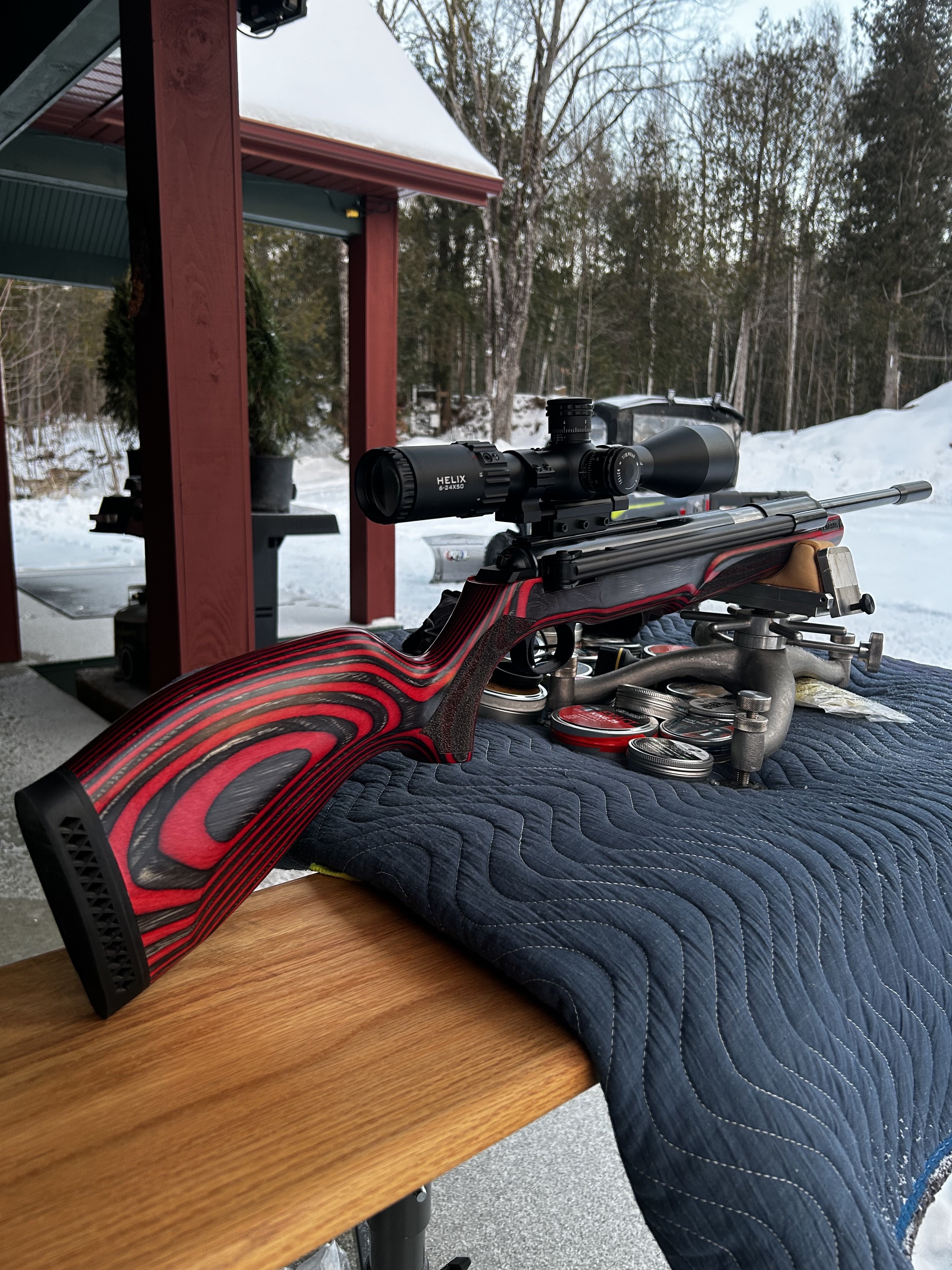

I'd does resonate a little. The limbsaver pad helps a whole lot.
I'm tempted to squirt it full of "great stuff". I really like the synthetic stock on it. It can be a little hollow sounding. It's not a big concern but the next time I have a leftover can of spray foam I'm going to fill it up.
The spray would be a problem if you didn’t like it. Just Stuff it with foam rubber or rags. Easy to remove if not liked. Crow

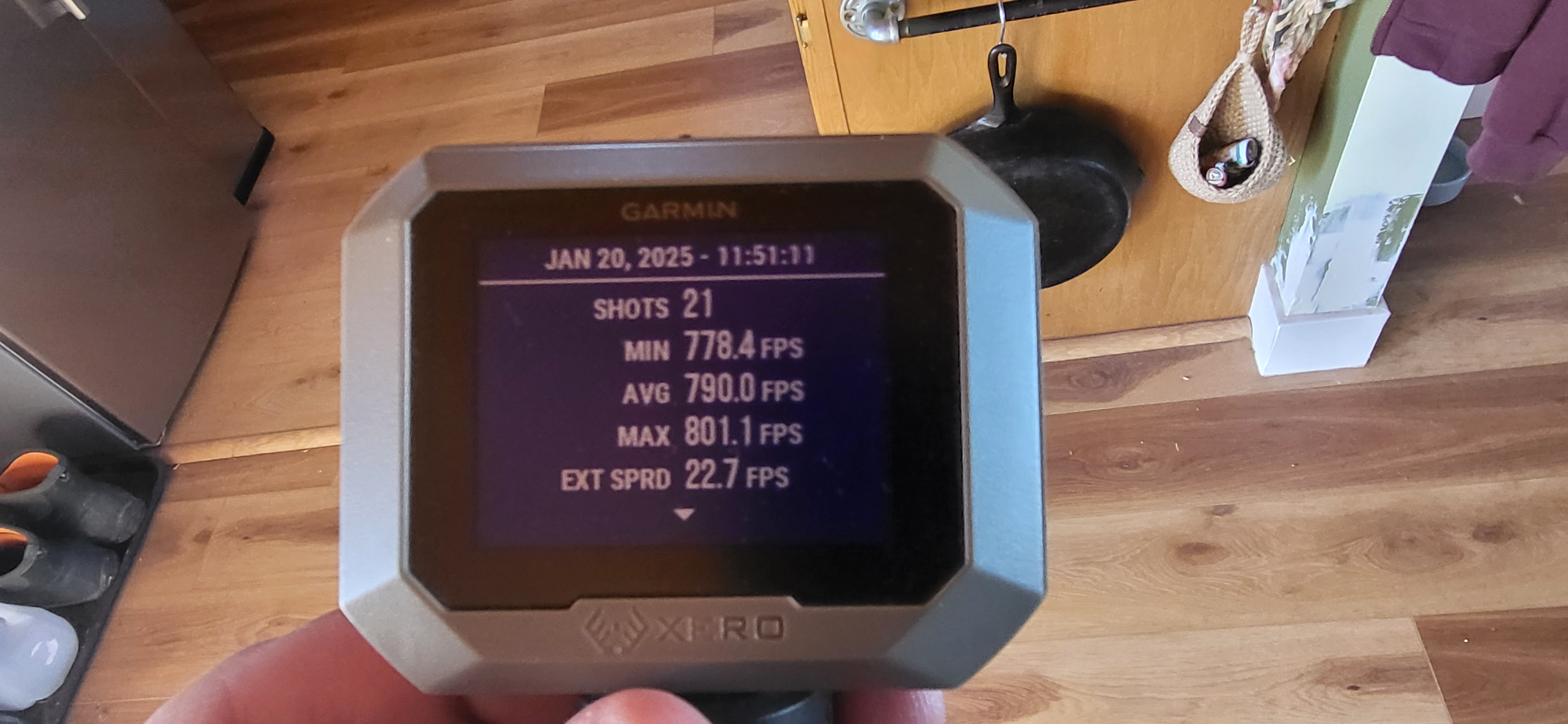

I couldn't take another day indoors. I went outside long enough to shoot the new to me 77. It shoots nicely. I have to get used to it missing a button release for the cocking lever. I only lasted 21 shots before my fingers hurt.
Very nice gun. I found that same problem. The push button sure makes a difference. Especially in the cold. I rarely use my TX’s in cold weather, same reason.

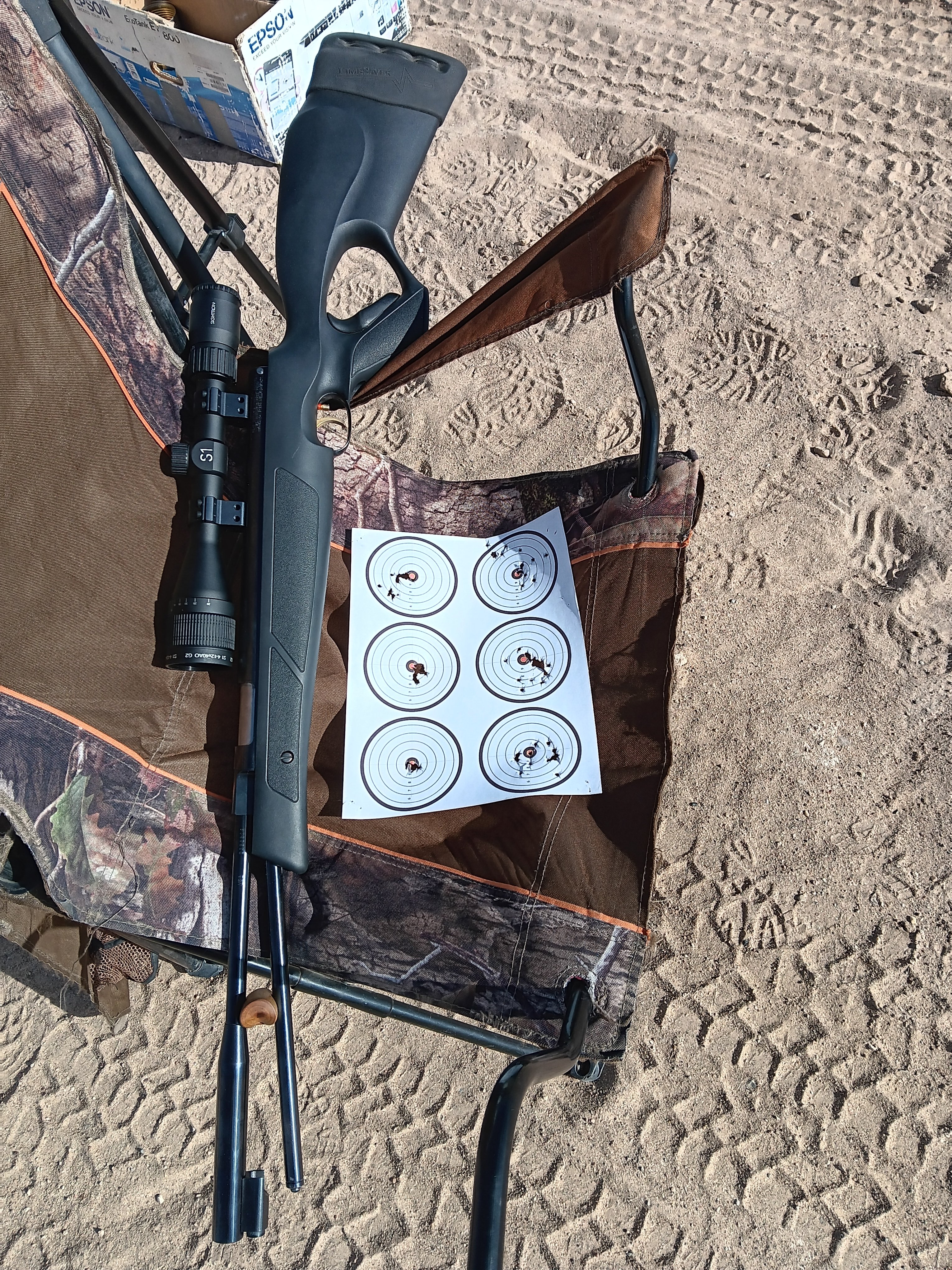

I got the 'ol 97 broken in at 250 shots. It's hammering the H&N 14's at a steady 680. Sitting in my broken lawn chair shooting off a camera tripod.

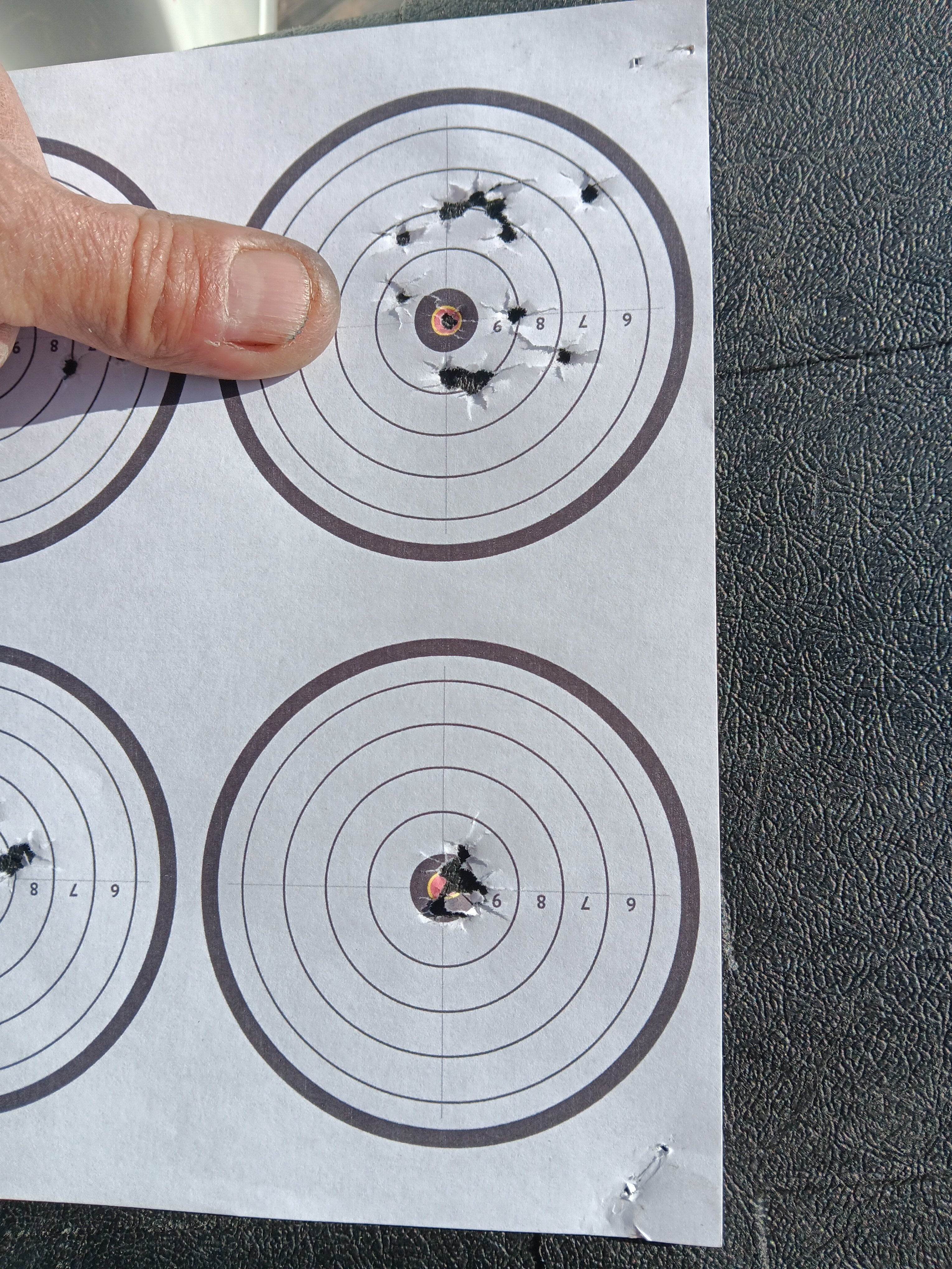

Beautiful breezy day 5-10 mph. About 40 degrees. The three targets on the left are at 25. On the right 50. The outside of the black circle is .o40.
The top four I was playing with different pellets and getting sighted in. The bottom two are H&N FTT's. Five shots at 25 on the left. 15 @ 50 on the right.
The wind was really tossing them into the corn at 50. The rifle will shoot much better on a calm day from a solid rest.
The gun shoots great and I'm really happy with the Tinbum kit. The rebuild has been a success!
