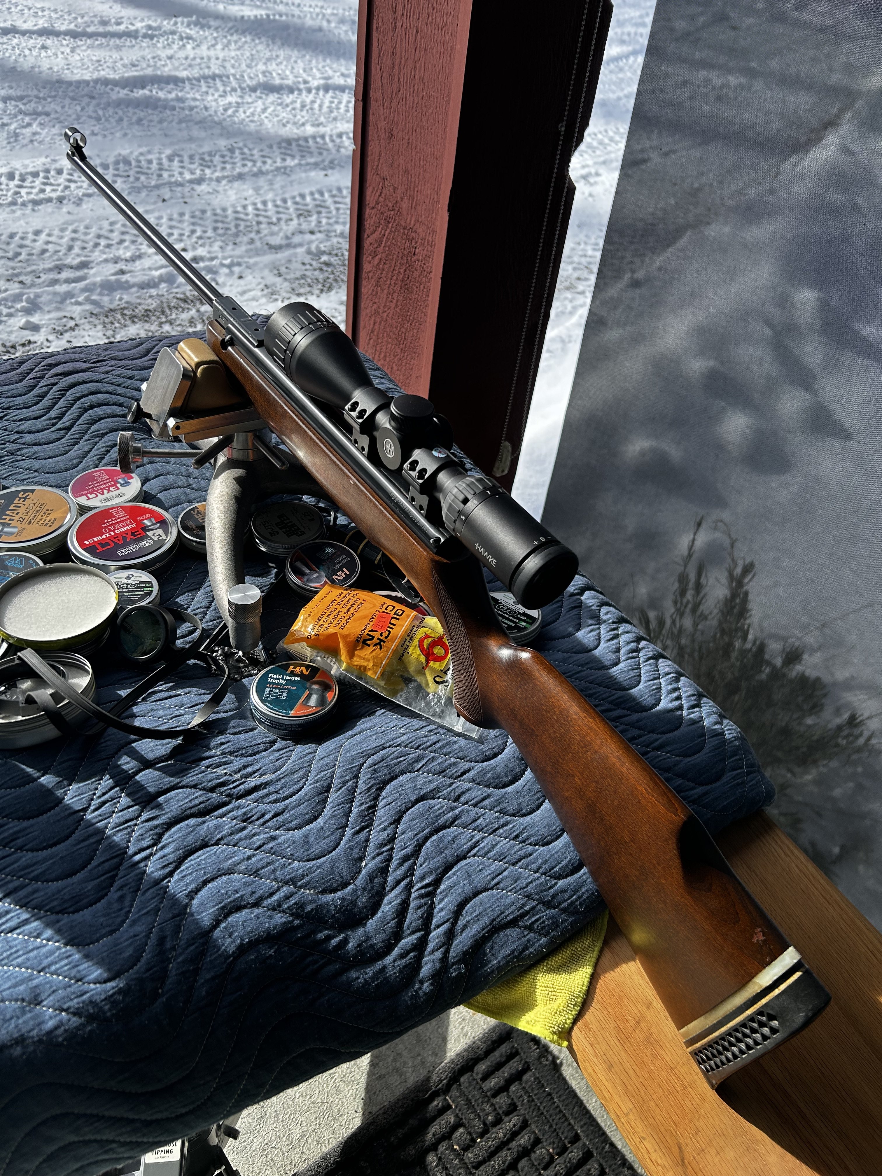

Shoot my NTM (new to me) 77 today at 25 yards. A bit of twang and 12fpe. The 66R Blue Ribbon scope zeroed with no problems but I'm not liking that you turn the whole eye piece to adjust magnification. The focus adjustments sometimes loosens when increasing the magnification. It may be up for sale soon. Maybe on a R8 lol.
It still felt good to shoot for a little bit today. It's 40F and cloudy today but felt colder to me so I quit early.

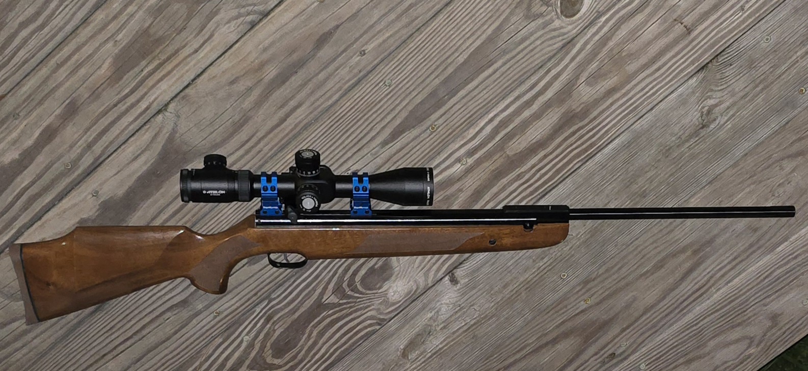

On thing that amazed me about my Blue Ribbon scope is that it is able to dial zero from 30 to 75 yards without any help from moa mounts. It still has its original Beeman mounts, mounted on a Webley Tempest..177.

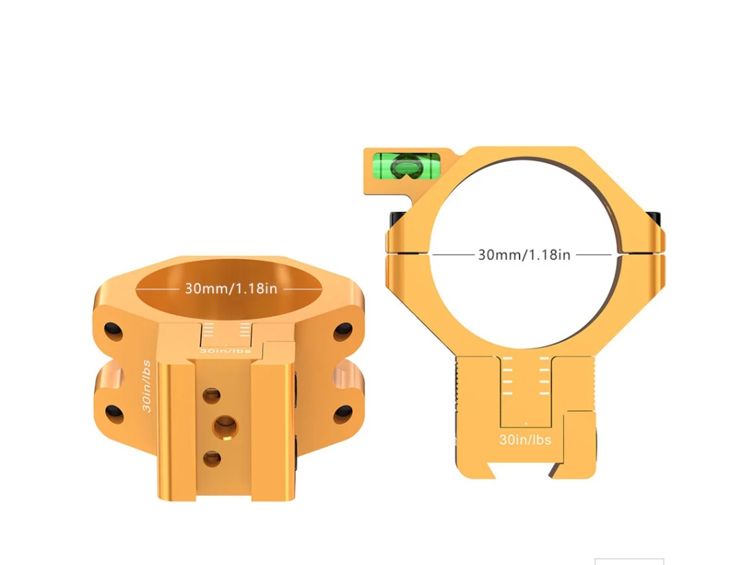

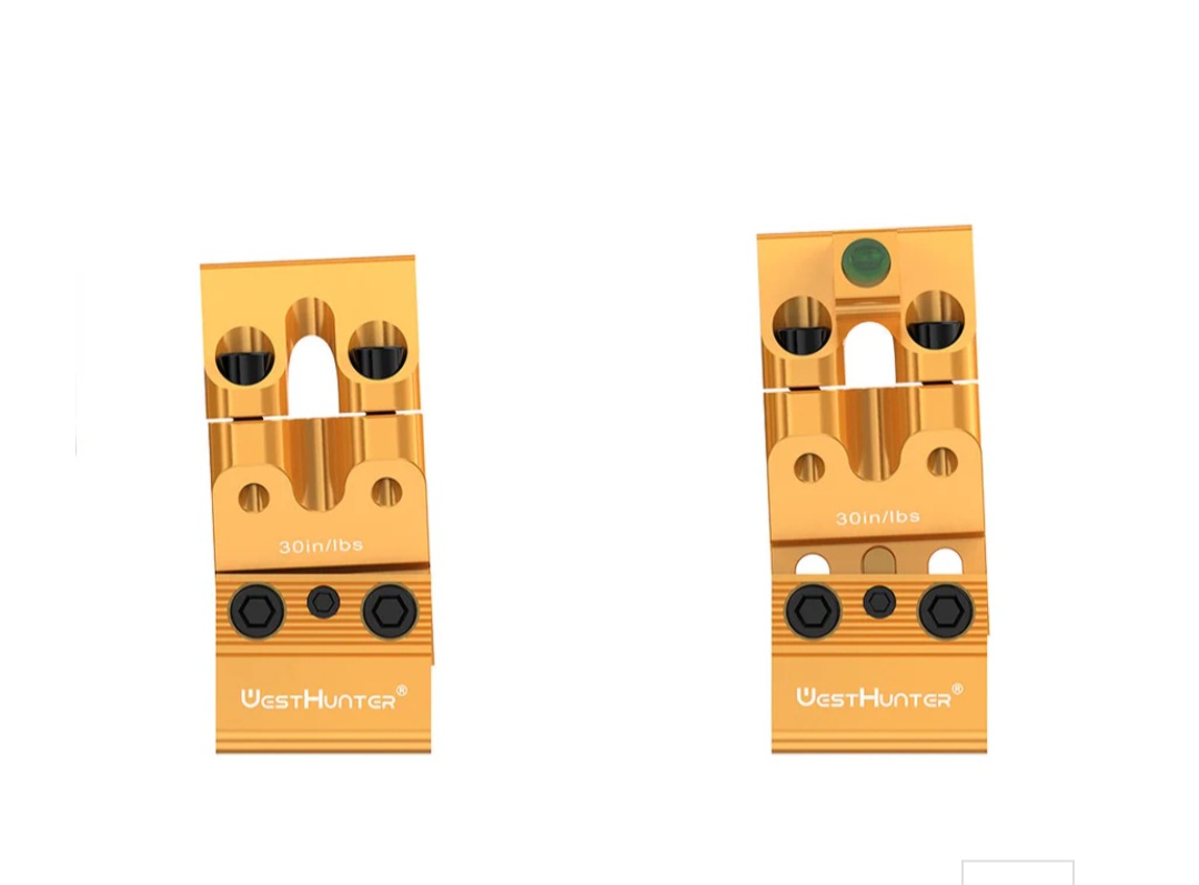

West Hunter has come out with a set of rings designed for springer shooters.
Its a dovetail mount, height, and moa adjustable, with a pinned rail, pinned moa lock screw, its inexpensive, (29.95) and a good-looking set of rings.
The problem is that they are 30mm and come without the adapters. So you would have buy a set of those.
They also come in 34mm.
Notice how the scope tube angle is maintained on both rings insuring no pinch spots.
Rail pin.
Its a dovetail mount, height, and moa adjustable, with a pinned rail, pinned moa lock screw, its inexpensive, and a good-looking set of rings.
Rail pin.

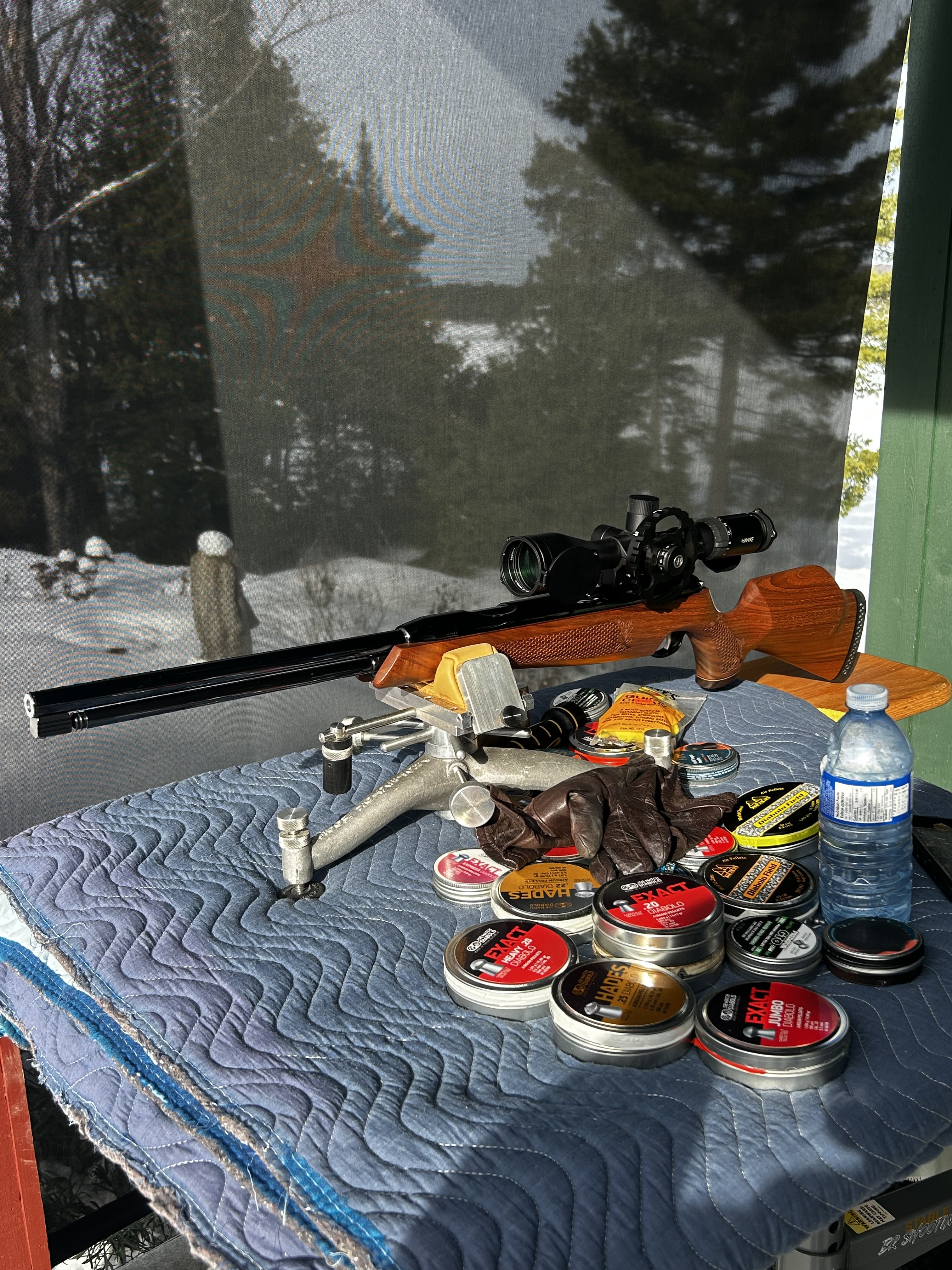

Another sunny day with wind so I drop the blind. Makes all the difference in the world. Started with my first TX 200 .22. I find the .22 cal. so much easier to handle in the 200. You can see the blind working.
Next up a R7 .177. Absolute awesome day shooting. Was talking to a member on the horn for 30 min. while shooting.
Gun is accurate at the 47 yd. mark. Crow
