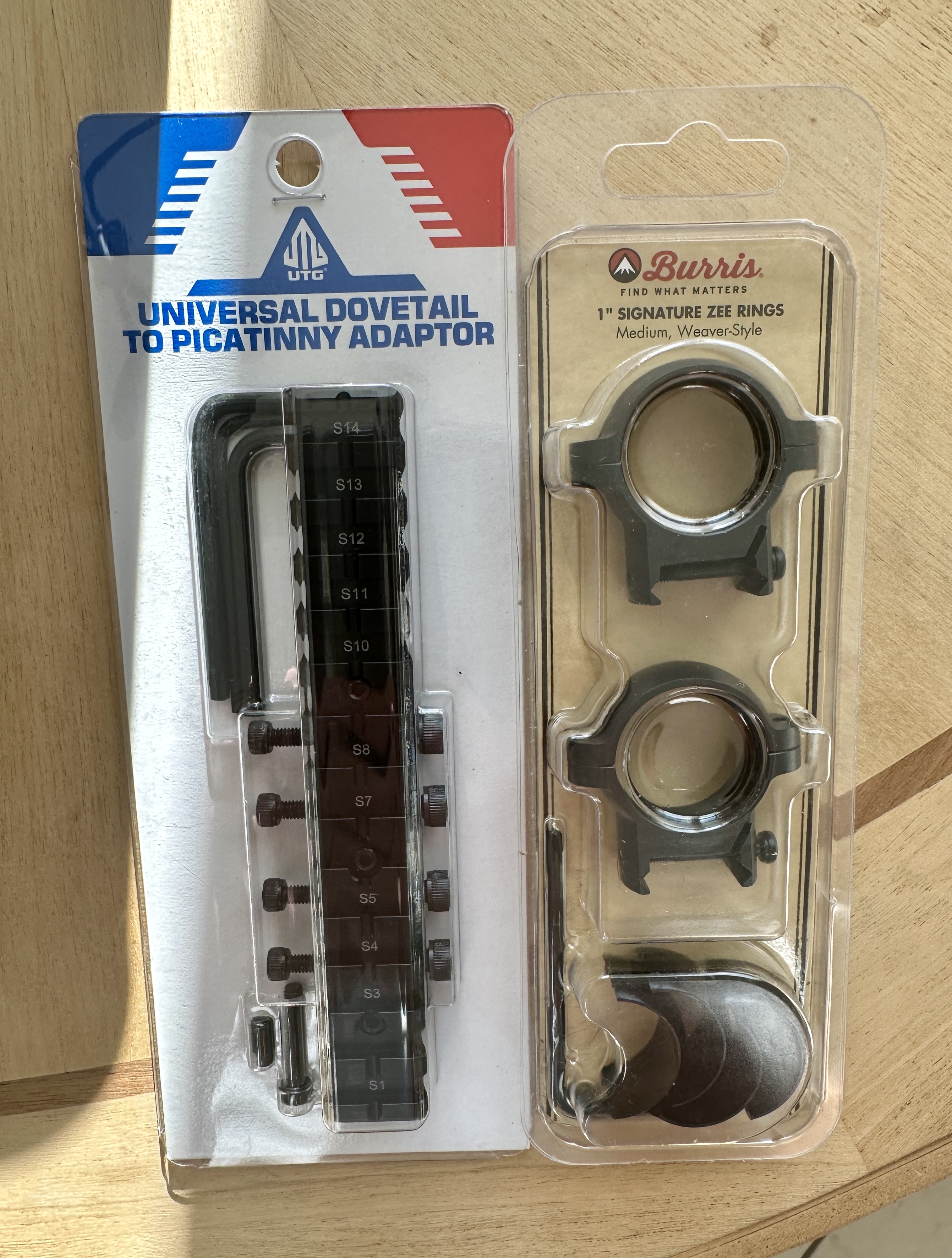

@.20calguy I already bought a set of those Westhunter rings to try, but the Burris rings solve the problem in a different way, as @bustachip describes. I think if I raise the back and lower the front the MOA gain should be additive. I can see how the distance between the rings would change the math...I will try both when I can just to see how it works. Cheers!

I don’t know if any one gets my point on the grip of the rings. If you clamp a tube in a ring it is going to point the tube in a particular direction. The next ring has to meet the tube where it is and match that direction. Otherwise the rings will have pressure points along the edges.
What has been described would need its clamps mounted on a hinge system similar to a drive shaft U joint to be able match angles from different positions, or be mounted in some kind of flexible gel.
A way to see it would be to set up a gross adjustment of 1/4” offset of two rings and expect a smooth clamping of the scope tube.
Although I have a mental block Ill go look at the Burris design. 👍

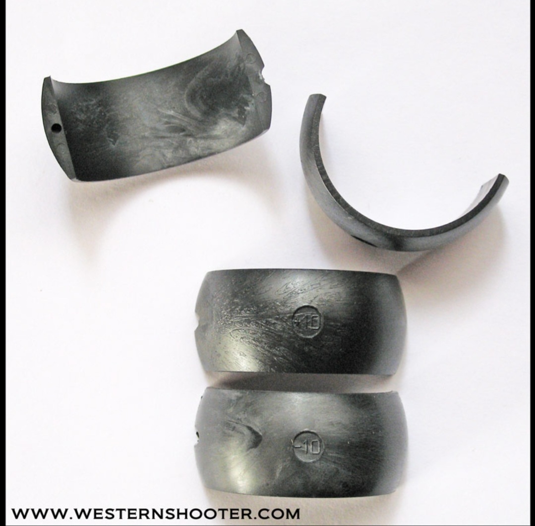

Burris inserts, deal with the tube alignment issue by having a radiused outer edge to their shims, allowing the inserts to essentially rotate in the rings while properly gripping the scope tube.
This, of course, will need to be used only in their rings with that built-in radius.
Good engineering. 👍
Good engineering. 👍View attachment 533200
They work great.

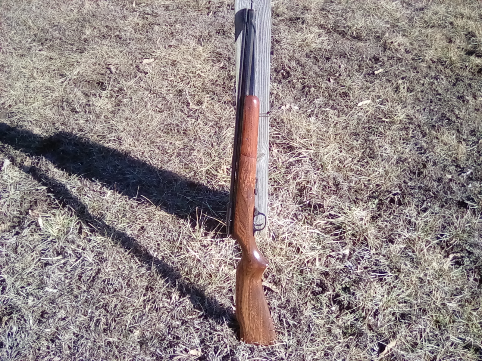

Not a springer but it's been awhile since I've had this pumper out.
This is a Crosman 140 .22 cal 1960's vintage. A great little rifle.
Nice gun. My buddy back in mid 60’s had a pumper. I thought a 240 .22 cal. He was king. We all had .177’s. I scored the anniversary one a year ago just as a déjà. Crow

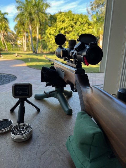

Got my 35e sorted with the Burris rings, thanks for all the help guys. Especially @bustachip Adding the -10 to the front to go along with the +10 in the back corrected it enough to be acceptable. I think the long barrel accentuates any factory droop. Also had time to shoot my .22 Prosport. It's really smoothing out with the TbT kit @13fpe.

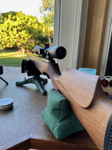

RECEIVED: HW 90 in 20 cal. Two sleeves of 5 tins of barracudas, sports match rings, and the gauge and fittings to adjust the gas ram. AND an Optics Planet box: Hawke Airmax ,1" tube 3-9x40mm. 1/4 min. adjustments. Will assemble and try to shoot in tomorrow. Have to adjust the 25 and 20 both with the gauge setup. Have tried for a couple of years to get the gauge. Be Well Brothers, dito.
Sweet man, enjoy.

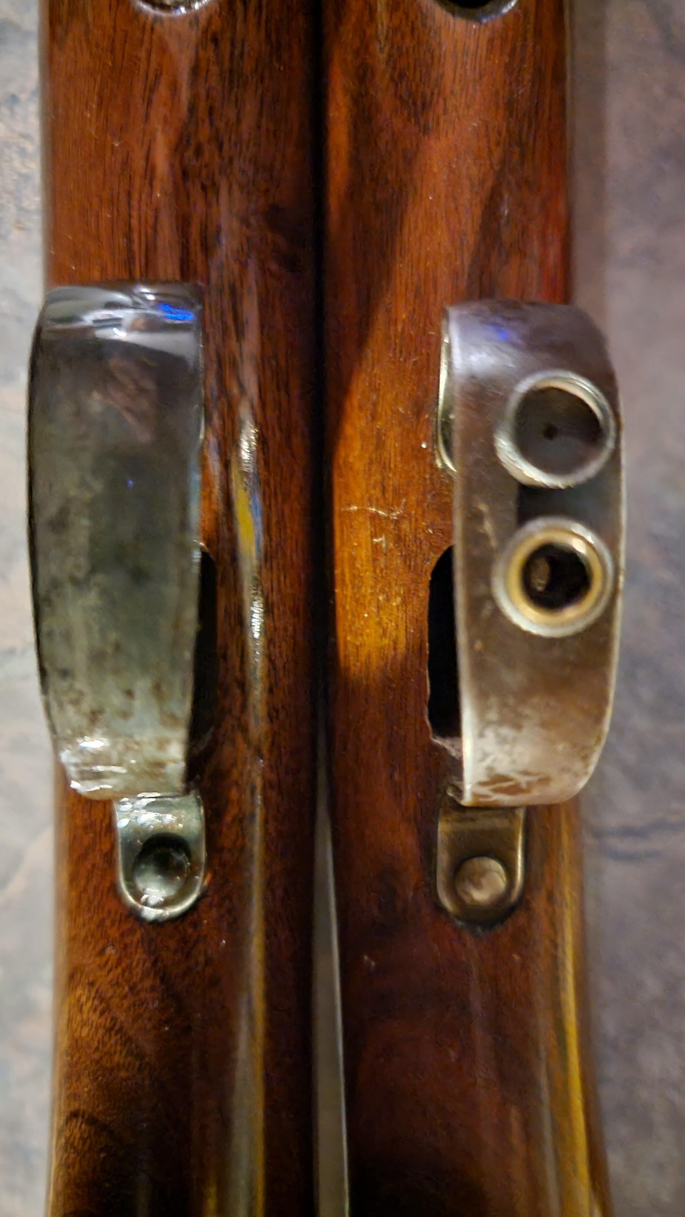

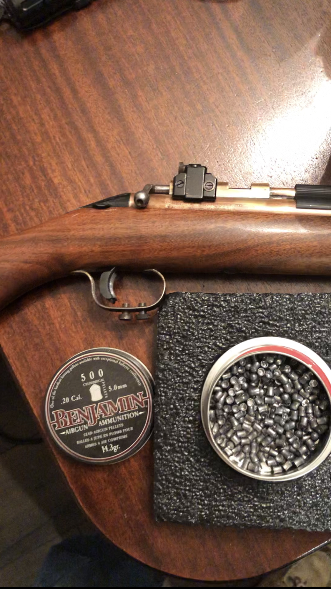

Curious.... What's with those two screws in the trigger guard? Never saw that before on a Sheridan. Edit: I just realised that they're not screws, but rather irises for the aperture sight. Had me going there for a second...;)
I appreciate you spotting that.
I also installed the williams sight, added a hood on the front sight, added the trigger shoe, and modified the trigger to add an adjustment for creep, that I have since removed.
