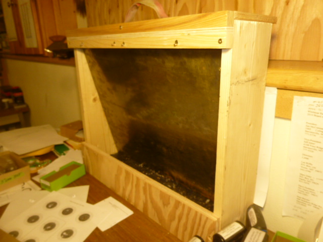

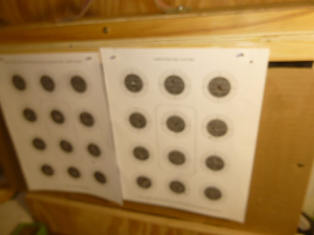

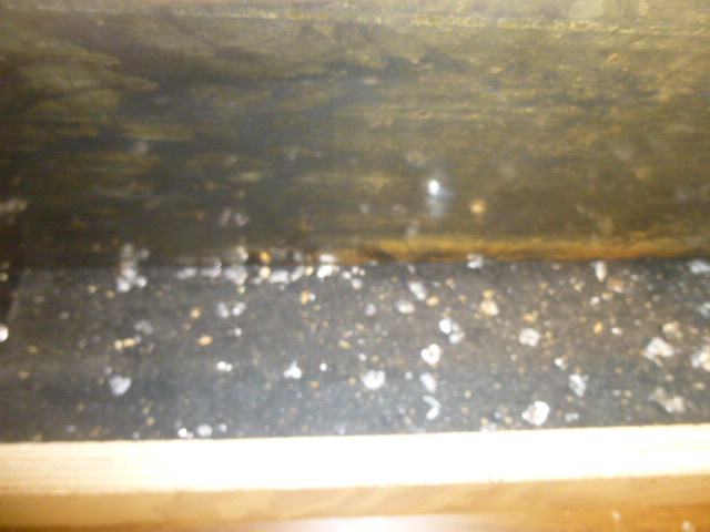

Redid my indoor pellet trap.this on is only 6" deep. works well,rubber sheet on bottom for pellets. Tempered sheet metal I had on han.Use earth magnets to hold paper,just pull on paper and magnets stay till you put on new target,holds two targets. Need to do a setup to shoot out of house.Have shooting window in shop but then need to put heater in it ! I'm wimping out! LOL !
Do the super domes fit really tight in your barrel?

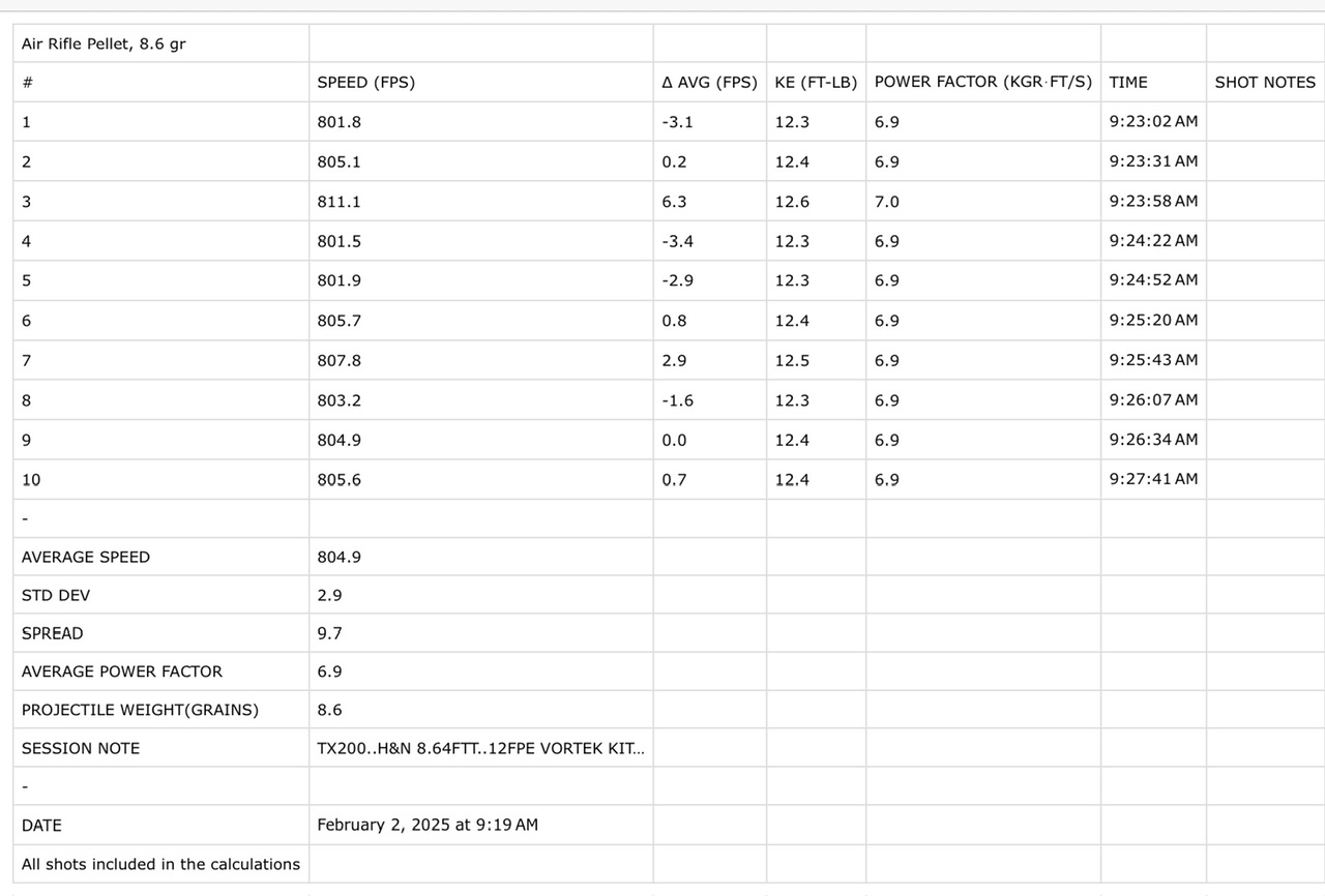

With three TX200s and that many different air rifle shooting opportunities, I thought I would change one to a 12fpe rifle for short range silly wet, offhand. We are restricted tom12fpe at pistol distances to protect the targets. Yesterday, motorhead gave me two used 12fpe VORTEK kits. The first one was only able to shoot at 10.5fpe. This morning I changed them and the second was right on the money or a SKOSH bit more…so now I have one at 12fpe, 14fpe and one at 16.5 fpe.

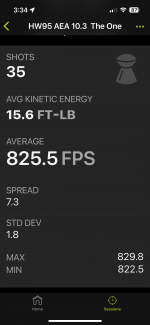

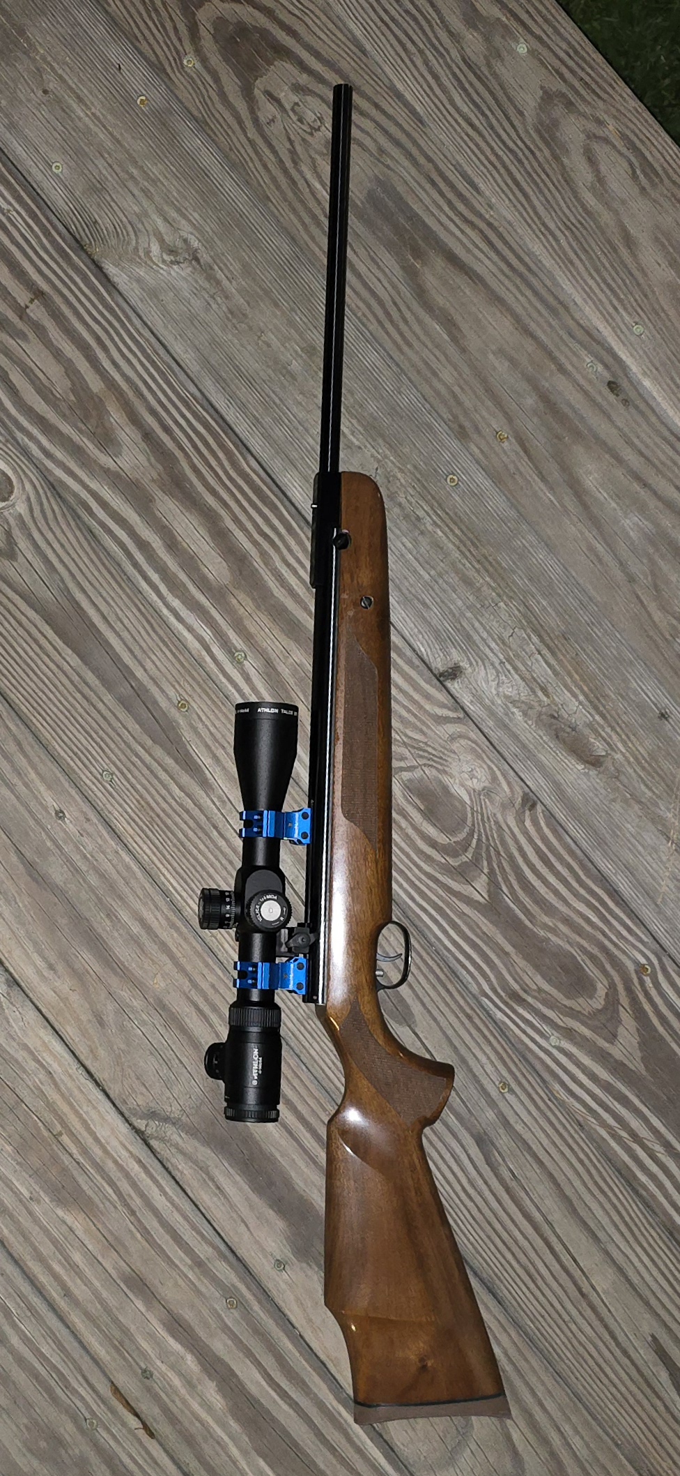

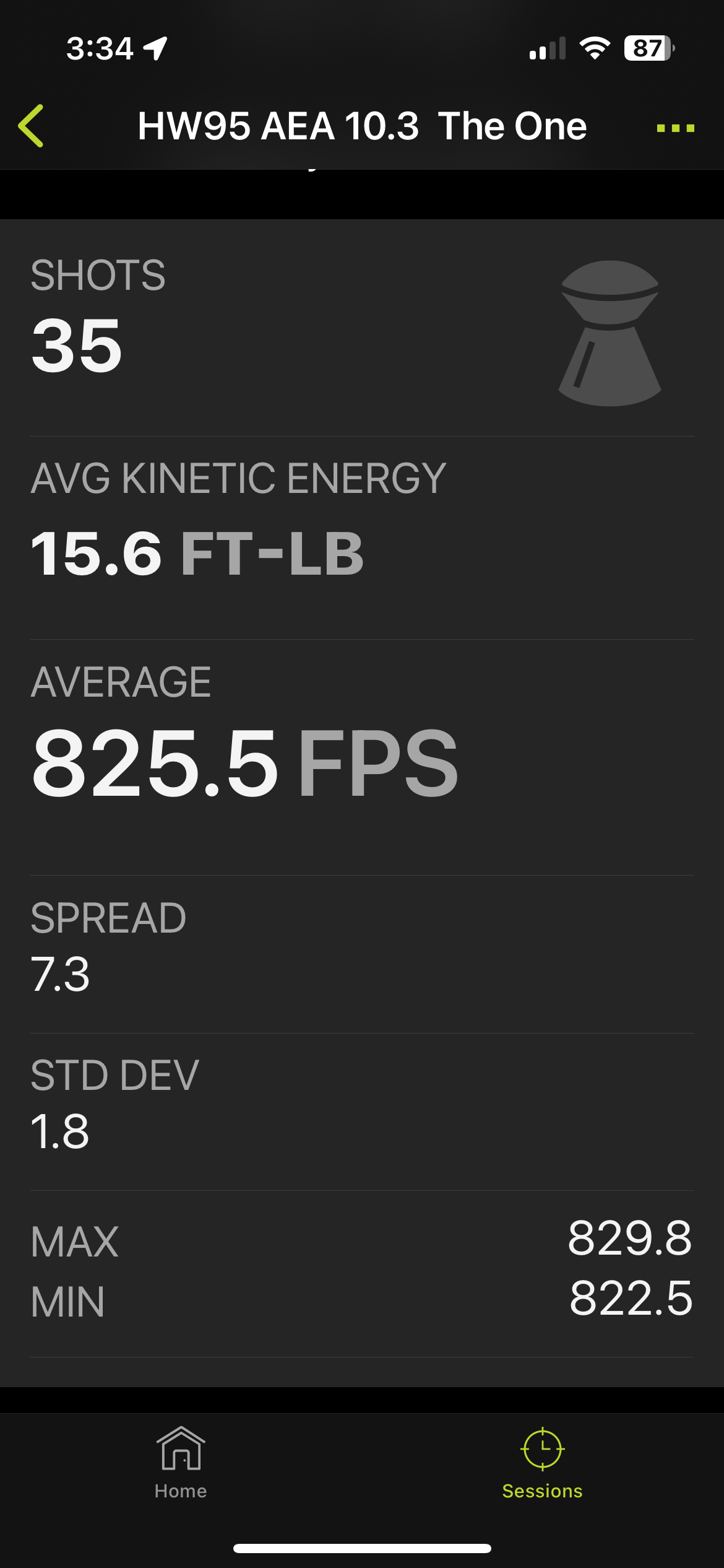

One of my favorite springers is my .177 HW95. Liked it so much a got it a custom CS stock. Decided to retest some pellets since I have a larger selection now, a year ago JTS and AEA were not on my radar. The results are in! the favorite JSB 10.3 and 13.4 are no longer the winners...AEA 10.3 is the clear winner with the JTS 10.4 and the AA 10.3 tied for second. I have high end PCP's that would be proud to have a SD of 1.8..
Now which power level will group the best?

Sweet rifle and chrony numbers. I need to try some of those on the next pellet order. I am waiting on a HW98 to show up, guy says it won't shoot good. So I took a chance, hopefully I can straighten it out.
And I have a walnut stocked HW95 in .20 on the way. In stock at AoA. My favorite caliber was impossible to resist...
I like the idea of magnets holding targets. Thanks for the idea. Crow

I use the old style paper clamps with an excessively heavy spring. That style will cut through the targets if you are careless. But I have seen some available with a magnet on them, a la refrigerator Note clips. If your trap is steel this might be the Goldilocks of target clamps. AND have I ever mentioned DEATH TO SQUIRRELS? Be Well Brothers, Bandito.

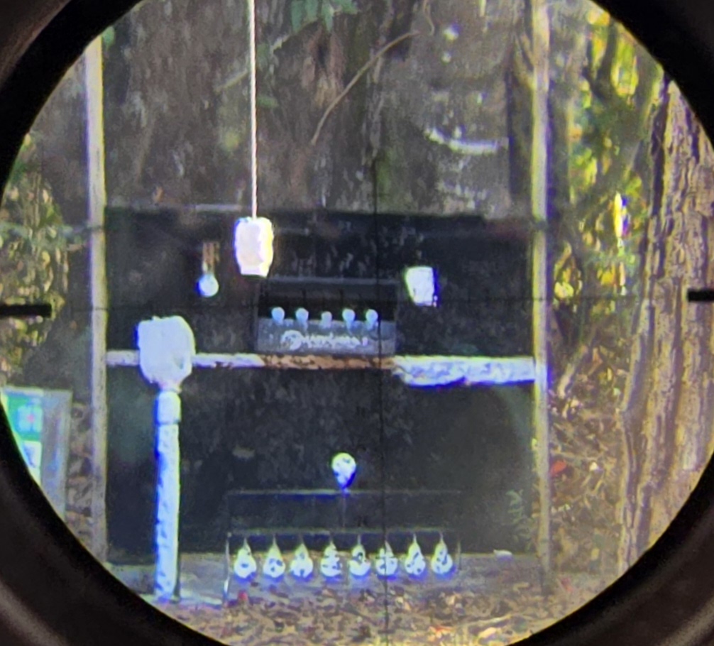

I shot two rounds of Crazy Eights in the wind and one round on the Marksman target at 75y after the wind laid down with mine yesterday.
