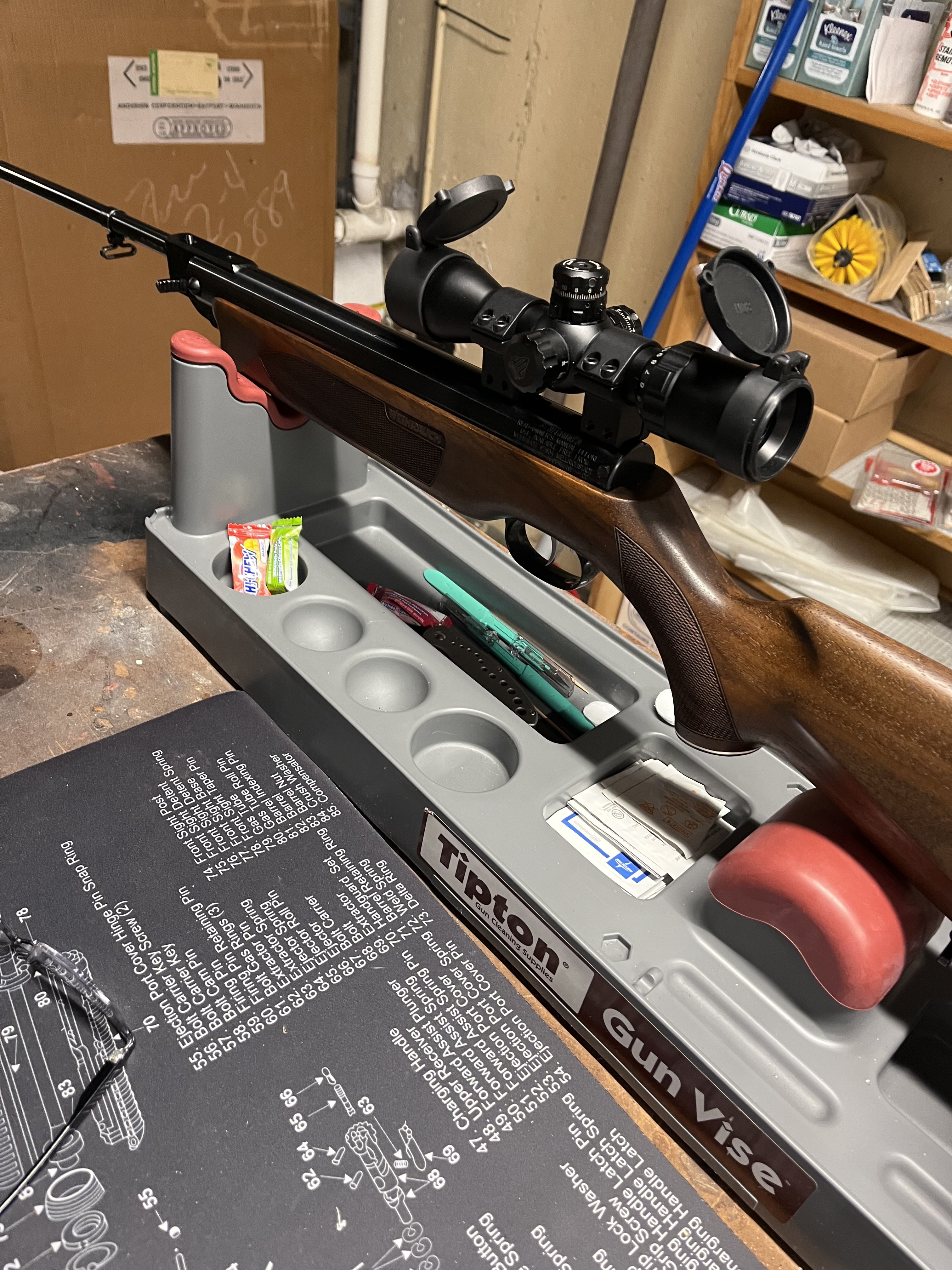

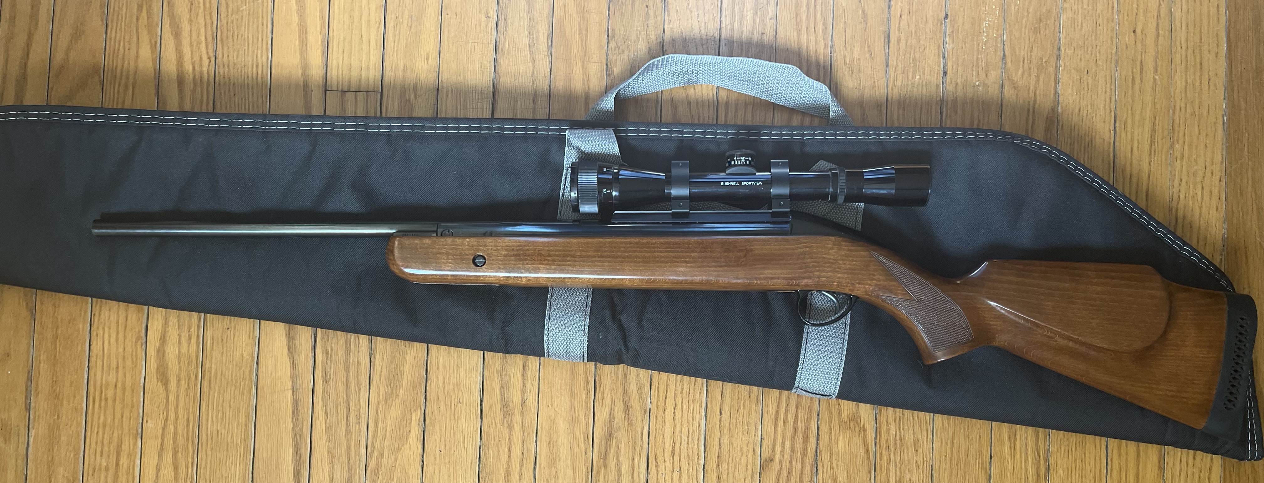

Everything arrived for my maiden rifle scoping. HW35 TO4C Bugbuster
Took a few shots to find paper but I managed to click my way near the middle.
I appreciate everyone for sharing their “how to” tips and encouragement.

BSA Mercury back block threads on. I have an HW50 spring in it. View attachment 536770
Karl, I think you might be on to something. Thank you. I believe I used a used spring from a new Weihrauch.
‘I’m with you on the install by hand. I put trigger block on floor and stand over using body weight. Need non slip. I like the idea of putting it in soft jaws to hold still. Going to adopt this idea.
I do most springs by hand. Even did a HW80+, not recommended. That was first and last time.
‘Really appreciate your input. Crow

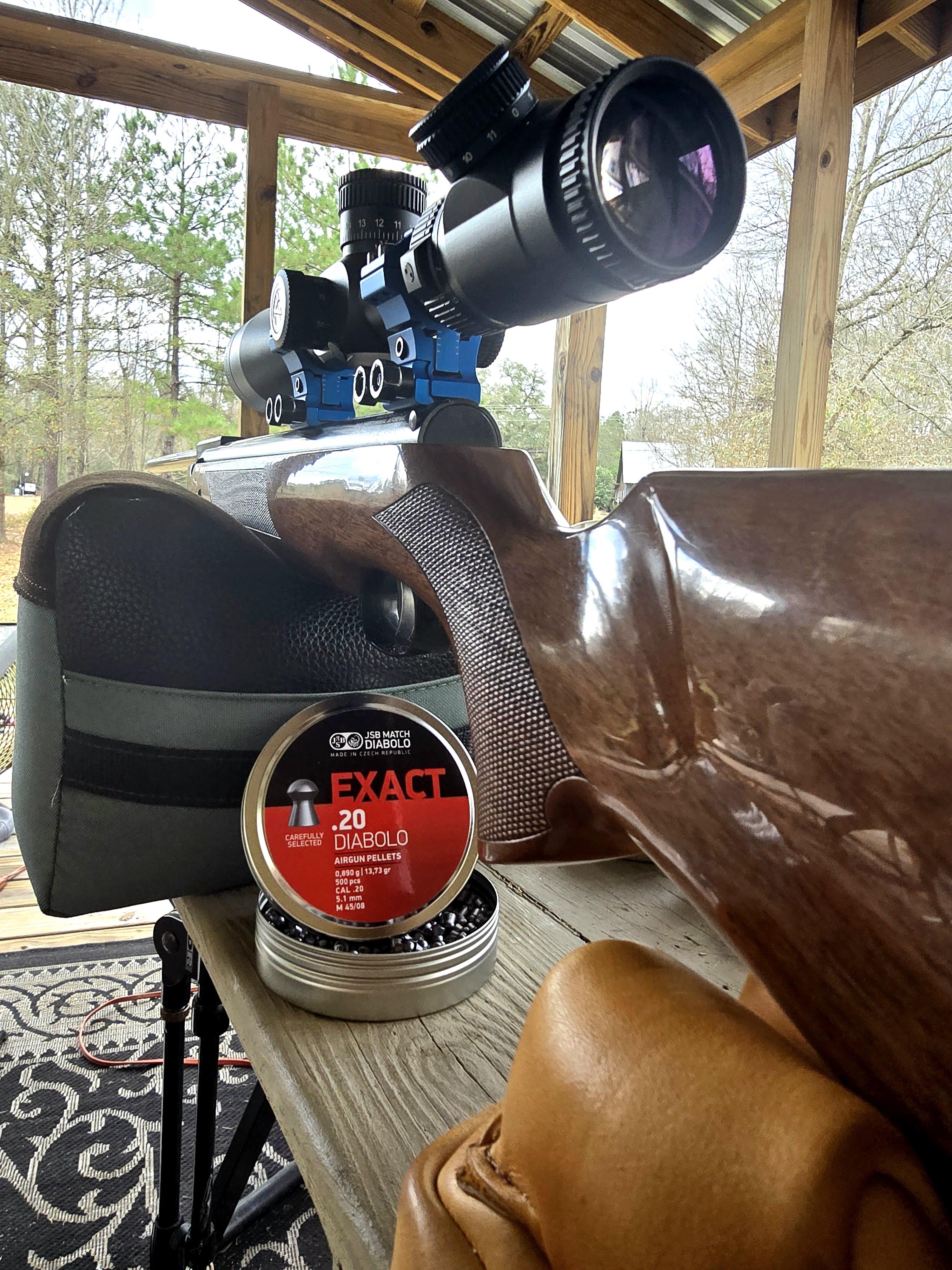

Cool scope. And great shooting. Crow

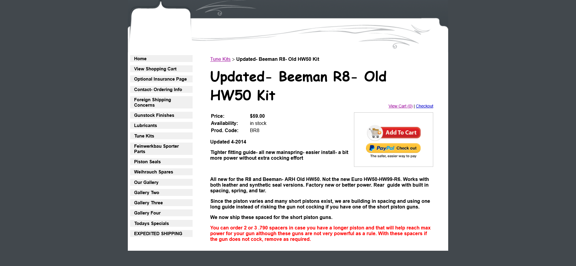

JM probably has a drop in spring as well.

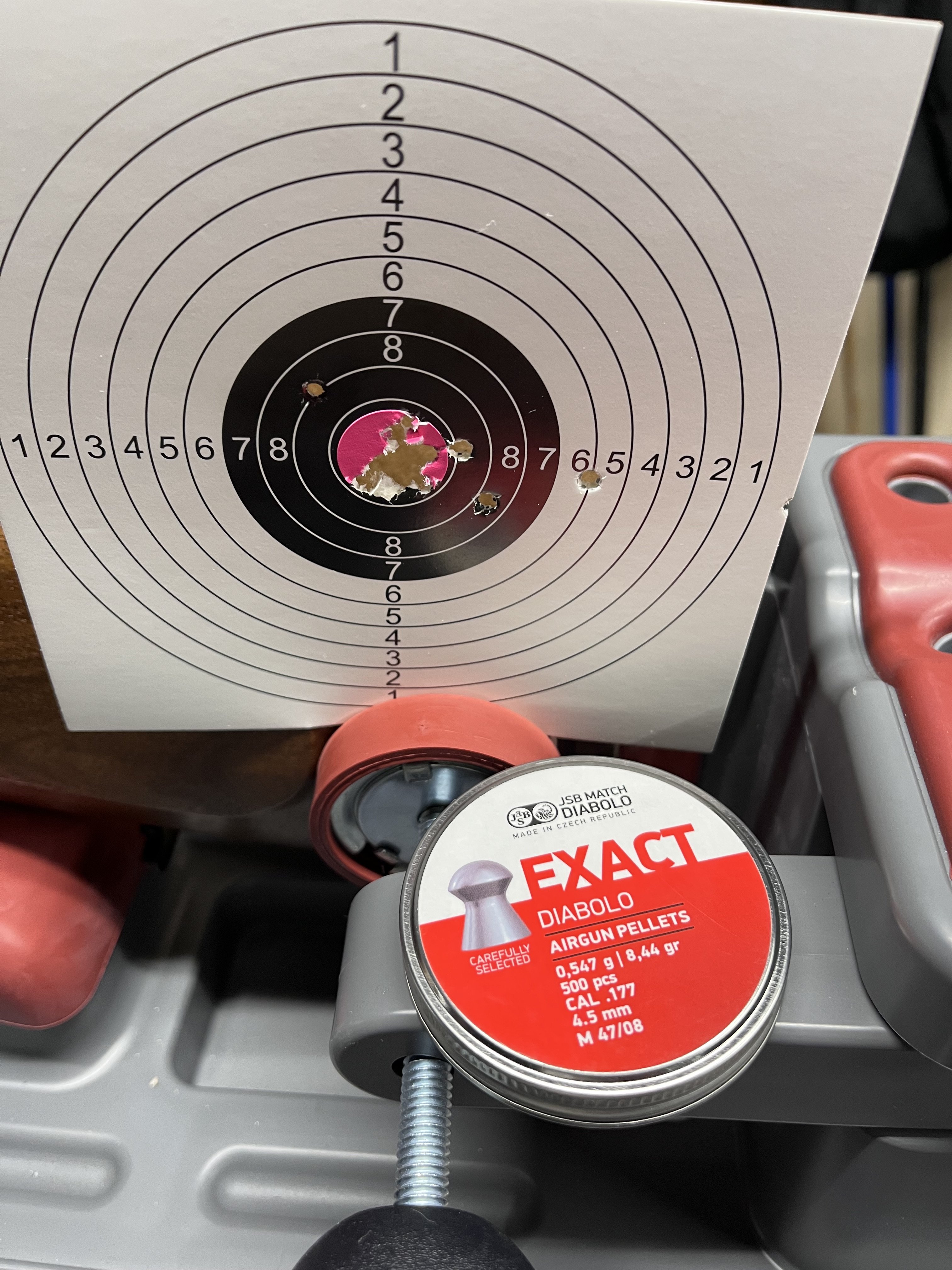

I set up early this morning to get an advantage on the wind. The flag inched out to the left after the first shot, which was a clean miss! 😠
I had some, but little success on the Crazy Eights again like yesterday. Also like yesterday I was chasing zero trying to figure this miss syndrome out. I would hit a dead bullseye, immediately followed by a hit in the dirt down low. Fed up I put my shoes on and took a target out there. It would have been a nice group if I'd been at 1000 yards.
So, Back to the JSB 13.73s.
Now I had a really good shoot, with plenty misses, but when I hold 4" into the wind and I should have held 7" I'm happy.
All in all I've been out here five hours, and "post" H&N, to JSB change, four rounds of Crazy Eights, the 1 1/4" spinner, three shot shells, one CO2 cartridge, and two side by side centered bulls on the paper target. 👍
We'll be able to have a better look if we ever have a good long, low wind day to work with.

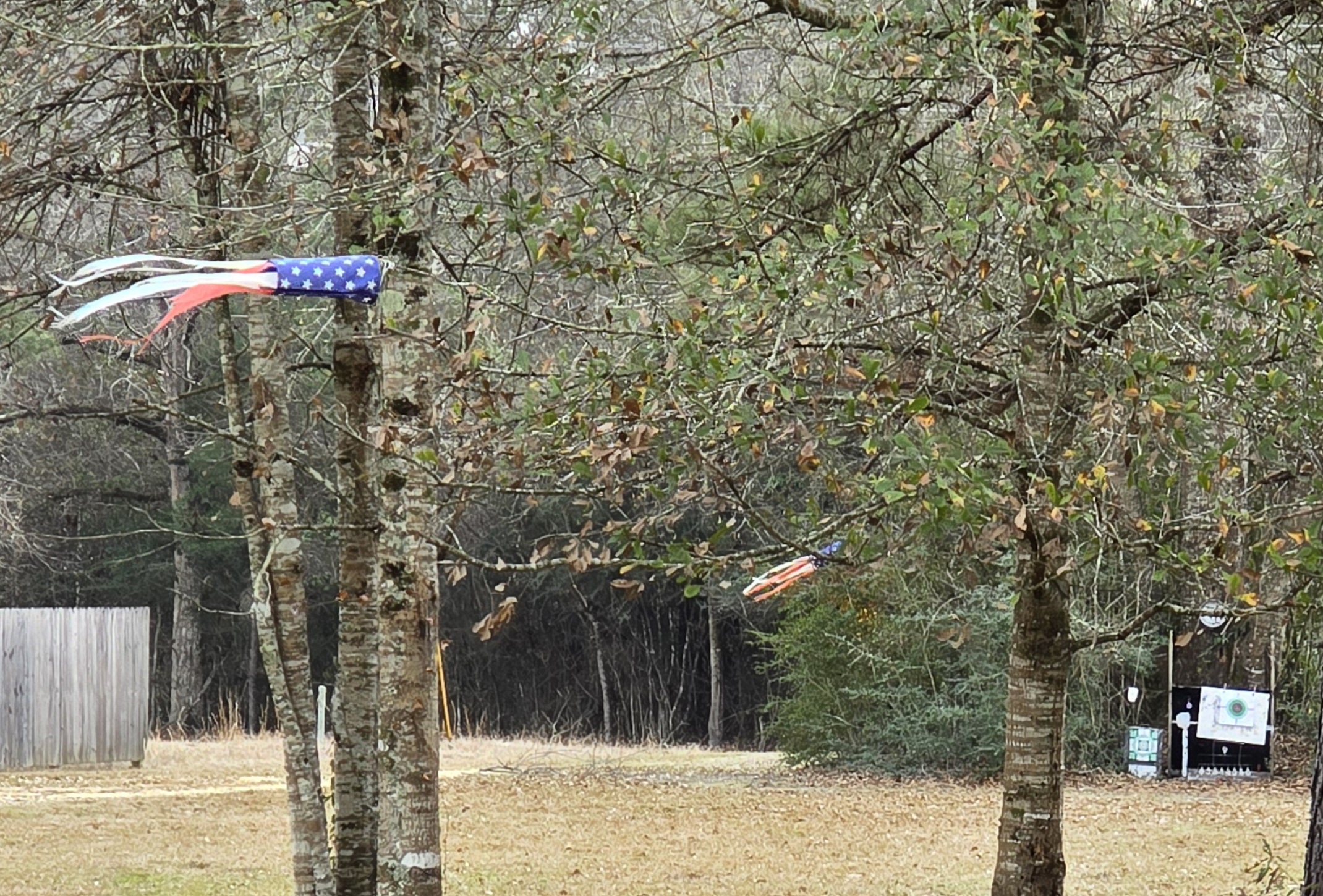

I was thinking of putting small wind flags near the ground in my perifial vision while aiming. I got some real good clues when leaves got airborne and flew past my targets this morning.
It really increases the challenge.
With the pellet trap being black you can see the grey pellet turn with the wind and see if your holdover was + or - or "Bullseye" 👁
The flags today variable changing directions, and sometimes one full left and the other full right. I give 3/4 dominance to the 30 yard flag, for hold over guesswork.
The wind tried to take down the paper target leaving it crooked but still standing. The hanging med bottles is about four feet left of its relaxed position. 👍
