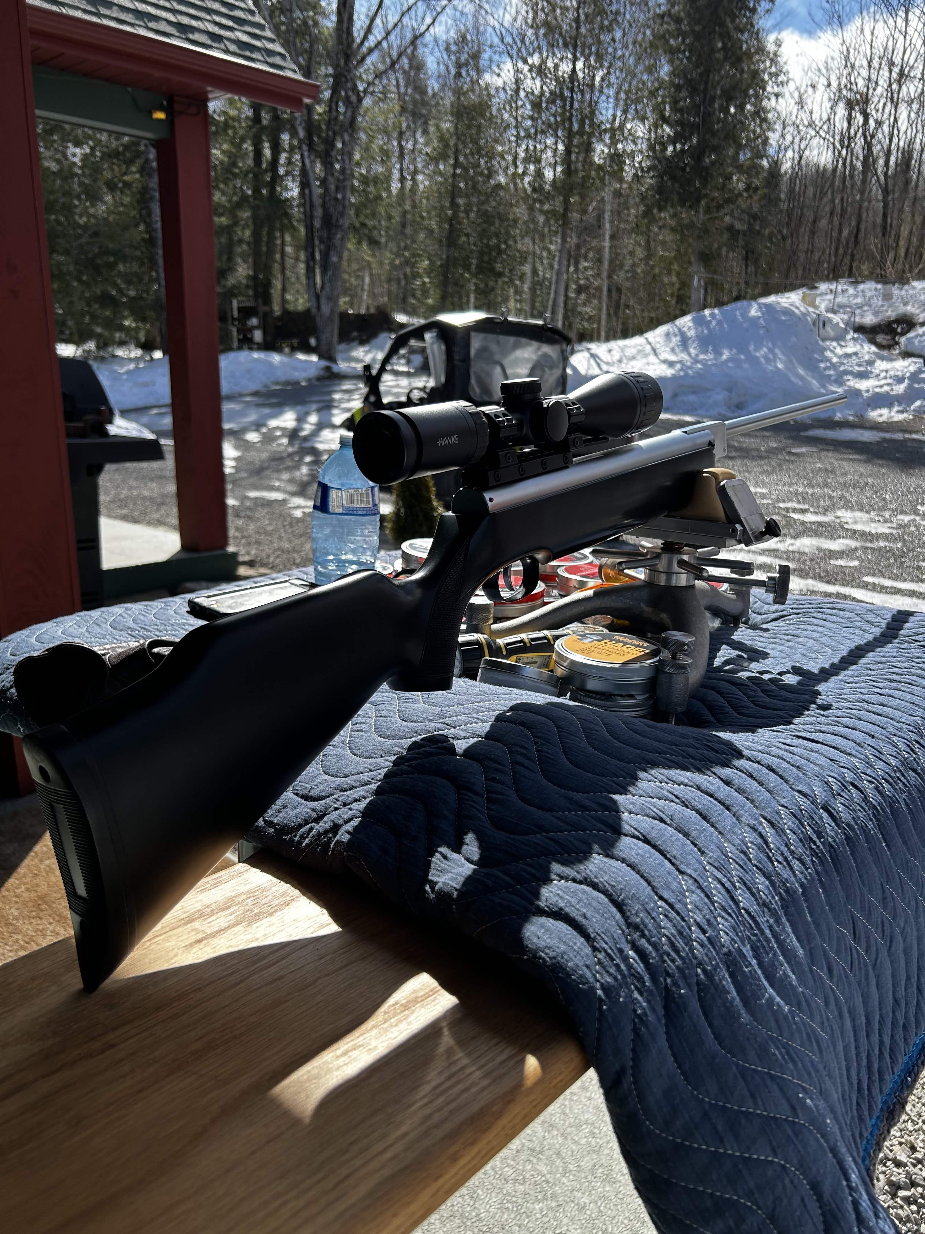

Sunny, but a cool 33F. Put another layer back on and boots, all good.

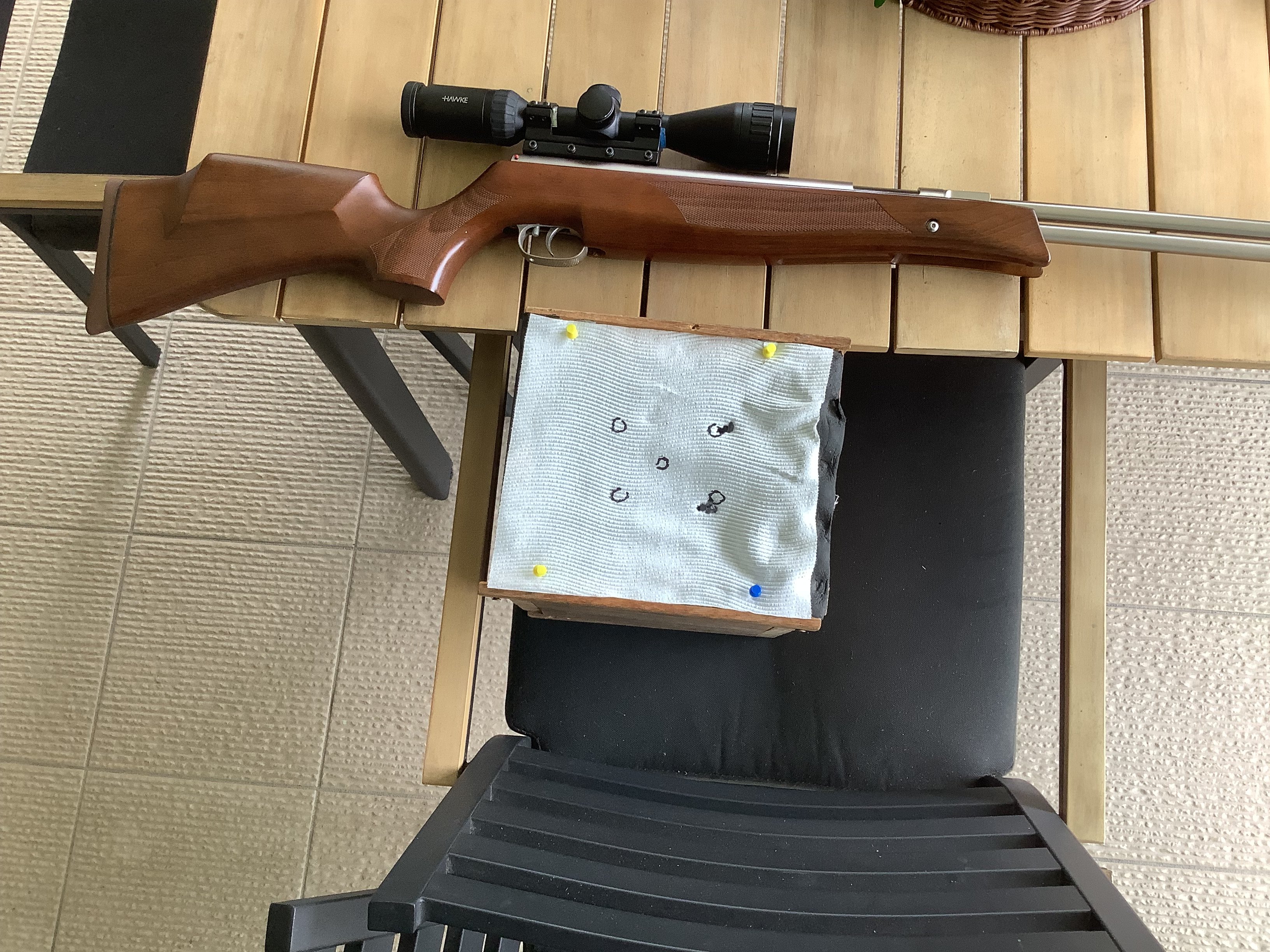

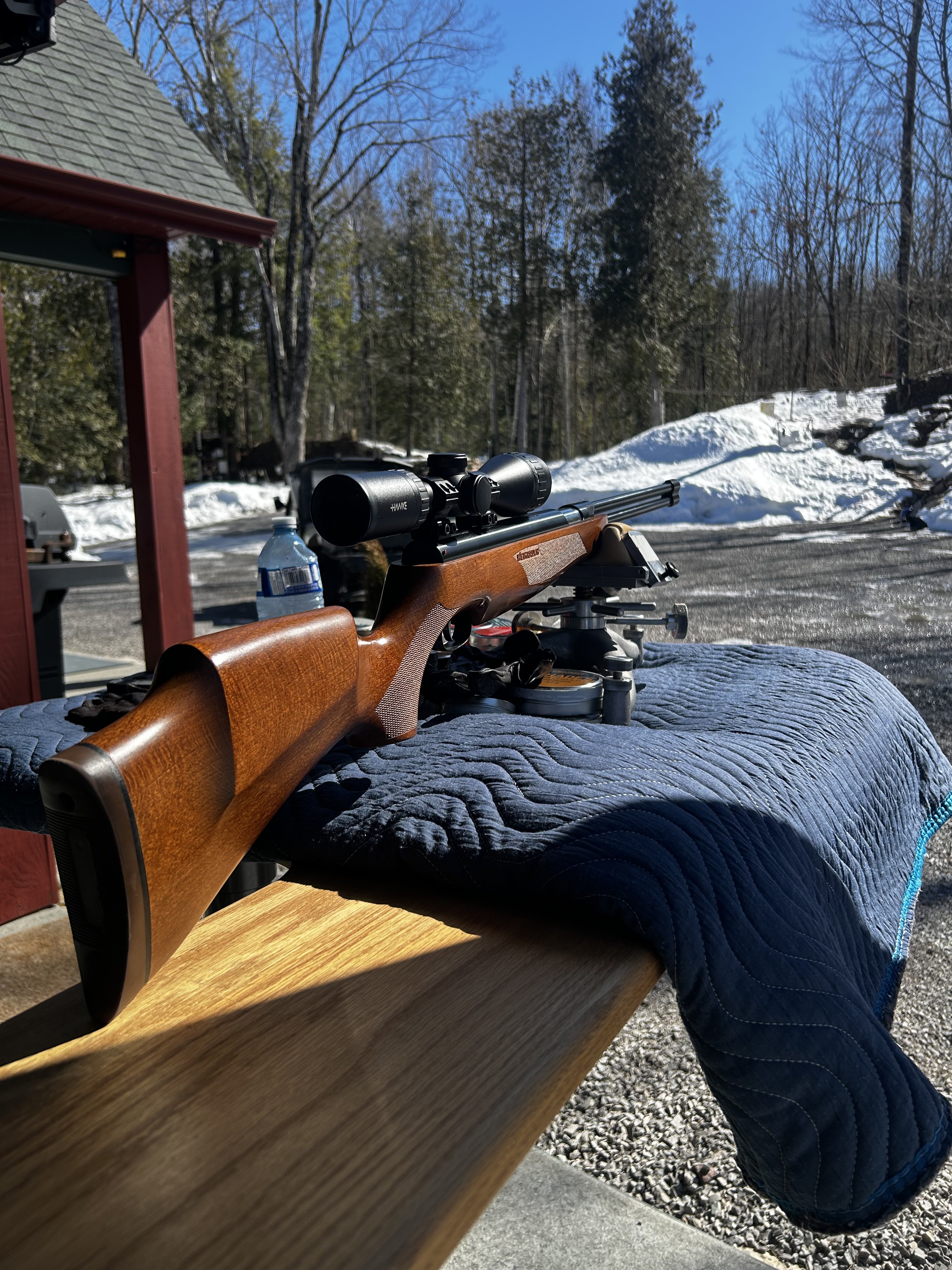

This HW80 .20 is about the third time I shot it.

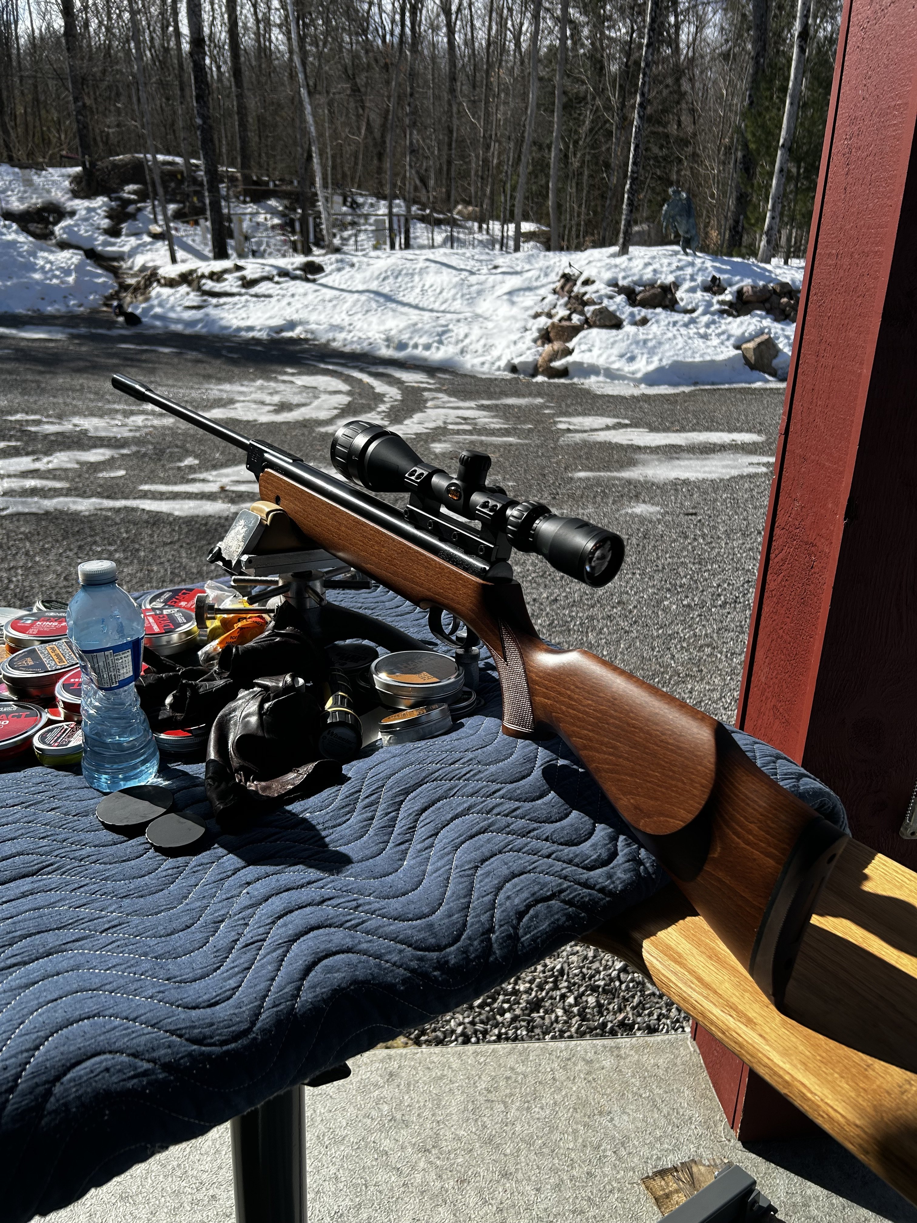

Came with a BSA scope. The dust covers almost got tossed into lake, what a PITA to screw back on. I like the elastic or rubber stretch covers best. 10 shots 47 yds.

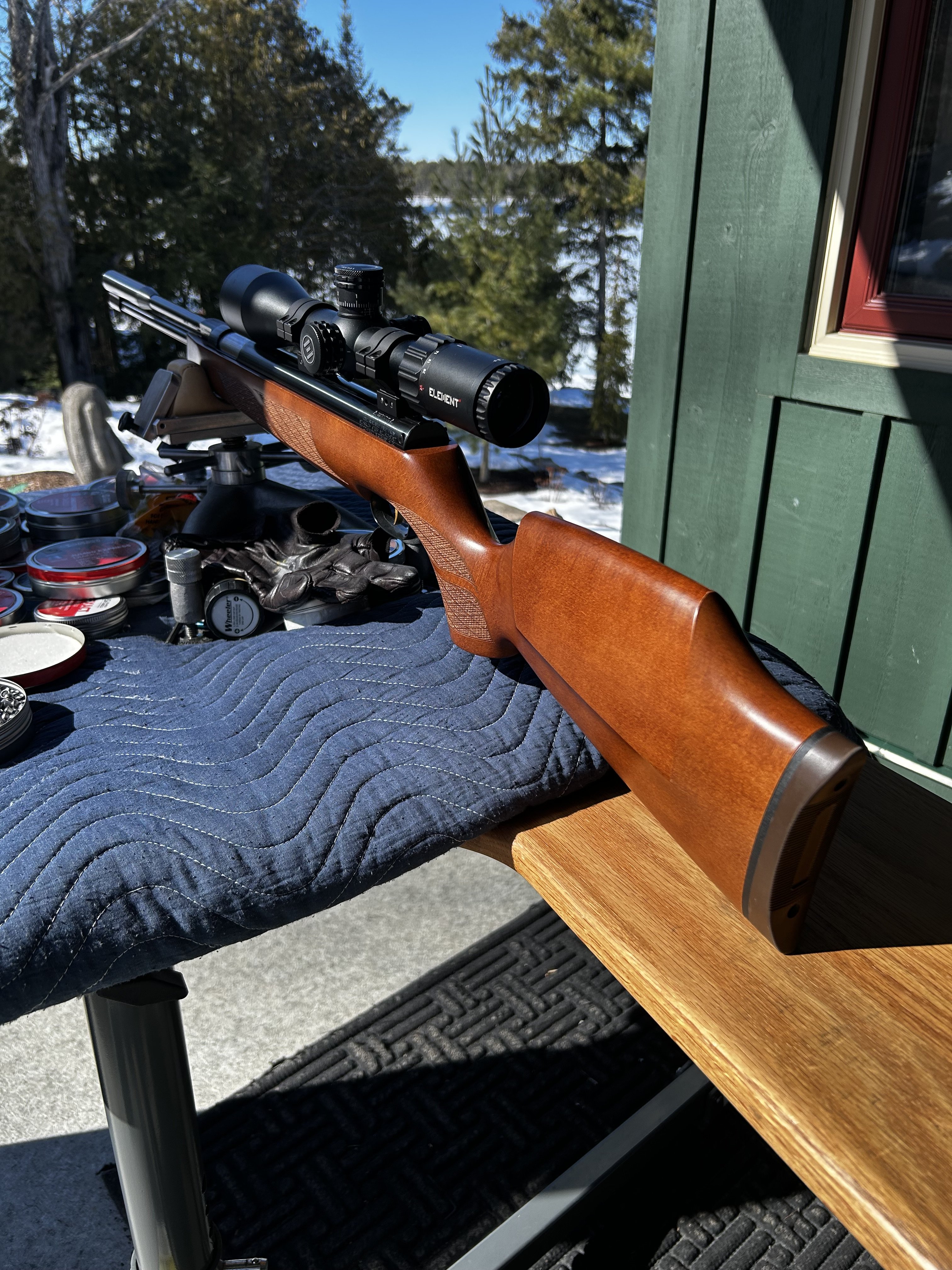

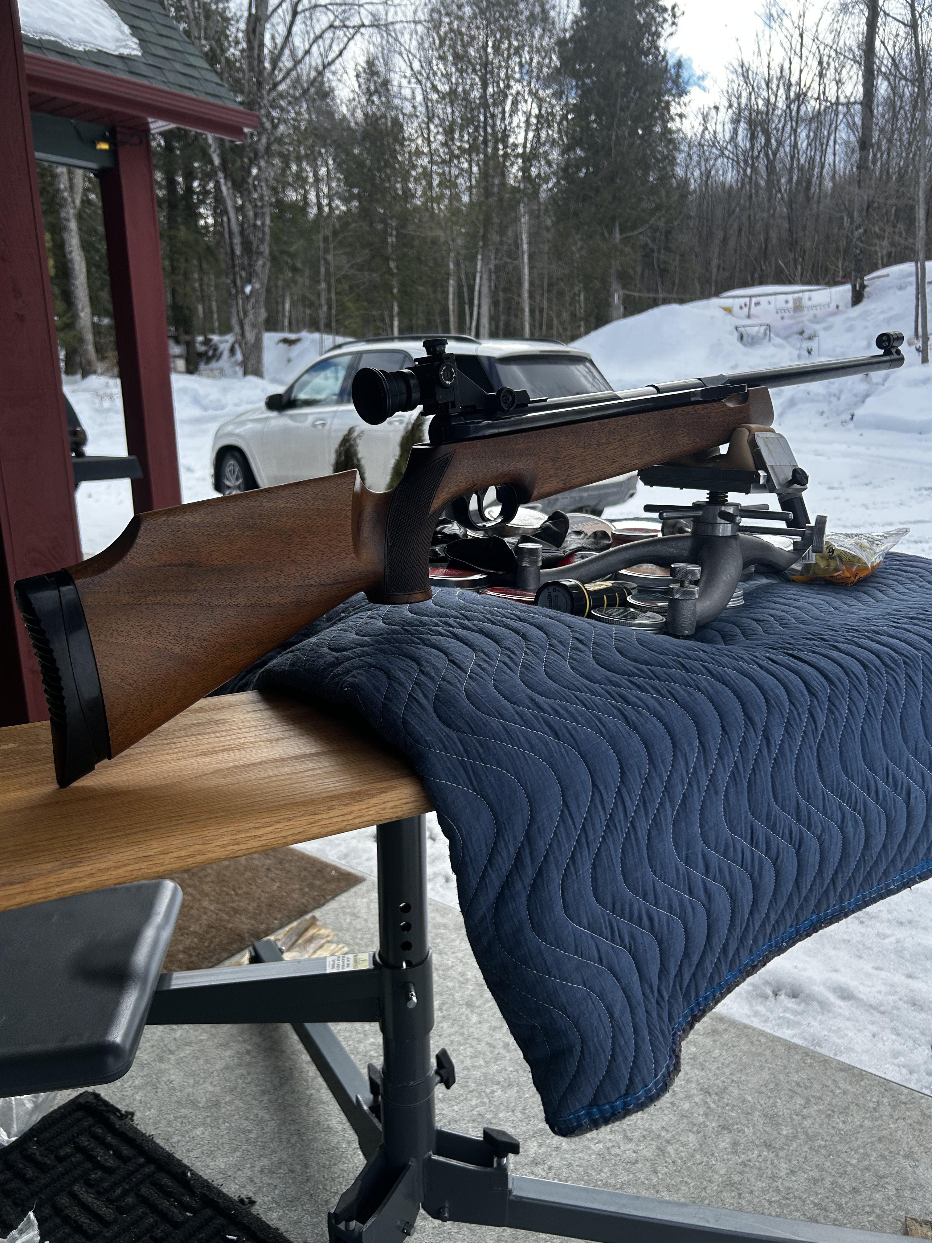

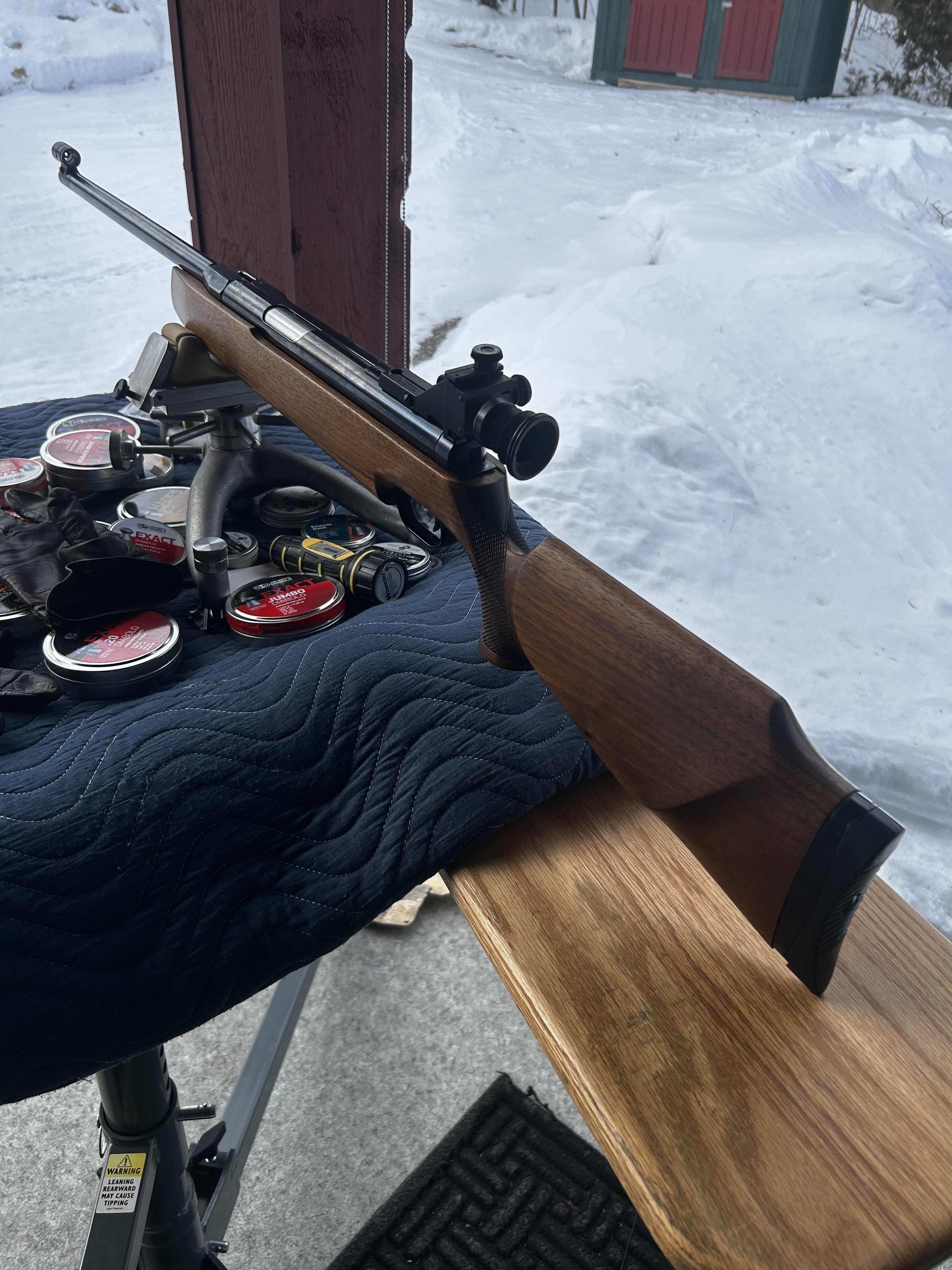

Also a HW80 .22. Sweet gun. This is the gun that got me hooked. It was my buddies.

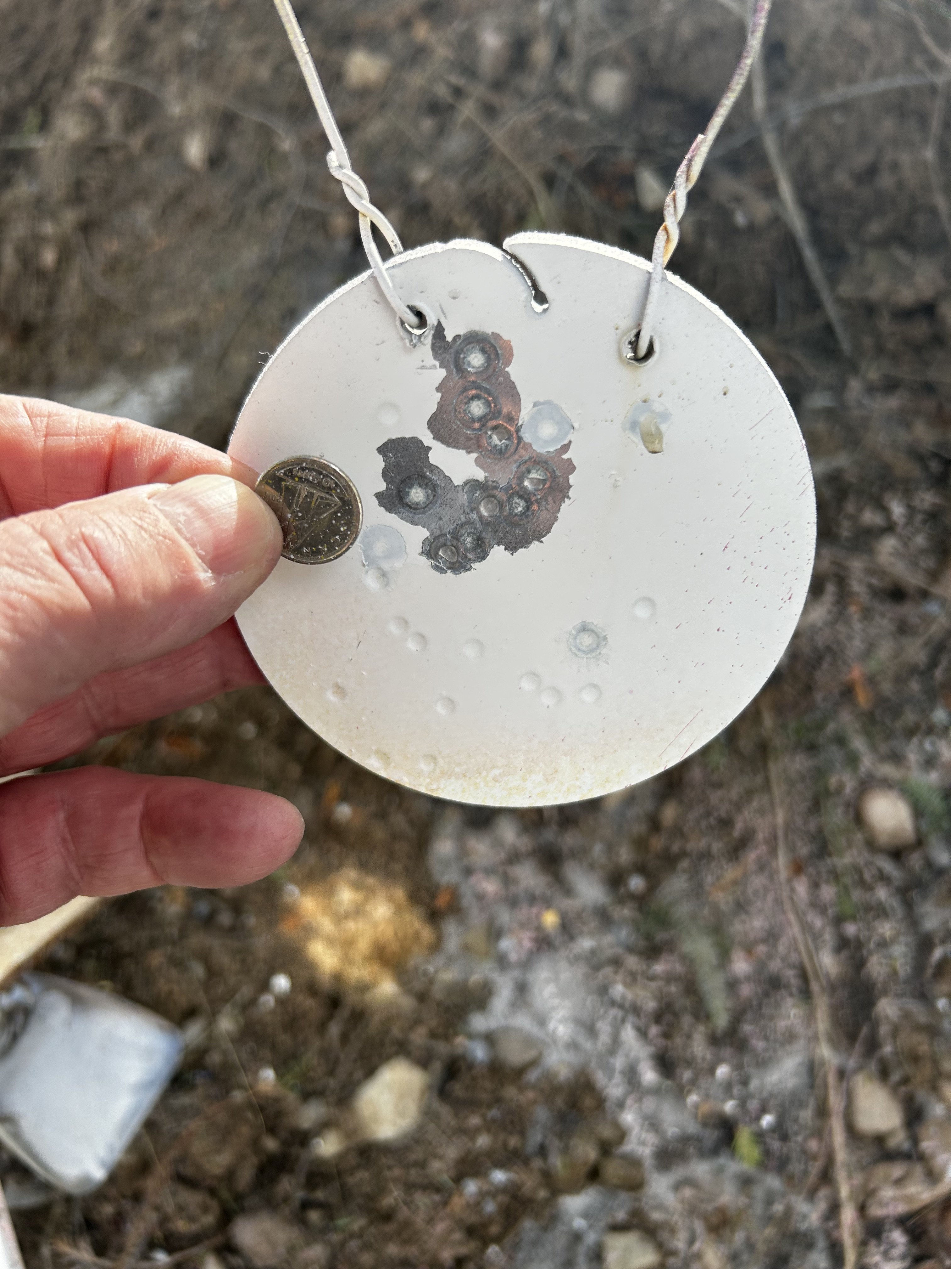

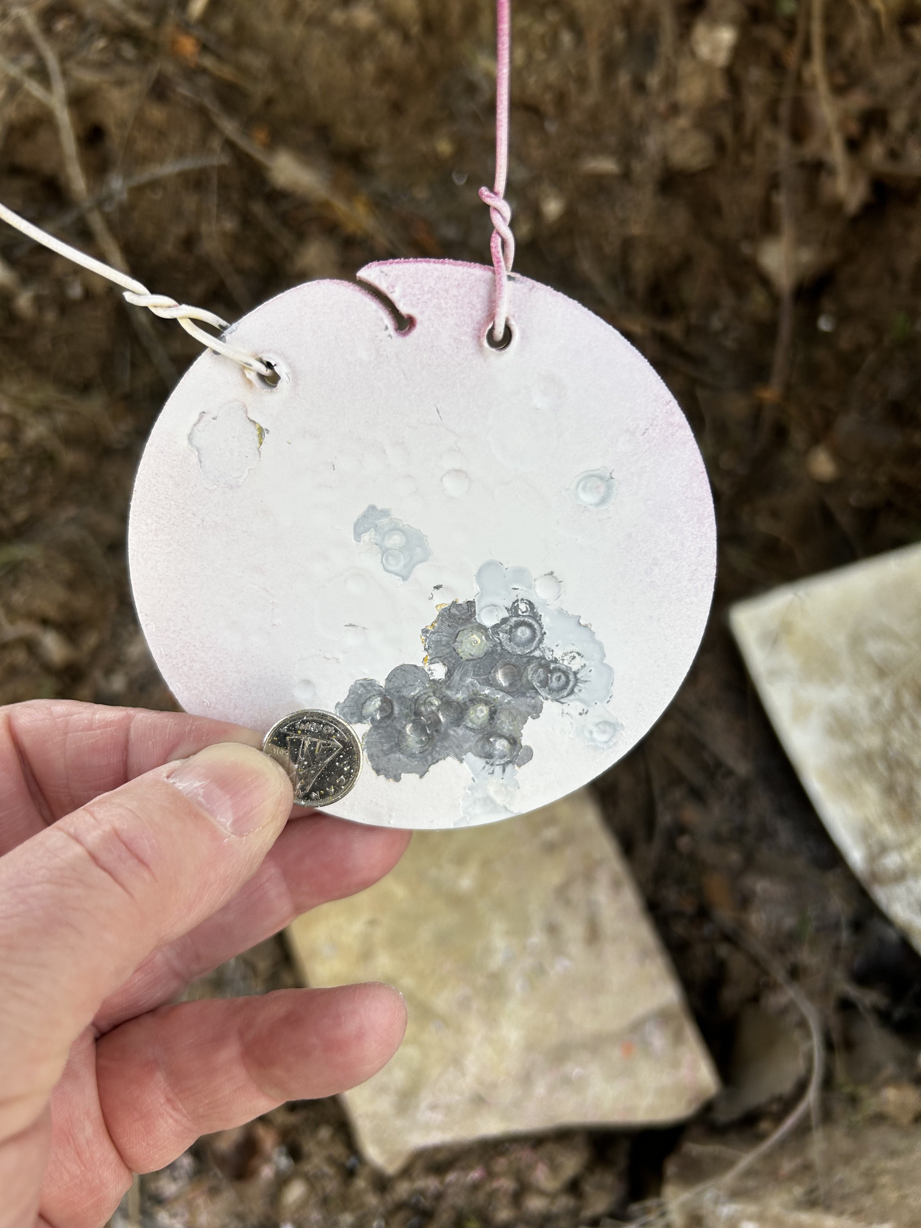

Look how much melted. The ice on my driveway way 6 inches thick last week. 10 at 47 yds.

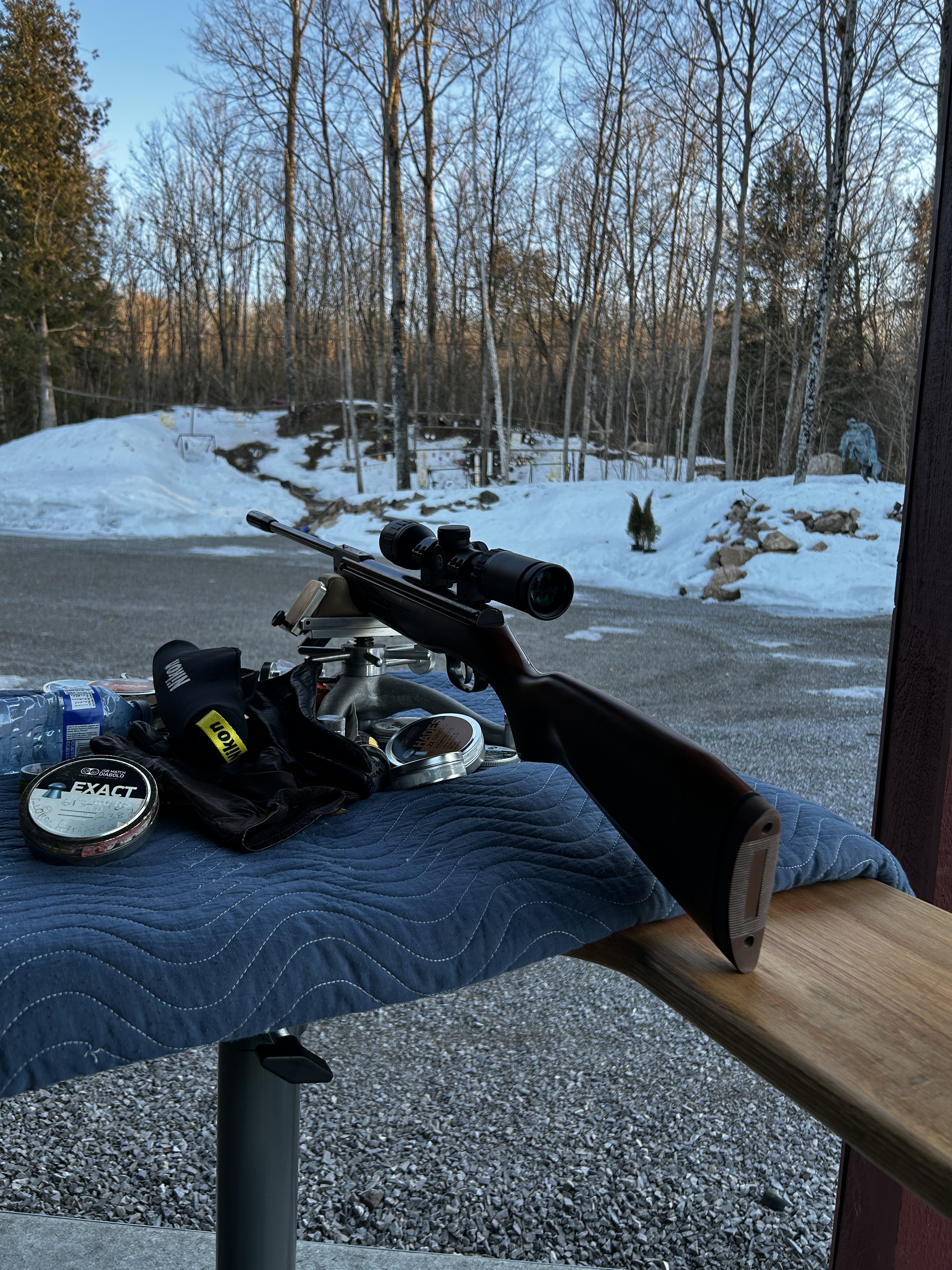

Anyway this 80 shoots consistent. The long barrel gives good leverage. Crow

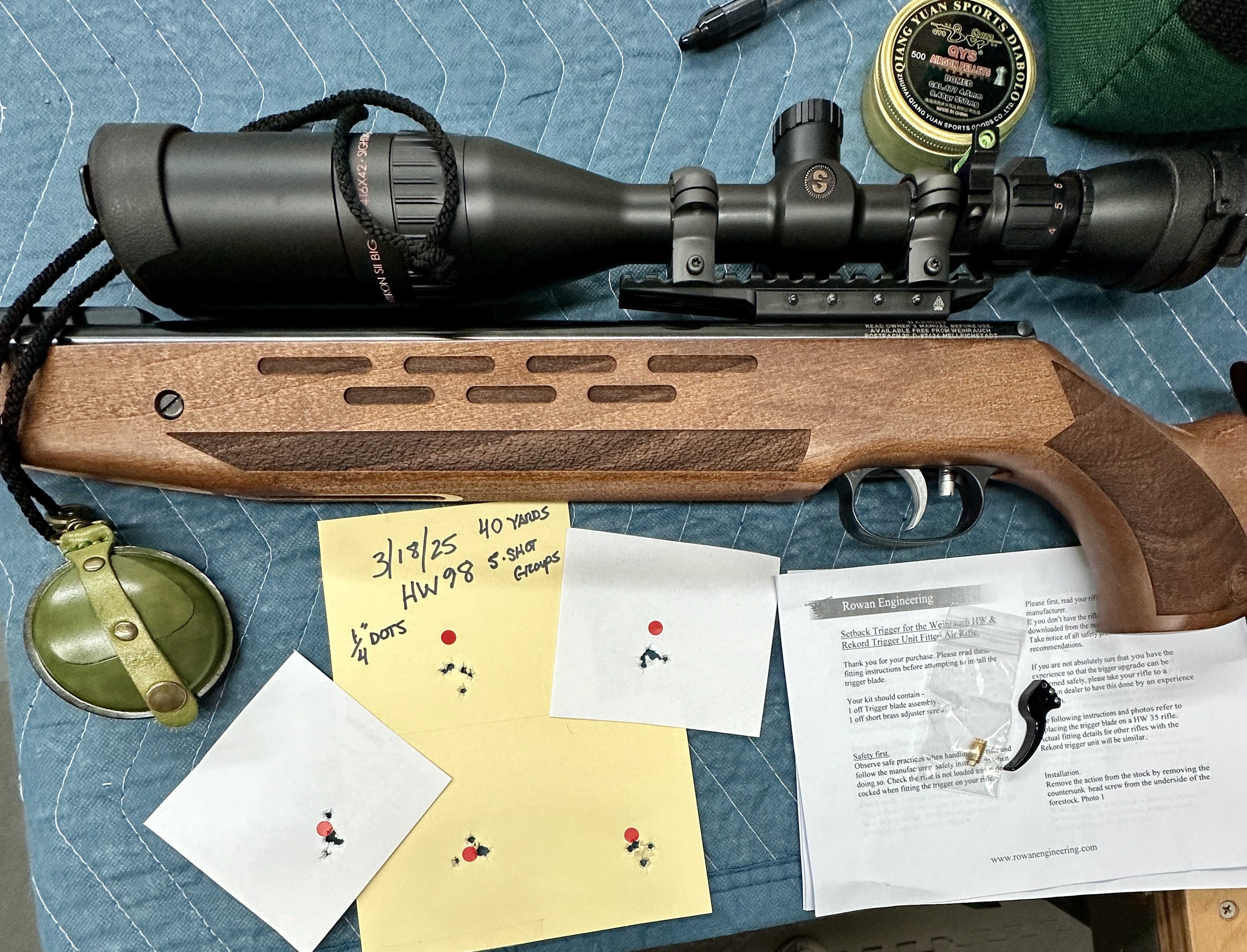

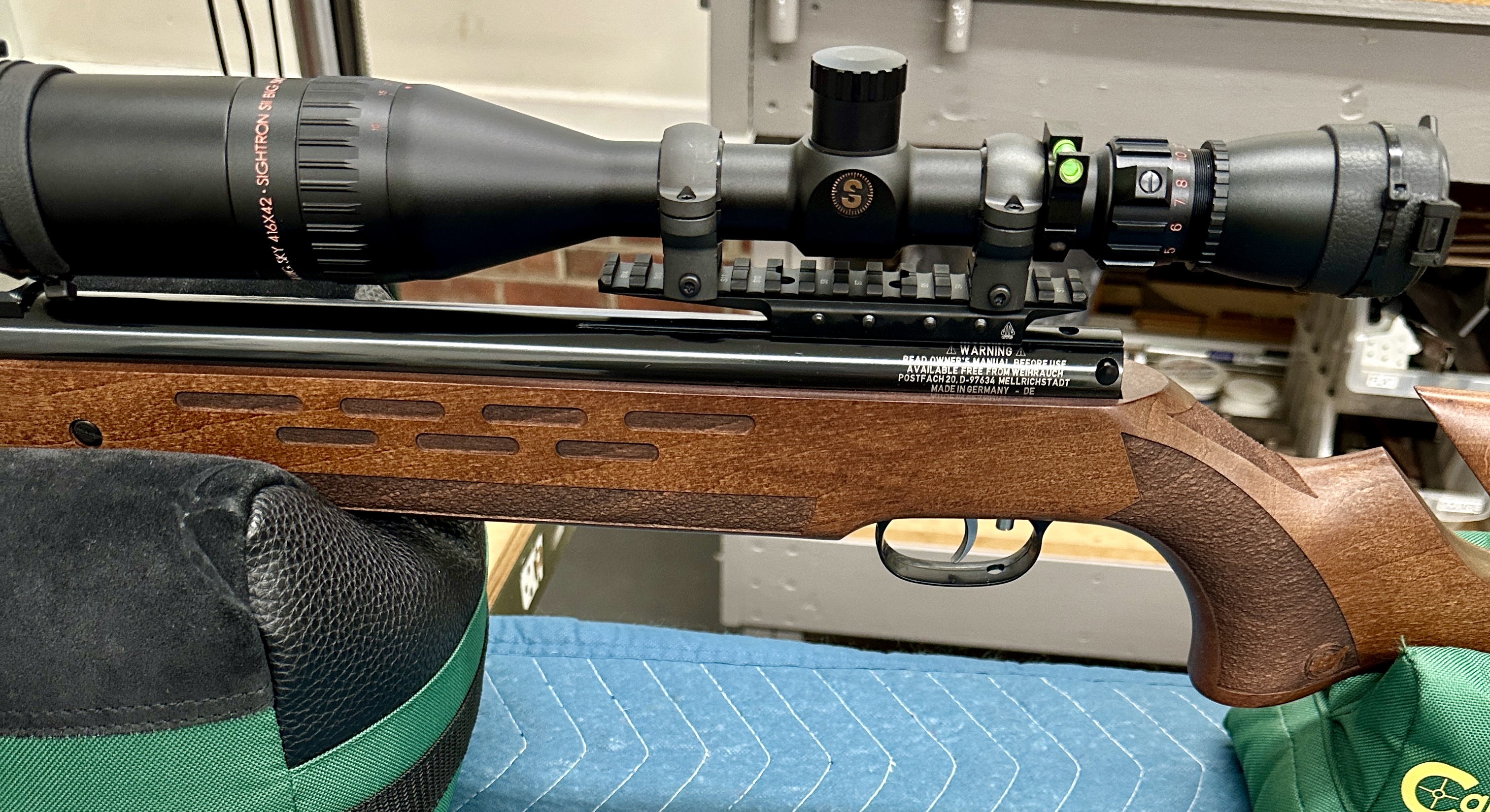

Ok thanks. I've never had a Sportsmatch ring slide or deform a hole when properly installed. For some reason I thought you were using them. I don't like the UTG stuff. I've had them move and don't ask me how I've had their threaded pins back out of the recoil hole. I see you have the signature Zee rings which are excellent so you need the extra pic trail adapter for them.
Maybe I didn't have enough torque on the rail screws? I use blue lock tite on the pin so it doesn't move once I screw it in.
Reactions: crowski
Perhaps not enough torque. The Chinese mounts are usually made of poor materials and they'll strip before you get them to tight enough to grip. Also if the dovetail angles aren't cut right they won't hold no matter what. You probably know this already because you're a smart man. It helps to degrease deep into the dovetails with denatured alcohol. Do not put loctite in the dovetails. That's another popular practice that's a big no no.
Reactions: crowski

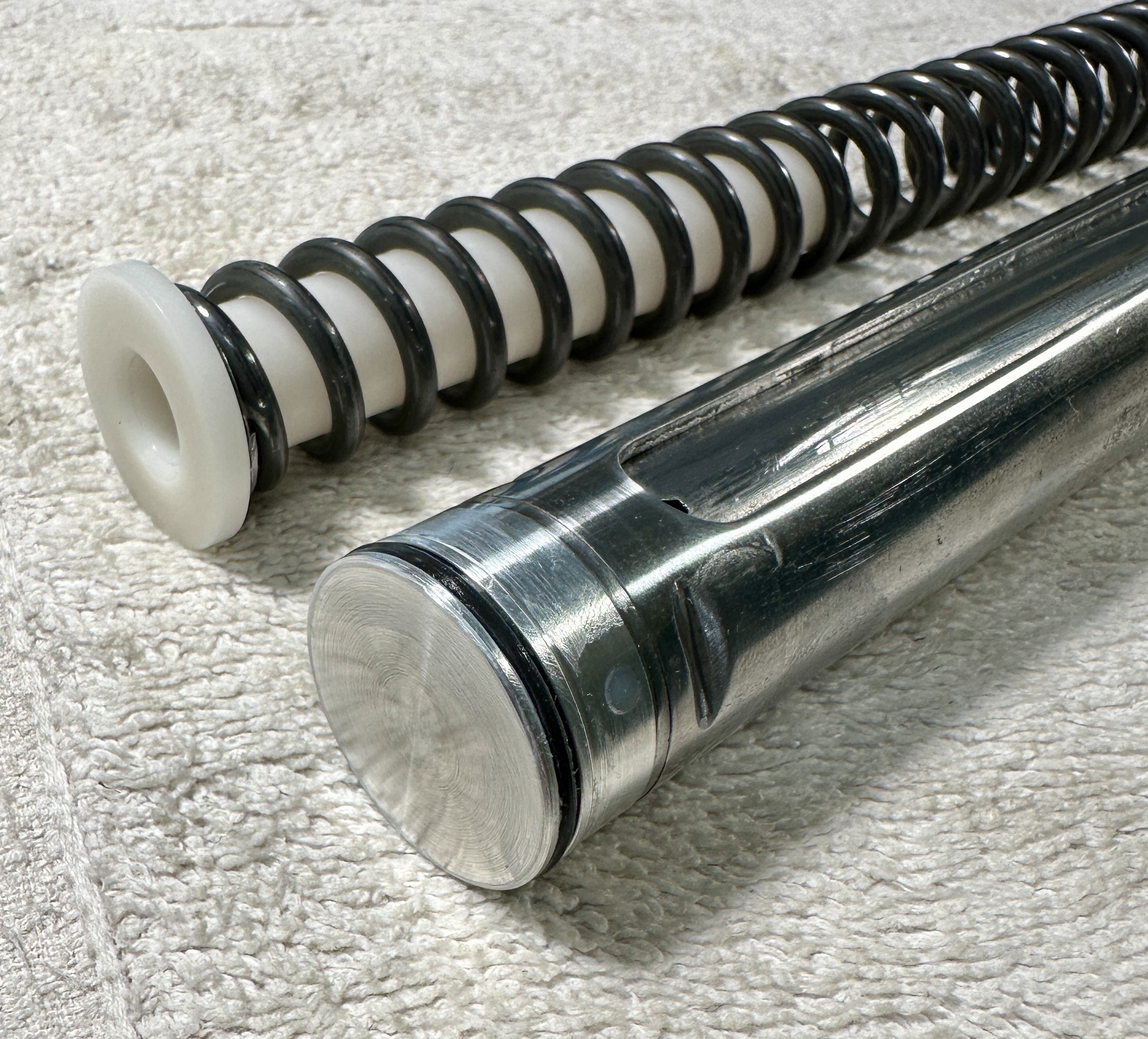

I got my new 98 #1 back together yesterday. Today I remounted the scope and tried some groups at 10 and 20 yards because the wind is blowing 40mph, be glad when it dies out, but that probably won't be until May.
Anyway, I did make new guides for the factory spring and I made a o-ring piston seal, I decided not to button the piston at this time. at the moment it only gained around 10 to 11 fps faster than before, I'll see if it speeds up or slows down when it's broken in.
O-ring with krytox on it...

Looks nice. I would guess the tube dimensions need to be almost perfect for an o-ring piston seal to function well. Hopefully the power increases once broken in.
I remember another gent many years ago making these, I would be curious how they hold up over the long term? Also, if the piston would slam into the transfer port and cause damage if the oring ever failed.

Oh that last part, there's no bumper like a traditional seal?
Yes I usually clean the dovetails, but perhaps I didn't clean them good enough along with not enough torque. Thanks for the reminder.
Yes it needs to be fairly straight and round. I made a gage .002 smaller than the bore diameter and it would go the whole way without any hang ups. I could also tell if there were any spots that got big. Mine felt pretty good. Some tubes would need to be honed if there were restrictions, and some not work at all.
This is the first large break barrel I've done, I did my nephew's HW30 and it had to be honed, it picked up around 50 fps IIRC. This 98 is only up 11 fps so far. In the past I've sealed my 97K and my now gone 77K and they worked good, the compression tube guns are a better candidate for the oring. I've never had a problem with it slamming or a oring failing. It is a more snappy shot cycle compared to the factory seals. But it also isn't as affected by temperature changes moving the POI around, and usually the first shot from a cold gun go where you aim. This has been my experience with my 97K, the 98 I'll have to shoot and test and see how it behaves.
If you're referring to Ed Canoles or NCed, he's the one who got me interested in the oring seals, and lubing with Krytox, and the ones I make are a direct copy of his design. He originally oring sealed my 97 back in 2015 IIRC. I've learned a lot from Ed about springer tuning, he's a good man. We've shot a couple of field target matches together in the past. He was, is, deadly with his R9/95 guns.
Yeah that’s the chap I was thinking of. Apparently these oring seals are holding up ok if he is still using them. Still would make me a little nervous. Especially if someone accidentally dry fired it.
I think that's all he uses in his guns, and he has sealed many guns for people in the past. I don't think he currently does it anymore. There was a guy on the old yellow forums that hunted farms and would post long stories of his adventure's and springer performance. I think his name was Hamilton IIRC, anyway Ed oring sealed his guns and he would tell about how it improved his hunting success in various conditions.
This HW80 .20 is about the third time I shot it. View attachment 547936Came with a BSA scope. The dust covers almost got tossed into lake, what a PITA to screw back on. I like the elastic or rubber stretch covers best. 10 shots 47 yds.View attachment 547937Also a HW80 .22. Sweet gun. This is the gun that got me hooked. It was my buddies.View attachment 547947Look how much melted. The ice on my driveway way 6 inches thick last week. 10 at 47 yds. View attachment 547948Anyway this 80 shoots consistent. The long barrel gives good leverage. Crow
Good groups at 47 yards.🎯 The stainless and black 80 is a nice combo.
