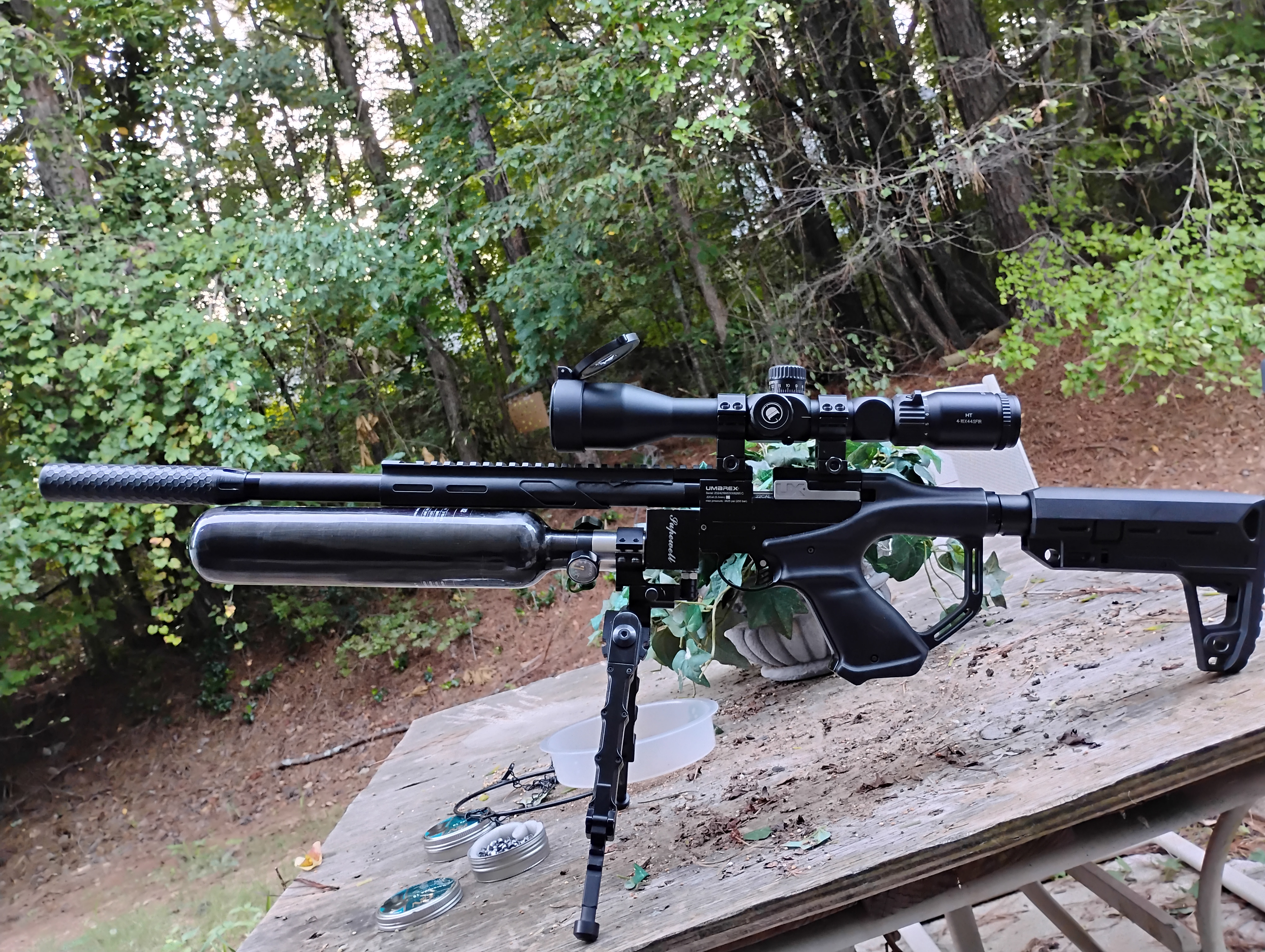

notos, Huben Cricket drop block/reg, port the valve block, the tp, polish the bolt path and hammer channel, toss on a 300+cc tank, FX barrel kit, plenum. The gun is my current baby. For 269. You get a regulated, super accurate .22. But are limited to about 730fps with 15.9 bone stock. Plenum gets you to 760fps, porting to 810 (at stock settings). Messing with regulator pressures and HS tensions can get you to 865 with the 500mm barrel or in the 840 neighborhood with the 380mm

This weekend I took my limit on grey squirrels in a 4 hour Sunday morning hunt. Distances from 36- 83 yards. Not ONE missed shot. The thing is a tack driver at all distances with JSB jumbo exacts or JTS 16 dead centers and NSA 17.5 .218 slugs. I opted for the easily obtained quickly super well drop block (45 on Amazon). Threaded it deeper and took a tiny bit off the back with a honing block (400-6000 grit) and bought the $60 Huben inline adjustable regulator. Love it
Reactions: daddypaddy
If you go my route. Which will take less time. The huben adjustable block/reg is 95 but takes 3-6 weeks to arrive unless you find it in stock at air archery fun or elsewhere.
Amazon
It's listed as "Aopkeo adjustable regulator" the silver pinless one, for 60 bucks is in fact the Huben Cricket Inline tank reg. Fully adjustable. The alsafe 500cc tank was 109, the discoveryoptic LHD FFP moa 4-16x44 was 180 (yes these scopes kick ass I've traded off vortexes for them) and used the extra 200 for better uses. The FX barrel kit is 130 from c88 machinist on eBay... The liner for 110 from trenier outdoors or Southern Precision Air Weapons, I ported, I polished, I used a 35mm picatinny ring mount around the regulator stem to mount a bipod and the Buckrail moderator shuts the bark up better than any donny or fox or impulse did. The plenum isn't on as I'm currently waiting for a little machining to get done to clock the drop block perfect. Without the plenum I'm at 821 fps, but I've brought back the hammer for accuracy sake to 810fps with 15.9 JSB and JTS 16s. The 17.5 gr slugs at 750 and 18 jsbs at 740
270 gun
110 tank
50 block
230 barrel kit
60 reg
45 bipod
40 mod
170 scope
975 for completely as is total package.

What is the gross curb weight of that rig?

wow, that thing is nicely done! looks like it’s got a really good balance.
