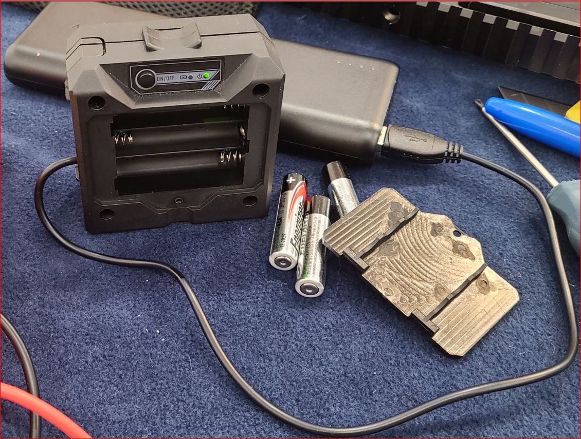

I hate buying disposable batteries and I've heard the FX pocket chronograph really eats the AAA money wasters so I modernized it.
I desoldered and removed the 6 battery connectors from the main pcb and removed the plastic battery tray portion from the case and battery compartment cover with a rotary tool. Insulated the back of the pcb with a foam sheet and wired in a 124050 3200mah Li-Po battery pack with integrated bms and added a charge port.
Capacity for three AAA Duracell batteries in series is 970mah vs 3200mah for the Li-Po pack so I'll have about triple the run time now and be able to recharge at least 1000 times.
The battery cost me $8.70 delivered from virusland. FX could've had them built this way for about $2 more per unit. FX stopped including the tripod base also so I had to 3D print one.
Link to battery pack. Link to 3d printable bipod base file
View attachment 206609View attachment 206620
5.5x2.1mm charge port
Charger / AC adapter
You did an amazing job with this! Did you just drill a hole in the side and insert the charging port? It’s hard to see in your pictures.
Yes and this is the only good spot for it. I wanted to do USB-c but it would've been more complicated due to the footprint of available ports at the time so I kept it simple. When it comes to tools I'm a firm believer in form follows function.

If a built in battery goes bad you change it just like the expensive throw away batteries that definitely go bad after a few hours. This li-po pack isn't built in though. I could literally swap this battery in two minutes but I'll never have to since it's good for thousands of cycles each lasting 4x longer than the best throw away batteries.
