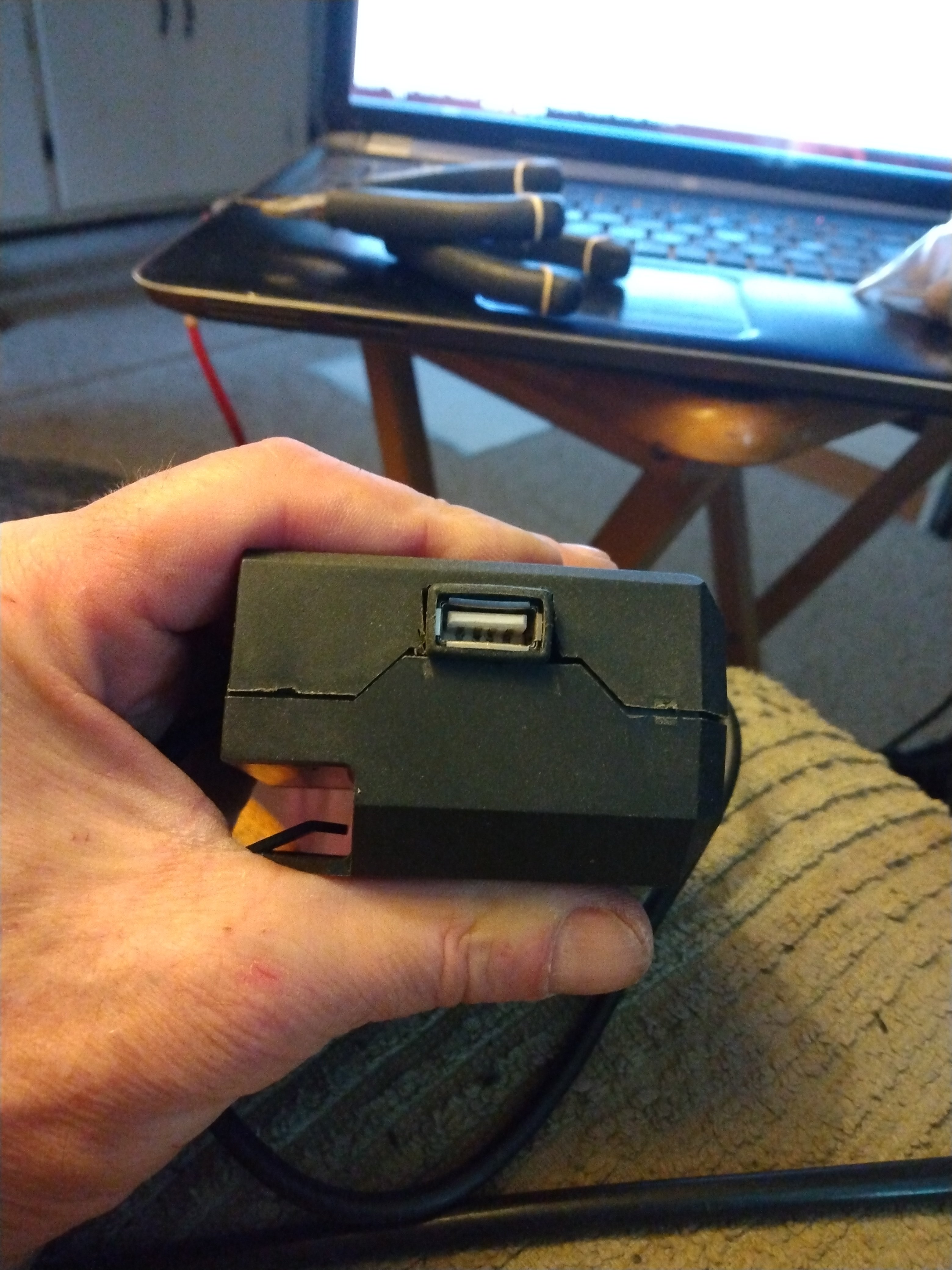

The pack is made up of two li-po cells and has an integrated BMS.

The one you show is a lipo battery, and appears to be a single "cell". Lipo battery can come in all shapes and sizes specialized for use, and are usually single cell when 3.7v unless for high current applications. Are you sure the one you got is 2 cells in parallel?
Most of the ones I've seen are two cells in parallel so the don't require balance. The one in the chrony is 12mm thick or 2x6mm.

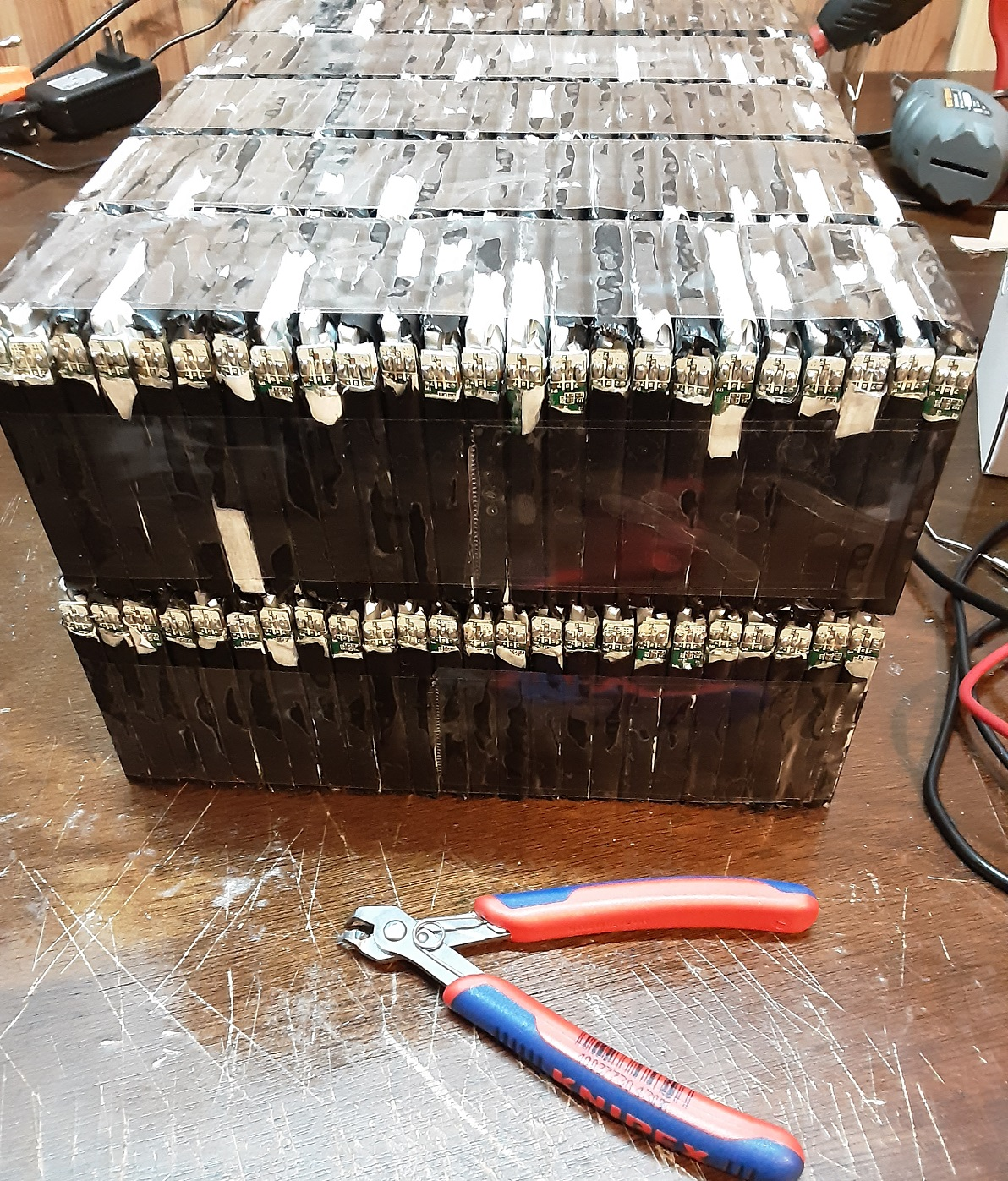

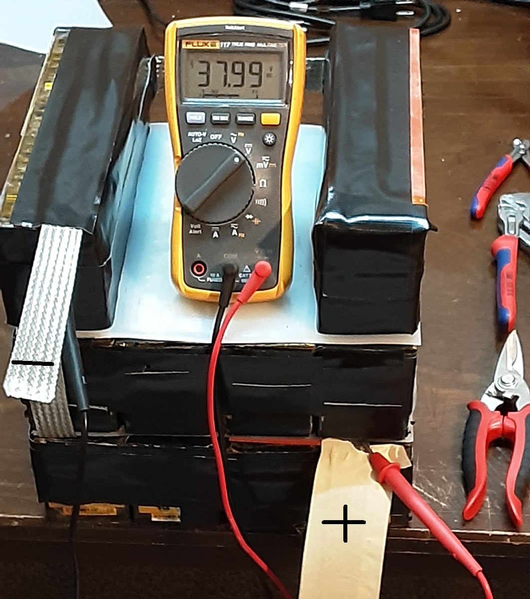

This pic I posted earlier is 250 pairs making a 36v pack to power my trolling motor. Each pair has a 4amp bms. 10s25p over 1000 solder joints.
