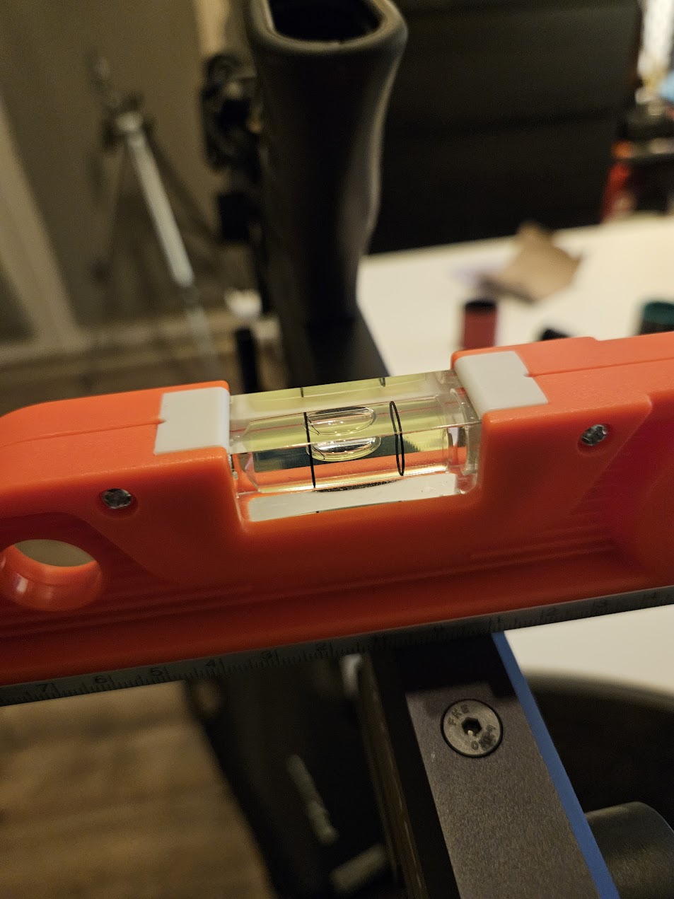

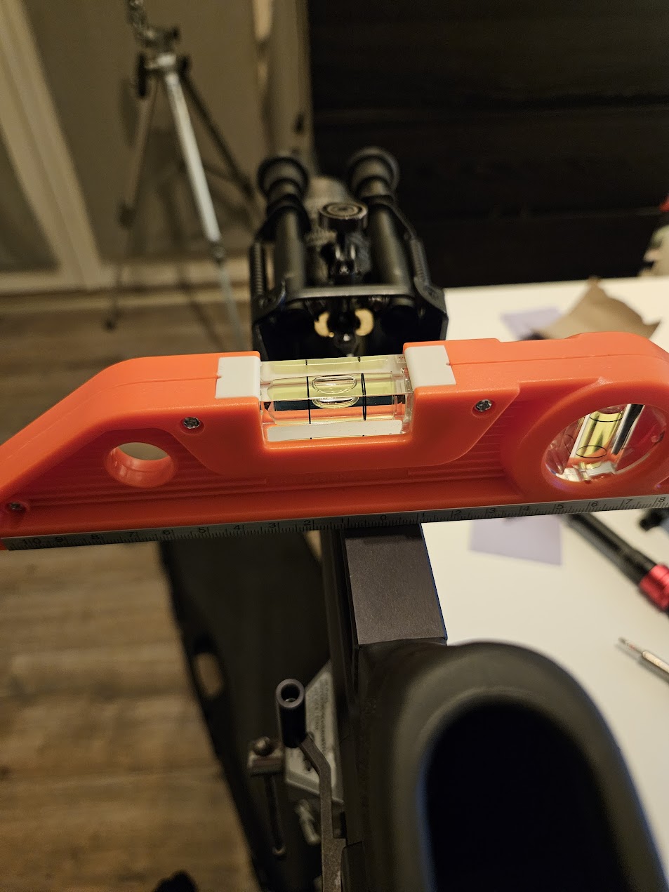

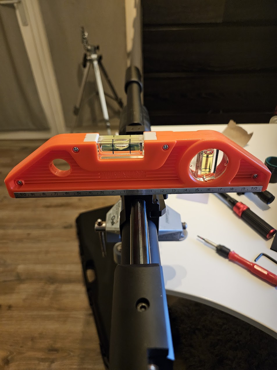

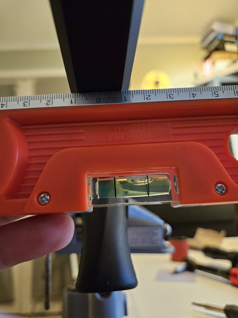

For now, I decided to bubble level check my Maverick as a whole, and found some interesting stuff.
I am not sure what it is worth, but let the images speak for themselves and tell me whether or not this should be concering or not:
1. Where front top rail mount, where rail mounts to chassis (top rail removed).
2. Same thing, back side.
3. With rifle still level on top side, measured the chassis underside.
4. Flipped rifle uside down and leveled on trigger guard
5. Now measured at same surface as pic 3.
