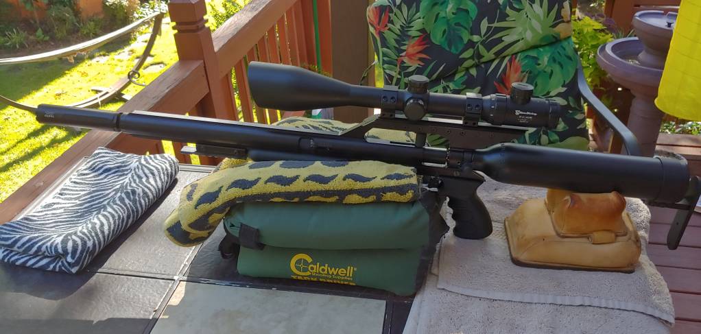

OK so I have recently acquired a talon ss, spare tank and altaros regulator for cheap thanks to a friend of mine. THANK YOU - you know who you are.
This isn't something that's been on my wish list or even particular something I was looking to get, but I have another Air Force (souped up talon P shooting well over 100 fpe out of an 18" barrel, yee-haw!) and I thought having a second one on hand would be useful given how modular and mod-able these are.
I have some spare parts: stock talon p hammer and spring, .25 cal breech, 12" .25 barrel, spare talon p tank with ring lock top hat kit so I can change port size. I changed all of these parts to make the souped up version of the talon p.
I could almost create the equivalent of an Escape ss (= silenced talon p) .25 in that frame. I think I might have to drill out the baffles a little bit which might not be a good idea.
It also occurred to me to try to get some higher energy in .177 and maybe I could shoot some heavier pellets and slugs. I know that the tanks are standard flow so it looks like I can't add a TalonTunes quick change top hat (that was my first instinct).
So if you had one of these, and you wanted to modify it in some relatively low budget way to get a little more power out of it, what would you do?
What about making something outrageous based on this starting point?
Or maybe I should just keep it as is and enjoy a regulated high shot count relatively lower energy air gun to contrast with my hundred FPE beast.
Your thoughts would be appreciated.
