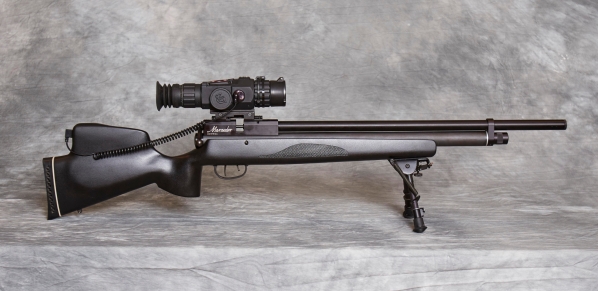

I have the ATN 4K and had the Xsight1. Love them, the 4K is much better rez. Hog hunt in spring with it on one of my ARs and the rest of the time its on my Marauder .22for backyard bunny control. Its day and night vision, records, streams to your phone, saves to Sd card. All around it rocks.
Bunny compilation from my old Xsight 1.
https://youtu.be/kGETBS8RbPM
Xsight 4k
Xsight 1

Yes, day vision and night vision. Simple press of button to change modes. Range depends on your IR. I have a couple aftermarket IRs, but the one that comes with them is pretty damn good. 150-maybe yards. People with high end IRs say they can do well over 300 yards.
Beau
I love that stock, what a setup right there. If you can get the ATN range finder it’s a beautiful integration of the two I highly recommend it.
