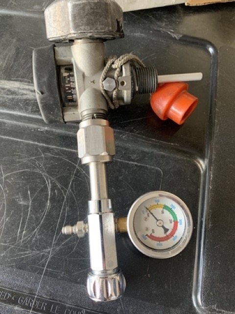

What valve do I need for this?
Searched and didn't really get a definitive answer.
Don't know I need a DIN 300 or a CGA 347. Going to get this set up for my friend so he can use the pcp I built for him. His hand pump went out and this is just easier for him. I'll just refill it when needed.

View attachment 485614View attachment 485615

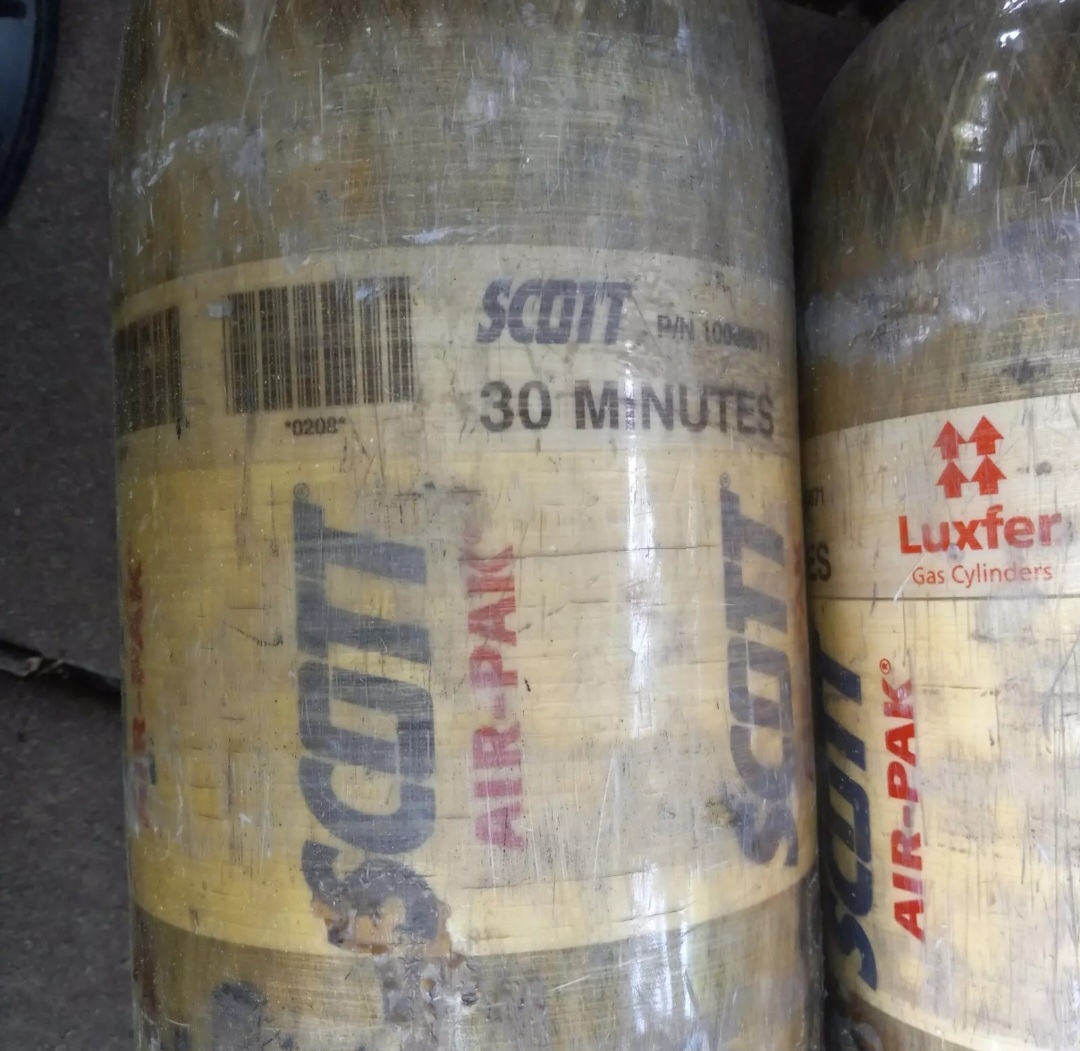

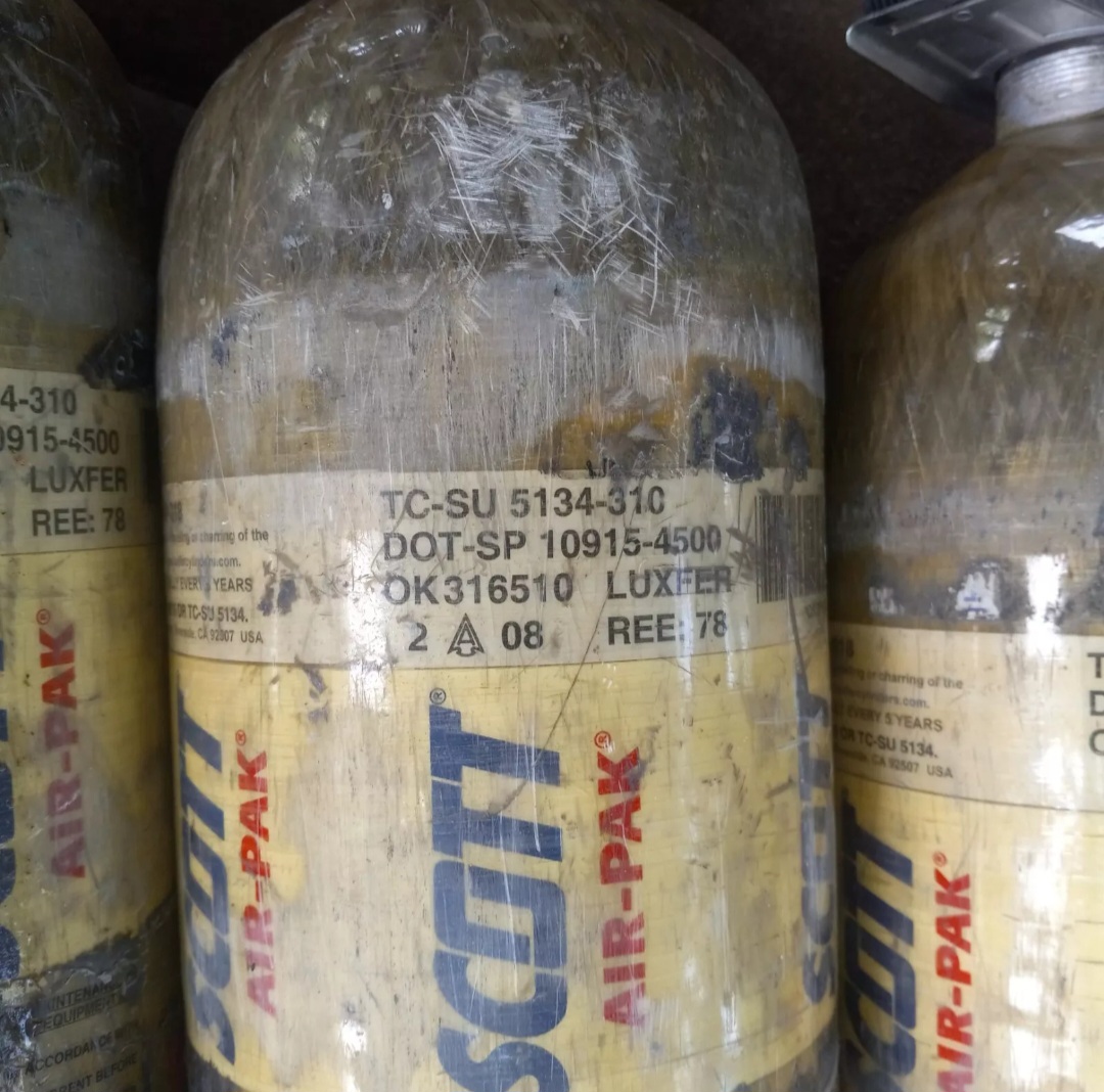

Be careful my friend they look a little old and they do expire better off getting a port compresser you can hook it up to the car but good luck be safe
The cga347 doesn't have threads on the regulator. Is that right?
Never mind, I see the threads on one I was looking at. They had an adapter threaded into it in the pics.

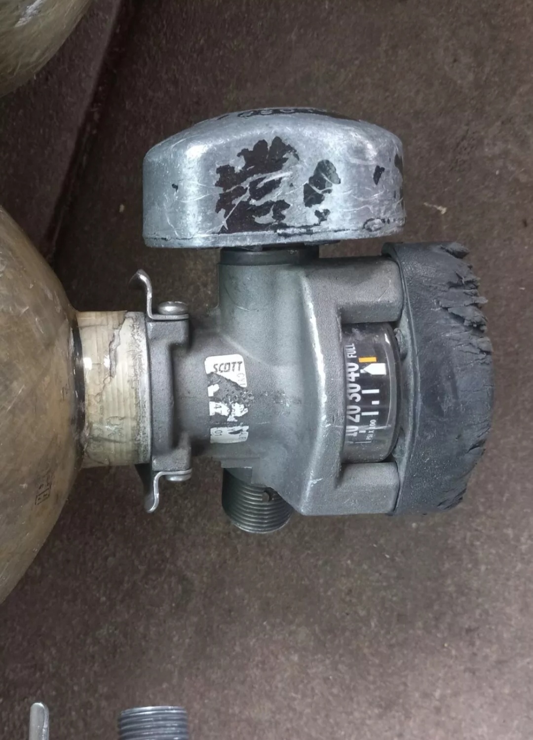

I was thinking of removing the entire scba valve and was wondering what the actual bottle's threads were.
The scba tanks threads is 7/8-14 they do sell normal valves for them.
