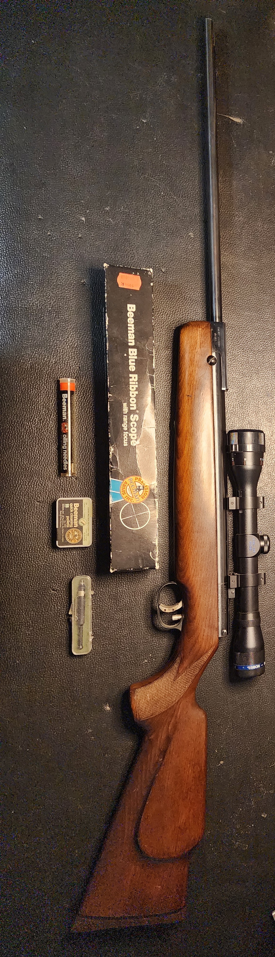

Here is mine. In 1989, I paid $295 for everything and scope mounted. The gun box and manual are in the attic.
