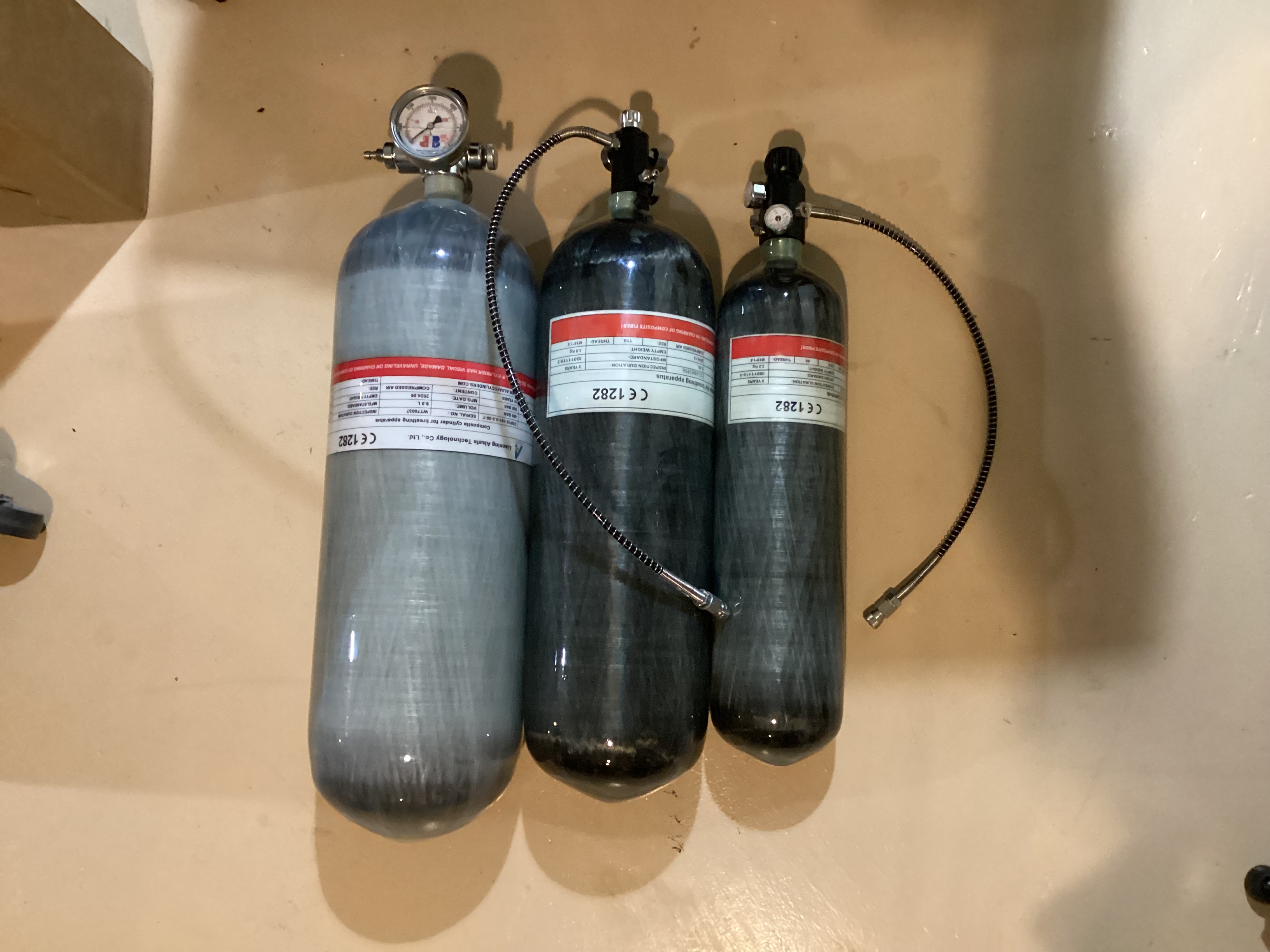

I prefer the 12L but bought a 9L because the price of the 12L was much more than the 9L in terms of $/L
I agree. The cheapest I’ve seen a 12 liter was just over $400. For the house I have the 9. Also a 6.8 and 3 liter.
If I did it over it would be the 12 on a dolly like I have my 9 in the cellar . The 6.8 for the range. If someone was
worried about dimensions the 12 liter is only about an inch each way bigger.
worried about dimensions the 12 liter is only about an inch each way bigger.View attachment 541968
