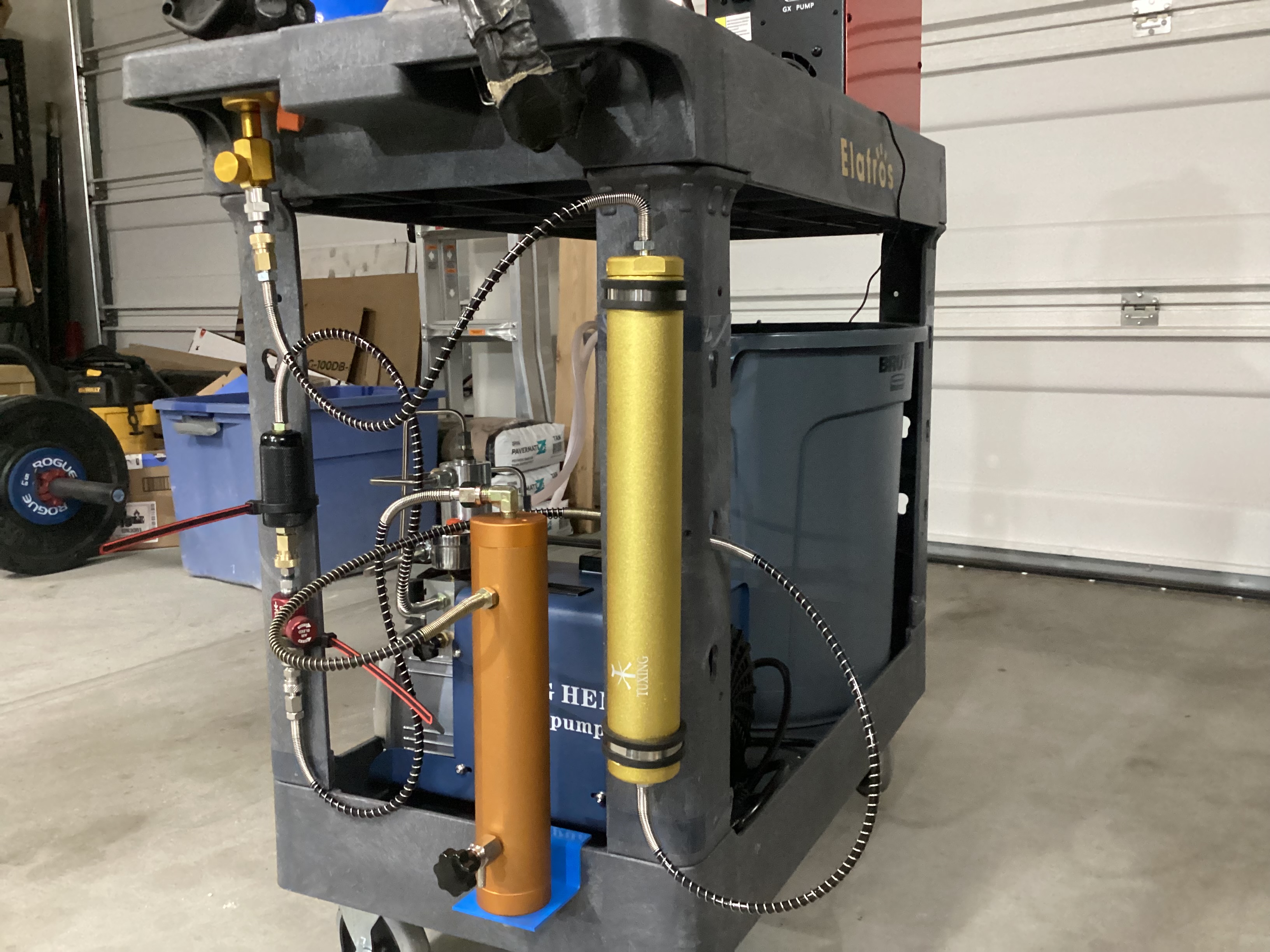

Congrats on finally receiving your GX4- I did too Friday. I just did a couple of test runs on it this weekend and averaged 34 seconds for the deadhead test. To get back to your question...I am currently using the same filter as you described plus a Tuxing gold with desiccant hooked to my Yong Heng. I added a check valve in between my first stage filter and the 2 "drying" filters. These cylinders take some time to fill up and you don't want to completely drain all the air especially if you're filling larger cylinders in stages. If your just filling guns then you probably don't need a check valve. If you're just doing guns, you probably get away with one external "tampon filter". I will post some pics of my set up when I get home tonight. I plan on hooking these filters up to the GSX4 this weekend...If you do get these filters, definitely check all the pressure fittings-cause mine were not completely fastened and leaked.

Glad to hear that you got your compressor! What desiccant is in your Tuxing gold filter? They've got one with cotton only that's about 13 " long, and at least one with molecular sieve beads, plus at least one other that has charcoal + other content.

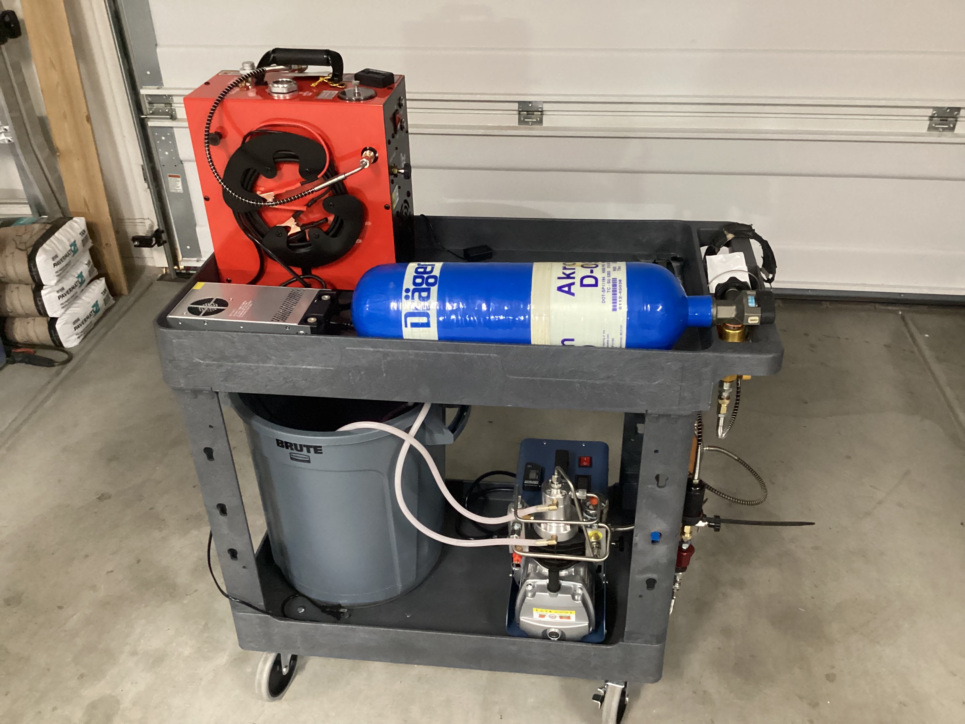

Looks a little messy, but it doesn’t leak…;). I have some fittings coming so I can rid of one of the HP lines…

I was under the impression that the molecular sieve beads needed to be able to drain off their captured moisture, and operate in vertical position to allow the water to drop out of the filter into an area with a bleeder. Is that incorrect?
two separate compartments, look up above at Dfp23 rig. One has bleed valve one is sieve
