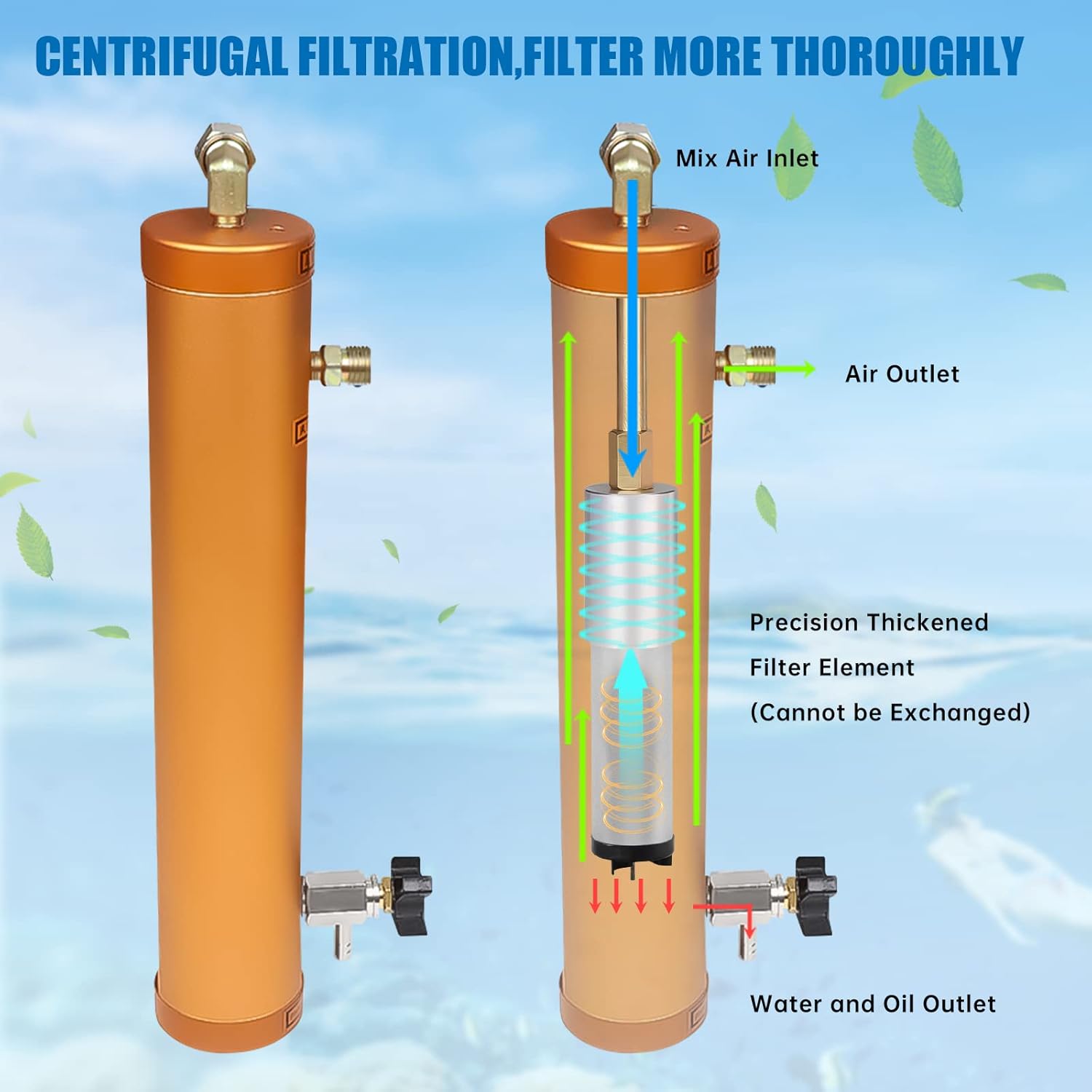

I am definitely not a subject matter expert on filters or compressors ....That being said, I put my 3rd stage (molecular sieve filter) vertically as a final preventative measure of moisture build up especially with the YH compressor. I haven't had any moisture in that filter after filling a 30 min SCBA in stages. I have had moisture drain off from the 2nd stage filter (centrifugal? type filter). I have not tried this on the GSX4 yet. Honestly, I think this set up would be overkill given the efficiency of the GSX4.I was under the impression that the molecular sieve beads needed to be able to drain off their captured moisture, and operate in vertical position to allow the water to drop out of the filter into an area with a bleeder. Is that incorrect?
my second stage with drain on is this one...two separate compartments, look up above at Dfp23 rig. One has bleed valve one is sieve

I would advise mounting a filter vertically to allow gravity to act as an assist for the beads to work. If you reach a point were water is collecting in the bottom of the filter the beads are no longer effective. Molecular sieve only holds about 20% of it's weight in water vapor. Those gold filters are repackable and you should monitor them by the number of hours run. Beads dripping water means you're long past their saturation point. Even the more expensive filters that have drain valves at the bottom should never spray moisture. That means the pre filters built into the compressor have either not been opened frequently enough during a fill or isn't properly designed for that compressor's output. The compressor bleed should discharge most of the moisture during a run. The desiccant filter should be for the small amount of moisture that gets past the internal moisture drain.I was under the impression that the molecular sieve beads needed to be able to drain off their captured moisture, and operate in vertical position to allow the water to drop out of the filter into an area with a bleeder. Is that incorrect?
