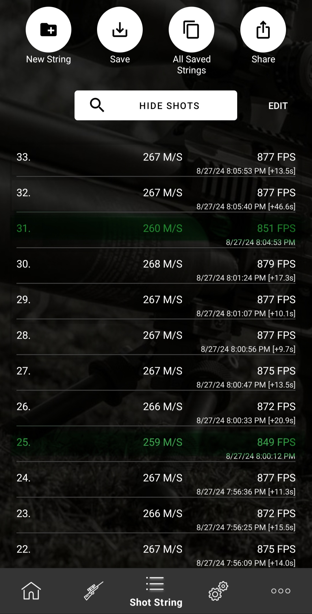

Wrong! Or there is something wrong with mine. if the gun shuts off and I cycle the safety my first shot is slow

Sean, if your gun is new it's probably just a "break in" issue.....
I bought it used from aoa. I need to figure it out, that was one of the reasons I wanted this gun. My impact I have to dry fire 3-4 times before I shoot at anything. Was hoping with this gun I wouldn't have to do that. I may try pulling the battery overnight to see if that helps. And if anyone has a couple good tunes for .30 let me know lol

Something is really wrong......

Please post the resolution to this issue, as it does sound unusual.

The way the factory sets these up is for easy versatility. The rifle can compensate for too high of reg pressure but the price is first shot low in velocity. When you have a SPECIFIC pellet and velocity in mind and want absolute first shot velocity, you're going to have to give up some of that versatility. In this case, start with a lower than needed reg pressure , set the rifle to more than needed power level and fire shots and turn the reg up till you get the velocity you want, then go up just a little more. Set your power level back to where you want and you should be good to go. This will make it much less sensitive to small changes in the pressure.
Mine is typically within 5 fps on shots from being awakened when set up this way for hunting or FT.
