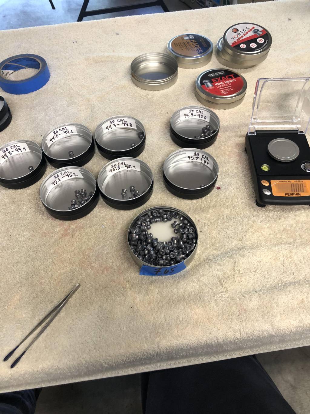

@ CMATERA- I’m sorting pellets now, JSB 30 cal, 44.75’s.
Dont know why there’s so much love for these. 4 different head sizes and up to 7 types of weights. I’ll be lucky to get one full tin of one head size, one weight, in a batch 900 that I went thru. At the current prices of around $18/tin, that’s $108 for 6 tins and the majority will become plink ammo.
I think JSB should’ve at least provided me the weight scale, the head sizer gage, and sorting containers to make it right?
Bigragu-I think you are chasing unicorns there are just too many variables to come up with anything meaningful across even the exact same model of gun. Your gun might like a certain weight/head diameter, and even the same model gun another.
