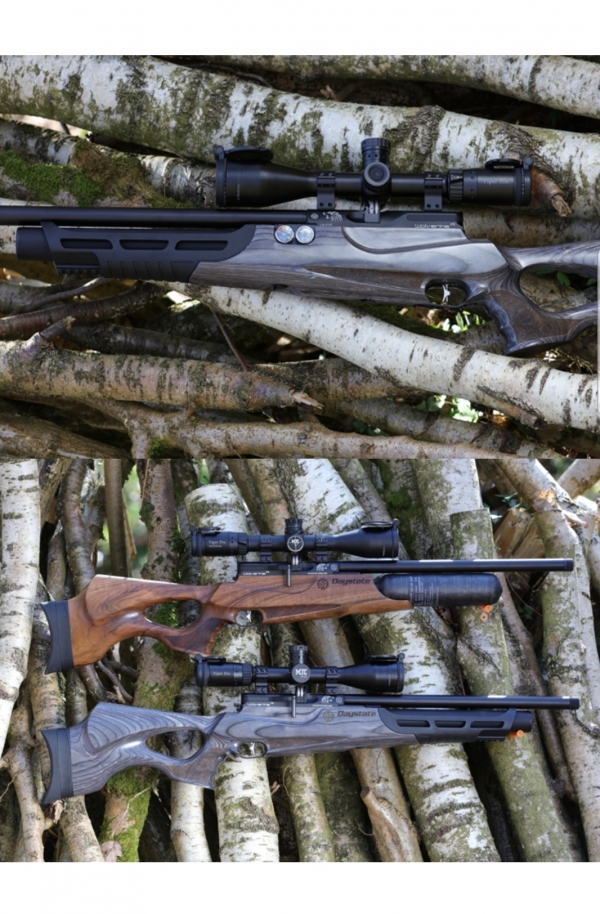

From your list, it looks like you're looking at a traditional rifle with the exception of the FX Impact. RAW would be a solid choice but they have a long waiting list. Check out the RAW REPORT in the General Airgunning section here for more research. Since you already have the Redwolf HP in .22, you may want to consider the Pulsar in .177cal and get the Daystate Handheld Programmer which you could use for tuning both platforms.
Another option is to get the Wolverine R in .177cal. Daystate offers two versions. The Wolverine R, C Type (Cylinder) and the Hilite. Me personally, I would opt for the C Type with the integrated picatinny rails in the 12 FPE model. According to Daystate's website, the shot count for the C Type in the 12 FPE model is 200 and for the Hilite (Carbon Fiber bottle) in 12 FPE is 460.
From your previous post, I take it that you want to stick with AOA for warranty issues because they are local to you right? I'm not sure if they offer the 12 FPE models but maybe they could order it directly from Daystate. If price is an issue, I've seen good reports with the Daystate Huntsman Regal in .177cal.
The .177cal 12 FPE model with the new Huma Regulator produces about 140 shots and the FAC version @ 18 FPE produces about 60 shots. Again, you'll have to ask AOA to probably bring these 12 FPE models in if they don't offer them.

Look at these beauties!!!...
