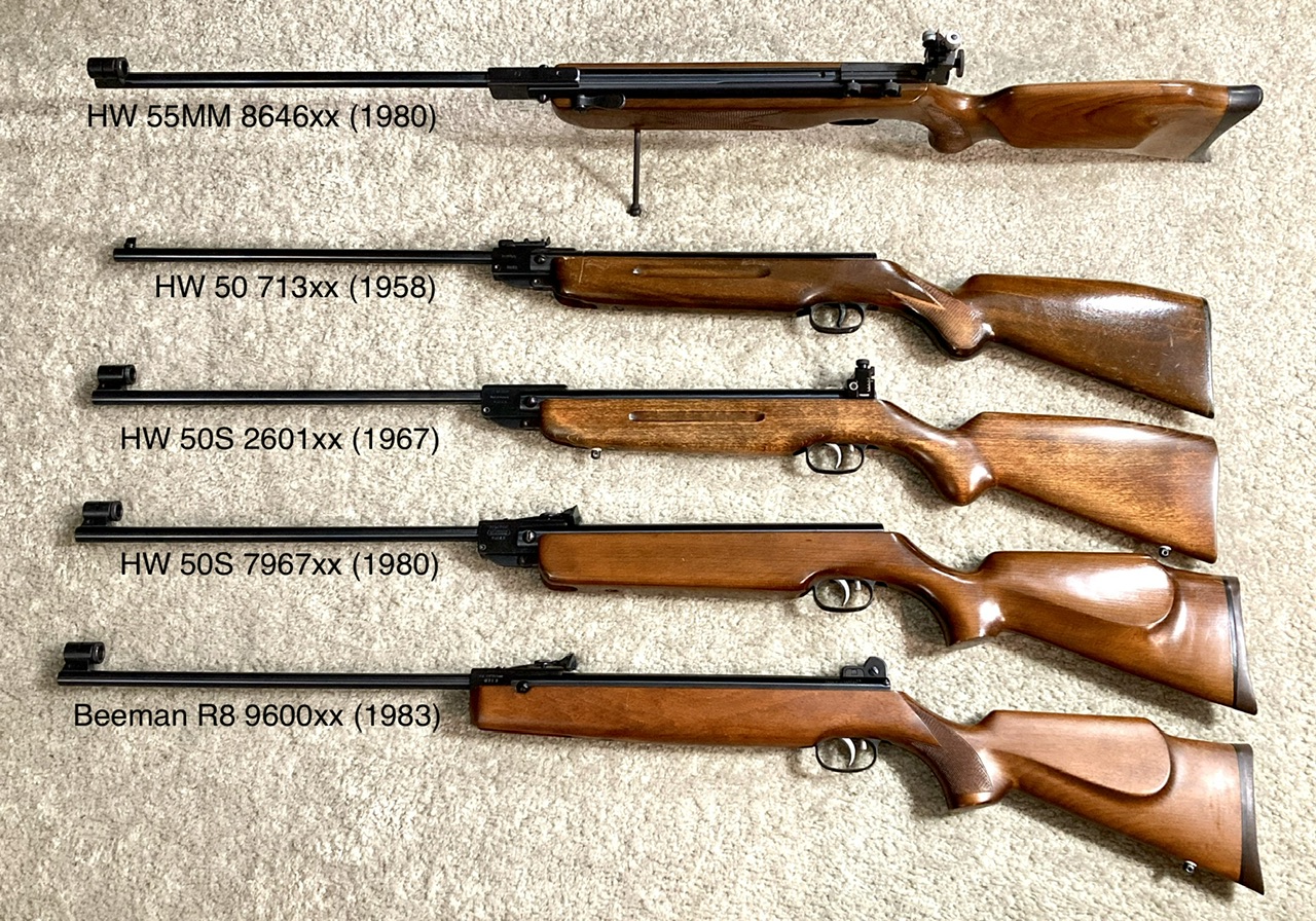

The old HW 50 is one of my faves - Weihrauch's only small-diameter action (i.e., 30mm exterior receiver diameter) that had the famous threaded-on rear end. Very solid, great-handling rifle with power right in between the R7 and current HW 50 / HW 99.
As KWK noted, the R7 and R8, derived from the HW 30 and 50 respectively in the early 1980's, had synthetic seals from the beginning - a big Beeman selling point. The HW 35 switched over about then too (843636 as noted above - made 1980). I don't know how long this took to "trickle down" into other versions of the smaller rifles, but it's pretty likely that except for the "R's," 30's and 50's from 1980 and before have leather.
I actually have a 1980 HW 50S, 796xxx serial, but it's a recent acquistion that's not been apart yet! The stock on this gun was an optional upgrade in Europe, but Beeman made it his standard one for a couple years prior to the R8. Older 50's usually have the severely plain (but for me, amazingly comfortable) stock of my 1967 one.

77 looks just like your 67,and I have to agree with you that out of all the rifles I have,that sweet old 50 is one of my favorites as well. I think it has a broken spring,as it's a little crunchy when cocked. Hopefully the leather seal is in decent shape, I'd love to keep it.
