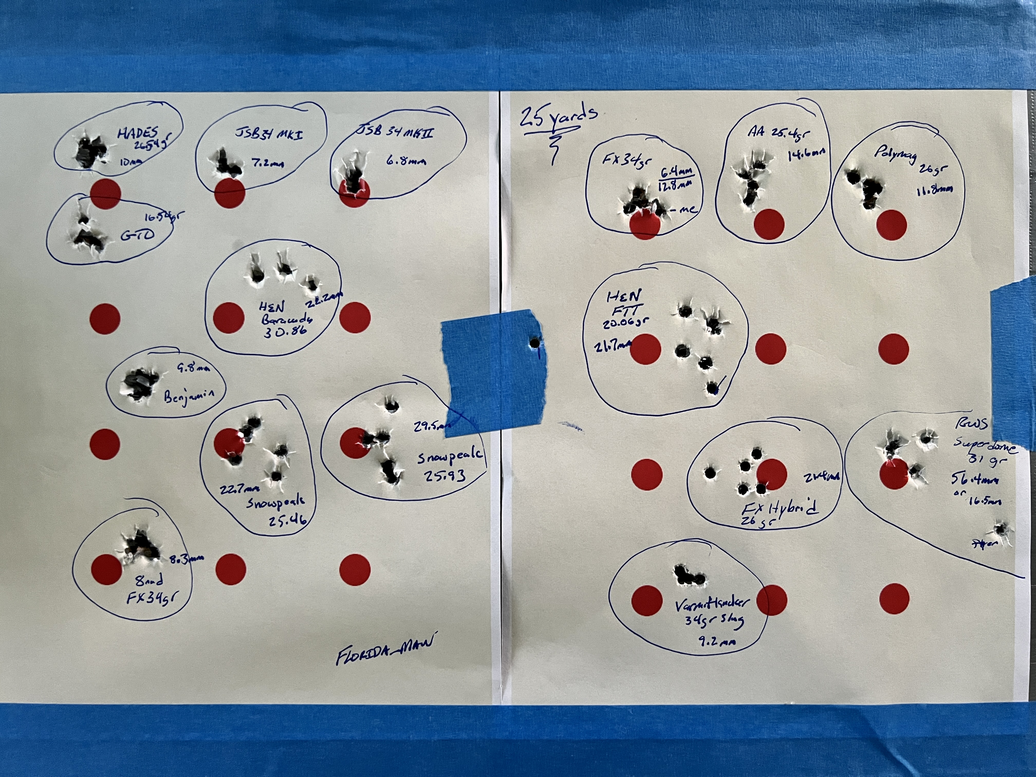

My P35 25 cal was the last rifle I tested them with, not bad, but not the best. I usually take head shots so the pests down leave my yard, so a tight group is higher priority for me.
Imho as airguns become more & more accurate at longer ranges the Polymags deficiency at longer distances becomes more obvious & less desirable. I really liked them as a hunting pellet when my abilities only left me comfortable staying within a 50-60 yard range. As my abilities grew and shots of 100 yards + became more commonplace the Polymags just didn't DELIVER accuracy-wise. As said above, when Hades came out everything changed for me personally. My .25 Royale shoots them more accurately than any other pellet & they're always "minute of squirrel head" in my .30 Boss too. The terminal performance is equally devastating at ALL distances as the Polymags were at their limited distance so the choice, for me, was obvious. On a side note, from day one, no matter what gun I owned at the time, Polymags would not fit in my magazines so I just clipped enough of the polymer tip off so they WOULD fit. Never affected their performance.

I've had a few really love them. .177 BSA R10 and a Taipan Veteran Standard .25. I've had .22s that liked them also. Just hard for me to give up any accuracy over a standard diabolo. But I'd say 50yds and in they are fantastic and really pack a punch. I know lots of people love Hades but I never noticed any difference between them and regular diabolos to think they were worth it. Polymags you can really tell vs Hades in my experience.

What’s interesting about a Poly is some of my guns will easily let me go well beyond 50 yards. But if a gun won’t let me shoot nickels at 50, I won’t use them. Another thing is they hate wind. A pellet doesn’t like wind but you can deal with it. A Poly is a little worse.
I have a M3 .25. It’s one of my primary squirrel guns. Last year I hunted squirrel using H&N hollow points. It just didn’t do the job that my other .25 did with Polys. So I built a LW barrel for the M3 and focused on making the barrel shoot a Poly and a slug. I did it and I can’t wait for fall. I will start off with Polys and as the season wears on and the pursuit of larger animals at longer distances starts to happen, I’ll switch to slugs.
