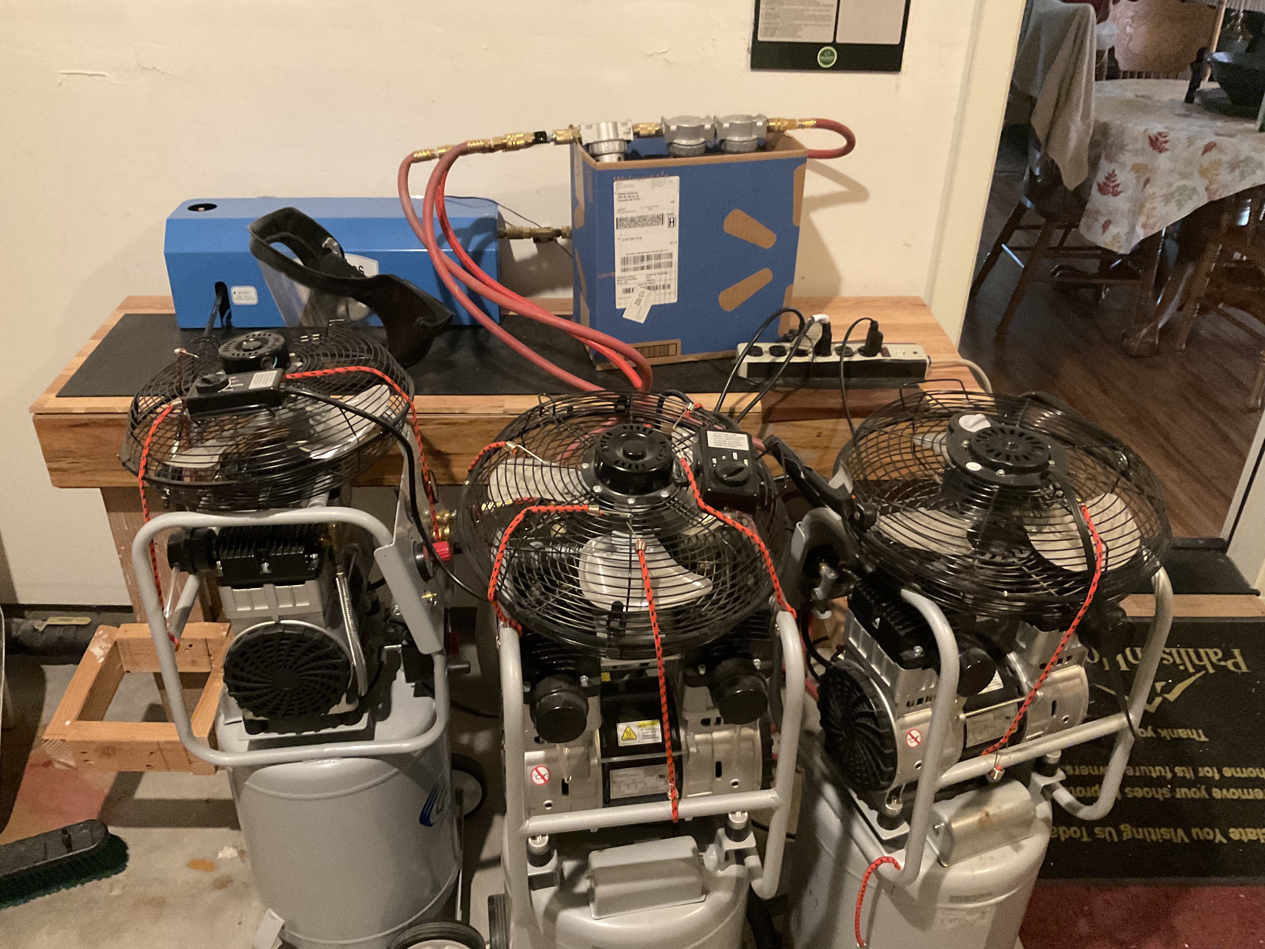

A Shoebox is a small booster style compressor that was made, I believe, in Texas. It's about the size of a shoe box, thus the name (I'm guessing).
They have since been pushed out of business due to the less expensive compressors from overseas. That makes it tough to get parts now. Thus, my statement about anything major going awry, it's gonna be trouble fixing as parts are tough to find. There are some parts available, but not all.
Relatively easy to rebuild however for general maintenance. A shame that they are no longer available.
